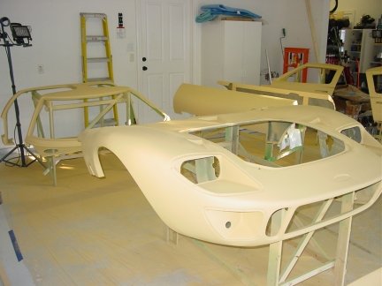

After months of sanding, ready for paint. I am sure, however, that after the prime coat is applied I will find, many, many defects. But hey, I'm a rookie!

Thanks guys, I'm fixing to get myself a stubbie as well! Got it primed yesterday, what a bit of work! About four hours to prime. Boy do you find out where more work needs to be done. Will hopefully have the imperfections corrected and spot primed by next weekend so I re-sand and get ready to shoot color.

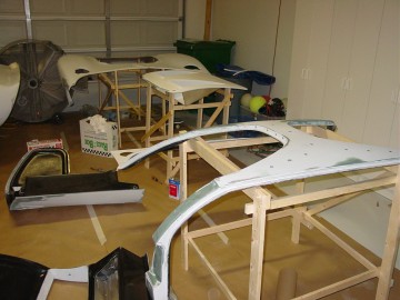

Just before second coat of primer applied...

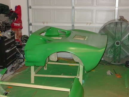

And primer applied. This stuff dries way too fast for me, very, very easy to get dryspray if you're not careful (I did and will have to re-sand the rear clip and re-shoot). Going to see if there is a slower drying version available. Anybody got any tricks to spraying the engine air intakes? Very tough to manoever the gun in there.
Re: RF52
Pat,
It's got nothing to do with the primer. It's the thinner. You need to buy a thinner for a warmer temp. They make three different kinds. There is a fast dry, a medium dry and a slow dry. Talk to the supplier and he should give you the right stuff.
