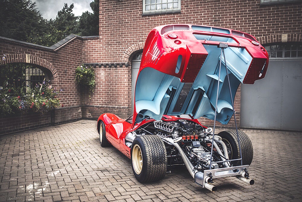

If I ever get my P4 finished, I would have some kind of pre-flight check-list that must be completed before setting off. I have a brain like a sieve and will surely forget something important! At least the tail on the P4 hinges forward and not back!
Mark
You may have hit on something for some for the tinkerers on the forum. I can see the 40 tail flipping up from the roof line. Lord knows it would help from having to take the tail off every time you need to do some work on the drive train. Would take a hell of a set of gas shocks to support it.:stunned:
I will put that thought in the memory bank for about 2-3 years from now. That's all I will say about it for now:idea:
