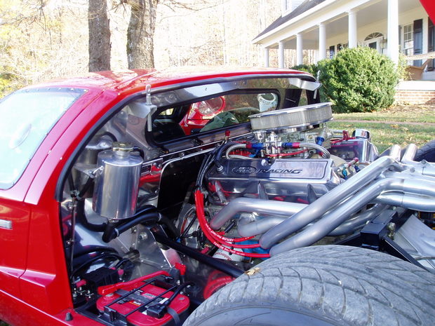

Good to see you're back on it Mark! I used a door weatherstrip from one of my donor vehicles. It raised the rear clip level just the correct amount. Send me your info and I'll UPS a strip next week.

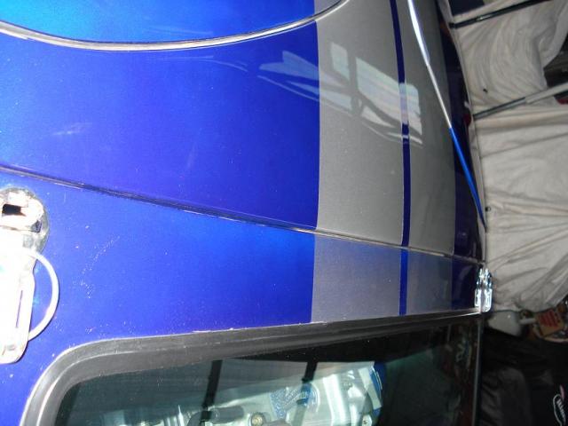

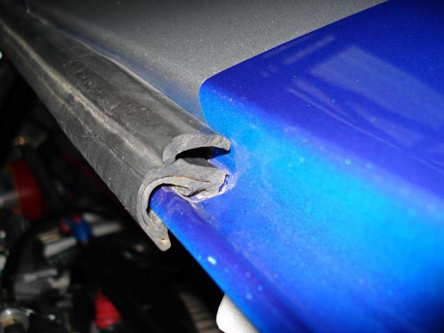

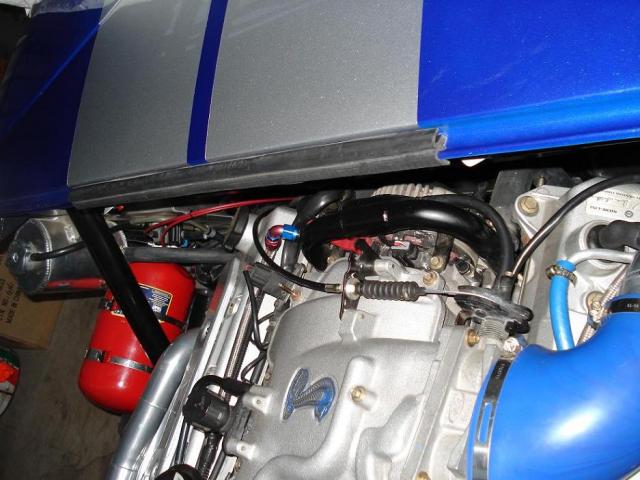

Sorry Mark I missed your post earlier. This is what is on my recently completed RF GT40. Let me know if you want more details.
Regards
David
Thanks all for your advice and help, especially Jim who took the trouble to send me some moulding he used, and to Dave, whose pictures helped me identify the correct moulding among my few remaining unopened RF parts. I also like the idea of using only a short strip in the center of the spyder - less weight, less fitting and finishing.
