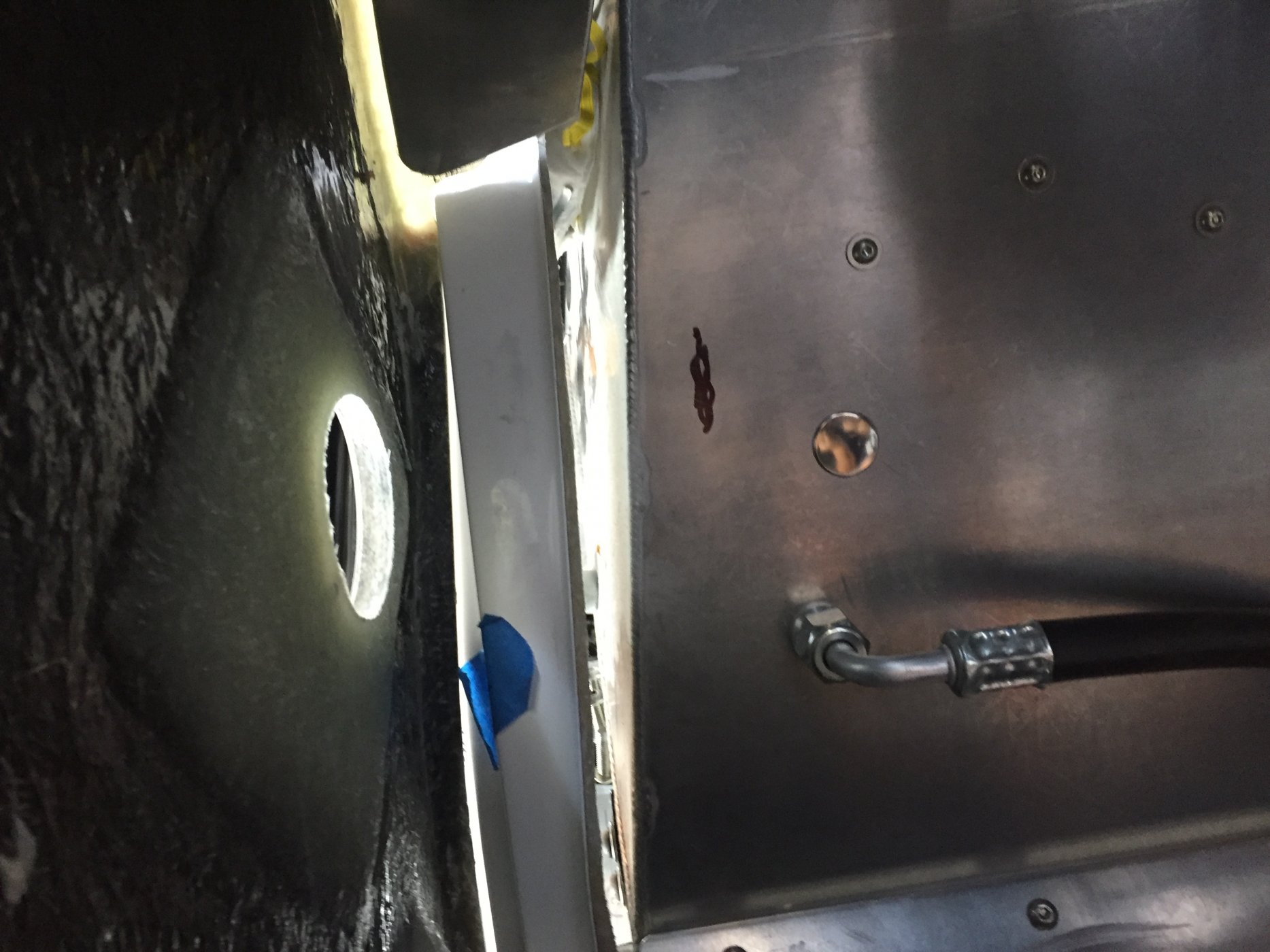

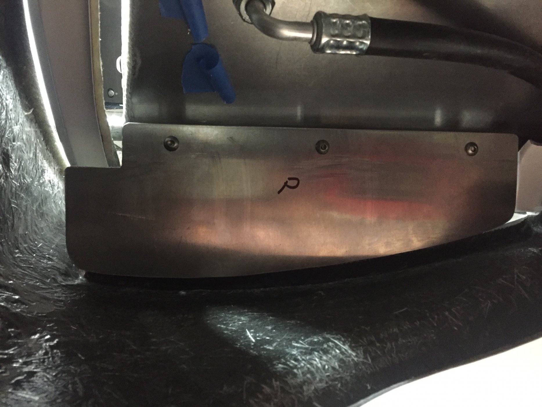

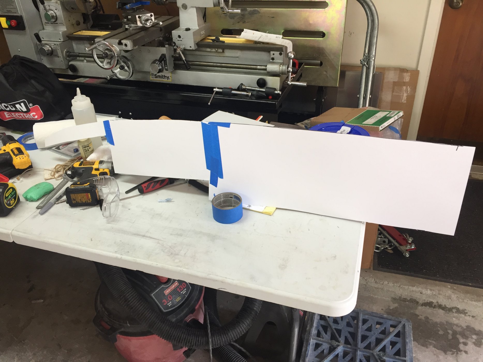

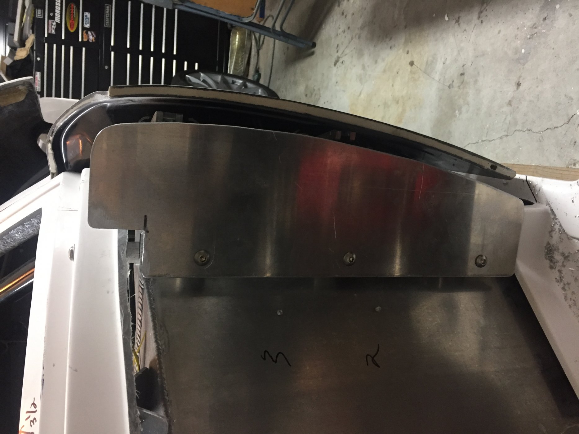

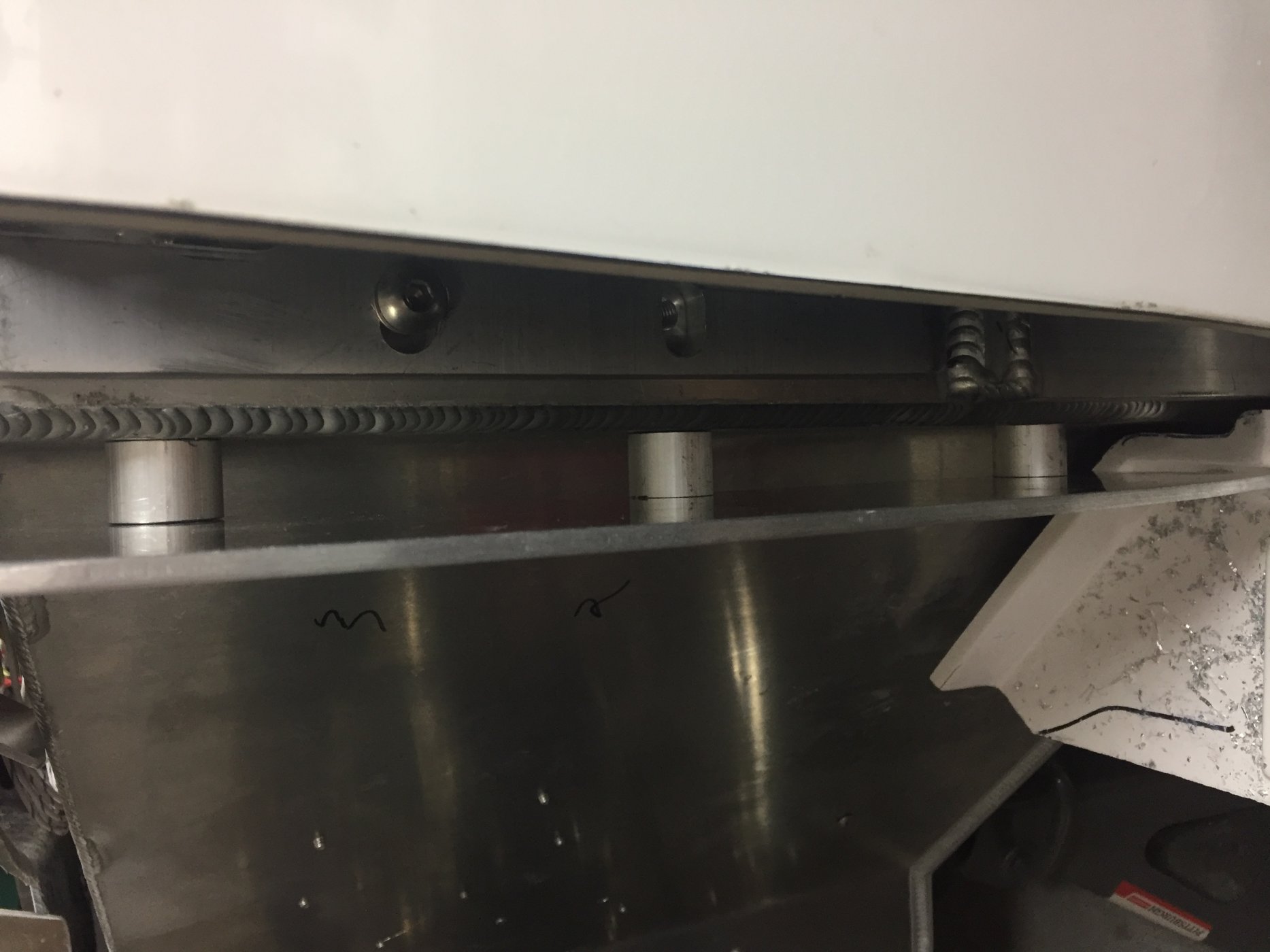

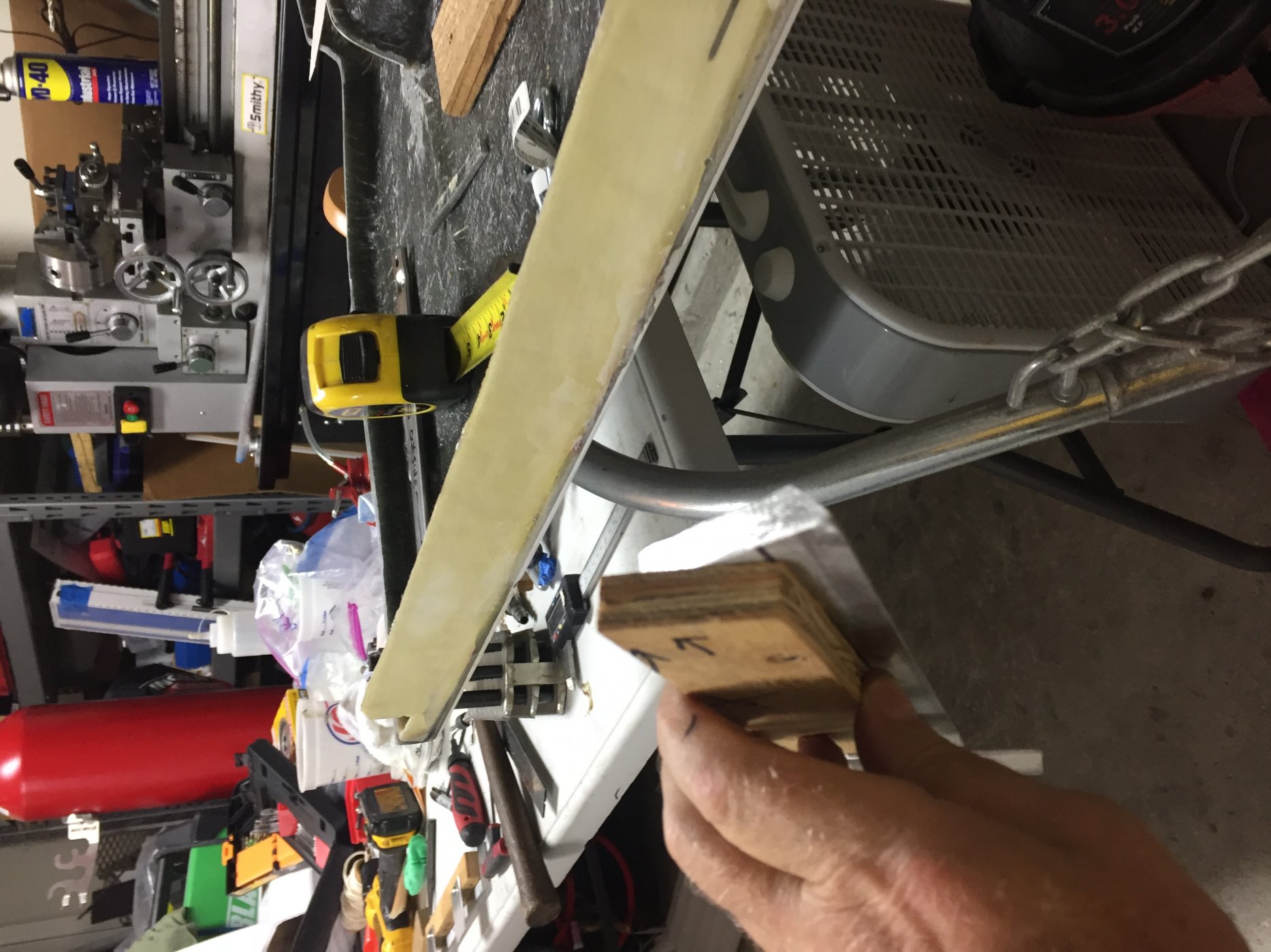

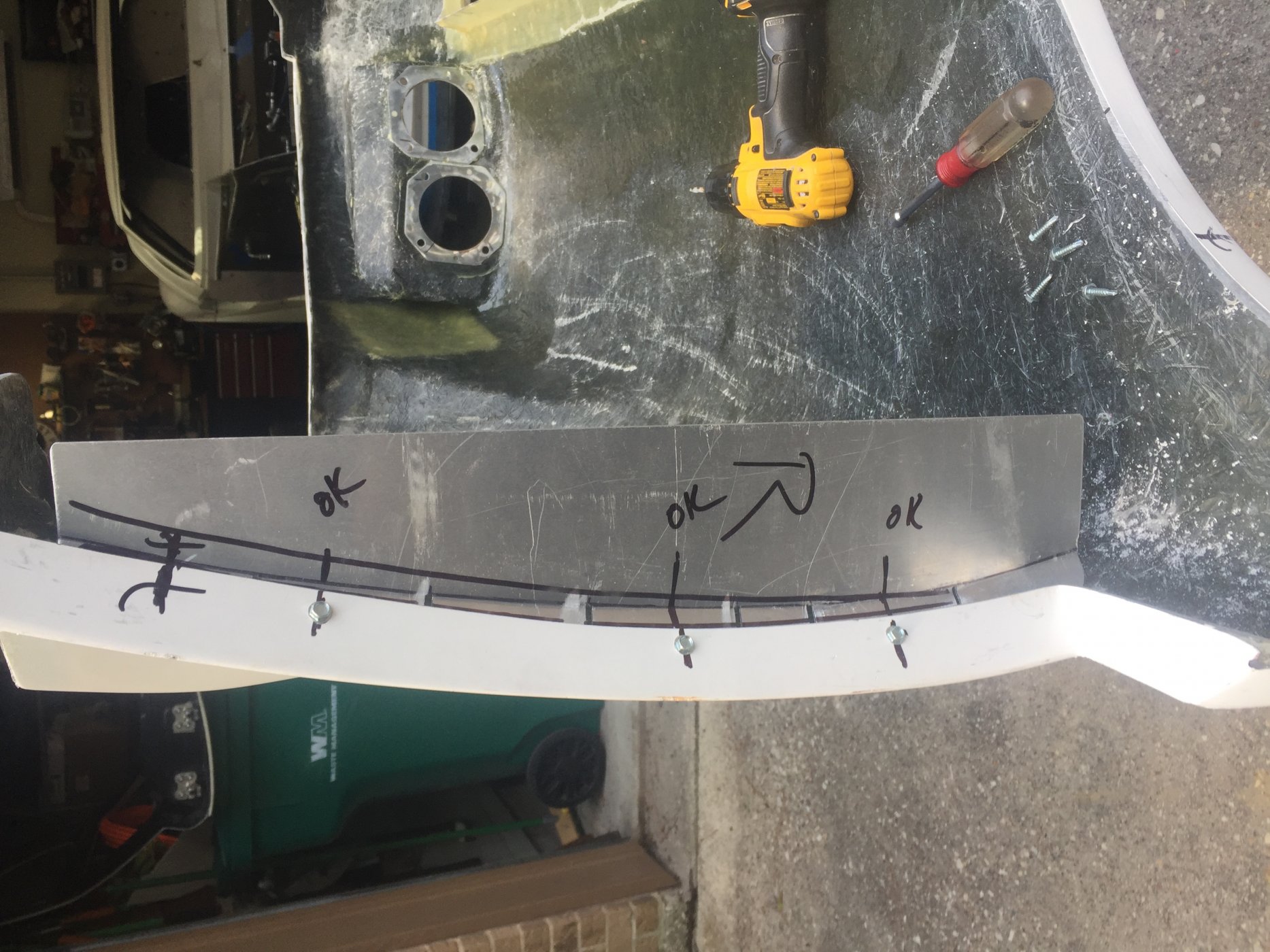

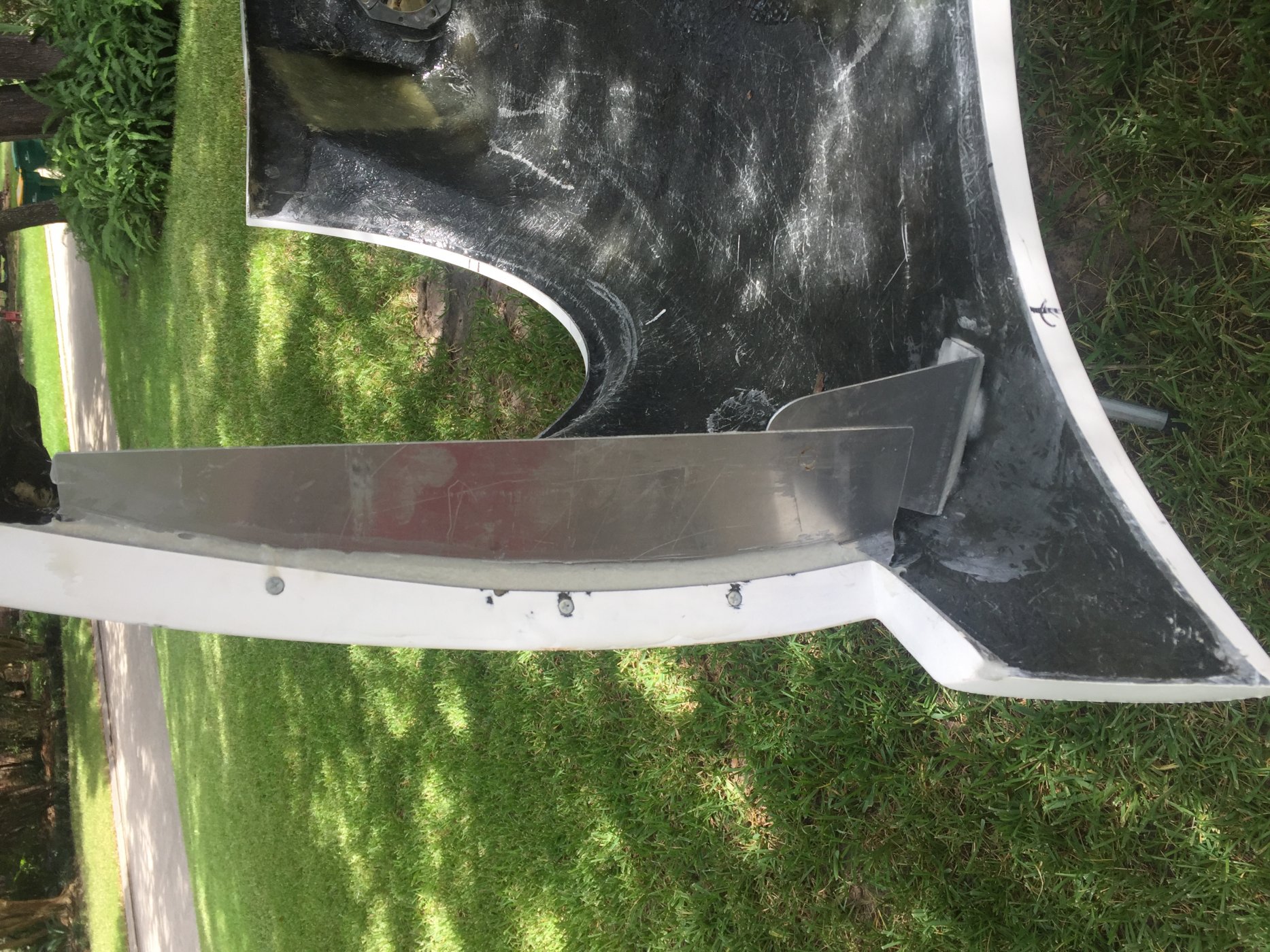

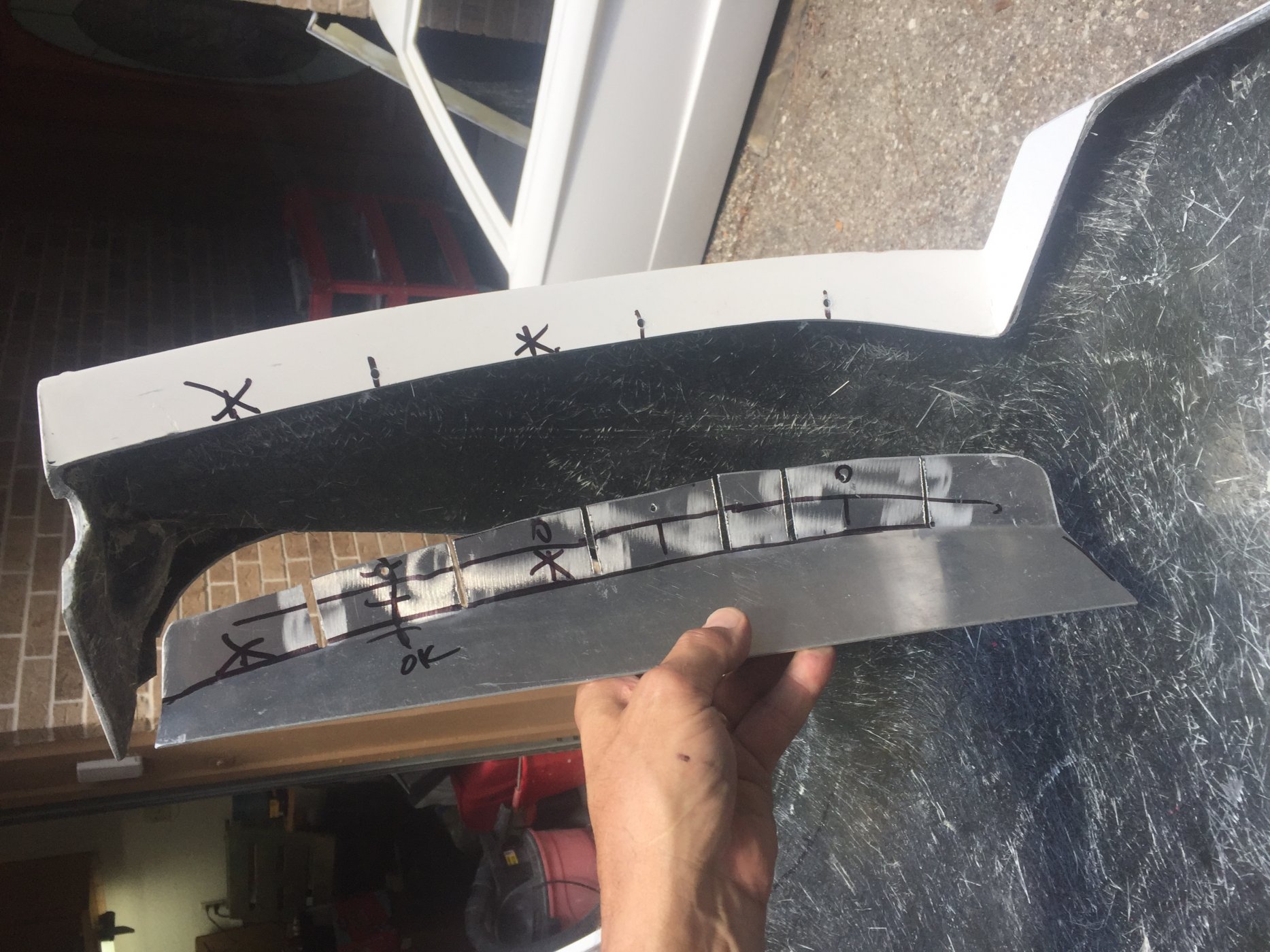

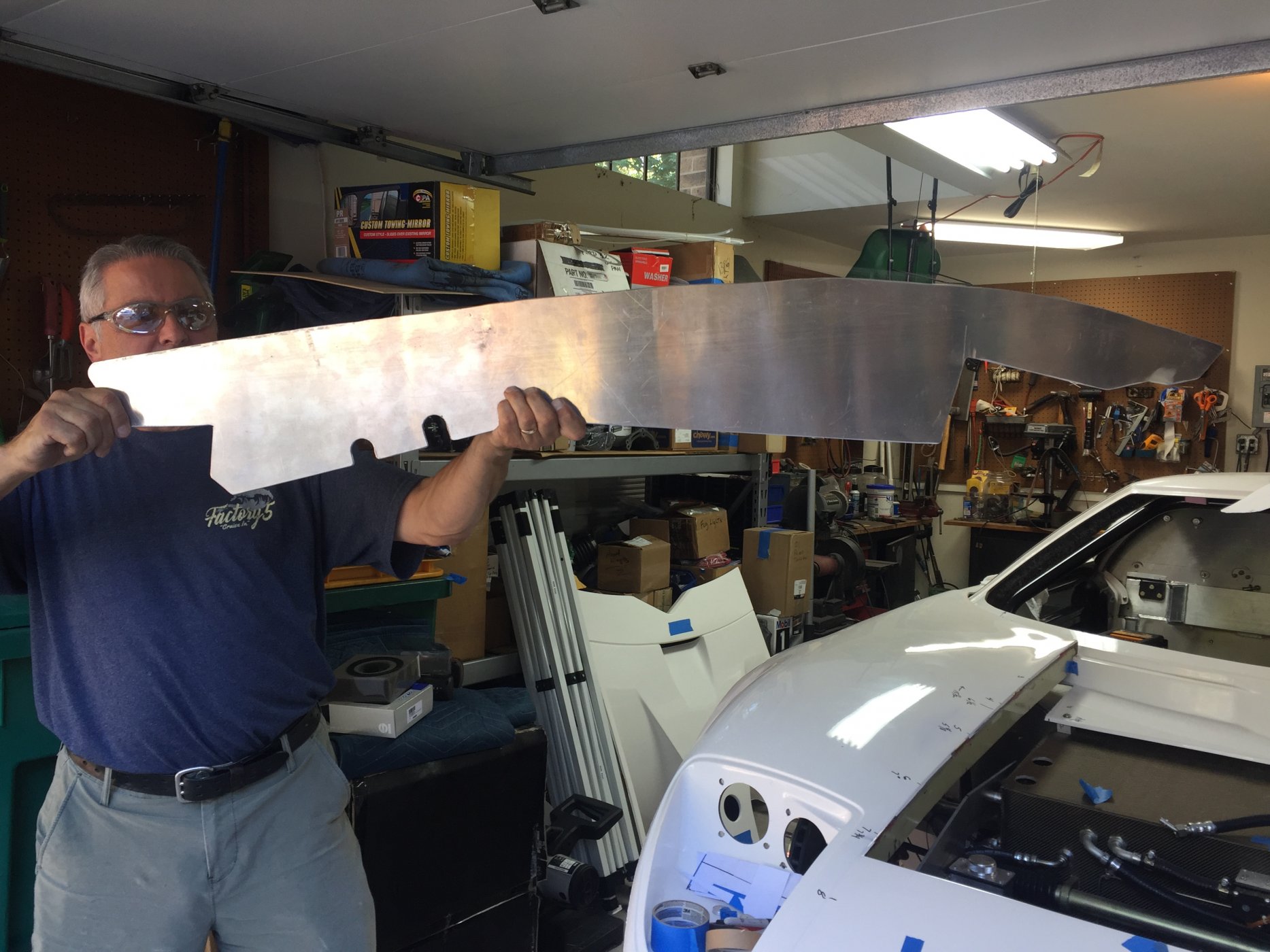

Made cardboard patterns for the front vertical panel extensions to fill the gap up to the clam and provide a ledge for the new return flanges on the clam to bolt to. Cut 3/16 aluminum pieces from the patterns and attached them to the front vertical pieces.

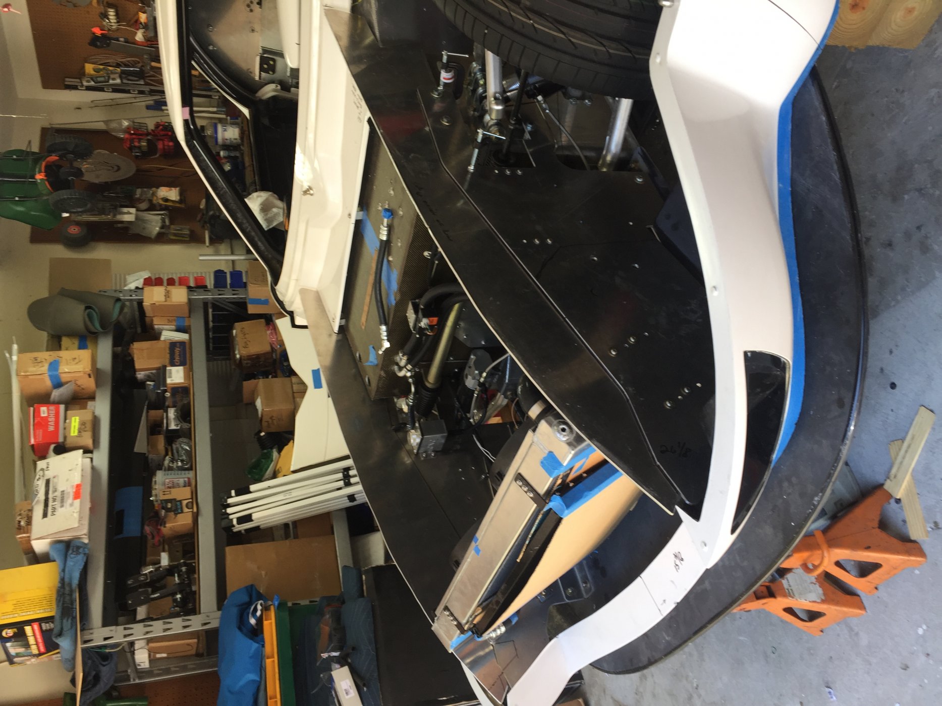

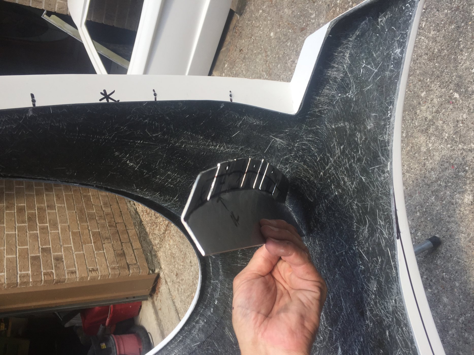

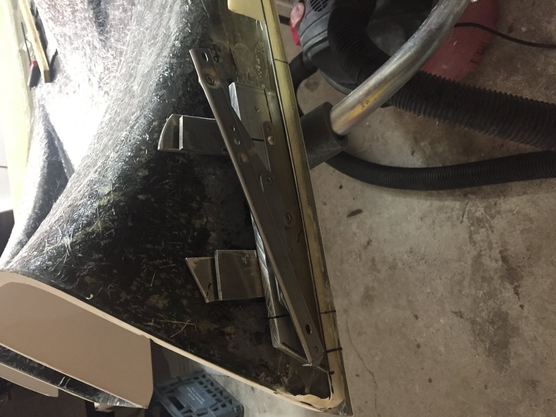

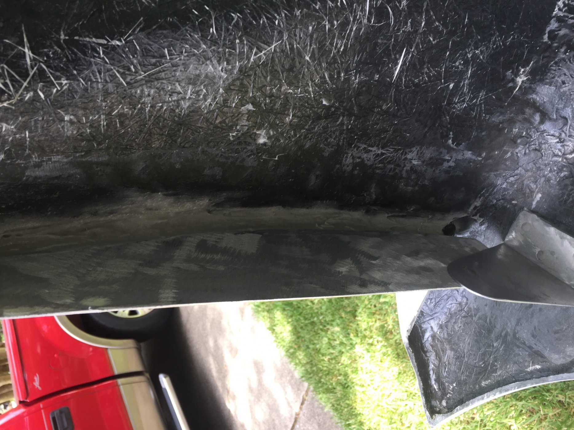

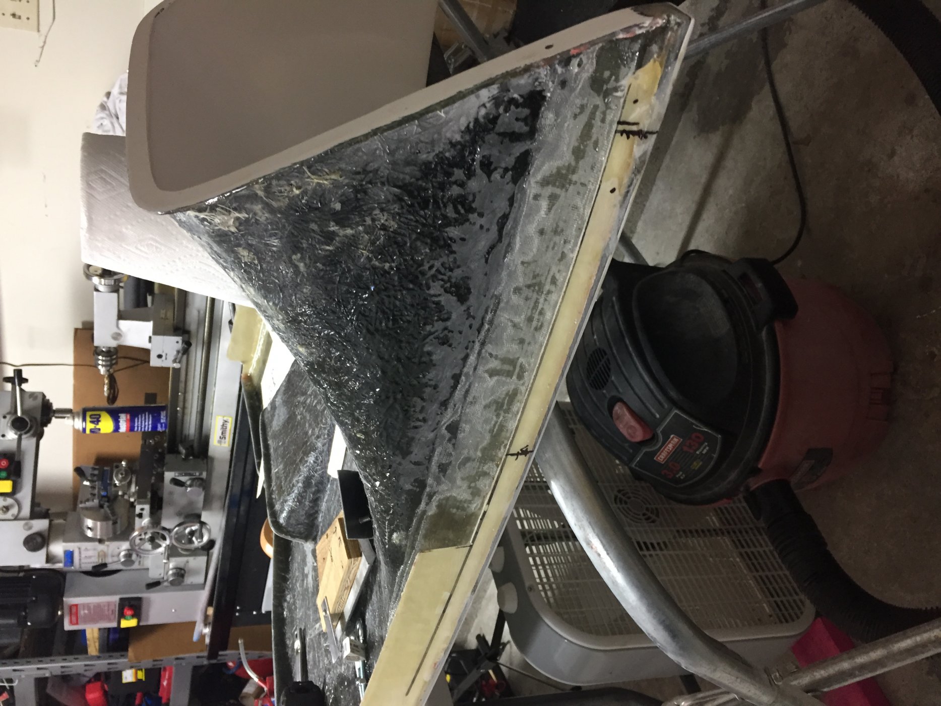

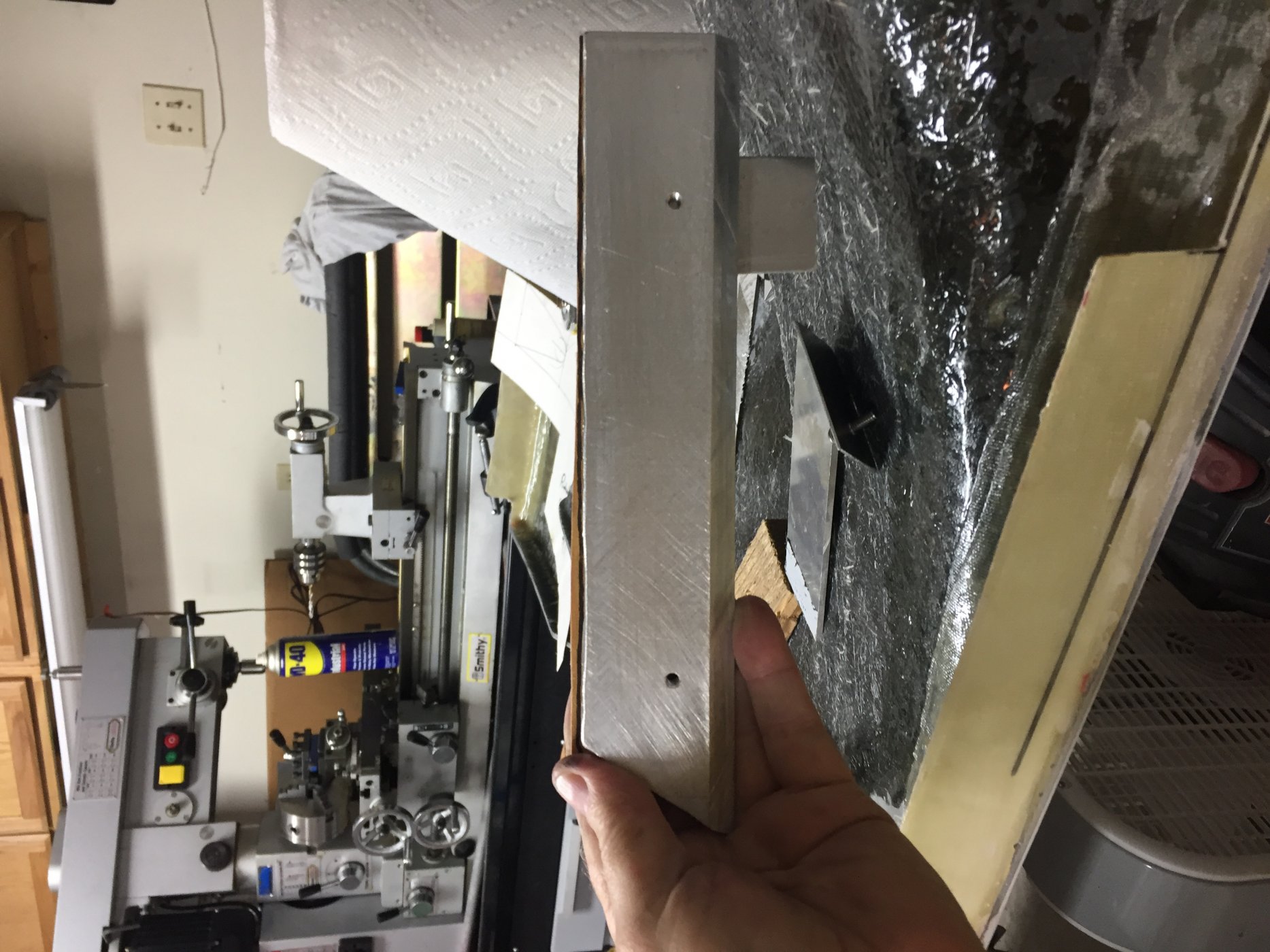

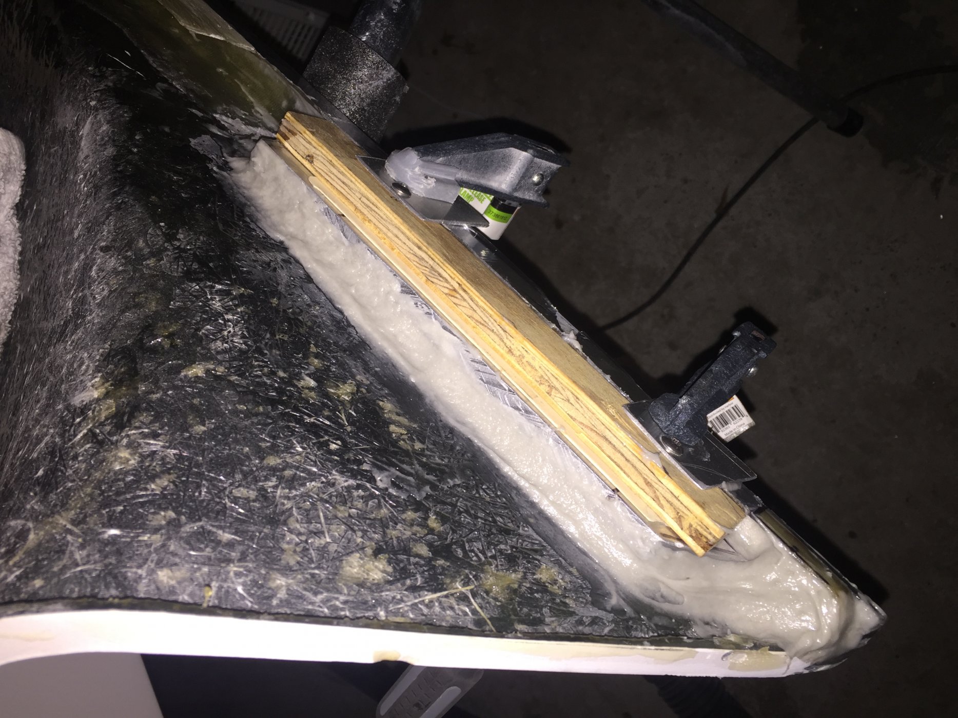

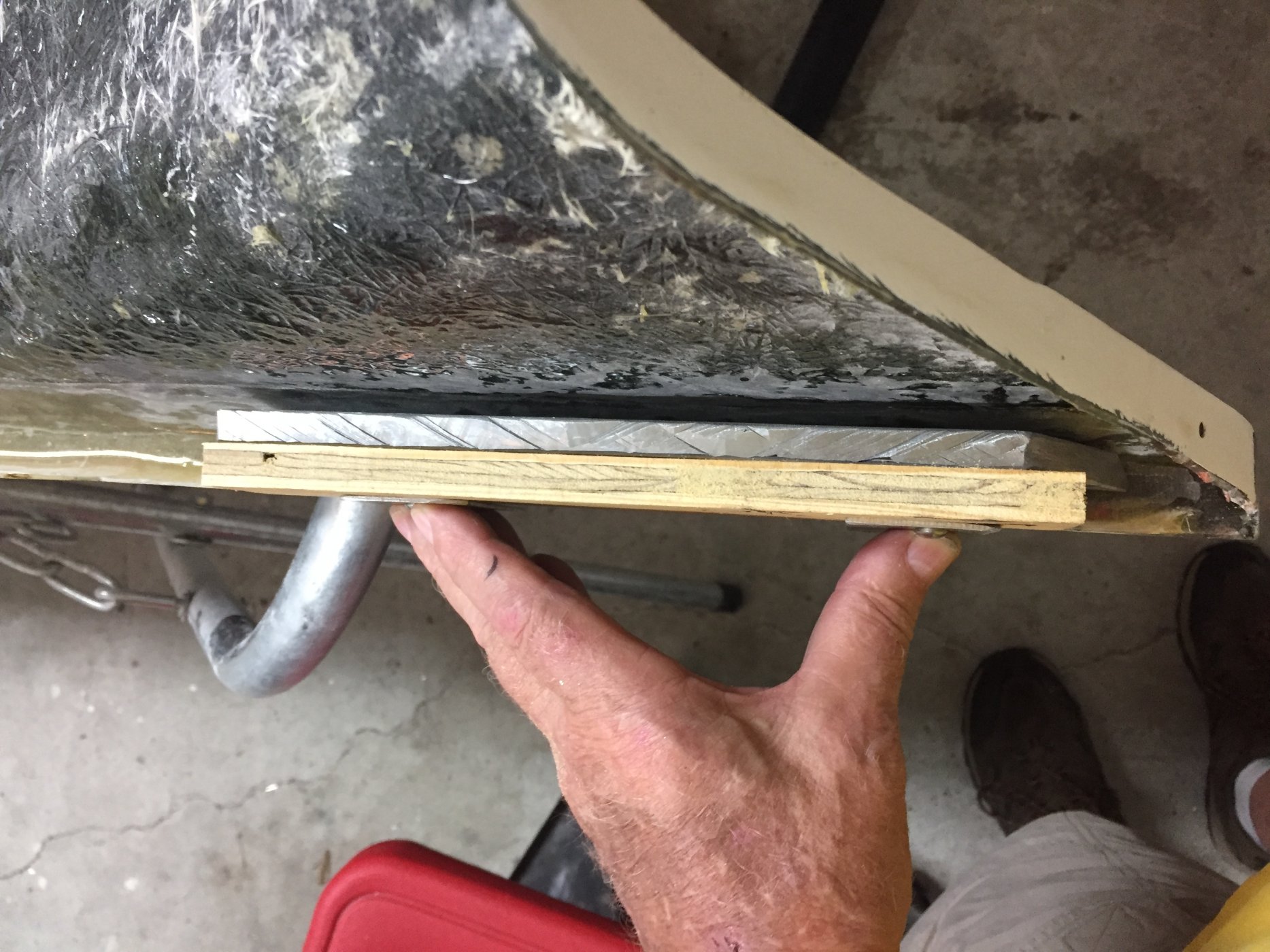

Added vertical plates in front of the door hinges to give the front clam an area to attach and also act as a seal/block in front of door. Fiber glassed plated into the front clam that will match up to the plates in front of the doors

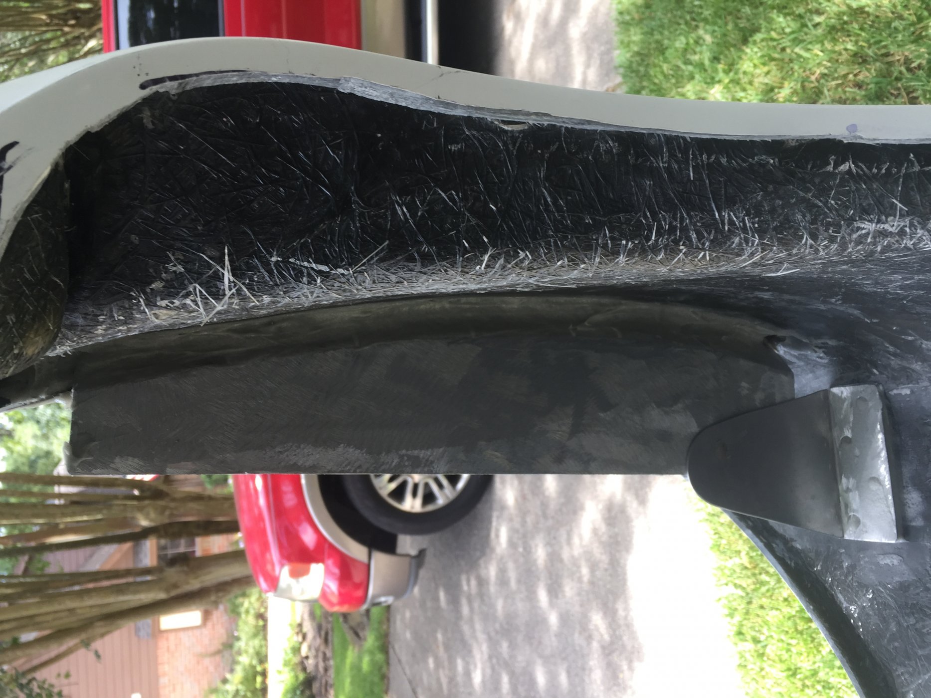

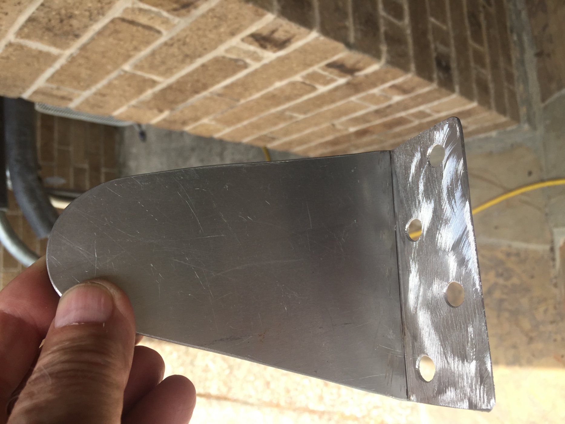

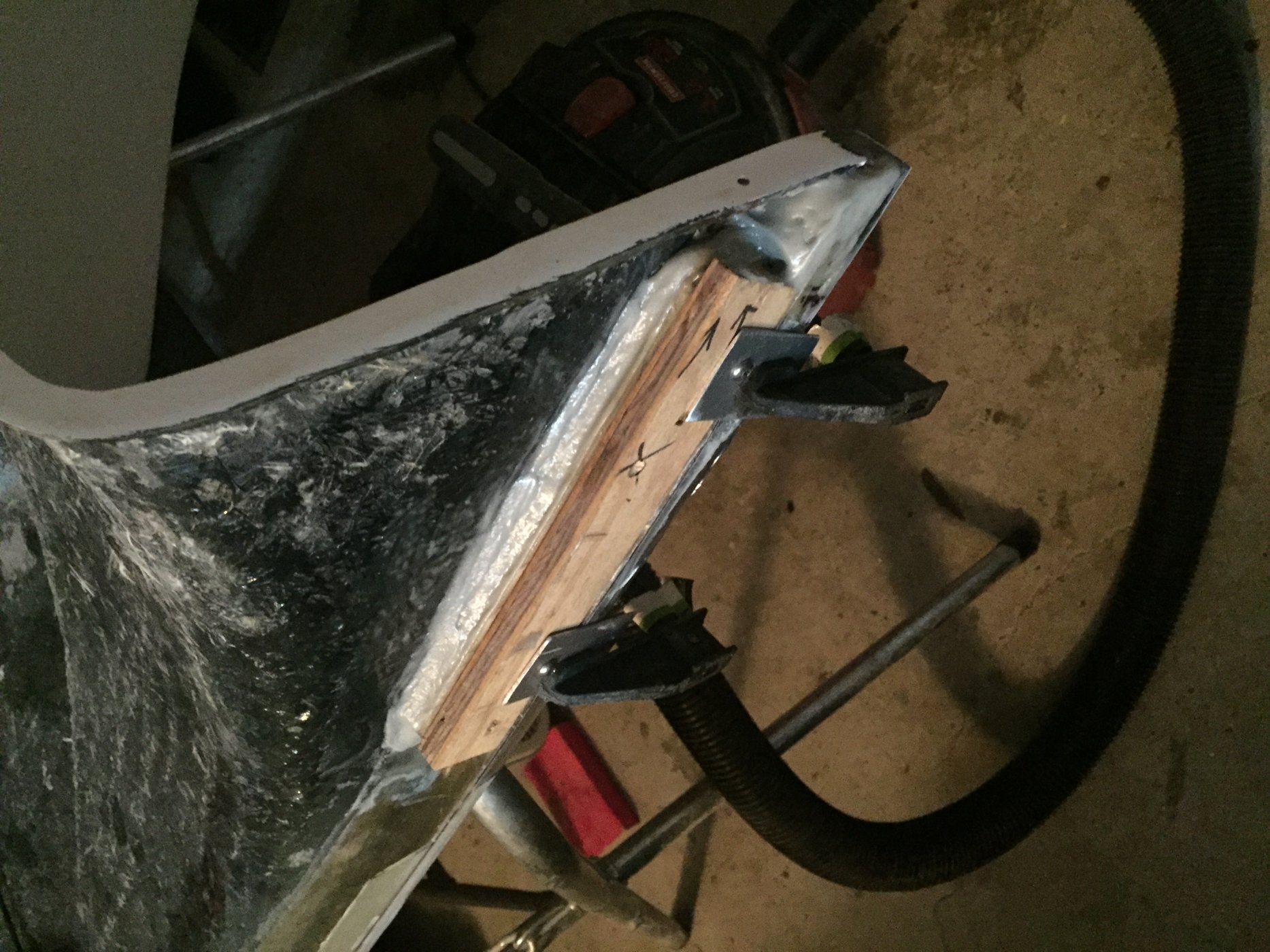

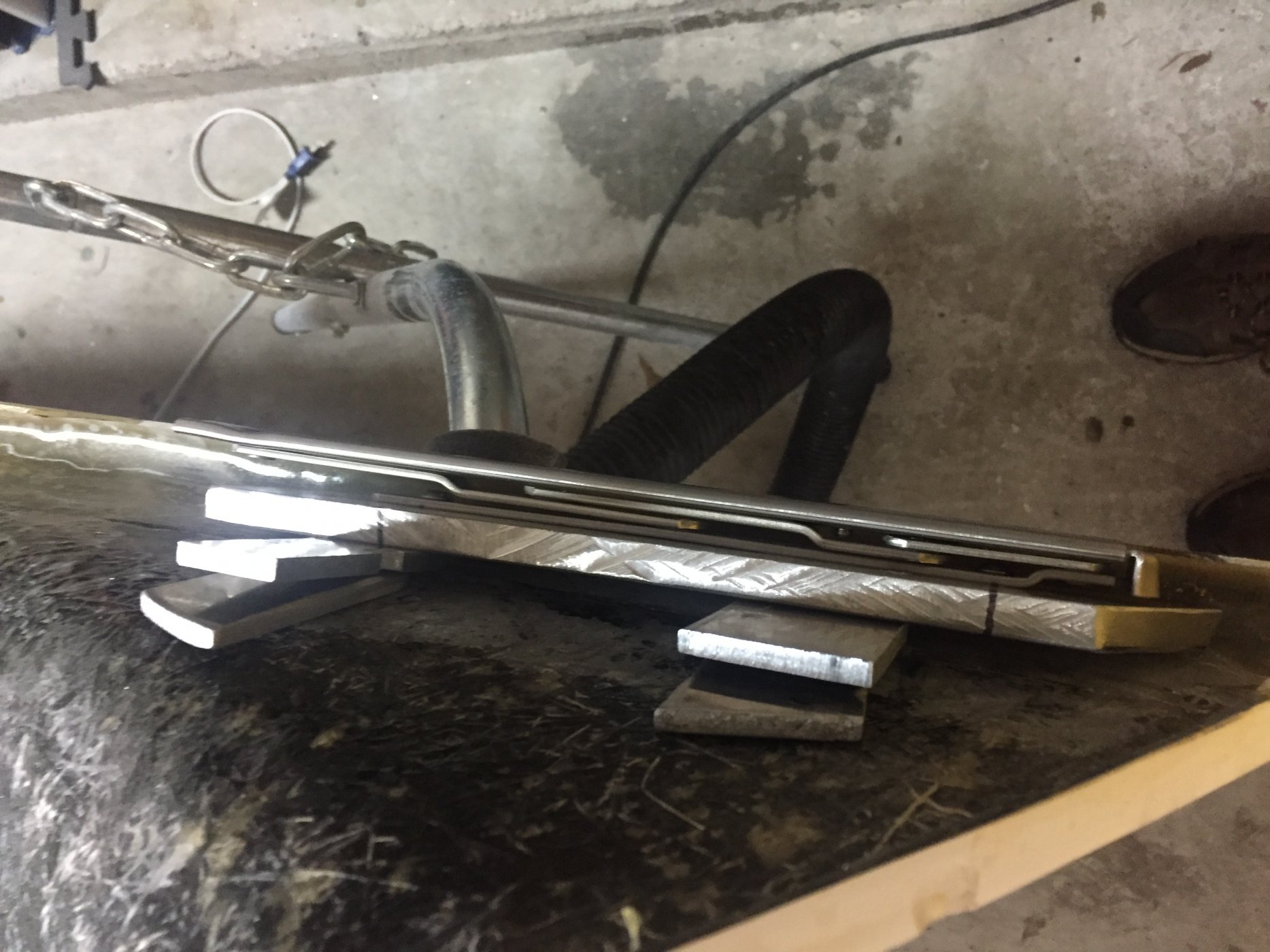

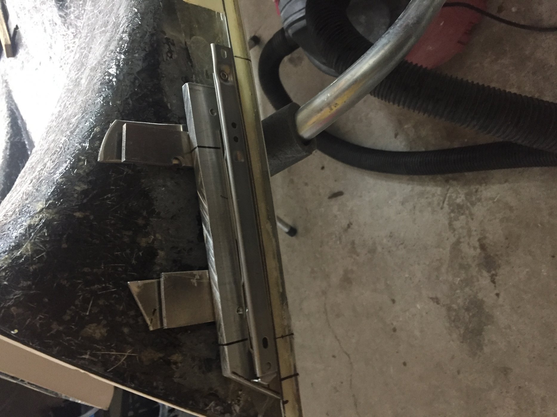

Fit the hood hinges to the hood and glassed in aluminum plates for anchor screws. Still need to clean up the glass work and then attach the hinges and fit the hood into the front clam

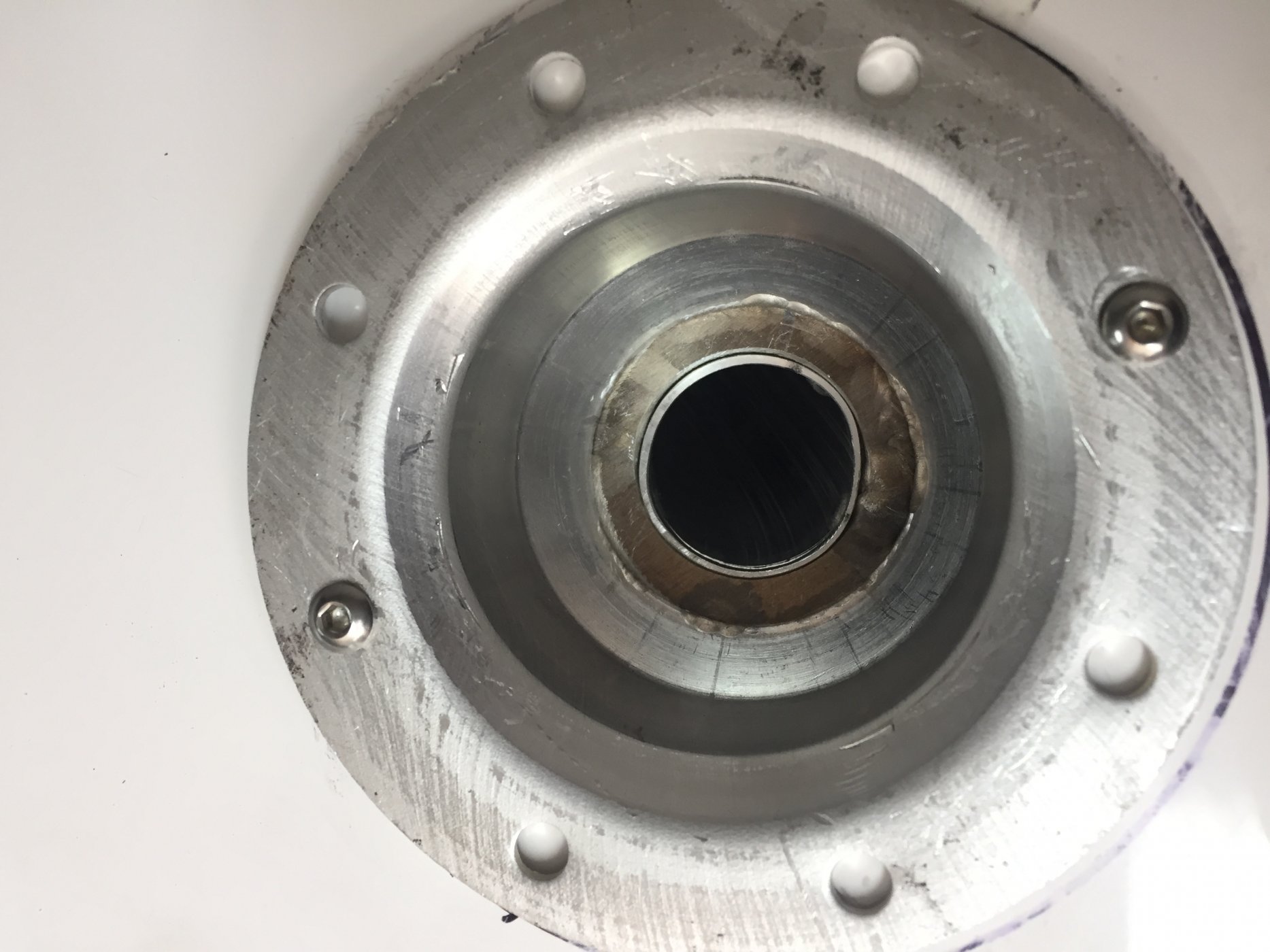

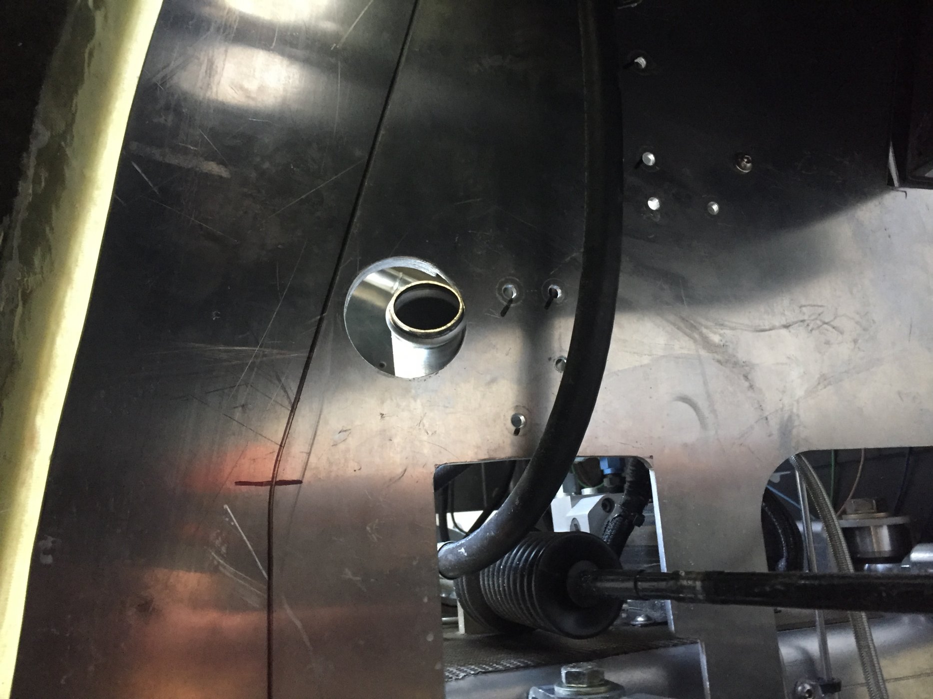

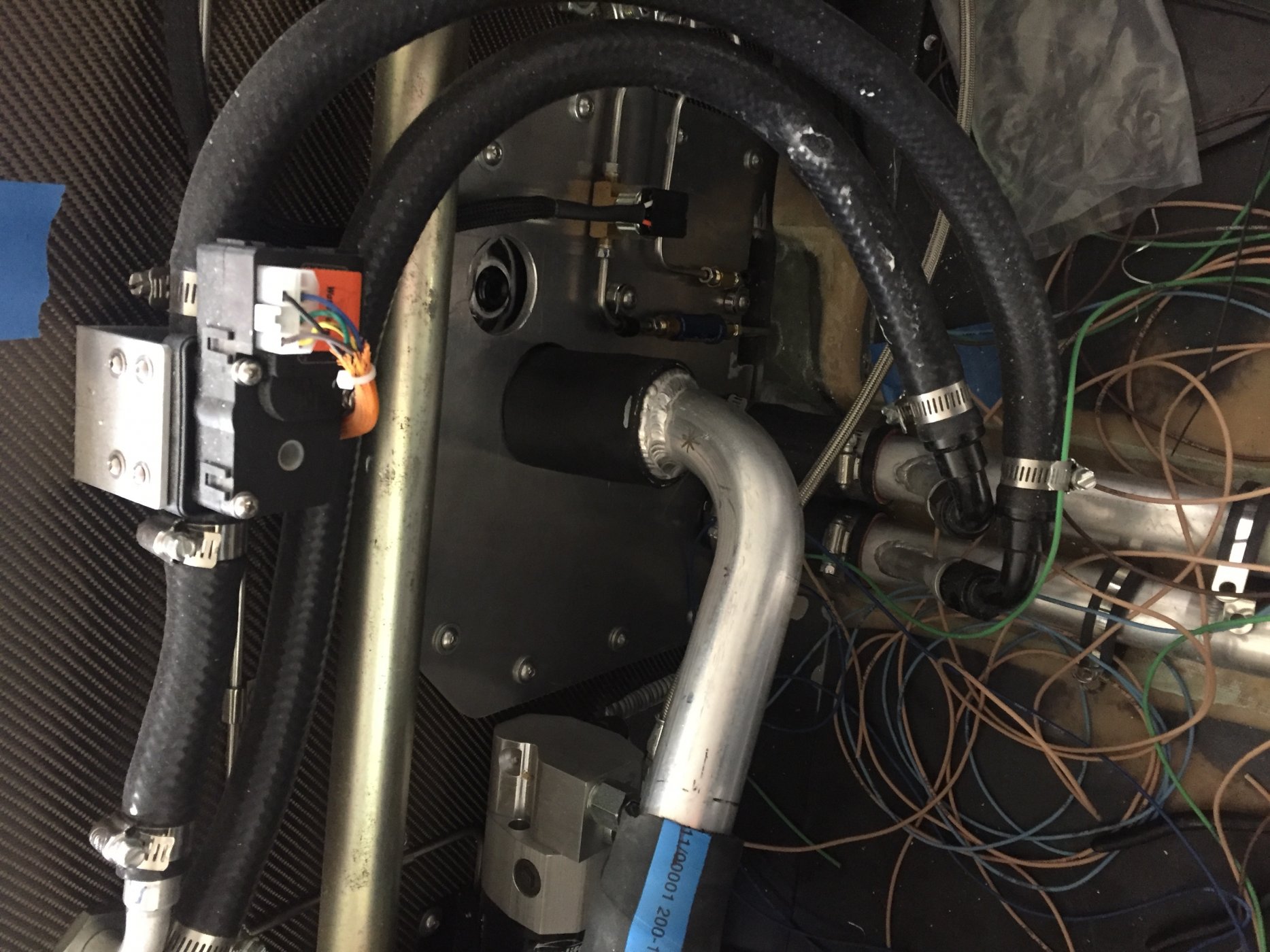

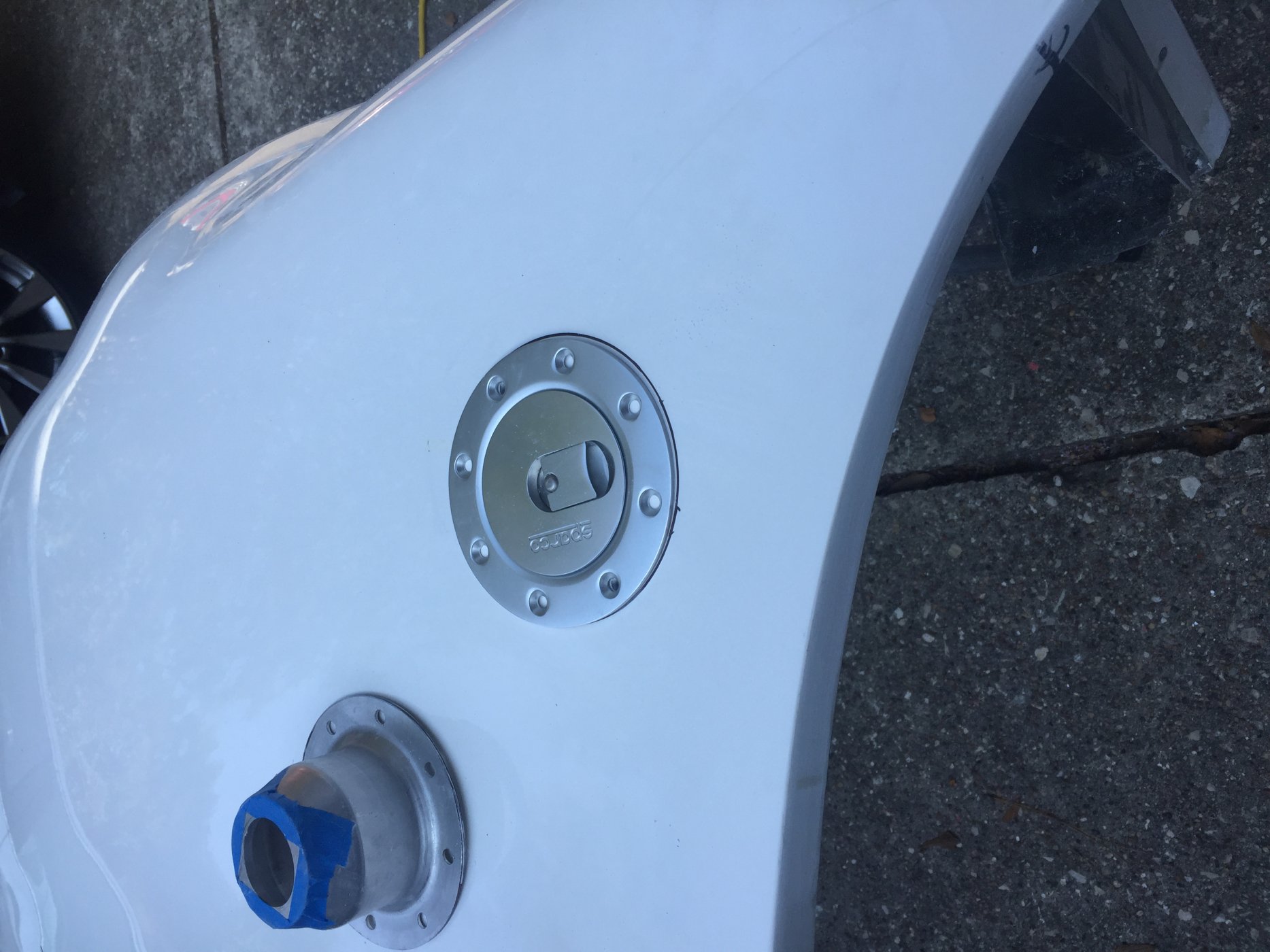

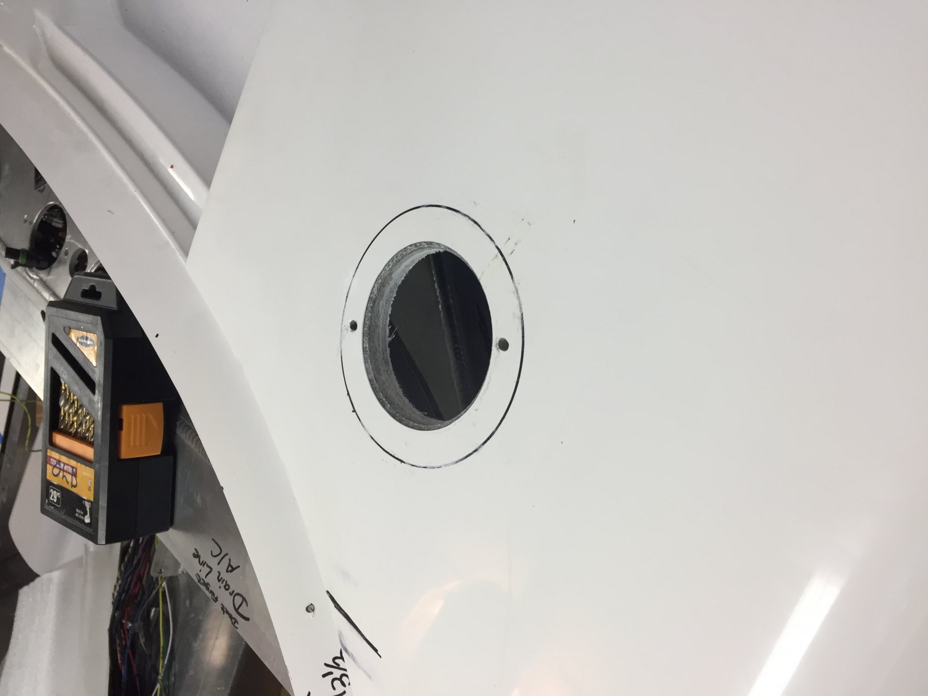

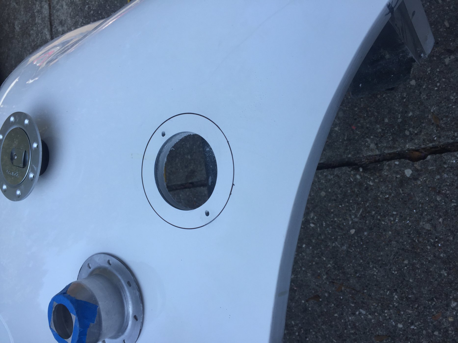

Had to relocate the fuel fill since the hood will open. Relocated to the passenger side so I can get out of the car when parked at a fuel pump. I will use the Sparko fill that came with the kit. Machined two reducers from 2" to 1-1/2: and welded them in to the fuel fill and a line to the tank. Bought some 1-1/2" aluminum tube form Speedway and rand the line to the new location. Built up the area under the new fuel fill location and will recess the fill into the clam.
