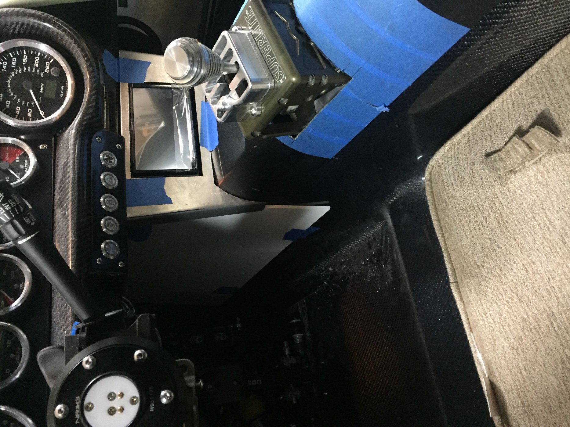

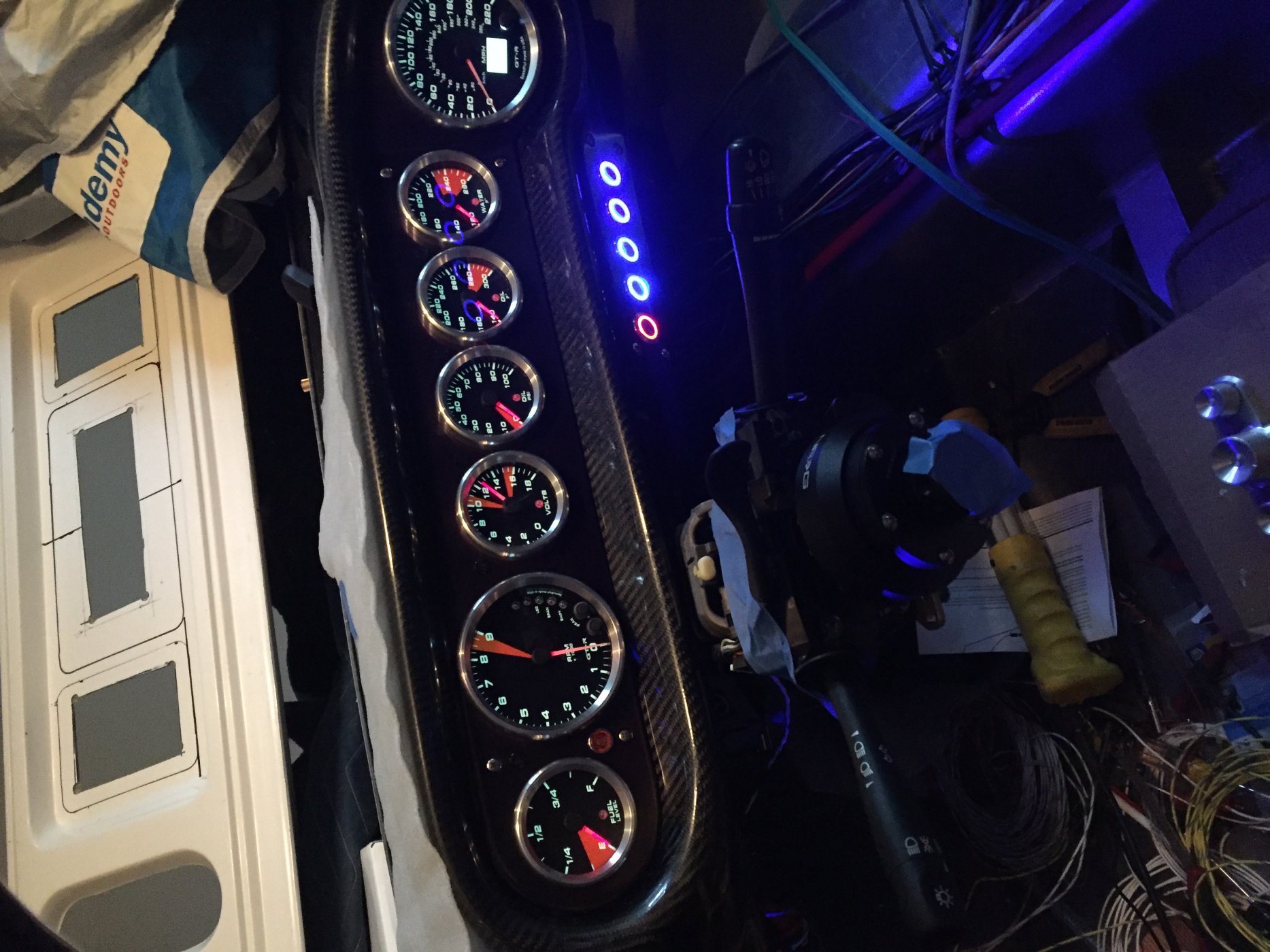

Finally finished consulting project and the car is finished except for the finish interior. Interior is scheduled for August first install. I will post a few pictures of interest.

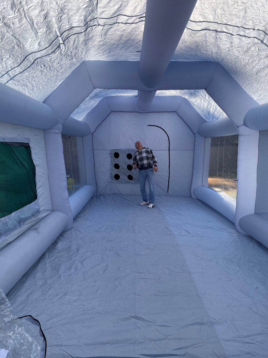

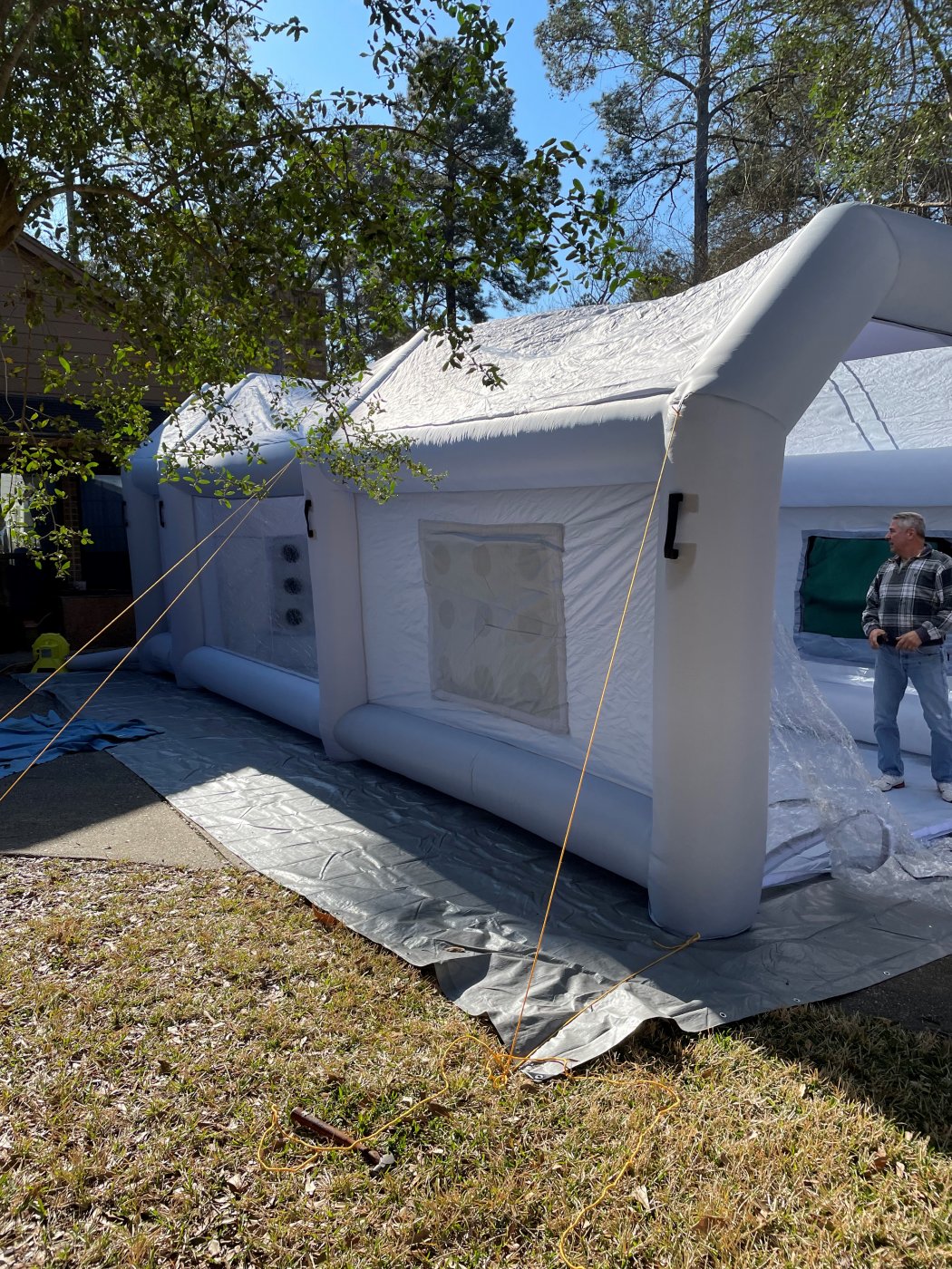

More pictures of painting in process. Bought an inflatable booth and did the work in my driveway. Had to wait on cooler weather as the heat can get too high in the booth causing problems.

Looks good! I have been planning on buying basically the same inflatable booth when I’m ready to repaint my Street Rod and C10 pickup truck. Any issues other than the greenhouse effect?

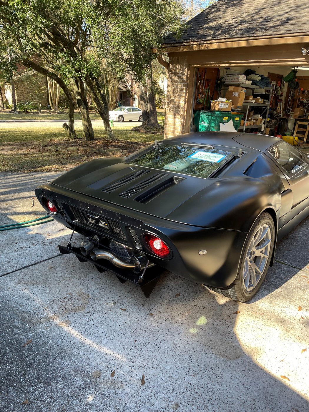

Next was to make the air intake tunnels that connect the upper clam scoops through the upper wheel well liner (from H) to the transitions. Made the transitions using a plastic container I found that worked perfectly. Bonded the wheel well liners to the rear clam after cutting holes for the air to pass through. Closed the clam and located the transitions on top of the stock Ford GT air cleaner and screwed them in place. Made cardboard patterns for the tunnels connection the wheel liner to the transitions. Made a mold to make the tunnel blanks then cut the tunnels to the patterns and bonded it all together.
Cut and bonded 3/16" AL plates to the clam where the lift struts attach to spread the load as not to distort the rear clam.
Hey Rufus,
Could you tell me where the tunnels lead to (where is the air intake that feeds into the stock air cleaner)? Thanks!
Jim B.
Hey Rufus,

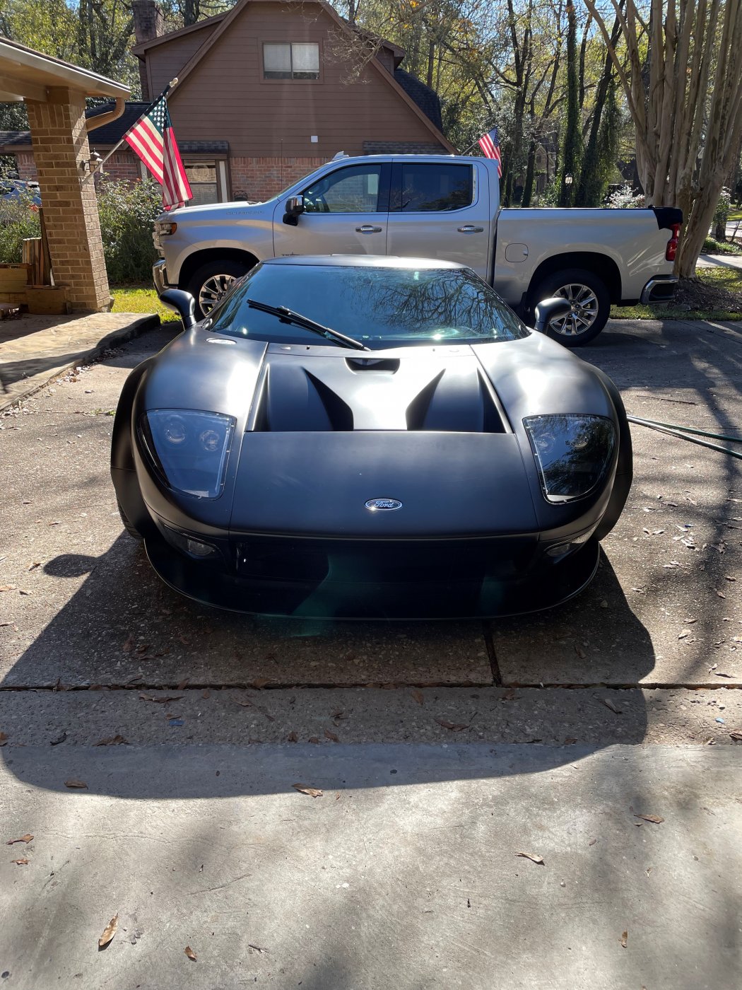

As the new owner/caretaker of Rufus' build I can say that the nostril scoops on the upper rear clamshell
