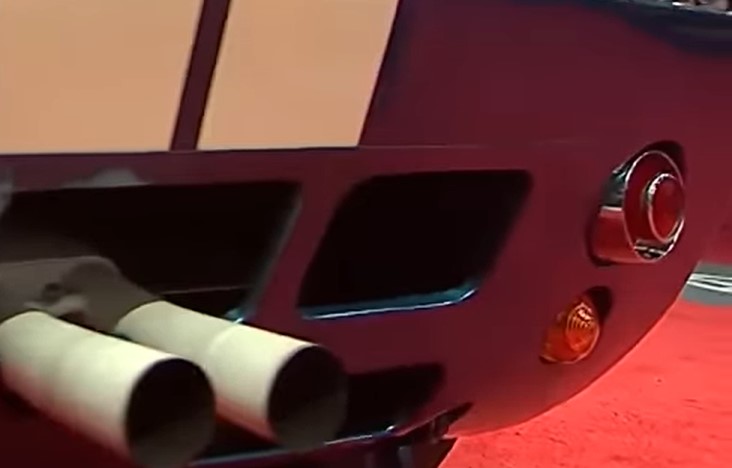

Bit of a side view showing the Merc lights.

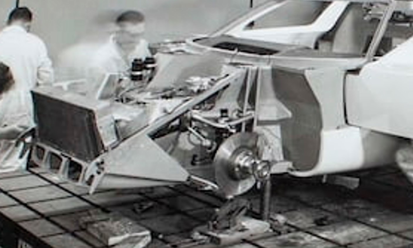

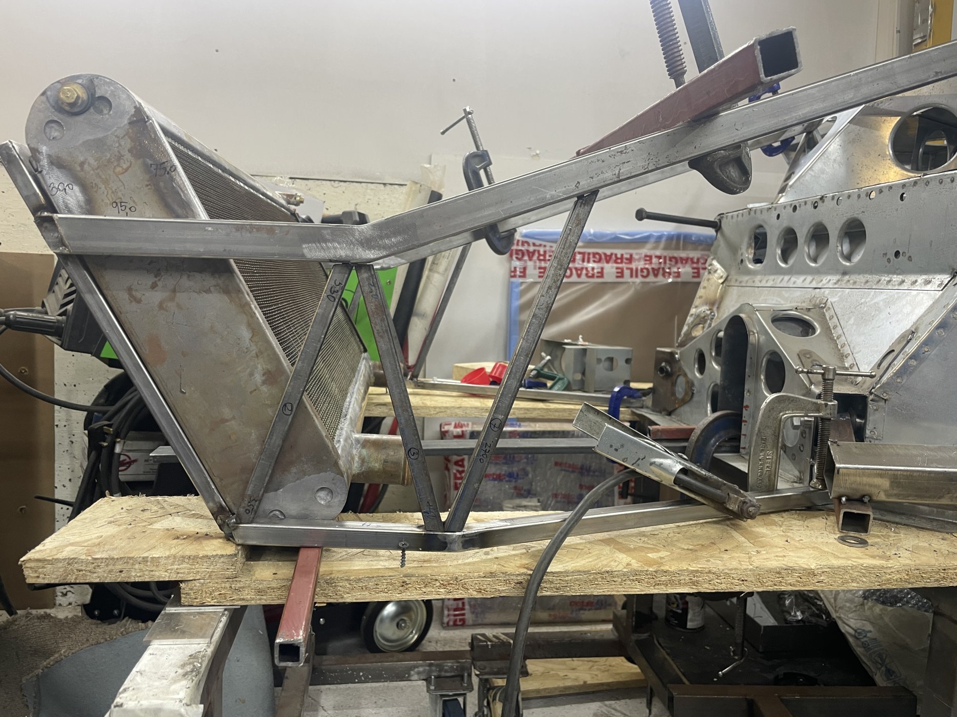

Radiator roughed in. Added the front clip hinge mounts after the discussion the other day.
Not how the radiator sits higher to allow the brake cooling ducts to run underneath.
Im still trying to work out the radiator connections on the back side. The hoses cant go out the ends like they did on the later MK I nose as the brake ducts are there.
I also think there was an oil cooler on the starboard side of the car. This style of radiator was in the car when they left FAV in the UK and landed at SAI.
Not sure if this is 104 or 103, wheels are chrome/silver where as 104 was shipped with black wheels. So i suspect this may be 103.
Car below is 104, as the mirror matches with what it has fitted. note the black wheels.
Lower outlet for the oil cooler on the end will be tight.
That's if I decide to connect it.
Still have to fix a few more details, but its getting closer.

One thing to note, the front brake cooling was re-arranged to pull heat from the radiator to help cool and preheat the brakes to keep them from cracking. That was one of the solutions they came up with since they would basically shock cool almost, and be thermo cycled so much from hard brake to long fast run amd hard braked again. By keeping them slightly warm, this cycling was prevented.
If you were to be running carbon brakes and dics this would help you brake better and lesson the overall wear.
Modern brakes have much better tempering and better heat cycling characteristics. Just a thought if you are going for true originality.
The 65 nose was a good bit shorter and the lower edge is higher.
I’m not sure if there was any way for the air exiting the radiator to get into the wheel wells.

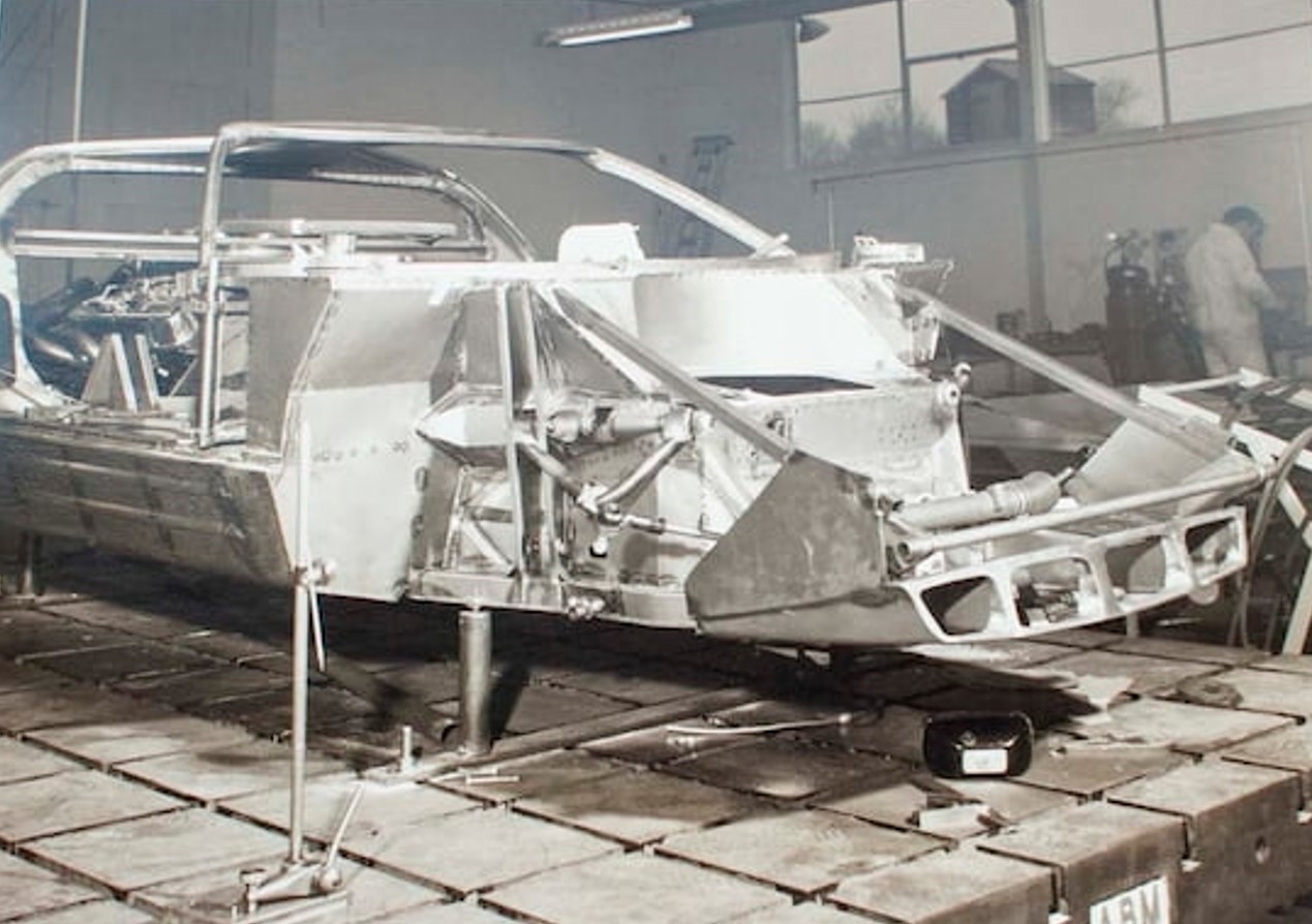

Then some more time trying to sort through the lower air dam and ducting below the radiator. Many hours going between photos trying to find the right angles. I think just about all of these parts pictured below have been changed in some way since the post on the 2nd of June
you can see that the brake ducting still does not line up 100%, so there was obviously a difference between the early P chassis 1000 to 1005 that had the triangular lower ducts and that which was on 103.
P1005 on the right, not sure which car is on the left.
I am still trying to confirm the radiator dimensions. It is of a different design to the standard MK I unit. It has an oil cooler on the starboard side of the construction.
It is also located closer to the front axle centre line. Not I don’t have the horizontal section of tube that the typical MK I front end has. So it’s around 4” rearwards of where yours is Morten. This should also allow a bit more height.

The vertical rear suspension pickups are still square/straight. I do notice that they continue down too but do not pierce the lower chassis reinforcement that forms the perimeter of the front floor. Some of the later prototype chassis certainly had these parts go all the way through the outer box section. Not sure if they needed extra clearance for a suspension modification or test.
Dry sump tank is still in the nose.
You can see the oval shaped hole through the B pillar in the first photos, but none of the ventilation ducting on the front of the chassis.
The forward section of the brake ducts in the lower nose section appears to be inverted in comparison to what was done on 103 and 104.
