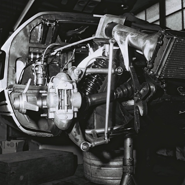

Thanks James, how does the release rod get installed up into the roof section so that you can release it from the small rectangular hole in the center of the rear of the roof?
I can see the rod coming down and entering the side of the slam catch in this photo.
Also note the rear accelerator cable attachment, the braded heat shield, the slight downward bend in the end of tray above the intakes, and the marks in the white stripe on the roof return as well as the dings in the flanges and slam catch mounts.
Trying to work out if this is 104 or 103.

Ryan,
Look at the rear engine side of the B-pillar above the window and you will see the rod traversing the top between the two haunches and at the same time the "T" handle poking through the roof hole.
The rear of P1036 on Concept Cars.com has a good photo illustration. FYI - incidentally it was Fran Kress's car.

Time to work out the details for the rear body work mounting frame. So collecting all the photos into an appropriate folder so i can flick through them easily with less noise and I see this one.
Some good details of the rear body mounts of what I think is 104.
Then in the background I notice the release rod for the slam catches poking out.
The keg under the car and the damaged paint work in the white stripe seems to match it to 104.

Just noticed the quick release for the brake pads as well. Same style as used on the 4 piston callipers on 1046, only this is the single piston version on the rear of GT104!
Also the eccentric mounting of the ring where the rear clip sits. I assume the nut was loosened and the rear clam shell adjusted and then the nut snugged up to hold the position.

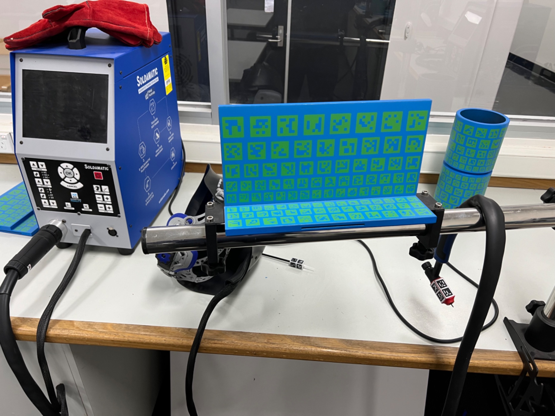

As mentioned in one of the other threads. I have enrolled in a Tig welding introduction course. This is the Augmented reality training rig that they start us on. Probably saved me from having to grind a number of tungsten rods

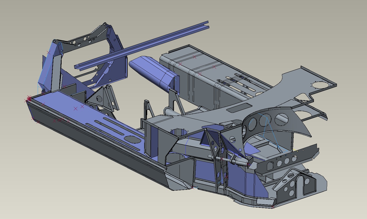

I am in the process of putting together a model similar to yours. I am working from the 170 sheet FAV drawings, which I believe you said you were working from. I know I will be able to fill in gaps for some of the missing parts but it looks like you have more reference material.
There are some copies of GT40 uncovered (which I think you also implied you had) on ebay for £600-700 which I am happy to pay but as I don't really know what excerpts of drawings are included I'm not sure whether I should take the plunge.
Are you able to tell me if there is enough extra information in the book to to fill enough gaps that would allow me to model a similar amount of components as yourself?

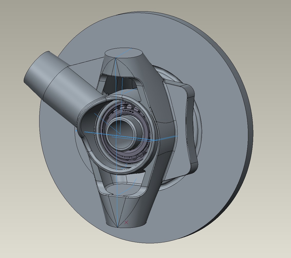

I took the plunge and purchased the book, I guess I was hoping for a few more chassis component drawings than there are but I was able to work out the inner and outer fuel tank panels from the assembly drawing by scaling dimensions etc and there was an extra drawing for the rear hoop that I didn't have. It also helps with lots of suspension bits (see front upright assy)
Still plenty to model, and I think I can extrapolate many of the missing components.
As I said I have the pack of circa 170 drawings, but I have seen mention of a pack of about 250 which I'm really struggling to get my hands on (happy to pay if anyone does have them).

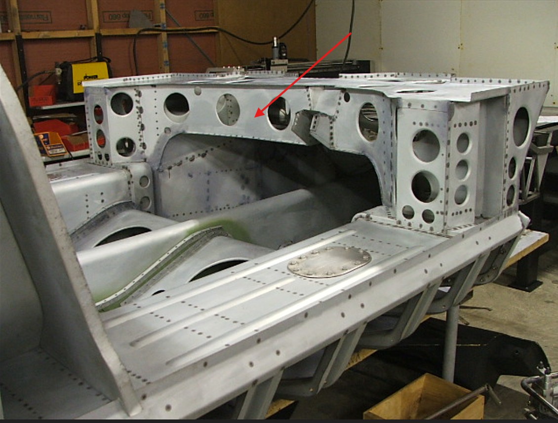

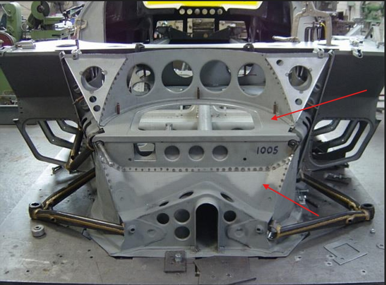

Main components I am missing at the moment (which will be difficult to extrapolate) - some parts arrowed on images:
Dash panel(s)
Steering column mount panels
Front bulkhead/toe board
All panels under dash/above legs
All of the seat back/main roll hoop/B pillar/roof spider
If anyone could help with drawings it would be a major help
