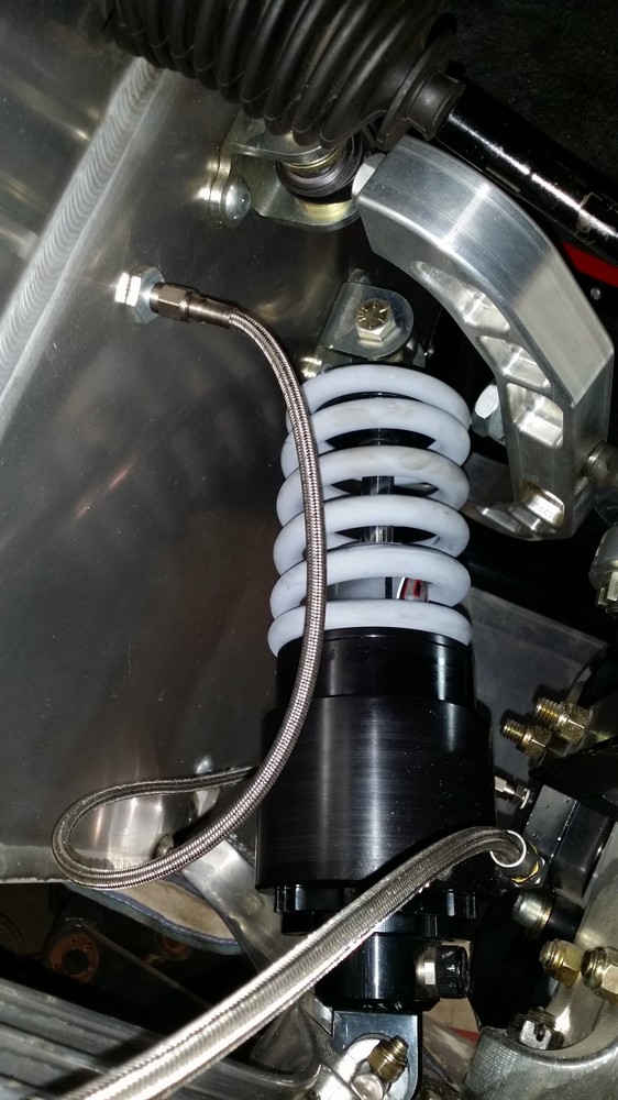

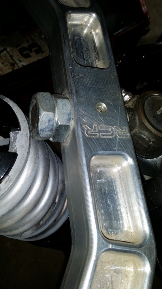

Not an SLC, but my P4, I believe had standard suspension, and this lift kit was added later. But I think when this happened, a shorter spring was not installed. Shouldn't a 1" or 2" shorter spring have been installed? Here are a couple photos, note that at full lift, the control arm actually hits the coil, this is because the spring is too tall? What spring height/rate needs to be used?
Thanks!

you should use a 4 inch spring with 400lb depending upon your use, to get the lift without compressing the spring and stressing the shock.
Available from Eibach or Hypercoil.
With a few mods to the bottom coil perch (basically drops the spring down a further 1" to provide more room between the lower and upper perches for all this kit) and following Fran's recommendations on the spring and extended shock travel you should be able to fit the lift on the sprung side like my RCR40. Its all close but there is clearance to the lift ram.
I would recommend the use of a helper spring so that it all stays together at full extension.
I have obviously inverted the shock as well, further reducing the unsprung mass. All done I was very happy that the RCR design allowed this configuration on the RCR40. It may be easier on the SLC as there appears to be more room all round.
