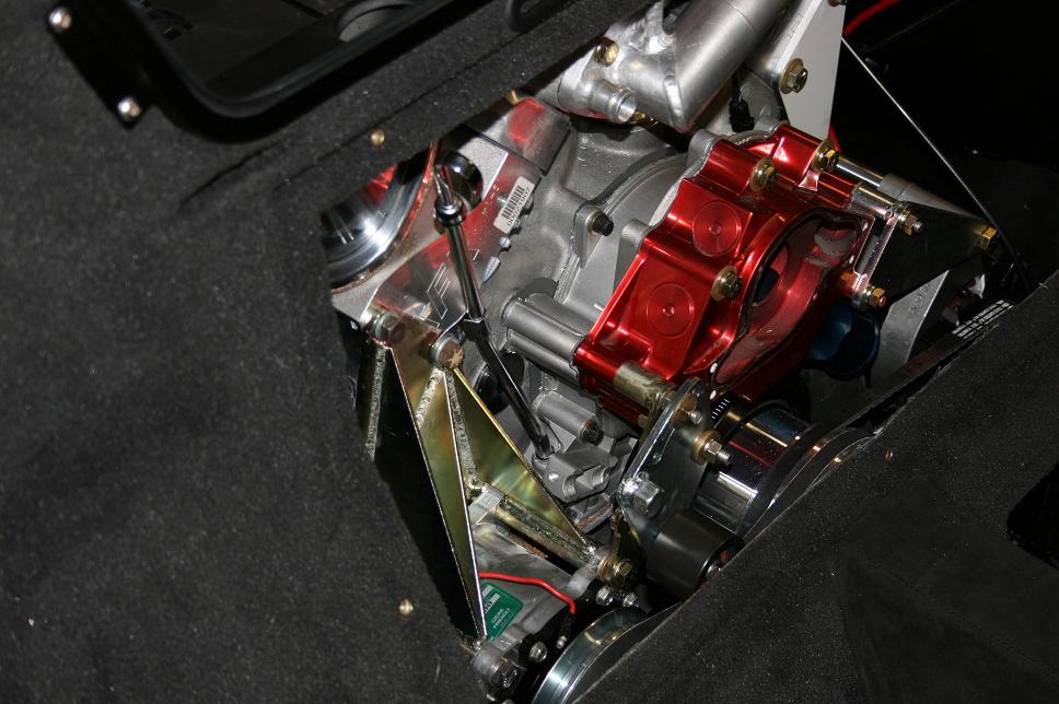

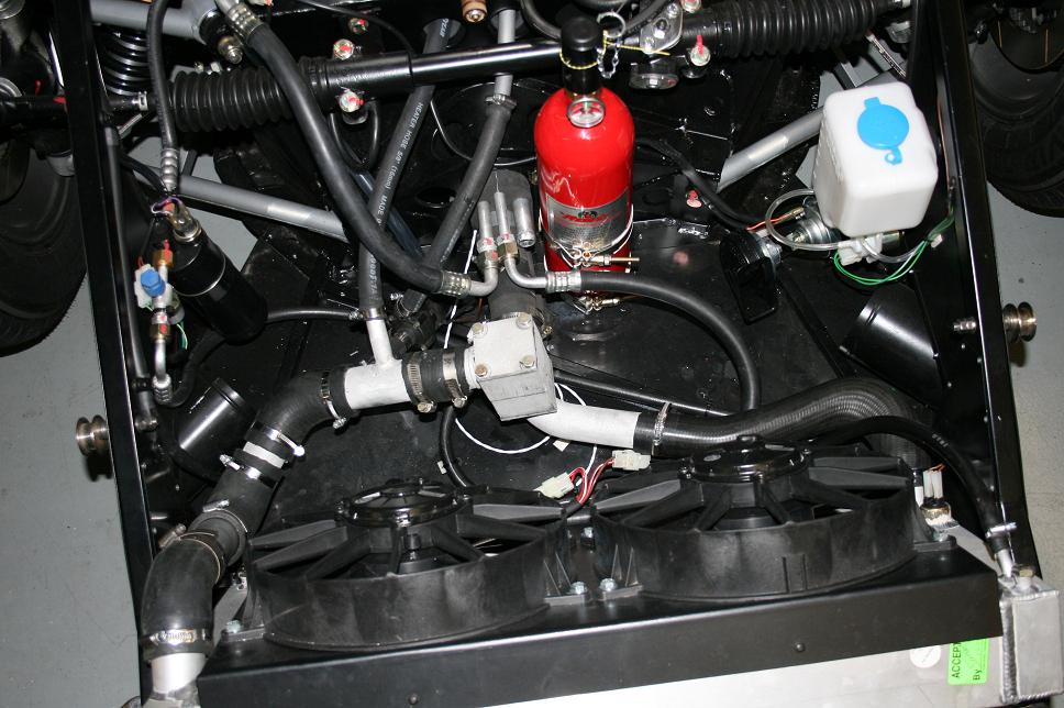

I had the same problem that the off the shelf bypass thermostats housing is pointed in the wrong direction so I milled my own housing, I run a 185 F bypass with a Meziere 55 GPM block mounted electric pump, I think that it a 35 GPM plump would have worked perfect and the 55 was overkill. You will be very happy with the results.
