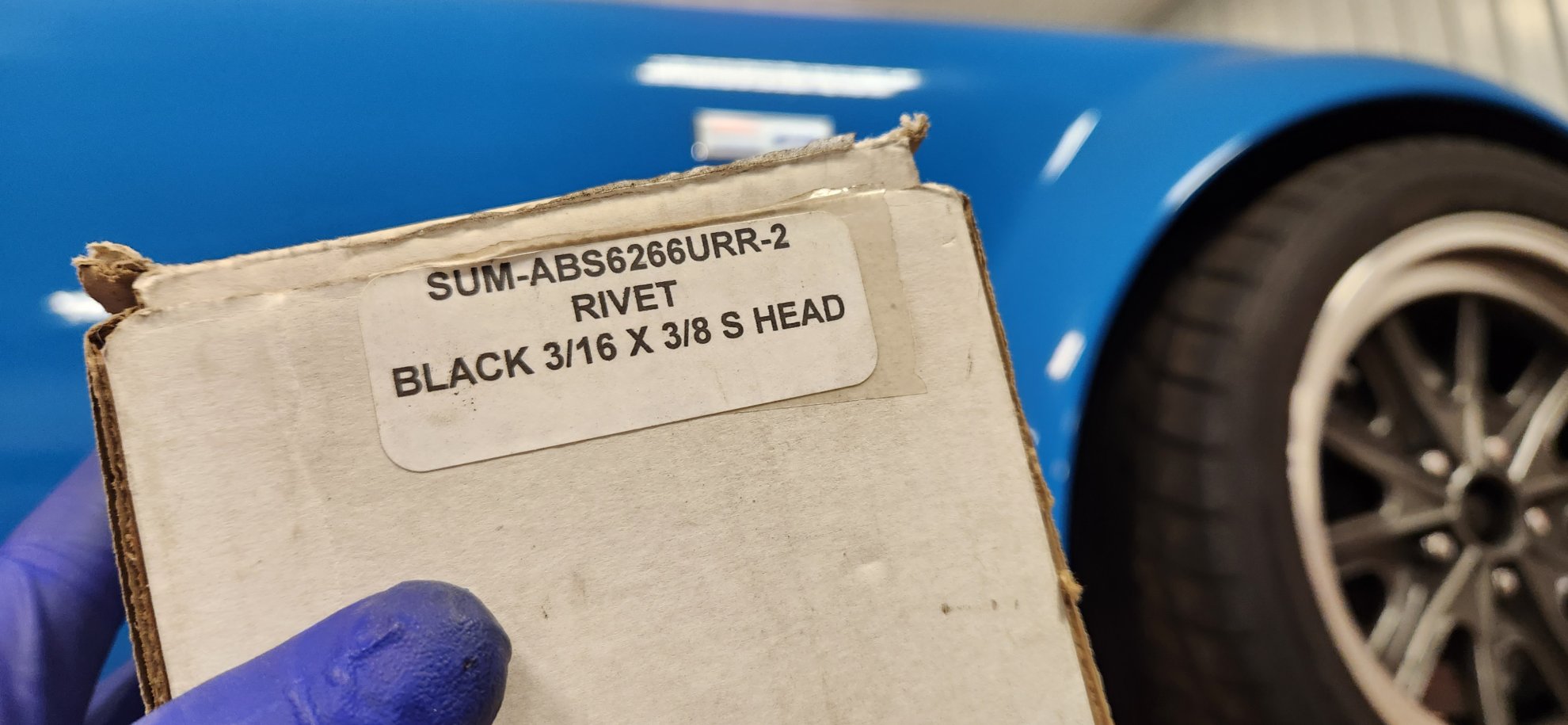

I used aluminum 1/8" diameter rivets for that. Aluminum rivets drill out for removal really easily. They are cheaper and lighter than stainless steel screws, will not loosen when installed correctly, and have no worries about stripping threads in the parent material. I like to use them for things that in most cases will never be removed but just might need to be disassembled due to some unforeseen reason. Perfect for brake lines, water lines, fuel lines, and other tubing held in place with 'p' clips.
Ken Roberts
I use solid sealing aluminum rivets. I didn’t want galvanic corrosion since these fasteners are in contact with water and the frame is aluminum.

The rivet body falls back into the tubing then there is an expanding wax spray to shoot in the hole. This encapsulates the rivet body to stop it from rattling around. ;)
