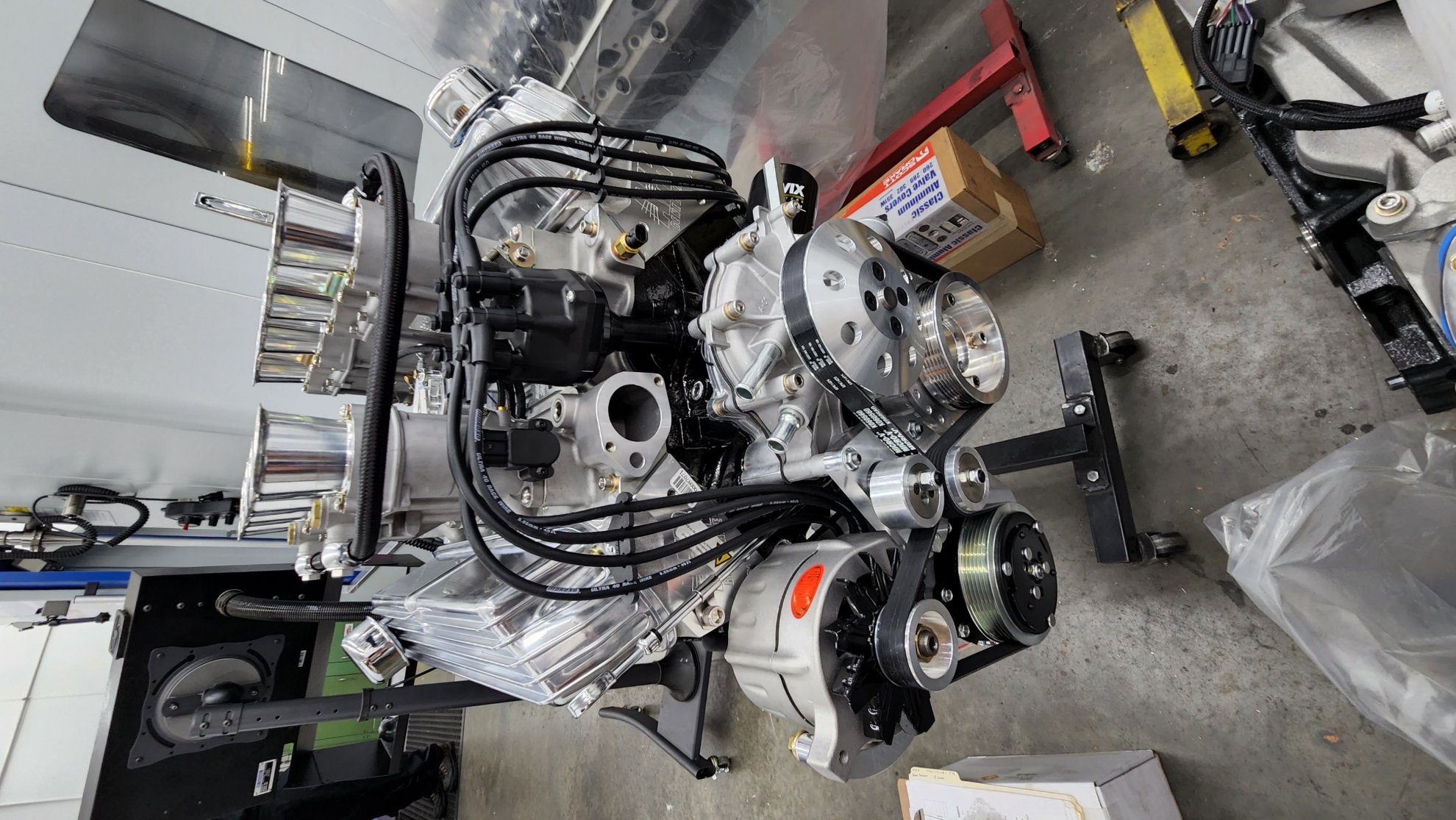

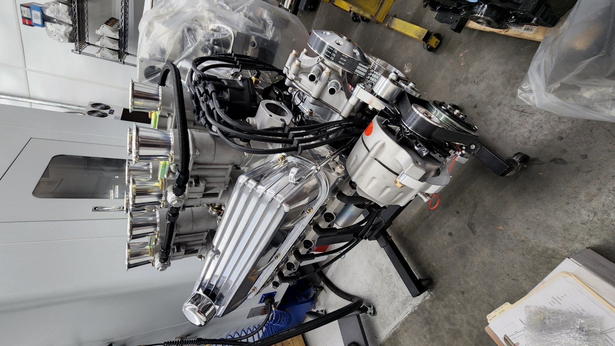

I have a Prestige 351W with the 8 stack Borla in my SPF MK1, which was built by Prestige Motorsports. If you haven’t yet spoken with Doug, I suggest doing so. He sent me a very detailed proposal listing all of the part numbers, based on his recommendations, along with a price for each part.

I have a Prestige 351W with the 8 stack Borla in my SPF MK1, which was built by Prestige Motorsports. If you haven’t yet spoken with Doug, I suggest doing so. He sent me a very detailed proposal listing all of the part numbers, based on his recommendations, along with a price for each part.View attachment 130394
What i am being told by prestige is they dont supply the front end for the 351 that is for RCR 40. My question is why wouldn't your set up fit the RCR 40? I am missing something. Im guessing its something to do with the space of the firewall or a height issue.
Correct,the system prestige has DOES NOT fit the RCR but I’m sure someone will chime in with what you need. I’m running the prestige front end in my 40 aswell. I have an all aluminum Shelby 427w from prestige.

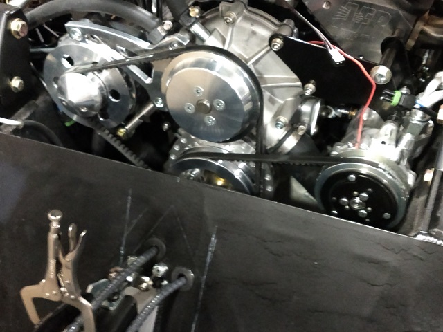

Problem is that with A/C, the compressor needs to be on the opposite side of the engine from the alternator. Prestige's serpentine system has the compressor tucked underneath the alternator and won't fit in the RCR chassis. I used a v-belt system with alternator, waterpump & crankshaft pulleys supplied by CVF Racing. They can supply you with a kit that has everything you need except a compressor mounting bracket. I used the one supplied by RCR. Some guys on the forum have made their own.
HTH, Rod
Thank you This is the way I will go found it on CVF
