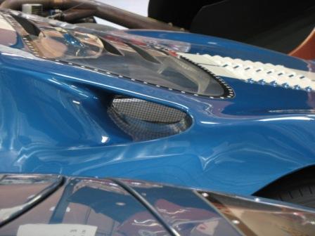

1. The air intake vents on the Mark I for the engine air had screens on the inside edge. On one care it was fine mesh, on the other is was a coarse mesh. Rather than attempting to put air filters on top of each of those Weber carbs, why not put filter material on the inside of the air intake vent? One would need a good seal between the cold box and the clip, but perhaps this would avoid the problems with the air – fuel mixture that air filters on the Weber’s cause.

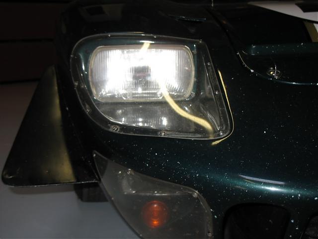

3. We seem to obsess with installing the headlights and driving lights without any screws showing from the outside. In fact on one car the headlights had two screw plainly visible on the upper left and right side of the lamps and on another four screws were visible in each corner of the light. The driving lights also have screws visible on either side.
4. On several cars the headlight and driving lamp covers were held in place with rivets. Others used small silver colored phillips type screws. There did not appear to any real consistency in the number of screws or rivets from once car to another. Same for the fasteners used to hold the side windows in place.

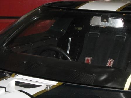

5. Two of the GT 40s have “Simpson” style harnesses.

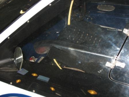

6. Here is an interesting detail. We have all seen the fender mounted rear view mirrors. I was not aware, however, that rear view mirrors were mounted inside on the forward portion of the door.

Many of those details such as harnesses and mirror are "post factory" additions. The GT40s were always in a state of flux and many have had "improvements" added since first built.
The headlamps always had exposed screws to retain them and yes, the fasteners for the lenses and side windows vary greatly from car to car.

About the Simpson seat belts....many of the cars are still driven (raced) and of course will need a current race certifed safety restraint. It is a great set up they have there. Located off the diagional highway at Twin Lakes. Only open on Saturday as I remember.
I had the same thought for my Mk II but for a different reason: to be able to run "correct" clear plastic velocity stacks on my 4 bbls. I don't think it would be particularly difficult to mount air filters and seal the window tray with some properly deployed soft foam. The issue I haven't resolved to my satisfaction is how to periodically test the whole setup to make sure a dust-carrying leak had not developed.
Hmmm.... white fly-paper to capture and exhibit dust? :huh:
