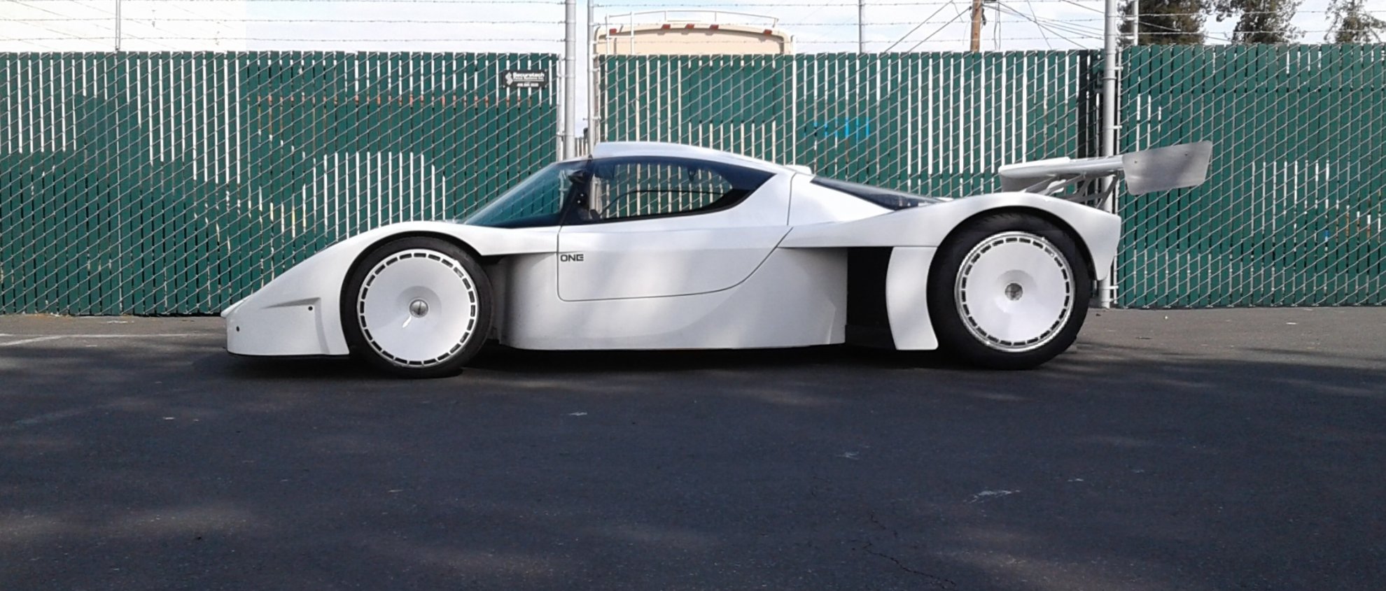

TBH Mesa - I HATE that wheel style .. but for whatever reason it looks really good on your car! Gives it a weirdly retro-futuristic look, something that would fit well in Back to the Future 2.

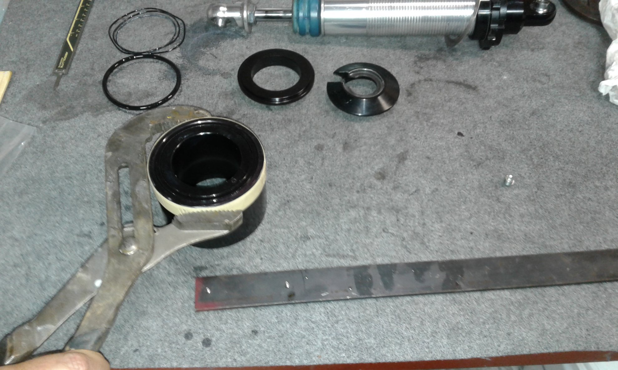

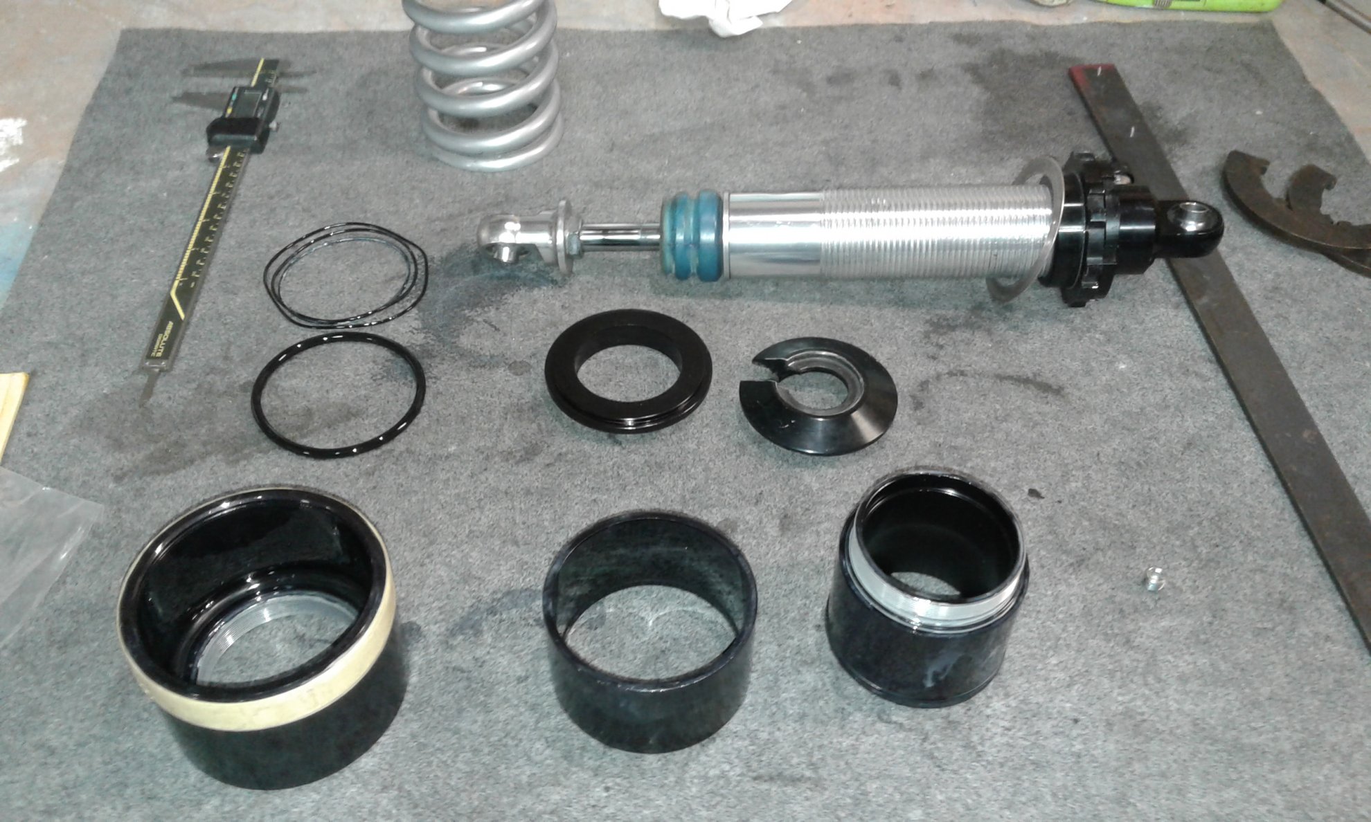

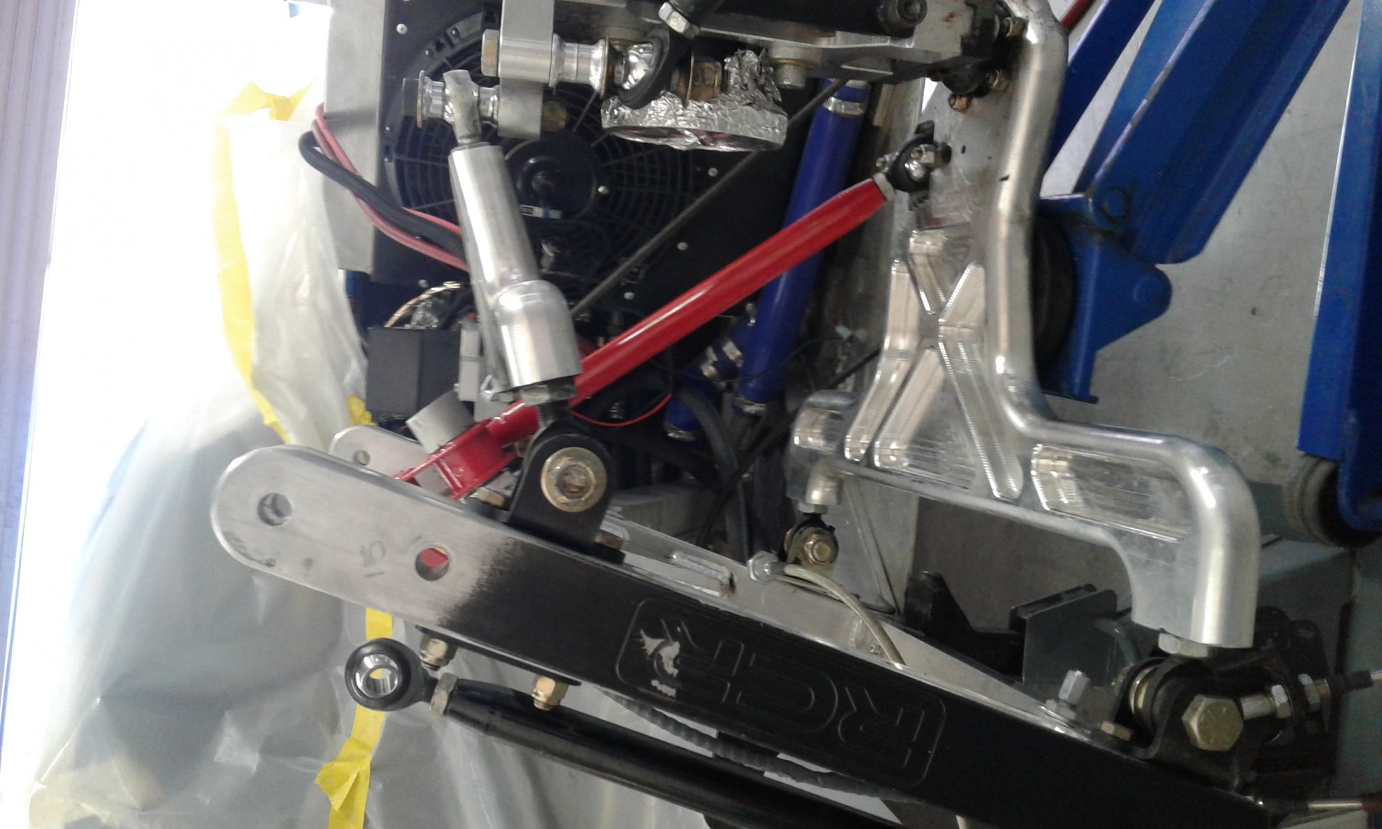

The front lift cylinders were leaking pretty good when the car was in the up position for any length of time. A call to Ram Lift procured a rebuild 'kit' of the four needed seals. Somehow I felt the need to run around local tool supply stores to see if a proper tool could be found which would facilitate removal of the inner retaining ring. After a few fruitless hours :rolleyes: I resolved to just make the damn thing, fortunately I had some 4-40 screws and the proper tap to do just that. Since the vice at hand was not large enough to hold the cylinder, channel locks were employed to keep the unit from spinning during disassembly. Masking tape was rapped around the body for protection. Once it was apart it took five minutes to remove and install the seals with another ten minutes to reassemble the cylinder.
So far we are leak free.
