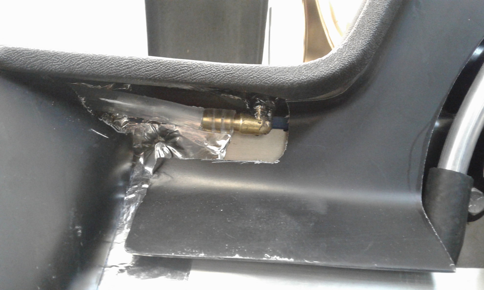

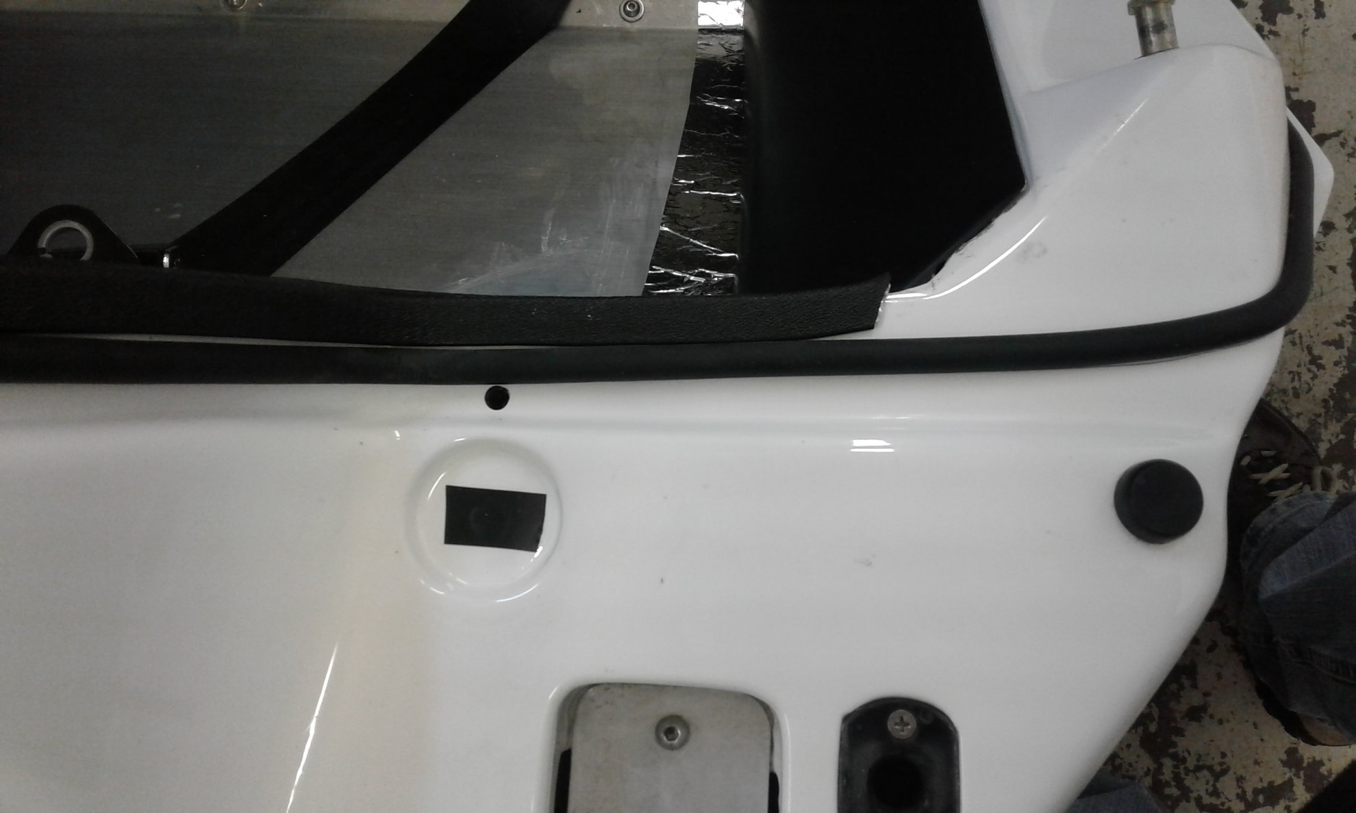

So one winter project was to get some weatherstripping installed. Unfortunately, I needed to rework the door handle fills (then repaint) before that could happen. For a still unknown reason the exterior door handle fill work printed through to the paint. Short version of a two month story - all fixed now.
I used Bill Phillips' guidelines for rubber seal materials and set to work. During which, I just could not get the doors to stop leaking in the horizontal areas behind the opening. Turns out the solution was to plumb drains in this area to prevent standing water build up, which would ultimately pour into the car when you opened the door. Crude in-process pictures attached. Hope it helps someone water proof their car.
BTW; There are shallow pockets right behind the door opening used to run a fastener in to hold the body to the upper frame (with black tape in them in my pics). These pockets should be filled in during the body prep phase. They fill up with water, which again just sits there in wait till you to open the door so it can drain into the car

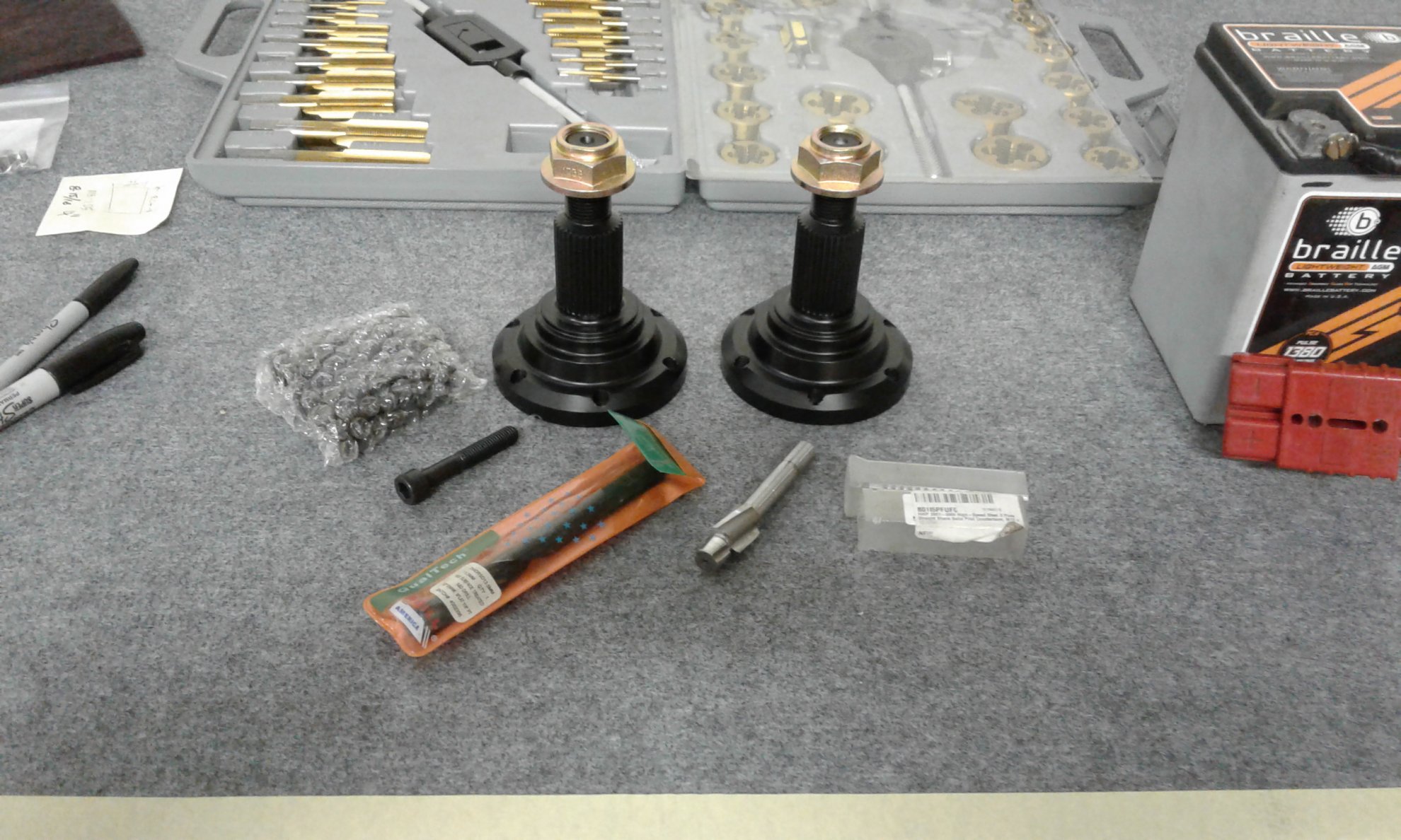

Unfortunately my upgraded Timken level C4 rear wheel bearings failed at about 2,000 miles. Since our buddy Howard Jones had already "fixed" the problem of having C4 bearing designs in a HP corner carving car, I thought it the perfect time to put his good work to use.
Before you is the DSS 33 spline C7 / 930 stubs and the Jones autograph model Gen-1 rear upright installation counter bore tools.
All's I need is the bearings and I'm off to the (uh...) races. Looking forward to having this issue over and done with, never to be dealt with again.
Thanks Howard.
