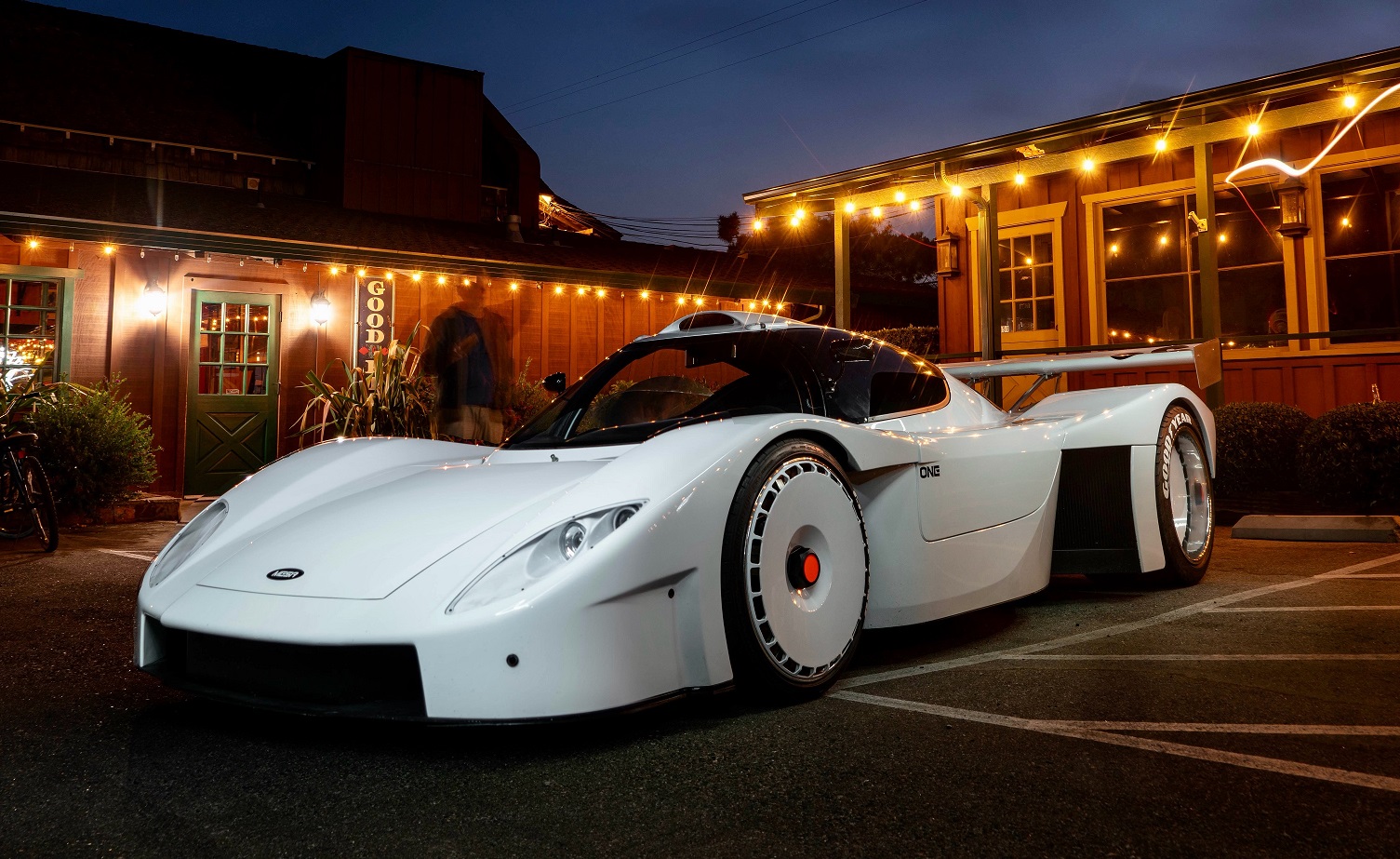

Managed to finish getting the brake fan centerlock attachment devices mated to the wheels. This work was completed just a few hours before leaving for Monterey car week activities last month. Can you say THRASH?

Long time since we last checked in and I have to say nothing but in awe of your car. That is a beast and the wheel fans will set it apart from any other SLC and really just any other super car. I would straight swap the M20. If you know anyone who wants an M20. its available. I love that nobody really knows what it is and putting your name on the nose just adds to the mystery. That is a great credit to you and I hope you get great enjoyment from it. Cheers Leon.
The 917/10 or 917/30KL was the first race car to utilize the 'turbo' fans, IIRC. I have a more aggressive/detailed version drawn in CAD, but have not figured out how to produce them at a reasonable price. Yet.

The Porsche wheels looked a lot like regular wheels with a magnesium cooling fan from a late-model Corvair engine added.

We ran the magnesium Corvair cooling fans as wheel fans on our B/P and A/P Corvettes back in the 70s….
