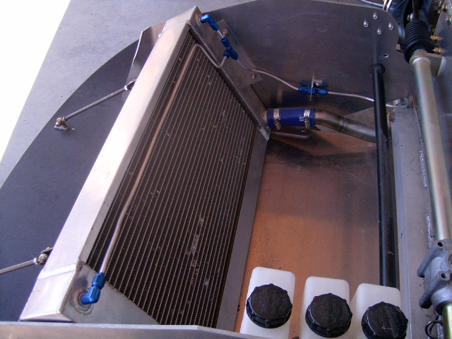

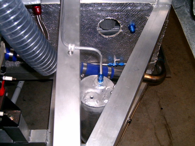

Howard, you might have mentioned it earlier in the thread but are you bringin back a purge line from the top of the radiator?
FWiW, I put on a 15 spi mr gasket caps that has an analog temp readout on it. always nice to have a 2nd opinion.
What are you doing for cool air for induction?
Howard Jones

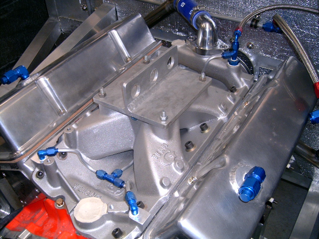

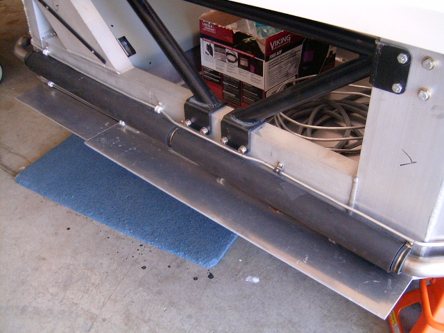

Here's the bleed line from the radiator aa well as the intake manifold bleeds. As you can see I needed to bend up some 1/4 alum tubing ad run it back from the front of the car. It's 5052 by the way.
I haven't desided what I am going to use the roof scoop for yet. I may vent it into the engine room or............use it for cabin air. Don't know yet.

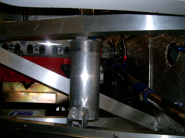

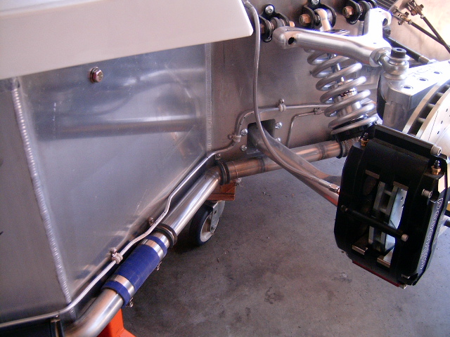

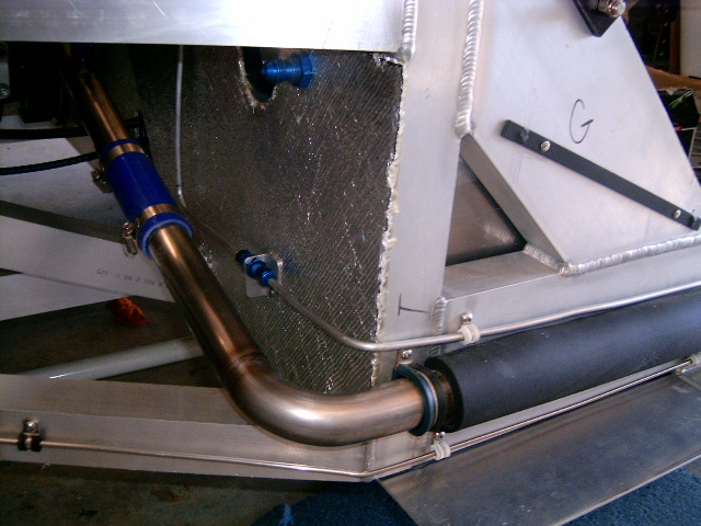

Nicely done Howard! Good idea on the coolant tube insulation too, where did you get the foam tubing insulation? Looks familiar, but can't exactly place it. My local ACE/Home Depot, etc. has nothing for 1.5" diameter pipe.
Howard Jones
Mo, It came from Lowes.

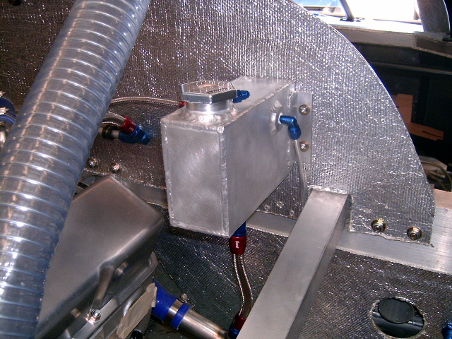

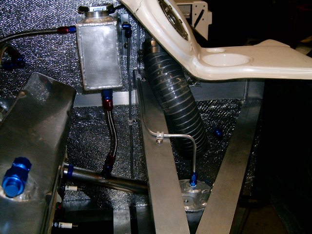

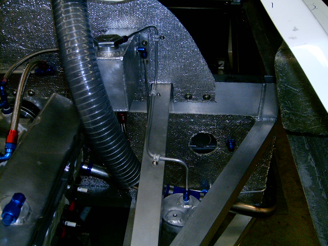

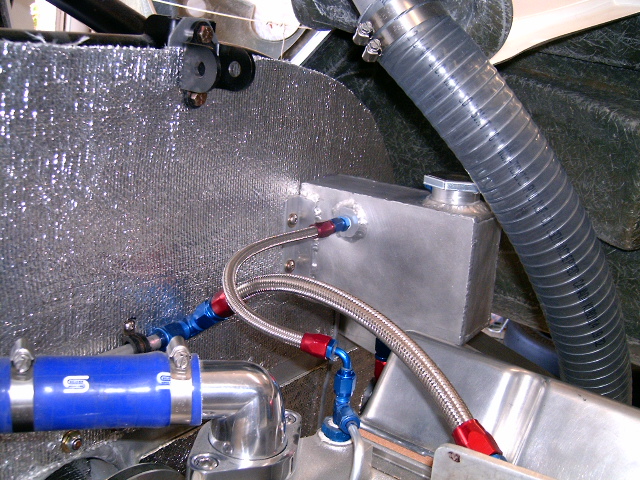

I made a catch tank. These are required at most tracks. It is a 4X10X1/8 inch piece of 6061 tubing. It holds 2 quarts. It will have the vent/overflow line run out the back of the car. You can see the unfilled bung on the top. This is the last piece of the coolant system.
The last picture gives you a good idea why I moved around the fuel fill and how I packaged the rest of the stuff I wanted to locate in that area. All filled up now.

I went to Lowes today, and the largest tube insulation size they carry is the 1" insulation (both in rubber and poly). Fortunately, they also carry 1 1/2" copper tubing, so I compared products and found the poly is not flexible enougth to cover the 1 1/2" tube. The rubber though could be slightly stretched (it will comfortably fit a 1 1/4" tube) to fit. My concern is rubber (correct my ignorance on this if wrong) shrinks when exposed to heat, which then means this will get even tighter when in use. Anyway, I purchased a couple of joints and will try it out tonight.
McMaster Carr # 5431K17. Poly insulation with 1 5/8"ID. Its for indoor use but can be used outdoors with additional jacketing. ...#K16 is 1 3/8"ID not sure if it will stretch enough.

I think it is very necessary. All that heat is going to be soaked up by the alum chassis rails and they are going to be at the water temp in no time. The best idea is to keep as much heat inside he tubing as possible. This car is going to be hot enough inside without adding to the problem.
I think the foam insulation might be 1.25. I seam to remember stretching it a little before I glued it together.
Well, I believe some heat amelioration is needed. But, using heat reflective material such as shielding used in my track Viper would work. The Viper has side exhaust pipes under the rockers and without reflective shielding, would virtually melt your shoe soles on the track or burn your legs exiting the car. As long as you can control engine overheating the foam will be fine as well. Some Viper guys vent the rocker panels fore and aft to aid heat dissipation.

I test-fitted it last night, and the "one inch" rubber insulation will fit around the 1 1/2" tubing with a little messaging. A tight fit, but doable. The wall is 1/2" thick.

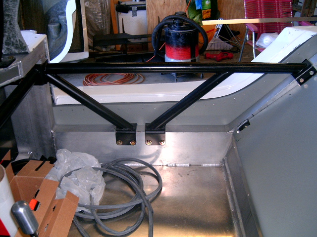

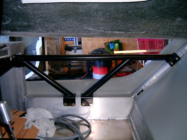

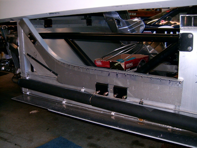

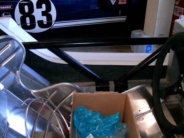

I decided to work on something that I didn't need to buy anything to do. I have quite a lot of alum sheet around the garage so I made one side of the interior paneling. This different than everybody's else's car. I have the prototype roll cage in mine and most of the streetcar version fiberglass interior panels won't work because the cage in in the way.
So I made the right side sill cover out of alum sheet. It will work fine and before I put them in the car for good I'll seal the edges with some foam tape and cover the backsides with insulation material to keep the heat out as much as possible without adding too much weight.
You can see the before picture of the drivers side with the gap clearly visable. The passenger side gap is coverd up nicely. Now I just need to make one more.

Nice work! I ordered the 1 3/8" McMaster-Carr rubber insulation, and if fits great, but the seam glue is not quite the quality of the Lowes brand.
