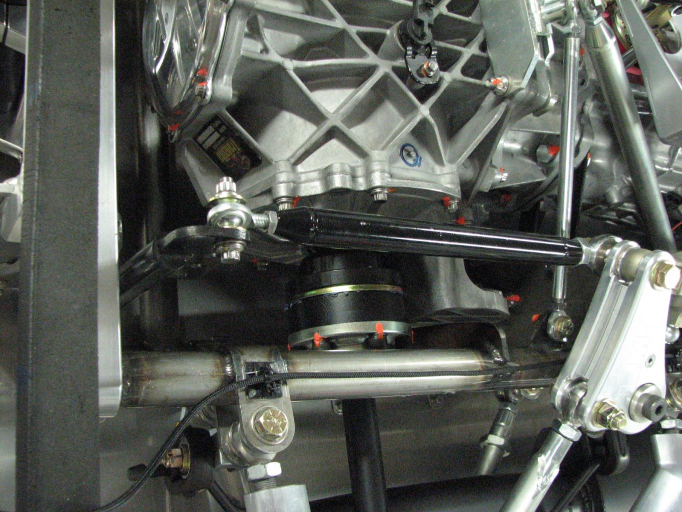

Torque-Seal on every bolt and nut.
Most of you already know but for those who don't:
Doesn't prevent loosening, but does tell you, at a glance, whether any has occurred. You can check the integrity of every fastener on your entire car in minutes. Also reminds you of which fasteners you have not yet torqued-down during your build.
Multiple colors, available everywhere, $2.49 at Pegasus.
