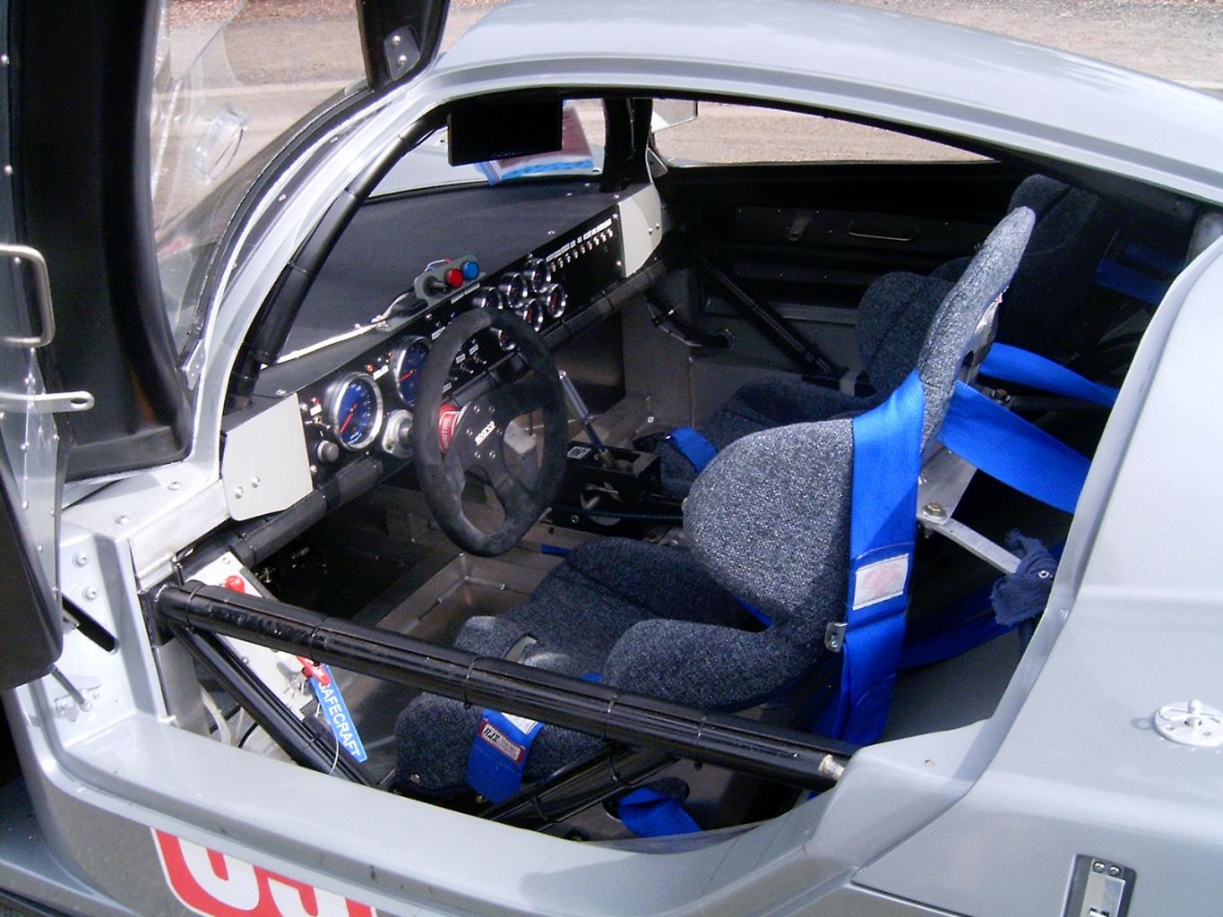

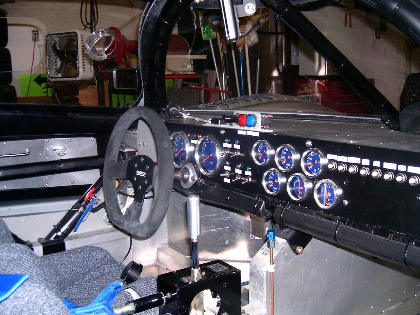

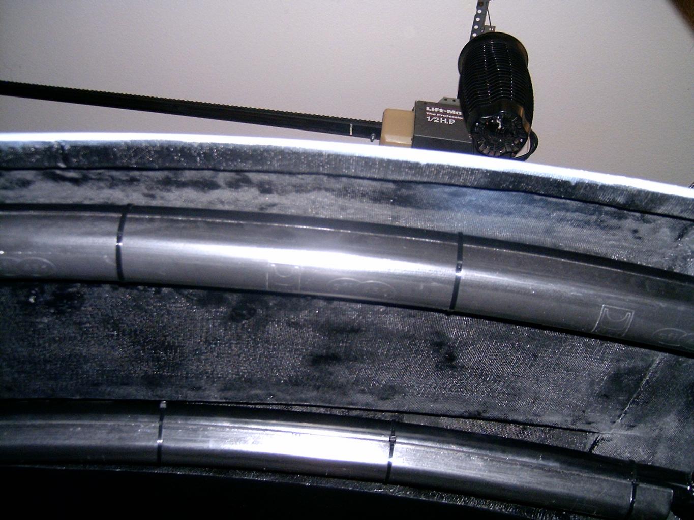

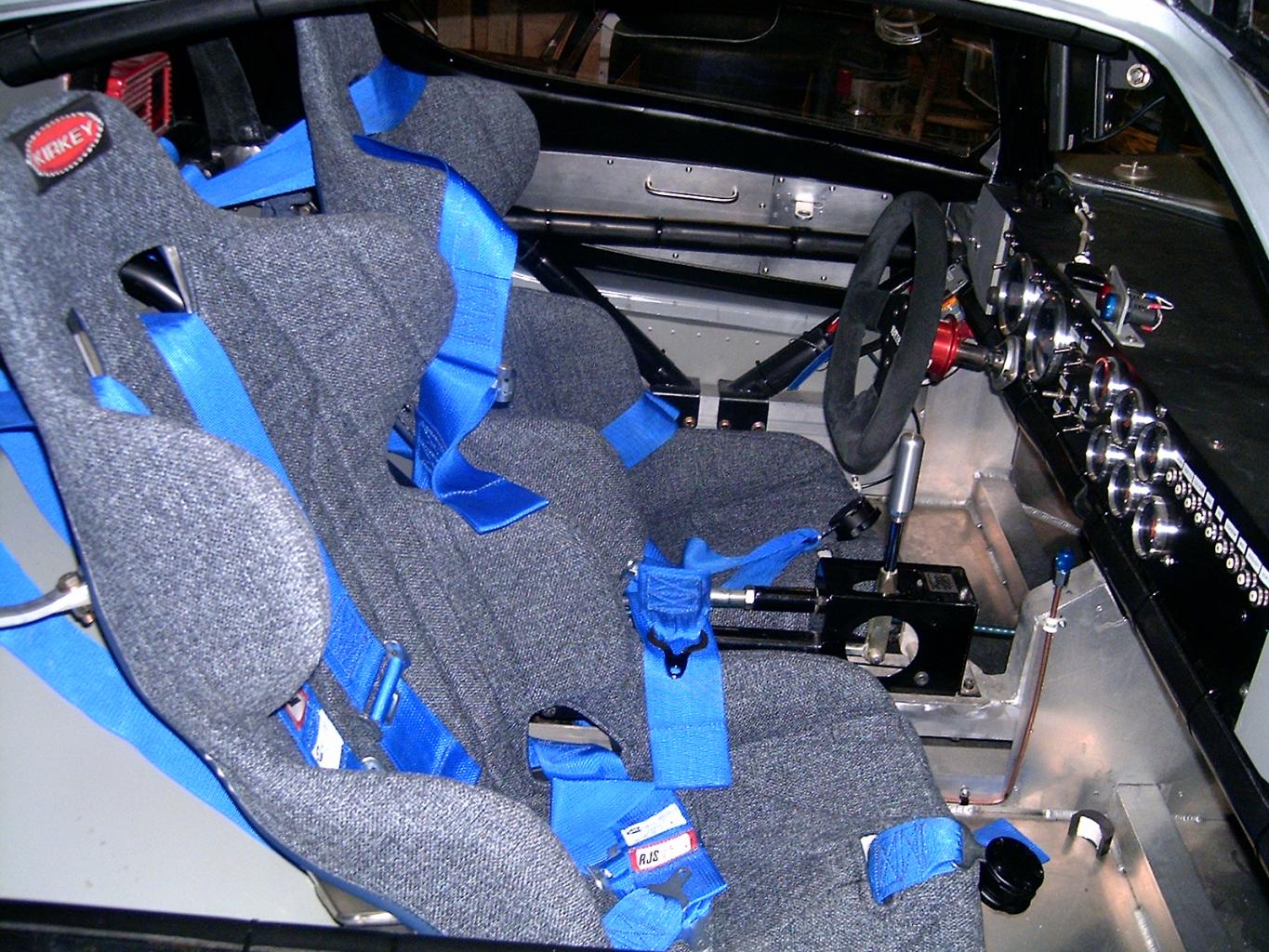

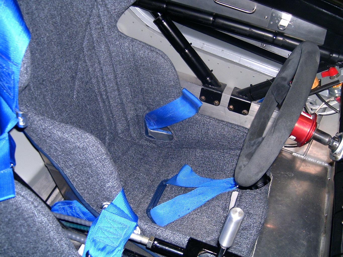

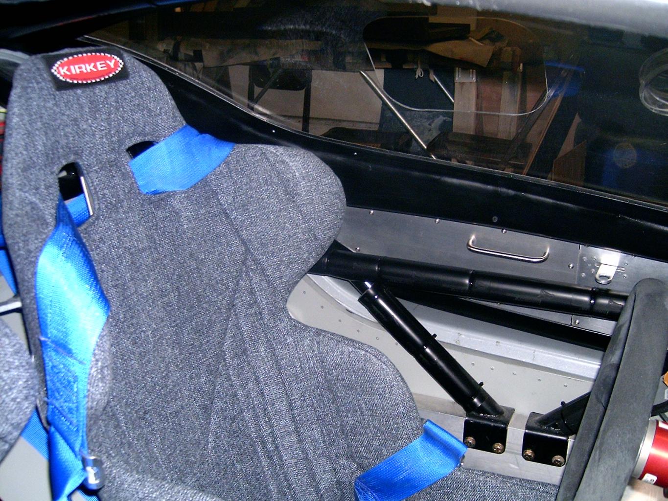

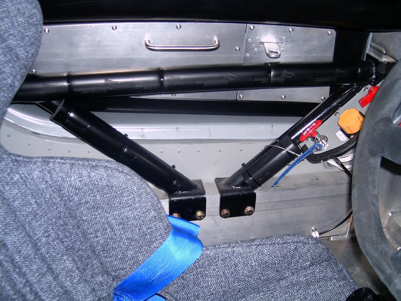

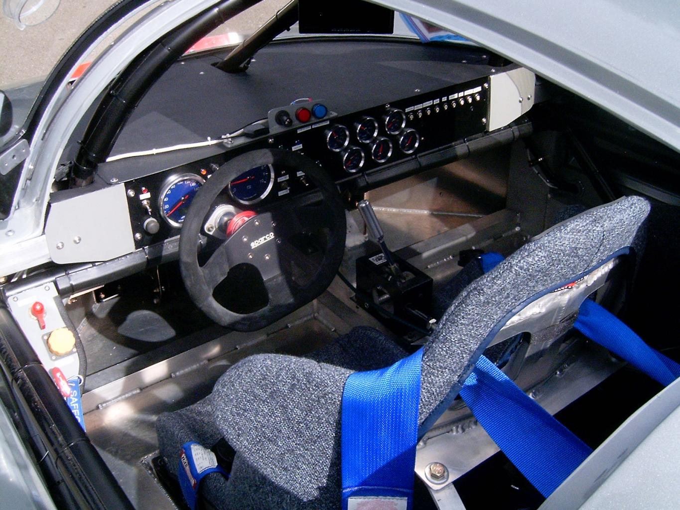

Finished the seat covers and roll cage padding today. Interior is done.

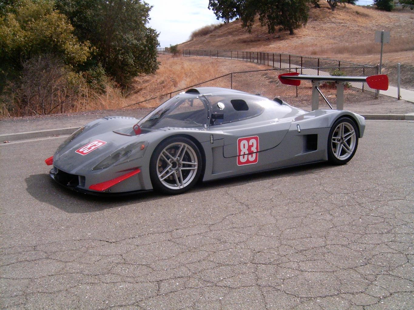

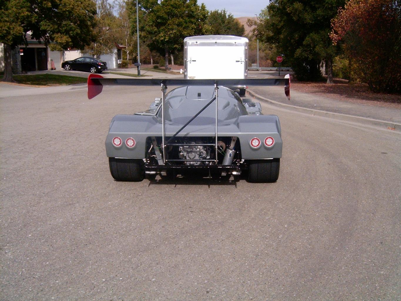

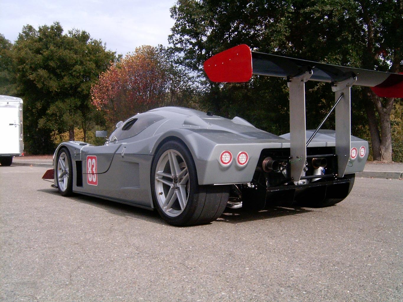

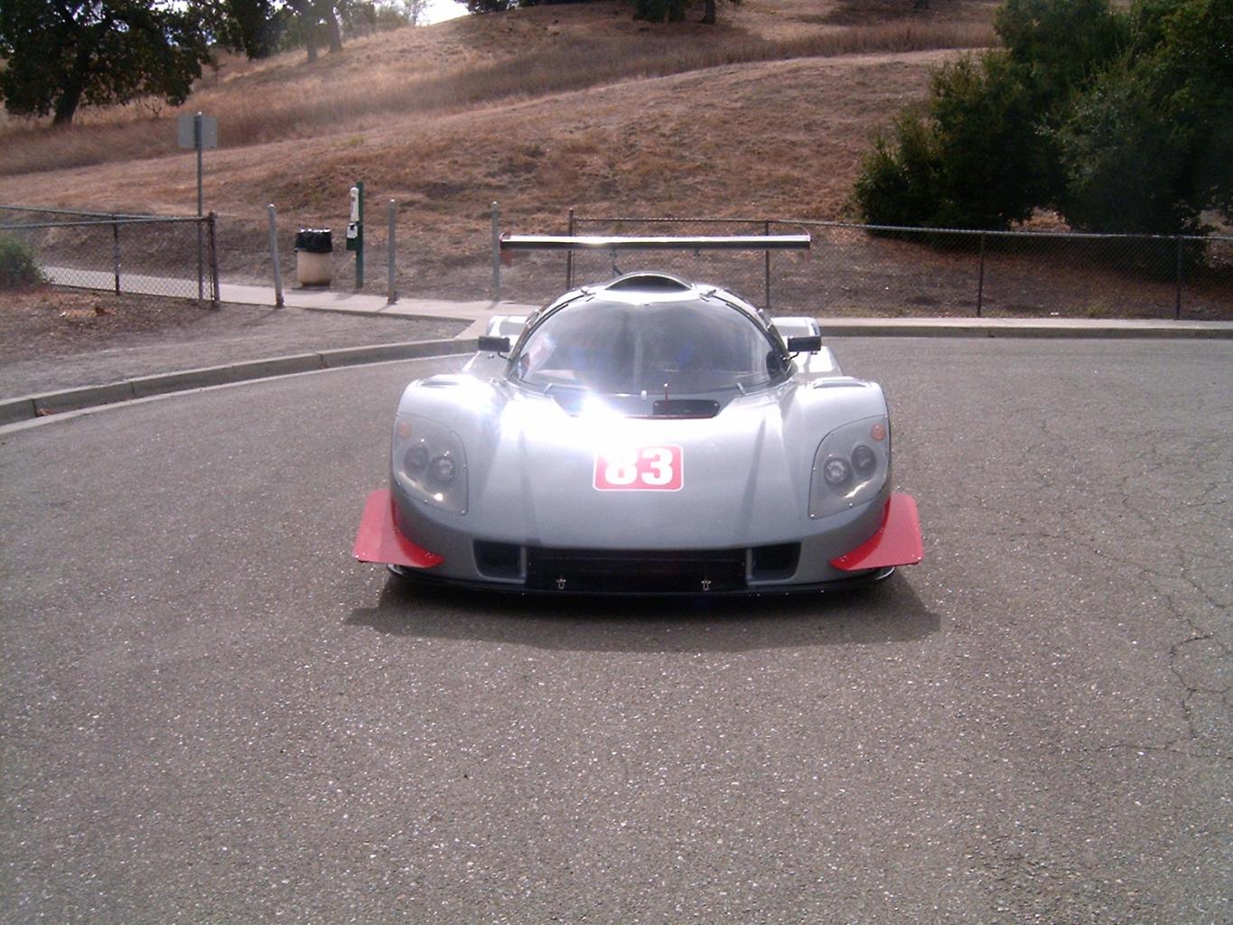

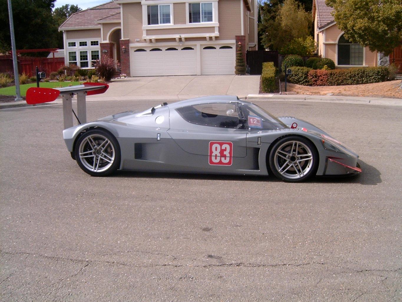

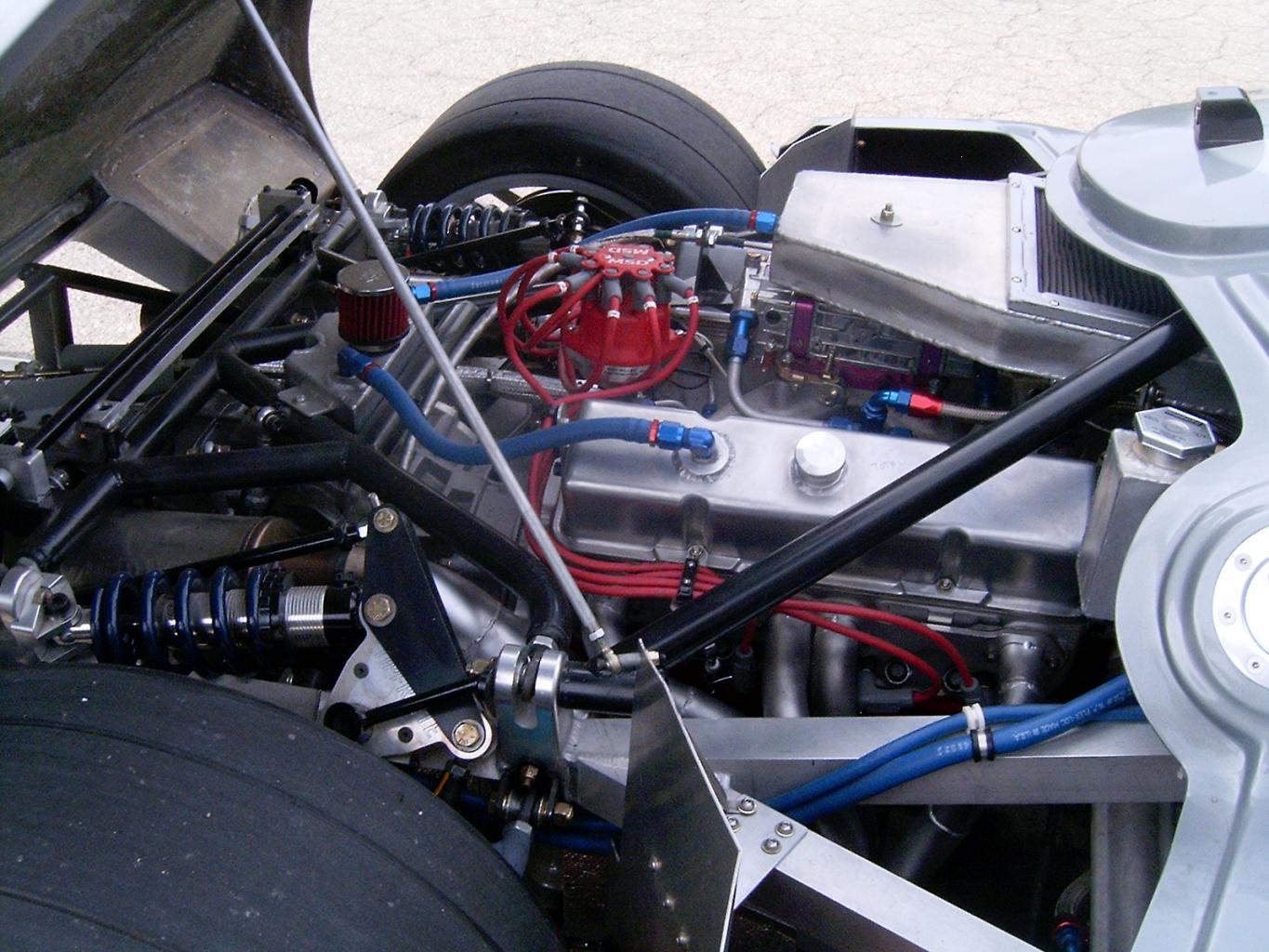

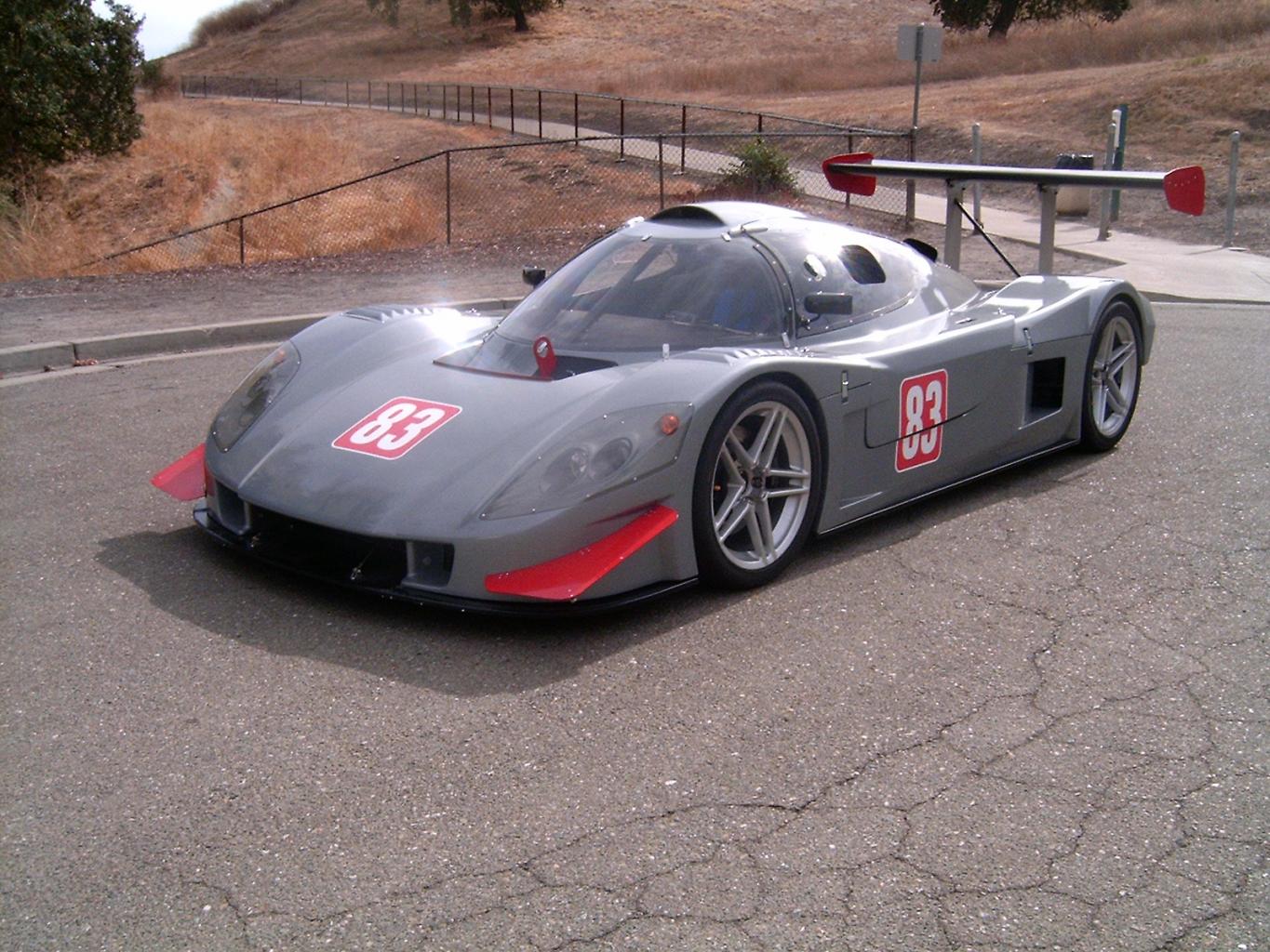

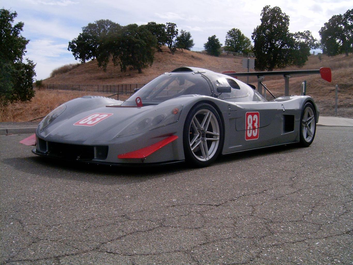

Insurance company wants pictures so I thought I would share.
Put into trailer today. Needed 8 foot extensions on trailer door but will go in. Fits good.

You gave the insurance company pictures of your car with competition numbers on it? Ballzy!!!! :thumbsup:
Wow. The car looks fantastic. Bad to the bone. That wing is way up there!
How did you determine you wanted it that high? Will those wing stanchions hold under the load?
I'm no aero expert. Duh. Seems the wing is more efficient up high like that.

Wing height? High enough to get it out from behind the roof line aero envelope. If it's not strong enough it will fall off. Really ............. I can push the car from it.
I like my seats. They are cost effective, have very good support, fit the car (with 2 inch's trimmed from the top), and plenty comfortable for 30 min track day sessions.

From our testing of Blue mistress, the aero is very good. The air stays tight against roof line all the way back. The air intakes work great as well. We have a high wing to try and incorporate the street tail envelope and wing envelope at a given distance behind SLC reducing the drag.
You have a race tail and will not have that option. Do your own testing on track. Your wing can be lowered considerably for your application. Your option is the Rear diffuser angle and wing height to try and get the envelopes to meet reducing drag.
Happy racing... Looks very sweet BTW...
I've wondered at why SLC's are putting the wing wayyyy up high, when the Group C / GTP cars put it low and used it almost as an extension of bodywork. Testing showed less drag, more downforce.
Howard Jones
I'm pretty sure they had a wing height rule as well as many others. They also had the benefit of huge ground effect tunnels under the car with diffusers at the exits. Lowering the wing in that case will cause the low pressure zone under the wing to aid extraction of the diffusers. This will produce gains in overall downforce.
I have no rules and no GF tunnels. The diffuser on the car now is what's left of the OEM piece that really is little more than a rear engine cover hinge mount. I may make another to see if I can do one that works. That decision is related to whether I can run the bottom of the car fully closed. If heat buildup prevents that then I'll just make a rear body hinge support and throw that thing on the car now away.
So I have put the wing up into clean air to allow it to work as well as possible. I also allowed for a reduction in height without the addition cost of new material. Just cut it off and drill some new holes. As the car gets developed a may do just that. For now it just looks cool.
All this aero development is still down the road a bit.
I still need to complete basic systems testing. Mainly cooling system and brake efficiency conformation. Then mechanical grip, suspension geometry, shock settings, spring rates, roll bars, tire pressures and at the same time learn how to drive it.
Don how high do you think would be optimal. Or put another way how much should I reduce it's height if I was to do so. I'm asking for best guess. I have also thought about a plate spoiler along the trailing edge of the rear body. I know these work because I added one to my GT40 and it did work on it. The Prototype engineer I talked to at COTA suggested that one would be a quick and easy way to add downforce. He even said that using a NASCAR type spoiler might be better than a wing for me considering that I was a one man band and really had no aero development support. Your airflow work seams to confirm that it will work on a SLC as well. Thanks for that info. Every little bit helps.
