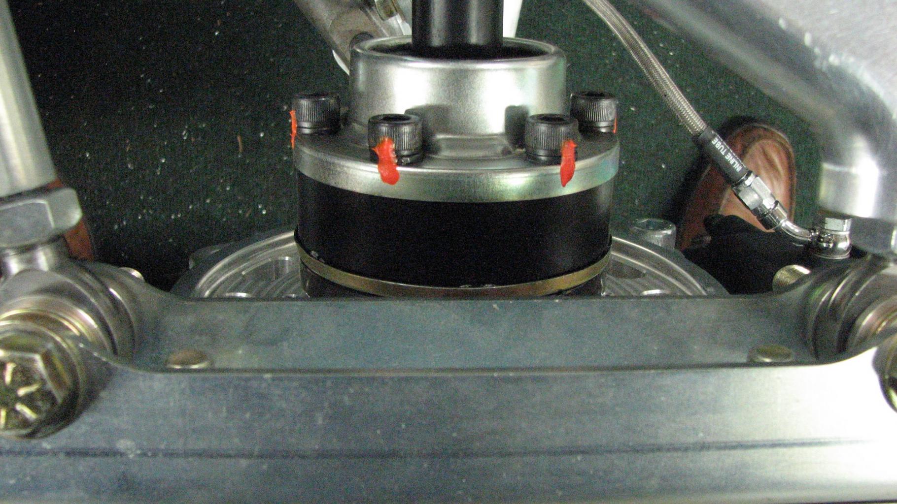

Some cars have had these come loose. I'm thinking I might replace mine with bolts with drilled heads so I can safety wire them.
For those that don't safety wire theirs, I like the idea or marking the heads and adjacent material with paint, along with regular visual checks.
