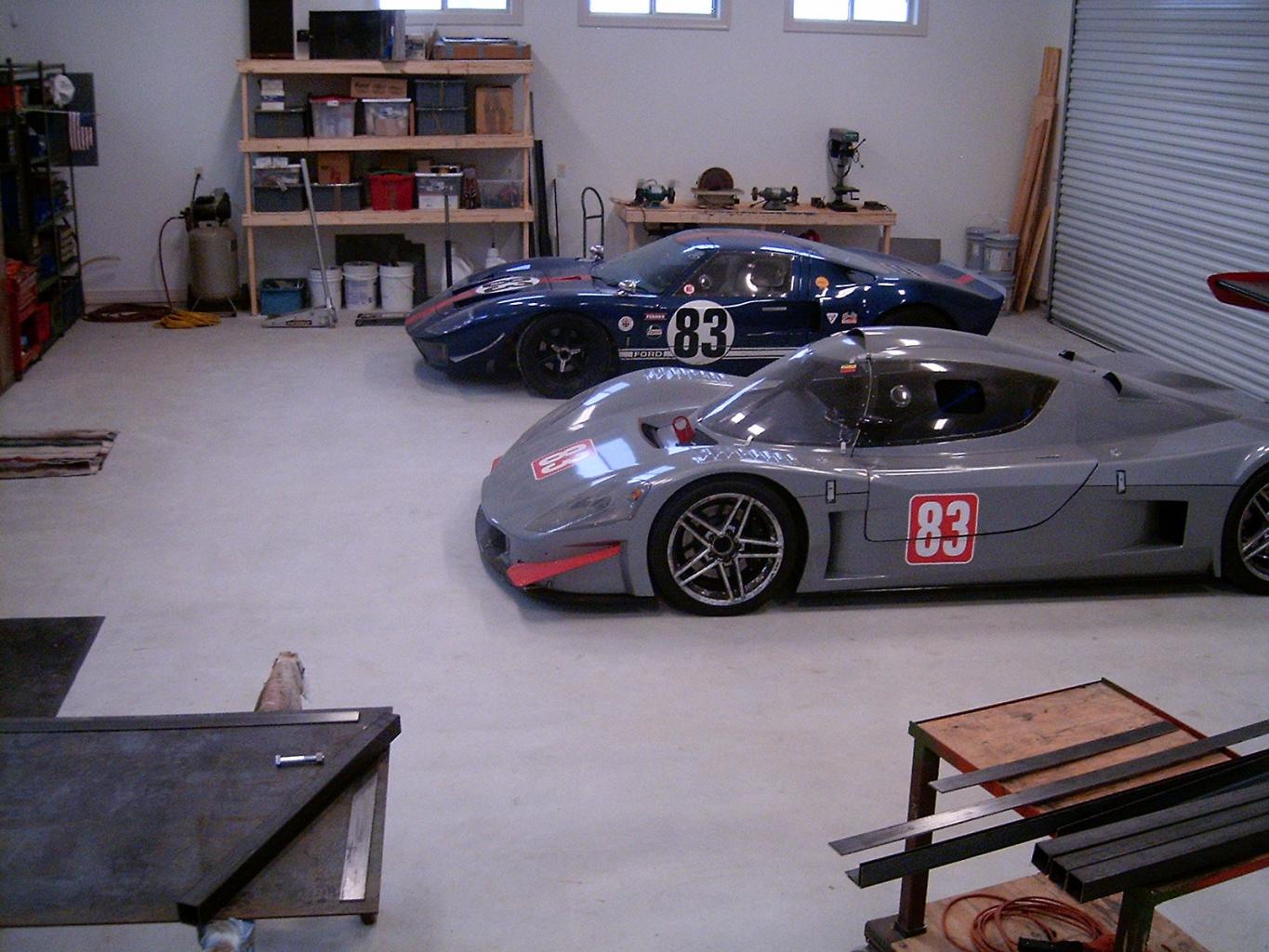

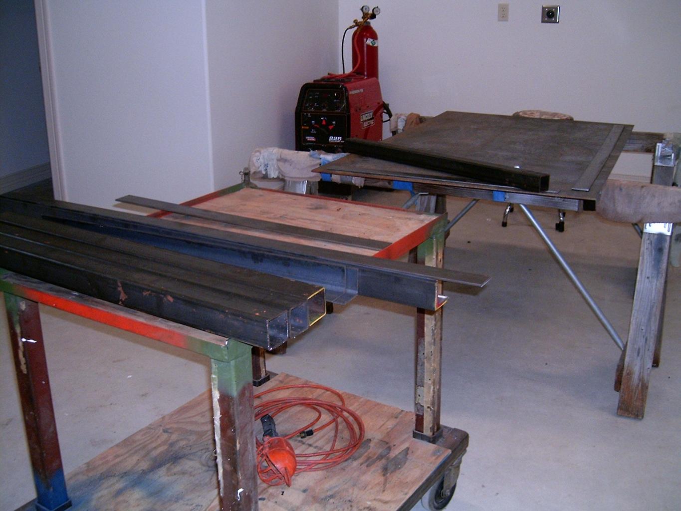

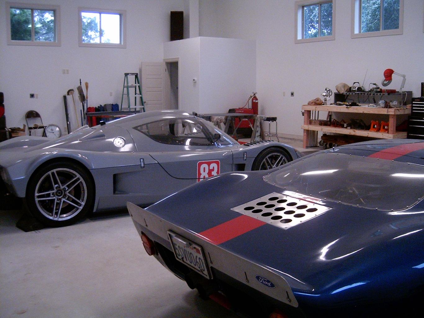

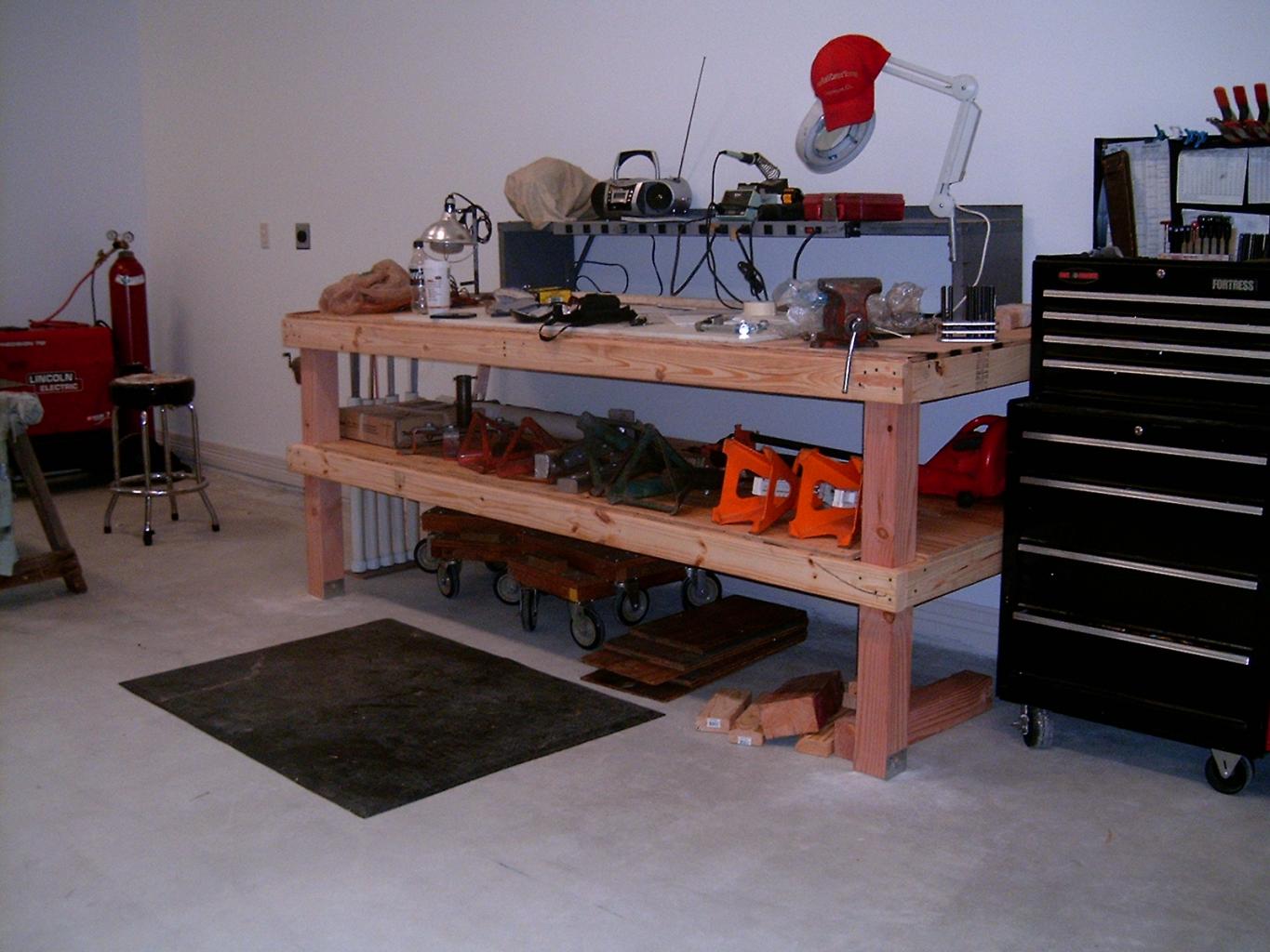

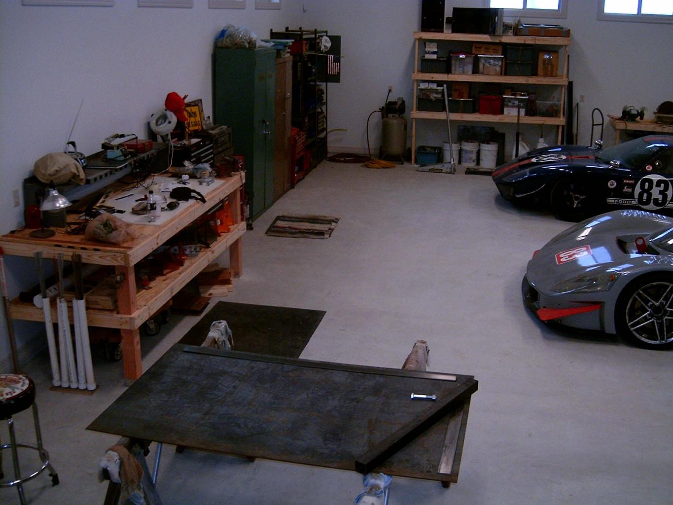

So......It's been awhile since I have posted anything. I've been busy moving and getting my new home done. That has pretty much been finished. So on to the shop. Here's some first pics of my garage/shop, the girls new home.
I built some wooden shelves and benches and am about ready to build a steel welding bench. Still no refrigerator and stereo setup.

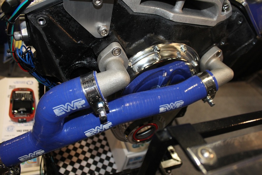

BUT in the process I have come to the conclusion that the high water temps I saw at the track are a problem with system flow volume. Even with the thermostat completely removed I just didn't think it was moving enough water. So I took the water pump off the car and found that the low cost Weiland pump I have isn't going to cut it. Very small internal cavity and passages along with a bit of casting blockage. I could have ported it out but I think I should do this right the second time.
Therefor I will install a Davies Craig electrical pump. These are a brushless design that really has become the state of the art in DC high torque pumps. I added a attachment that explains Brushless DC motors for your entertainment.
I also have included a picture of how the mechanical pump is replaced with a manifold. The picture isn't my car because it would be difficult to photograph in place, but it's the same parts on another SBC like mine.
More to come on this as I do the conversion.
