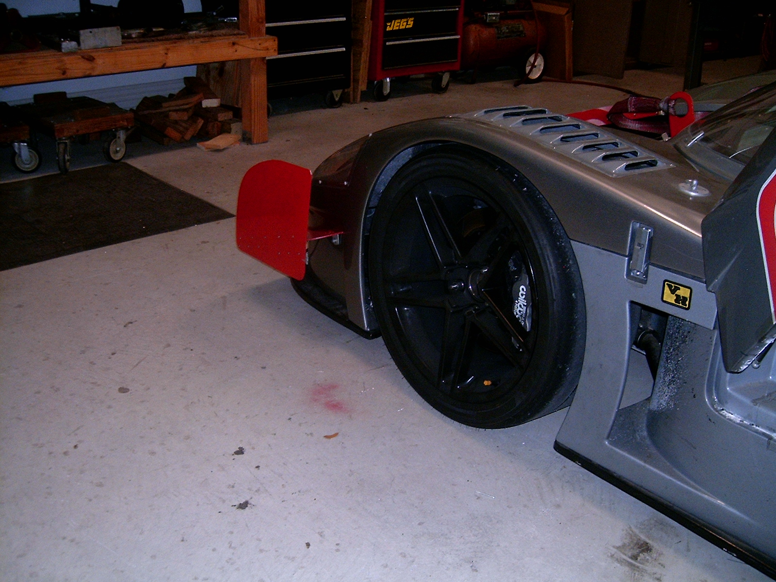

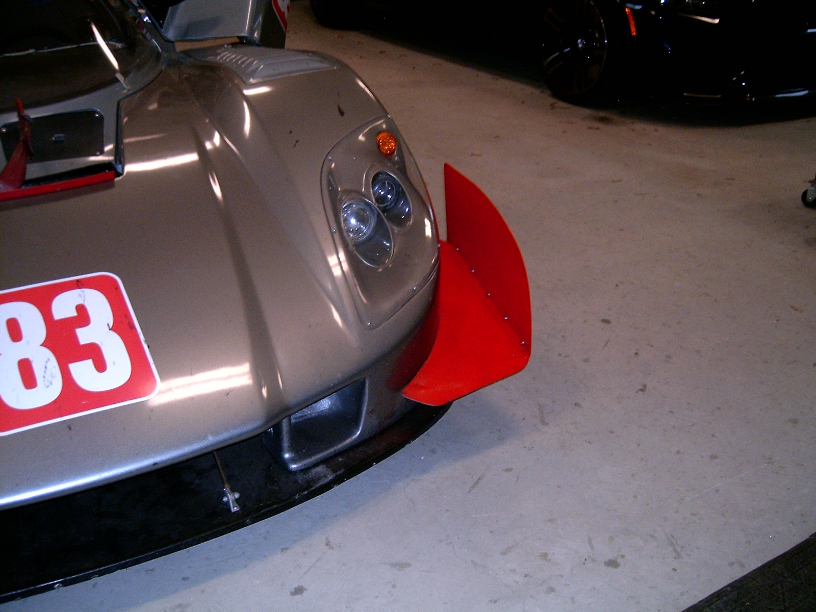

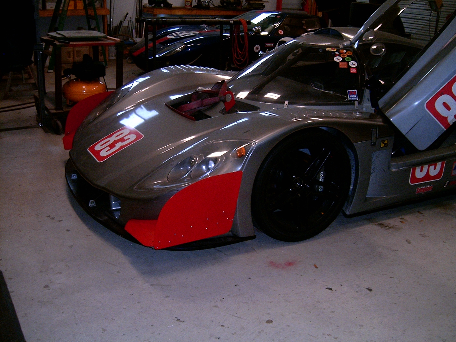

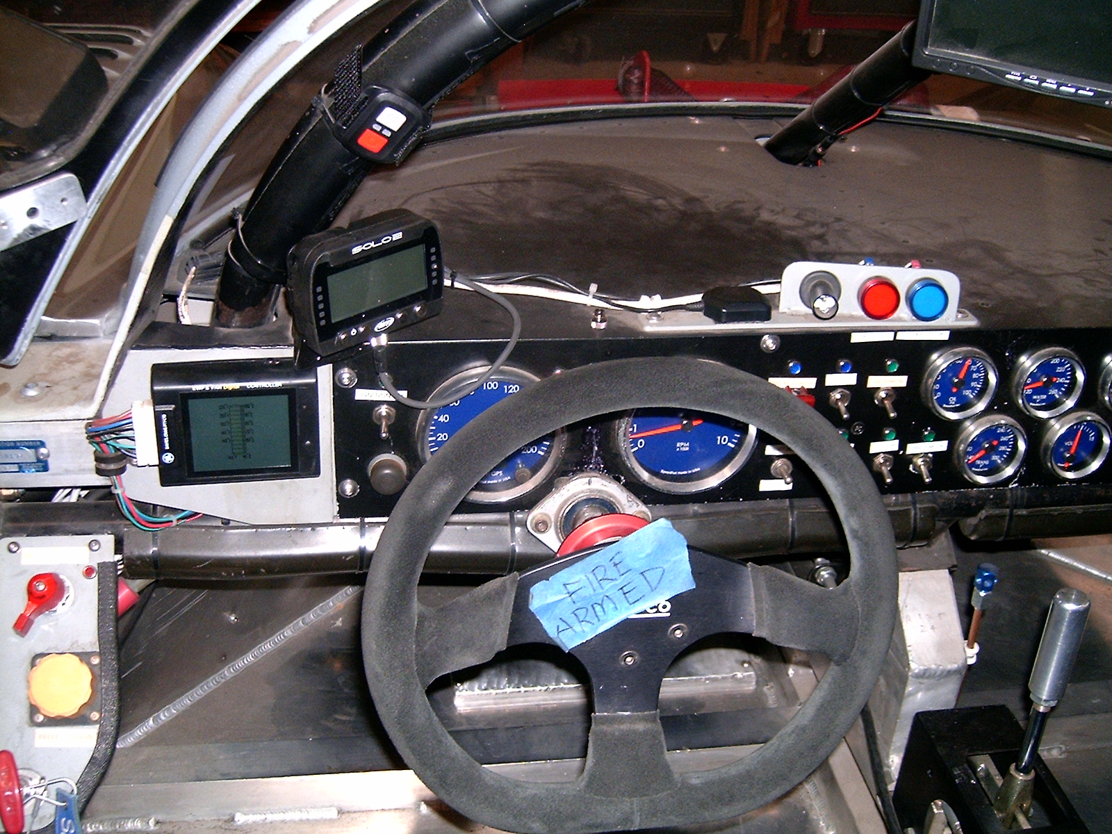

Here's some pictures of the canards with the taller fences and one showing the location and homemade mount for the SOLO2. You can see the remote camera button thingie above with a velcro wrap wristband around the roll bar right above it..
