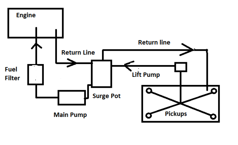

Thanks for that. Great minds think alike, Ya? I am considering a 1 gal tank separate from the main tank that receives the fuel being pumped from the main pump as well as the return line from the fuel pressure regulator. Then that smaller tank will incorporate an overflow back to the main tank. A second primary pump drawing fuel from the smaller "surge" tank would supply the carb via the inlet to the regulator. I'm going to draw something up so I can get a better idea of what I am doing. I would like to have an emergency/reserve tank in the system that I can use if I run the main system out of fuel. Enough to return to the paddock if that happens. I gallon would be plenty. Maybe I can get some dual-use from the second "surge" tank and pump system.

That is exactly what I was thinking! I was going to research pumps next. To confirm, I will need to pump out of the top of the fuel tank and into the 'serge tank sitting next to it. The total lift height will be about a foot and the length of the fuel line from the main tank to the surge tank will be about 2 feet. I am making about 550 hp so I think about 50 gph ought to work. OK Don?
The Carter Black pump in free flow is 50 gph free flow. Lift pump is free flow into surge tank.
As in diagram, main pump from bottom of surge. Return to tank out top. Lift and regulator return on side at top at an angle creating a swirling motion. Hence swirl pot. Prevents air bubbles from reaching bottom of surge tank under low fuel tank pickup conditions.
Questions:
What are you doing for pickups in the main tank?
Holley hydramat?
Does the main tank contain foam baffling?
Rock crawler pickups?
I would call you but I lost a few #'s when transferring to new phone.
Howard Jones

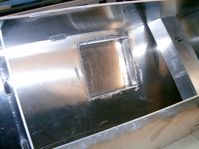

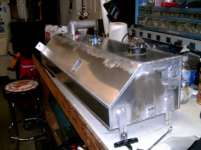

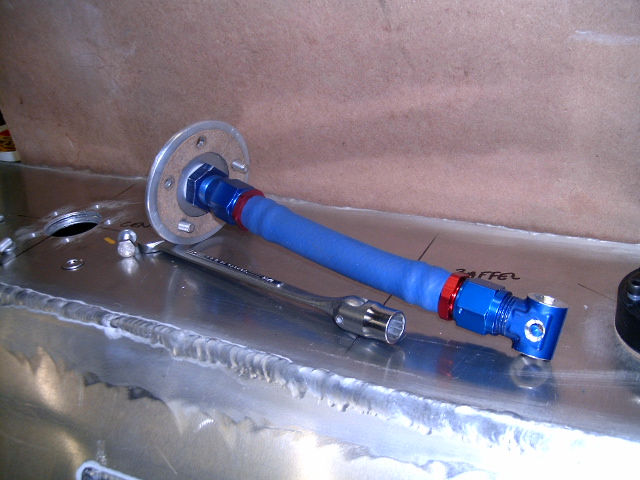

The main tank is a big aluminum box about 5 feet long a foot tall and about 14 inches wide, It is divided with full width and height baffles into three sections of equal area with holes in the rear bottom of the panels about 1 1/2 in diameter to allow fuel to transfer between them. I have added a sump in the center section located at the center rear, 6 inches square and, 2 inches deep.
The pickup is a length of hose that comes from the top of the tank and terminates down in the center of the sump. I used an aluminum AN 'T' fitting attached to the hose and sitting on the bottom of the sump as a weighted pickup. It cannot move enough to contact the sides of the sump walls. I would estimate that there is about a 1/2 inch clearance to the bottom of the sump from the two 'T' openings and therefore the inlet would be about a 1 to 11/2 below the floor level of the main tank.
No foam. The tank is all welded up and replacing foam would be a big deal.
I am pretty sure fuel will normally find its way into the sump while on track pretty consistently. However, I agree that a surge tank would probably solve the problem. I just ordered a length of aluminum tubing to make a surge tank.
I'll send you my contact info via PM. Thanks again, Don.

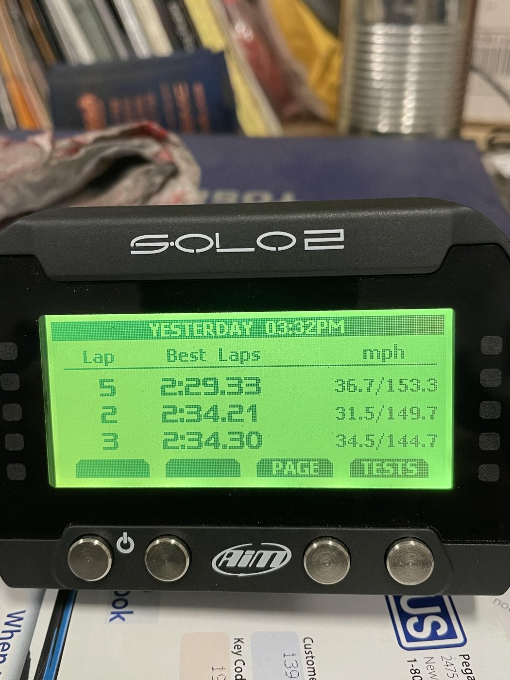

The news is after running constant 2:34-35 and feeling like I know there's a lot more I had a go in the last session. Here's the SOLO 2 screen from that session. 5 seconds over that one lap by just giving the car what it wanted, deeper braking after full power runs down the two straights, and a good hard lean on it in the fast corners.
There's a lot more there, I just need to want to do it I guess. I need to get my head around bumping up my fun speed a bit. Gonna have to move up a group though. I had a couple of near misses on the brakes with 50MPH closing speeds at the end of the back straight. In an earlier session, I tried to go for top speed on the straight and saw 160. Letting the car have its head off the corner before the straight makes a lot of difference in terminal speed. That's also a lot of work for the brakes, as well as added wear and tear, and that is the downside to high top speeds.
So here's the SOLO 2 picture.

Going faster is definitely harder on the car and the wallet. A 5 second jump in one lap is immense, do that a few more times and it will become second nature. Soon, a 29.3 will feel slow.
Happy to have provided some inspiration ;)
Howard Jones
I was a little surprised by that one myself. But to be honest I haven't run the car down the straights with full power and intent to max speed there. Otherwise, I moved the brake points deeper to a point that I believed was near maximum and ran both of the high-speed turns until I saw the beginnings of a little push. I used a lot of 4th gear and only down to 3rd in the slowest corners. New tires are a wonderful thing!
Throughout the day I had been trying these things one at a time and in the end, just did them all in one lap. That used to be my method when I raced motocross to work out a full lap min time. One section at a time. Then put it all together. Still works I guess.......
If you look at the SOLO 2 data you can see that both the min and max speeds went up quite a bit on that lap. On one earlier lap, I saw a 160 on the back straight but I just didn't feel good about it when I got to the braking zone so thereafter I sorta rolled off the power earlier and waited to get to the brake point instead of going from full power to full brake effort.

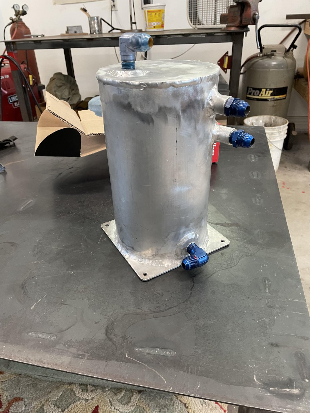

I have begun to build my swirl/surge tank. See post-1206 above for the layout. Here's my question. I would like to install a low fuel pressure switch in the lift pump output from the main tank to the surge tank so that I would know when the main tank has run low on fuel and be warned that the surge tank is not being supplied with fuel. This will give me a lap or so of fuel to return to the paddock without running out.
But I don't believe that there will be much if any pressure in that line since it is in freeflow to the surge tank. The surge tank is vented back to the main tank by a open return line and the main tank is vented to the atmosphere. Therefore I don't think any pressure will be present in that line. If I install a low-pressure switch there it will be on all the time. Fail.......
I was thinking that a restriction in that line might provide some pressure differential but I really need about a constant 6 PSI to use a 4 PSI sensor/switch. That much of a restriction would be excessive? I have a leftover inline fuel pressure regulator. If I used this inline with the surge tank inlet, do you think it would provide enough restriction to use the pressure switch?
Has anybody solved this problem? Ideas?

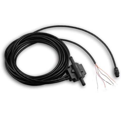

Other than putting a float in your surge tank, maybe a fuel flow sensor? Problem would be coming up with the circuitry to support a big yellow light…

I may be overthinking this. In any case, I made my surge/swirl tank. I'll get it mounted and in place this week after I test it for leaks. I then need to order some hose and fittings. Here is a picture of the tank. It holds about a gallon.

Do you have a functioning gauge on your main fuel tank?
For the swirl tank, I'd consider something like this marine fuel level sender. You'd know immediately if your swirl tank level is dropping, with time to pit. Whether you're out of fuel in the main tank, or your lift pump has failed. 2 fuel gauges would be super cool anyways.

I do have a fuel level gauge in the main tank. It is one of the capacitive probe types. It does work but it is slow to react, If I start with the car sitting on flat ground and add 10 gallons to a dry tank then it tells me I have about 90% full. It will take me about 25 mins to burn off 6-7 gallons and at that point, I will have about 2-3 gallons left. BUT, it is sloshing back and forth in the tank and the gauge will read about 1/2 full until I park it and let it sit for a few mins. It will then read nearly empty The gauge is not effective in the car when on track,
If I were to use a gauge again it would need to be able to correct the reading at least 2 times a min. 10 would be better. Once a second would be ideal. The laser one is interesting. Maybe I'll call them and ask for the refresh rate.
This is why I like the idea of a pressure sender low warning switch/idiot light in the output line of the hose coming from the swirl tank fill pump to the swirl tank.
