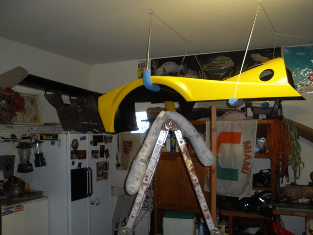

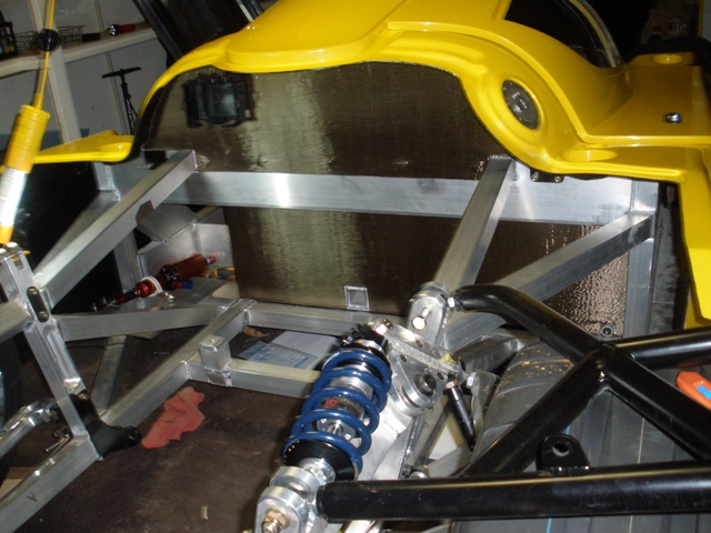

OK, i haven't been sitting idle but i feel like i've picked up a part time job in the evenings. Part of it is tracking down funky fastners. more on that later. First thing was to get at the Ricardo. I took the diffuser and tail off. Thanks Jack for the hint about releasing the pressure on the shocks first. Duh on my part.
Once i got rear clip off it was screaming for epoxy. i used Autobahn truck bed liner 2 part. i tried rustoleum, too think although the autobahn is a little glossy but it should give a little reinforcement form stone chips. Bonus, it cuts alot of glass splinters.
I'm trying to use as little space as possible so the clip got hoisted to the roof. i saw an Ultima guy do this. keeps the kids away from it too!

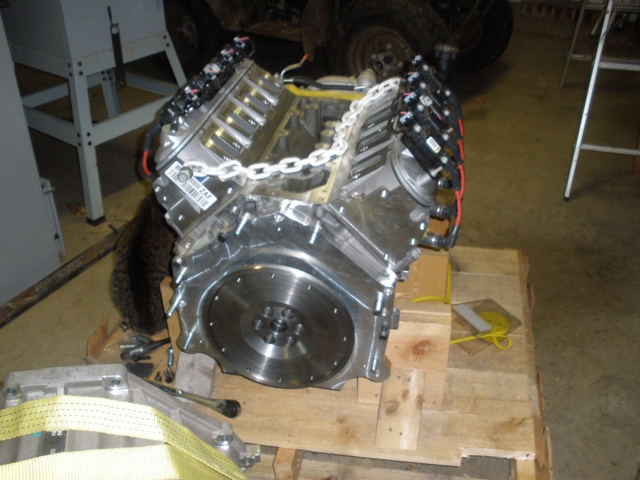

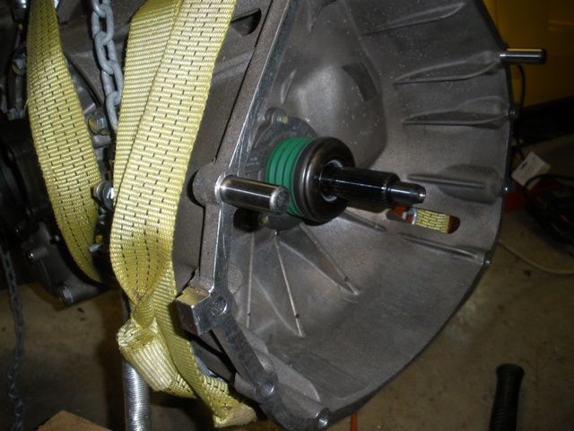

Ok, got more room to move in the garafge. so got the tranny out. simple harbor freight 1 ton hoist. i shoulda gotten the 2 ton for a little more reach might be tight getting the mated tranny/engine. Found a clutch tool on ebay. has all the right numbers on it but man is it tight. Spent 1/2 sanding it and i may still need to use the engine winch to get it out once it lines up the 2 discs of the ricardo. While i had the rear clip open i used some heat reflective from heatsheild, their lava mat. Prettty cool, looks like carbon fiber....

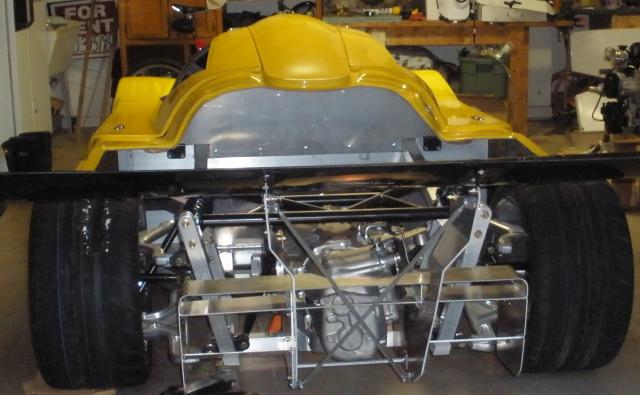

Can you post a more detailed pic of the diffuser/body? I'm curious how they are tied together - I thought the diffuser was attached to the chassis.
Whoops, somehow those pixs didn't upload. Here is that clutch tool and the reflective mat installed.

Efn, my bad, the diffuser does attach to the frame, 4 screws to the Al rear tube, 2 to the steel cage. To remove the tranny i had to release pressure from the shocks to take the steel cage off

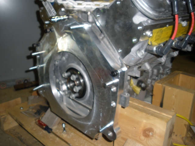

So the adapter plate and clutch for LS3 to Ricardo take a few special fastners. i figure ill mention them now before i forget. The clutch needs nine 8mm x 90mm hardened hex head bolts, not easy to find unless you want to buy a bag of 50 from Fastenal. the ricardo also needs two 16mm x 30mm locating pins. it actually looks liek 32mm would be exact but good luck finding those. i suppose i could cut 8mm from a 40mm pin. Then you need six M10 x 40mm 10.9 allen head bolts, adapter to LS, so the heads hide. Adapter to tranny needs five M10 x 60mm hex heads. the hex stay captive in the plate so you can tighten when they are buried under the plate. Here is a pic of the plate loaded up. I wish i had this laundry list instead of carting the plate around to 5 fastner shops. hope it helps someone out there!

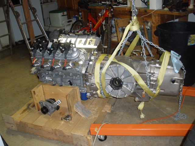

My favorite shot, automotive pornography if you ask me. Chevy and Ford mated!
The intended offspring is HP to the tarmack...

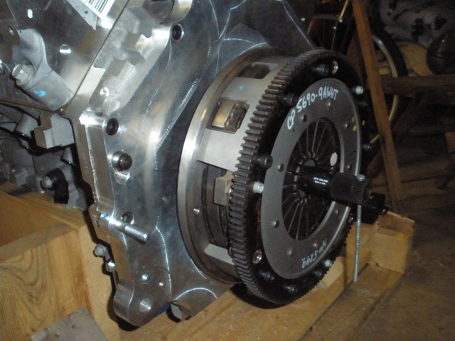

For the record, I spec'd the clutch bolts and dowel pins from Ford. They are GT parts. I remember the clutch bolts came in bags of 4... perfect for when you need 9 :).

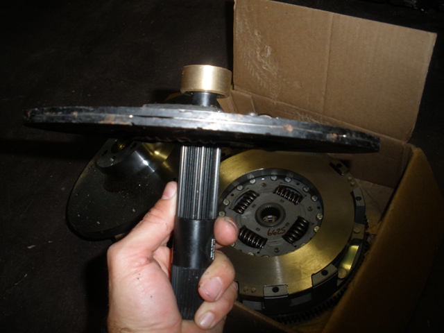

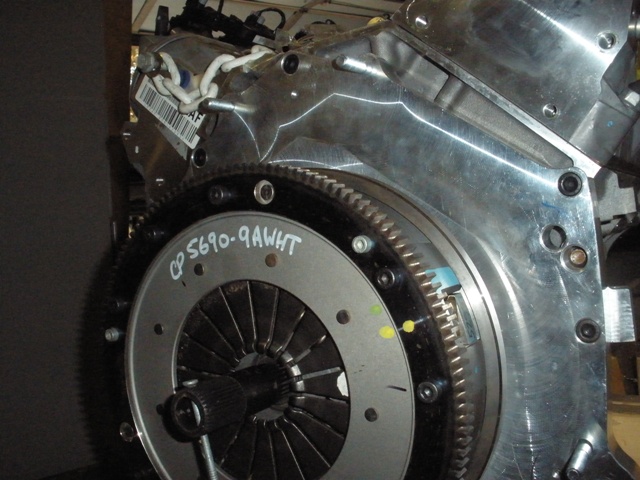

Here are a few pics with the clutch/flywheel on. the clutch alignment tool was a pain to remove, probably the hardest part. anything more than 10 ft/lbs and the delrin locked in there. i ended up using a comealong to yank it out so the 2 discs didn't misalign at low torque on the bolts. i also added a shot of the Ricardo just beacuse i could never find one on the web! it's hard to see but i had wear marks on this inside of the bellhousing. i'm curious if this might be a remanufactured Ricardo or if that happened in final test?
