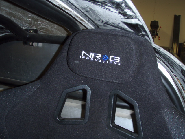

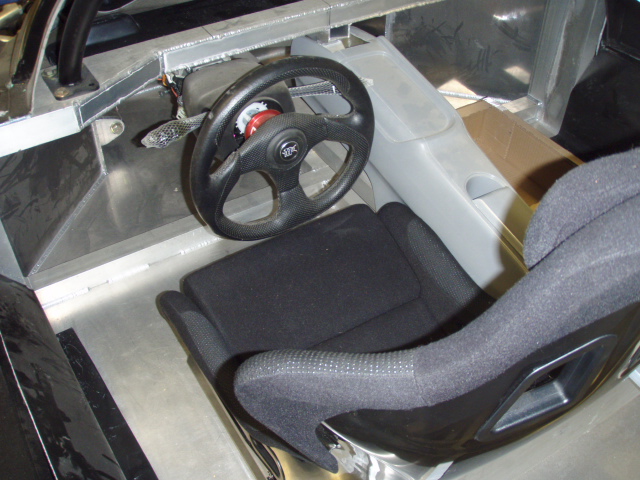

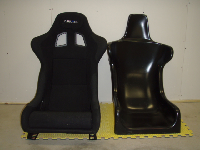

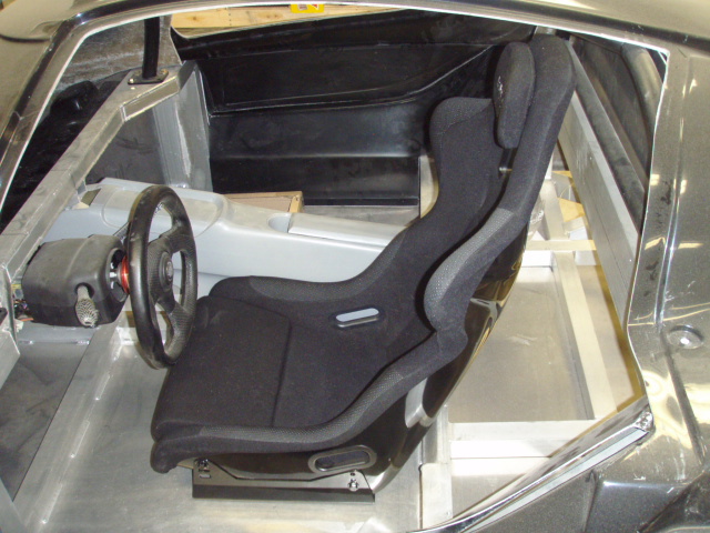

Well, another aftermarket seat that won't fit. All dimensions are good except for the width of the headrest. No matter how I adjusted the seat mounting bracket (seat tilt) the headrest interfered with the door on the driver's side. I didn't bother trying the passenger side.

If finding the right seats is difficult, and the NRGs are close and comfortable (and affordable), I'd think an upholstery shop could cut down the width of the headrest, modify, and recover with the same material.
Just an idea if this is becoming a time suck for you.
Tom
Dave Lindemann
Dave,
Tom
Tom -
You're definitely right, the seats would be fairly easy to modify given that the shell is fiberglass and the upholstery is nothing special. I guess I've entered into a bit of a quest and I hope to find the seat that's "just right" given the special nature of the SLC.
The quest continues....
Dave L
I doubt it. Too wide, and too high unless you are munchkin-sized.
The SLC needs a very low, very narrow seat. Several builders have found that the Tillett seats work well, and, of course, the stock seats fit. :)
