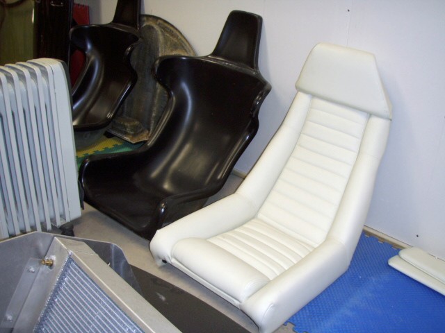

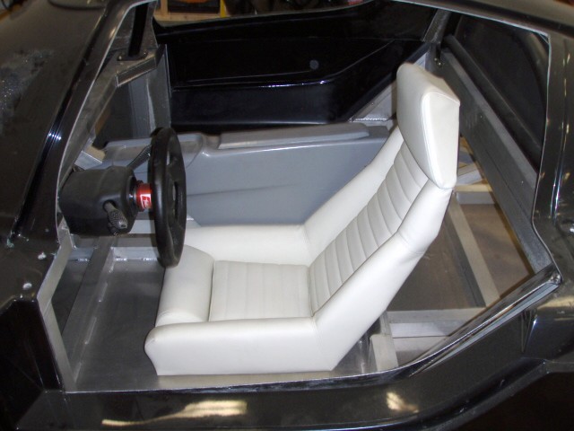

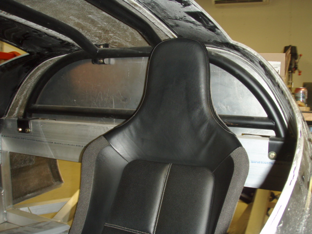

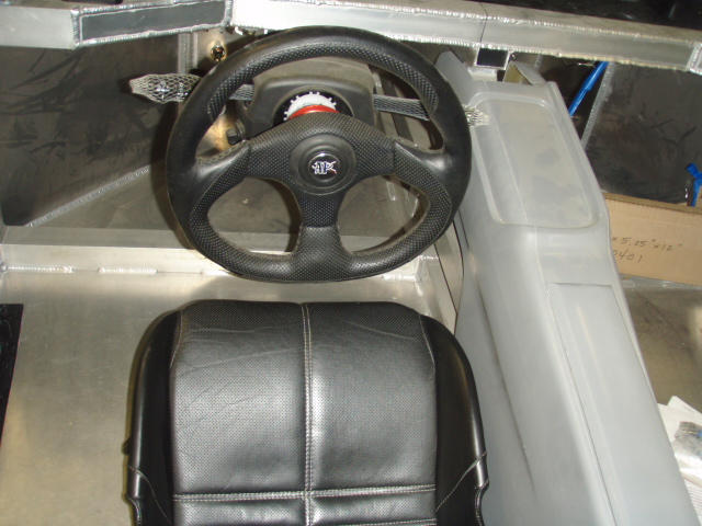

Resurrecting this very old thread. My SLC project has been sitting idle because I'm focusing on the rebuild of a modified Lotus Europa Twin Cam Special. The newly upholstered Lotus seats have been sitting on the floor in front of the SLC. On a whim I thought "what the hell - let's see how they look in the SLC!".
Holly crap - they look like they were made for the car! Plenty of clearance everywhere, the incline matches the firewall with the seat sitting flat on the floor, and they are very similar in shape and size to the stock seat. The difference is these are not quite as tight in the hip area and nowhere near as tight in the shoulders. While I've had limited seat time in a Europa and can tell you that the seats are very comfortable and offer good support. Obviously, they aren't racing seats but for a street car these may be just the ticket.
Food for thought.......
Dave L

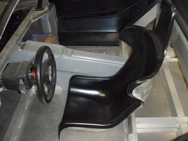

Maybe a dumb question, but is it unsafe to trim the fiberglass on aftermarket seats?
Obviously, then the covers would have to be tailored, but probably not a big deal. I have some EVO 2s that I suspect could be trimmed to fit and still look good. The shoulder wing and head could easily be cut. Then again, if strength is compromised then no. I haven't looked at the shells without the covers. That would probably reveal the answer.
Those Tillets look like maybe the answer, if the stock ones won't suffice.
Doug

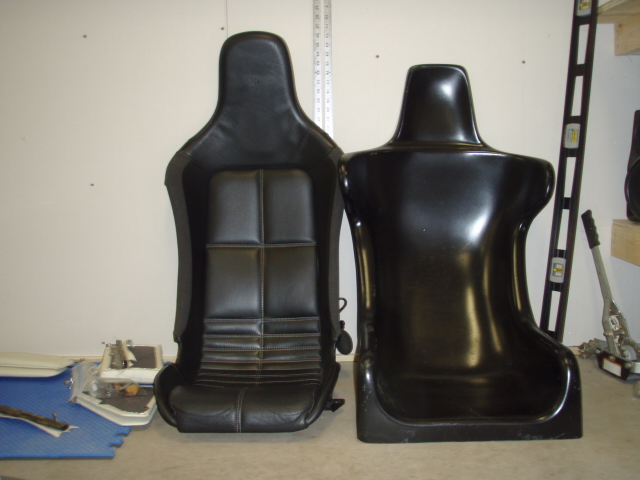

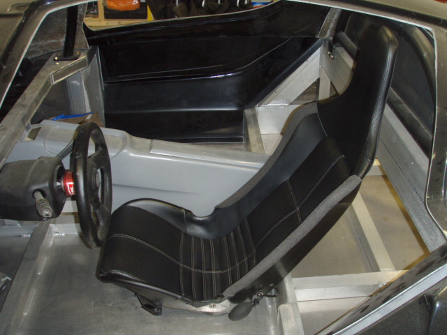

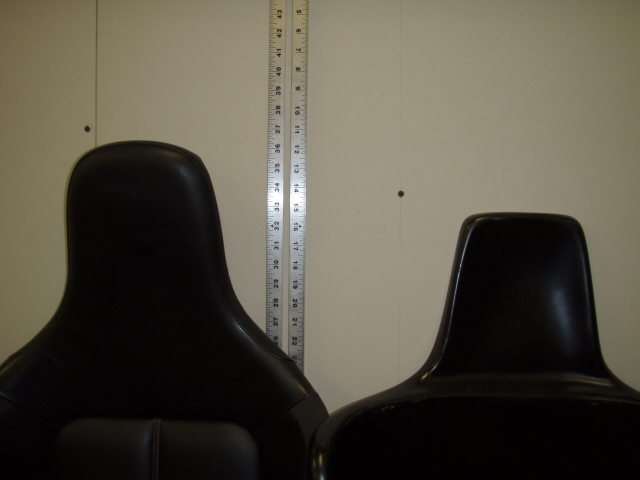

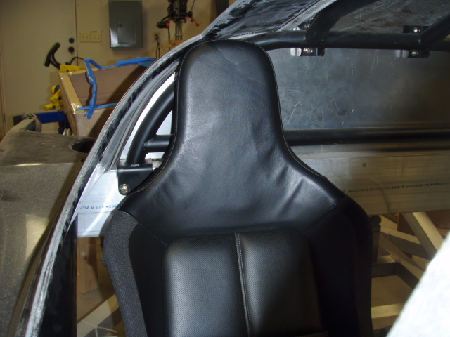

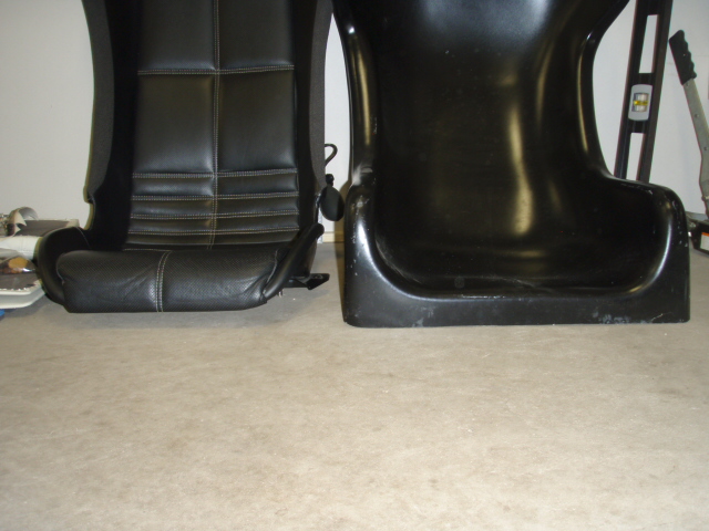

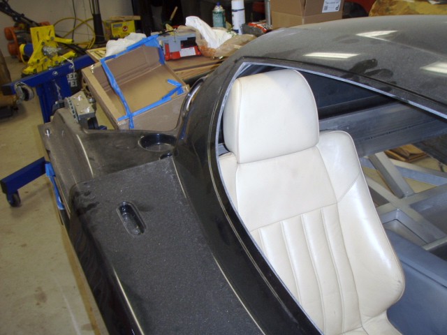

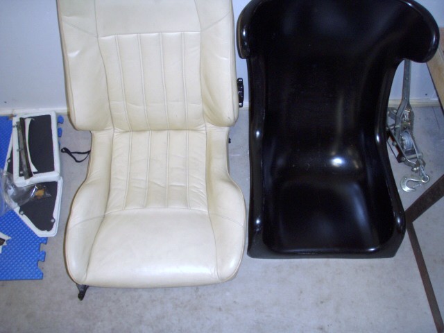

Here's another possibility - though they would require cutting down the headrest height by about 3". The seats are from a 2005 Lotus Elise, black leather, pneumatic lumbar support.
Max width at the base = 16.75" vs 19" stock
Max width at shoulders = 19.25" vs 22" stock
Max seat cushion height = 3.5" (this is a "cushion") vs 2" (rigid - without upholstery)
I'm thinking the headrest (fiberglass) could be sectioned and re-glassed and the upholstery modified to fit. Note that the Elise seat is slightly reclined in the photos to compensate for the headrest height. Here are some pictures:
Dave L

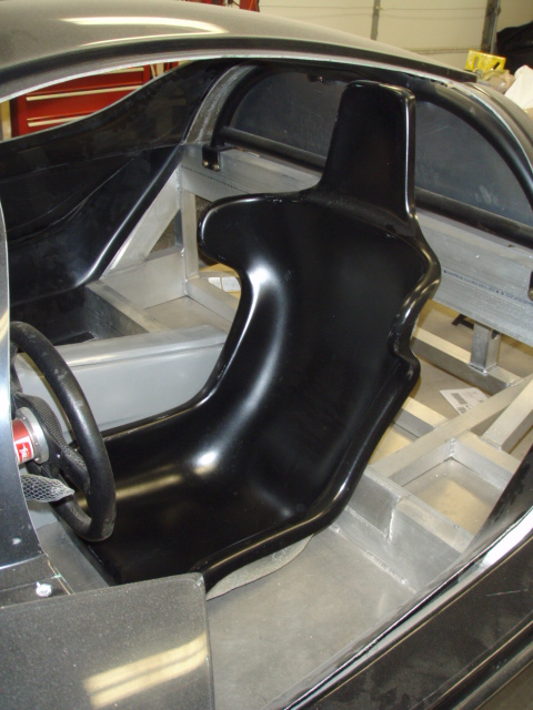

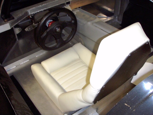

Another seat eliminated - Lotus Esprit seats (S1, S2, Turbo, SE, V8 - they all use the same basic frame). A friend was kind enough to let me trial fit his SE and V8 seats - it didn't take long to figure out they won't fit - the seat base is too long and the upper part of the seat is too wide. The search continues.....
Dave L

The Bride Stradia seats fit in the SL-C very well. It's how you would fit in the Bride seat that's the issue. They are very tight in the shoulder/rib area, perfect for aggresive track driving but not comfortable getting into and out of. They look great and fit the car's style but it's whether you'd be comfortable in them or not.
2 BRIDE STRADIA VERSION II LOW MAX BLACK RACING SEATS | eBay
The Cipher Racing seats also fit in the SL-C. Plenty of room in the shoulder/rib and leg area. Problem is they have too much padding in the seat bottom and back so although the seat itself fits nicely I'd say if you're over 5'9 the padding will place your head up too high.
