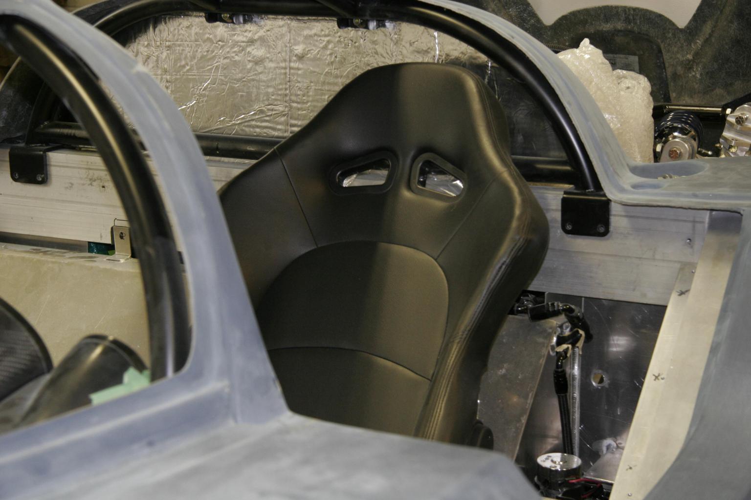

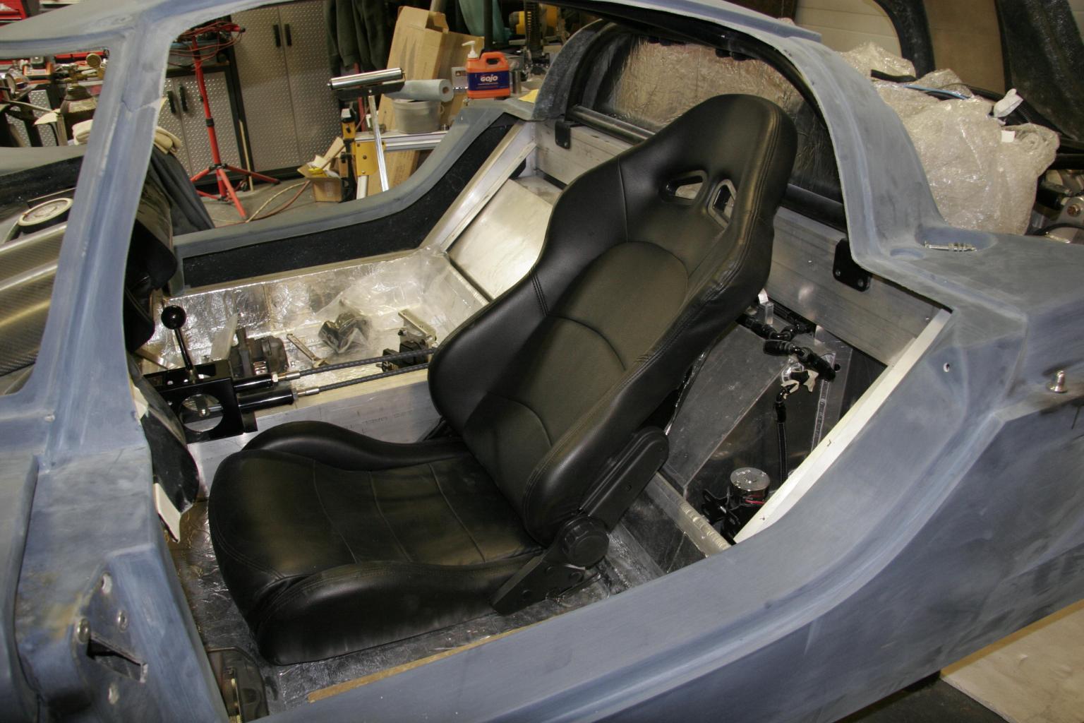

I have been looking real hard for seats that would fit me and I think I have found some from performance world it's there Pro seat and very reasonably priced at $229.00 each. They fit but the passenger side
is just a little tighter then I like so I am having them altered slightly. I will post some pic's when I get them back. Very much like Allan's.

Sorry people I mean't to post these pic's a while back these are the Pro seat's. I had to take them in and have the lower seat scooped out they are still small for me but they are as big as they can be and still fit in the Car. For the price I don't think you can beat them, they are quite nice and they look and feel like leather. I did how ever get bent over by the Upholster as he charged me more for the mods then the seats cost and I after seeing how they come apart I would have been an easy DIY. These will work for the average Joe, but due to my size, I have now confirmed if I want comfort I will need to build my own custom seats from scratch.
Cheers,
Grant

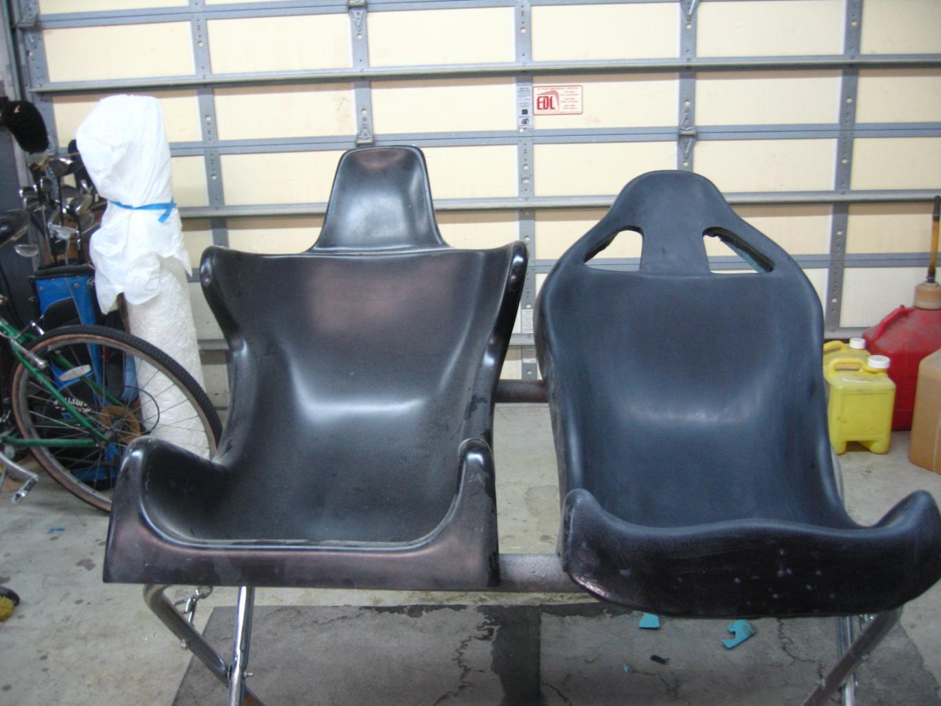

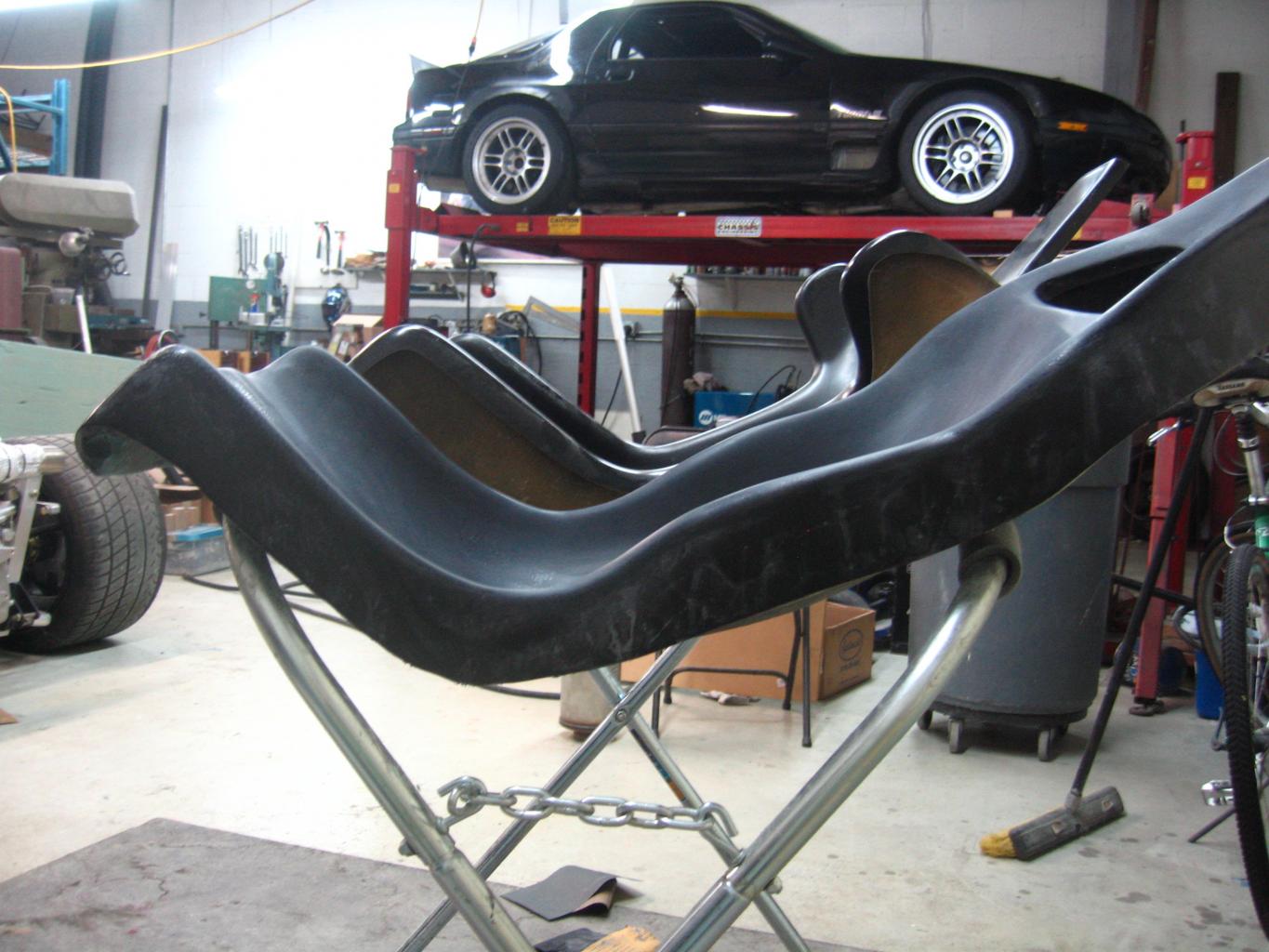

This is what I did to settle my seat options. I cut up the existing RCR seat and reshaped and added sections. Another owner did something very similar. The new version shown is an unfinished plug, which is the reason for the large flange around perimeter.
I have some additional pics of the work in progress.

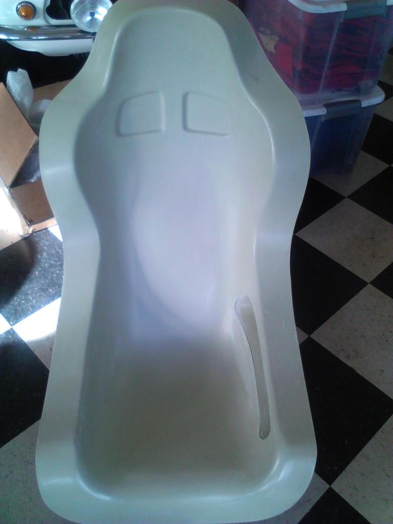

That looks very like our new seat...
you can see that this only has the mounting pocket mounted on one side of the mock up currently but it will actually be on both sides..
This seat will also be available in the standard and also the "gentlemans" seat option ...the back of the seat will also be fully enclosed with a class A finished surface on the rear of the seat...making it stronger and also more street style.
This seat is much less enveloping than the current seat
A Carbon option will also be available
No pricing yet..
