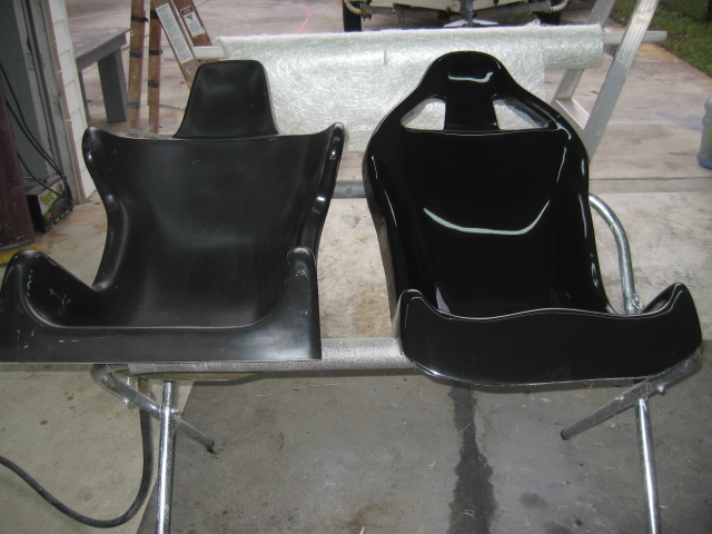

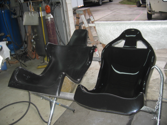

To much bolster? OMG! Check out the second pic on post 84. I removed almost all of the stock bolsters. The little bit I added back I flared out, providing much more room. I'm 5'10" with a small frame and felt like I was in a NASCAR style seat. I added the hump between the legs to help keep me in the seat (it looks really good too). Having a bad back, I was unable to get out of seat then exit the car. Now I can swivel my legs out easily and my right tricep doesn't hit the shoulder bolster when shifting. I am very pleased with the outcome of the plug.
I planned on the tillet B5's, but my seat is very close in measurements for a fraction of the price. If we are successful with cf, any slight difference will be hardly noticeable.
I was able to find some time to get in the shop. The plug is polished and 10 coats of wax. Now a some PVA and the mold will begin.

Thanks Dave.
I laid up the first layer of fiberglass last night. I will experiment with bagging with a couple of smaller parts (maybe my front fender vents) first, then do the seats this way. Eventually I want to learn vacuum infusion and CF. Wet wet wet is all I know.:thumbsdown:
Dave Lindemann
There's definitely nothing wrong with a wet lay-up for a mold - especially if you layed down a single layer to start to minimize air bubbles like you did. I'm new to vacuum bagging but so far I'm amazed at how well it works - no air bubbles, reduced resin weight, and it forces the fiberglass to conform to every curve. Good luck and I'm anxious to see your finished product!

That is a great looking seat! Put me on the list for one if you decide to offer a few to the group. I would even tell you if you get one that isn't good enough for a street car, let me know. My race car won't mind a few imperfections.
Nice work. I might also be interested. Currently exploring Tillett B4, B5 or Elise/Exige seats, though those get sucked up quickly by the Miata crowd and the Tilletts are not exactly cheap...
Tim
Thanks for the interest, but I don't want to get into the composite business and wouldn't step on Fran. I'm sure his new seat is a lot nicer then mine anyway. I have about 40 hrs in the plug and to recoup some of the cost would drive price up.
Dean my first seat probably won't meet the standards of a street seat so I'll keep you in mind.
