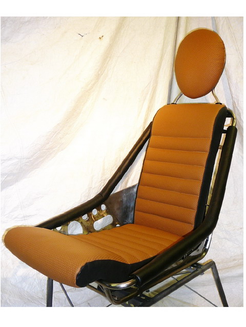

Has any one ever seen these seats ?
Hot Rod Zeppelin Car Seats - Hot Rod Zeppelin
I am thinking they may fit us larger types : )
this one is kinda ugly but with some nicer upholstery and a head rest change it could be nice? These guys make them custom so any changes should not be a problem. They also have one called the Pan Am which should work as well but lot more money.
Great find. Even if you don't find the perfect seat...they seem like the kind of place that can make you just about anything you can dream up. I would've called these guys with ideas...but I blew my wad on Tillets.

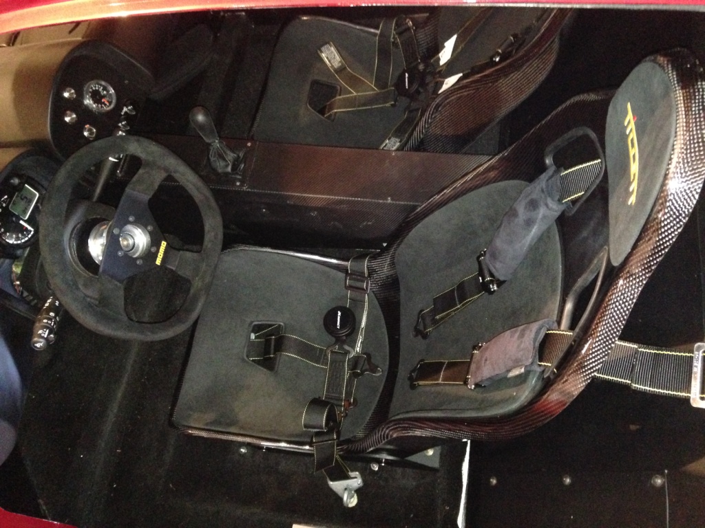

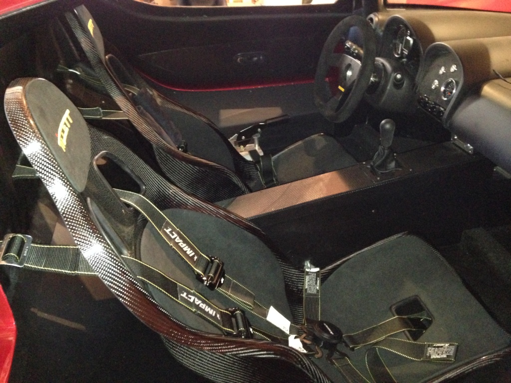

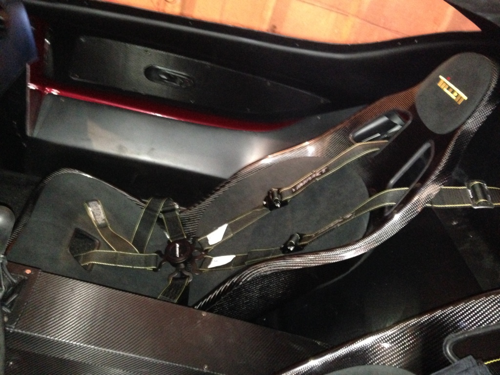

Well - after an exhaustive search I switched out my GTM seats and installed the Tillett B'5s. I gained a bunch of real estate and these seats keep me in place. The passenger side has less install wiggle room but tons of area on the drivers side. These fit my body/build (a hair under 6' 185-190lbs.) but likely would not be comfortable for "larger" persons. The B4's have another 10 degree lean-back and higher bolsters so I did not go that route. I used the tillett TB3 seat rails bolted directly to the floor. I apologize for the phone picture resolution.
