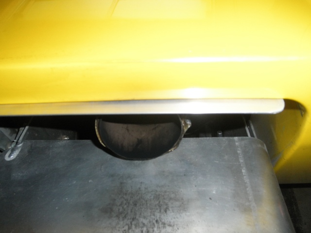

Roberto, i brought my exhaust up oiver the rear crossmember so it got forced close to the bottom of the rear clip. I cut it about square witht eh rear clip so the clip scould swing around it. i started to melt the bottom of it so i put in a strip of Al. not a problem since.

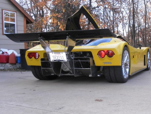

Why not run the pipping/tips through one of the 'shelves' on the diffuser? That's my plan.
1st shelf is too narrow unless you wanna run 2" exhaust...nah...! 2nd shelf causes you to bend around the driveshaft. then you've gotta hit the "v" between the 2 unprights just so. Probabaly a better exit route but more work / back pressure.

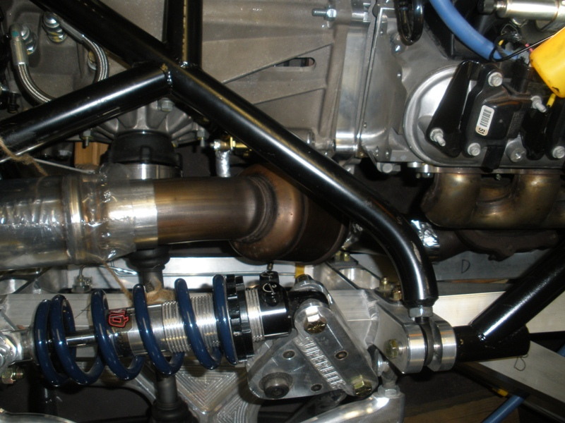

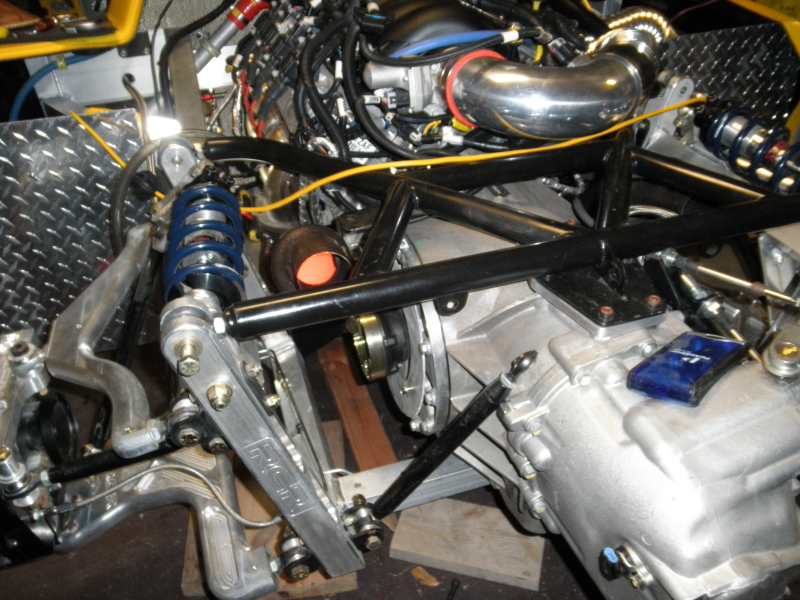

Cam thanks for the pic (sorry so late in responding to my own thread). Would you mind posting some other pics from different angles? I'm assuming that's 3"?
These might help? I just chopped up 3 3"ss j-bends and mingled those parts with LS7 take off parts. The Al added on the rear clip is 2" x 3/16" x ~40" as a heat guard. looks like it was meant to be there. the 3" exhaust deosnt seem to bother the F/G. Where the gases exit, it eats it tho.

Cam, do you have any pics of your finished engine bay? I was looking how you ran your air intake pipe and it looks like it's impossible to install the rear diagonal brace since it's blocking that point?
Thanks Cam. I was looking for the exit pics with the diffuser. Allan's schedule has been booked and I haven't made it up to his house to look at and mock up the diffuser in person yet.
