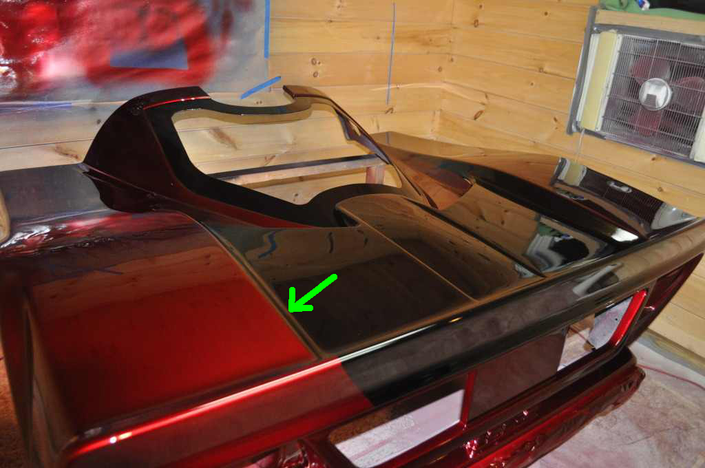

Time to "Kobe" up. I'd suggest 1+ carets.
Is this a gold pinstripe here (see attached photo), or is this how the light is playing on the body lines? Beautiful paint. Amazing, really.
Eric
No gold stripe, that's a reflection. My engine accessories came in, but Hurricane Irene has thrown a monkey wrench in the schedule... couldn't work on it all weekend. Half of CT is without power.
