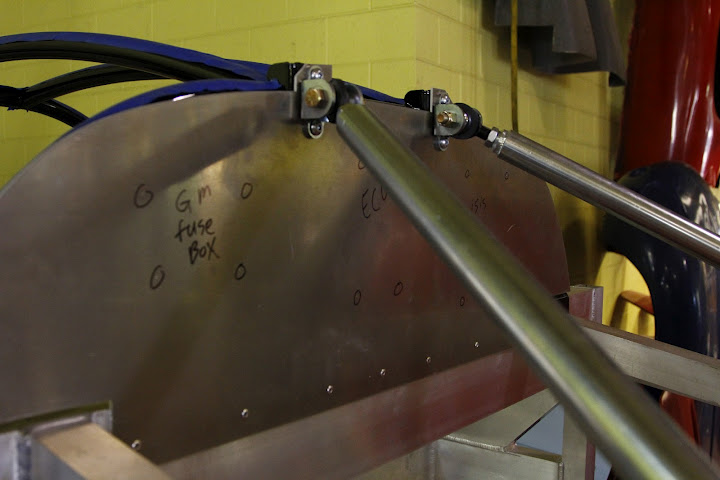

Fran's crew is pre-marking and drilling the location for the GM fuse box. Would the box fit below the coolant tank, or would it need to be moved to a new location?

Ben - Unfortunately, that fuse box location is right where the tank would mount. The box would need to be moved down below the tank, more to the passenger's side, or to another location.

I'd be all over that at 175, nice work Dave! This really is the best location for the coolant tank, Ben just put your fuse box in a different location. Easy enough, really.
