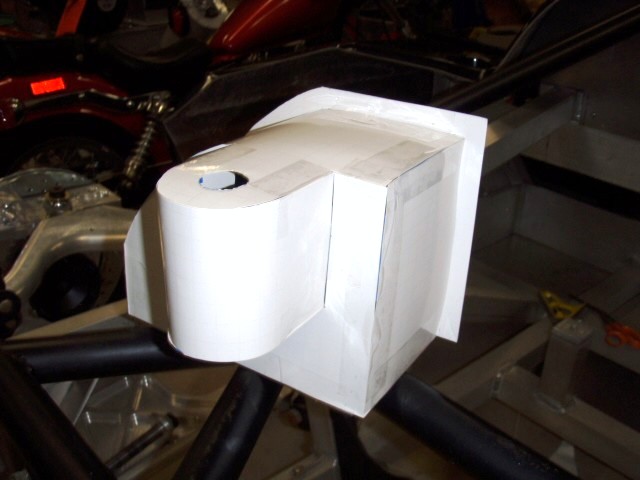

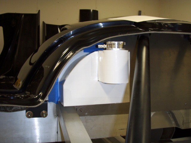

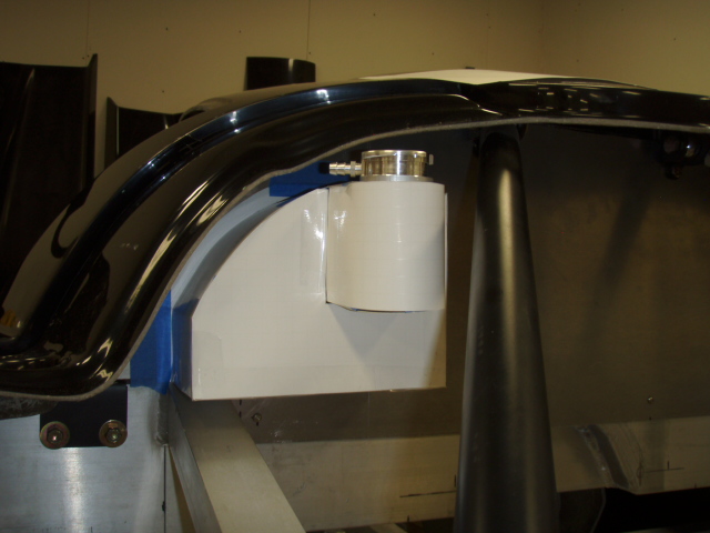

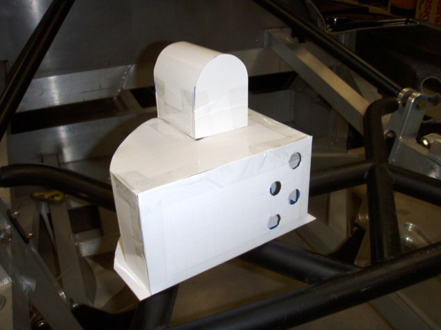

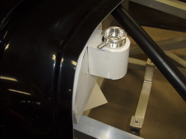

I wanted to confirm that my CAD drawing was reasonably accurate so I drew out and cut the components from poster board as accurately as possible, taped it together and did a trial fit. Looks good to go. I'll be ordering the CNC cut aluminum and all of the weld-on parts today. The aluminum will take about 2 weeks to receive then the welding begins - that'll probably take another couple of weeks.

Hard to tell from the photos, but how is the clearance for the cap, and what would be the maximum length I could use for stand-offs?
Dave Lindemann
Ben -
Cap clearance should not be an issue - the rear clam has about a 1/2" lip that sits on the forward edge of the spider. In other words the rear clam is convex above the tank cap.
I honestly don't think stand-offs are needed. I plan to insulate the bulkhead then install the tank. However, if you really want stand-offs I'd estimate 1/4"-3/8".
