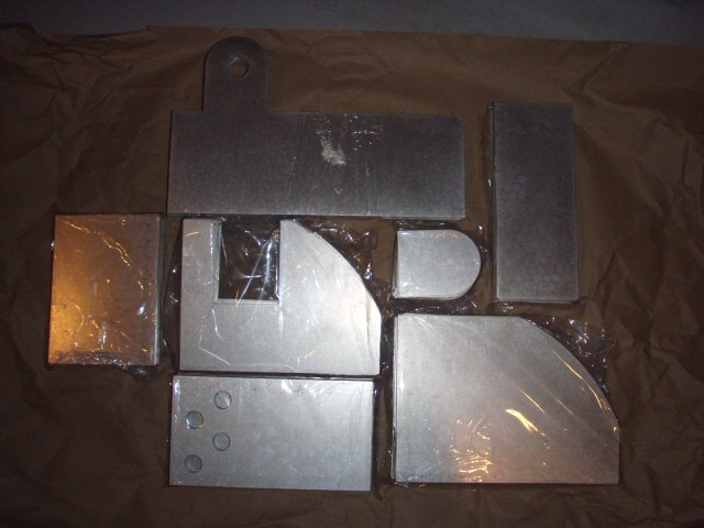

Dave Lindemann
Will wonders never cease - a vendor that delivers a day early! Sorry for the poor quality of the photo. Off to the welder tomorrow.
Dave L

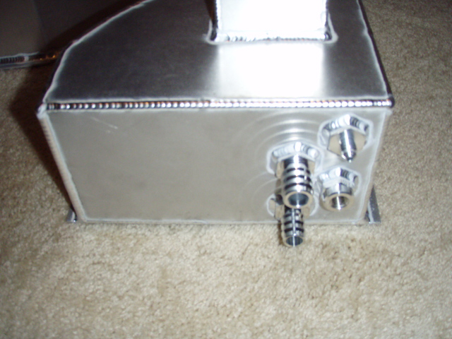

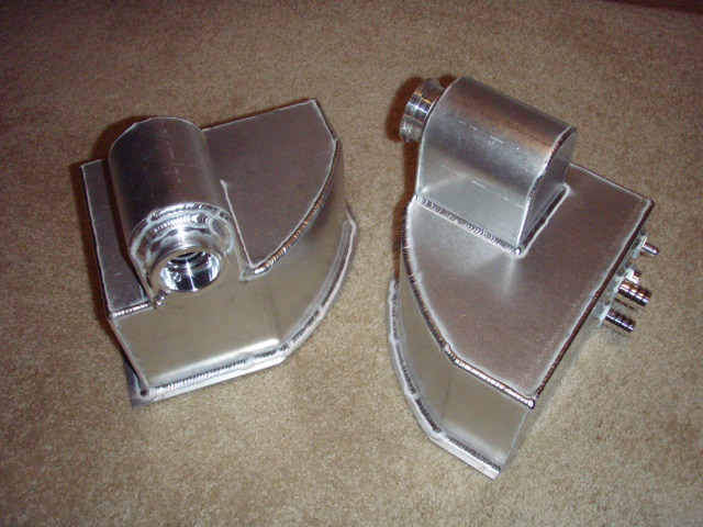

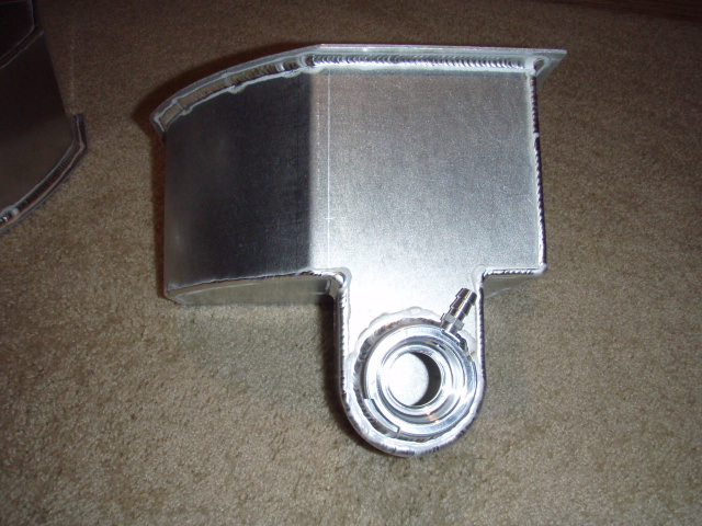

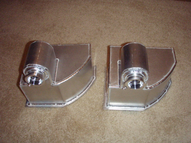

Well, I have some good news and some bad news.......
The good news is that 2 of the tanks are finished and in my hands and they look amazing! Tanks are fabricated of 5052 aluminum, sheet aluminum was professionally formed and welded. They really turned out better than I had hoped.
So, what's the bad news.....the "forming" was unanticipated ;-(
Here's the cost breakdown -
Fittings (billet filler neck, 5/8" and 3/4" hose barbs, AN4 (female), 1/4" NPT) = $74.05/tank.
5052 aluminum, water jet cut = $43.40/tank.
Welding and forming - $105/tank.
Total cost = $222.45/tank + shipping.
Here's the other issue - I'm leaving town on Sunday for 3 weeks. So, while all of the tanks will be finished next week I won't be able to ship them until the end of the month. I know of at least one person who has a basically finished SLC and wanted a tank - if he's still interested I'll ship it tomorrow.
I apologize for the higher than anticipated cost - but the tanks really do look good!
Dave L

Dave: The tanks look good. I am curious about what you have done with the back side of the tank for mounting bosses, etc to allow attachment of the tank to the firewall. I haven't seen any pictures of the back side of the tank.
Dave Lindemann
John -
Sorry for the slow response - I'm out of state at the moment. The back of the tank is flat. If buyers want to mount the tank off of the bulkhead my suggestion is to use a non-threaded stand-off. If you are insulating the bulkhead (either front and/or rear - I'm doing both) then I don't think stand-offs are needed. Tank mounting to the bulkhead is pretty basic - I plan to use 1/4-28 bolts with nylok nuts. You can drill your own holes in the mounting flange where you see fit, I don't see the need for more than 4.
