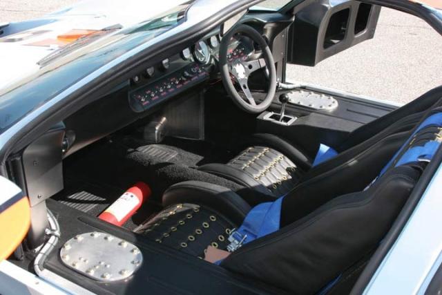

When I look at this picture of a car I am pretty sure Fran did, it is a loooong way from the finish work on this SLC here, but is more in keeping what I think a well done car will be.
