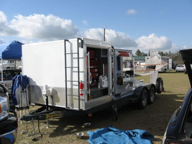

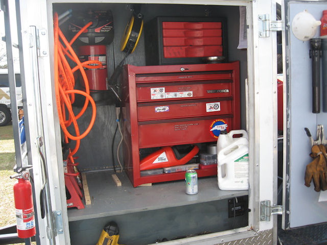

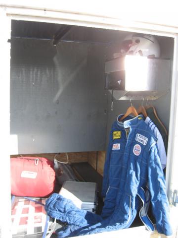

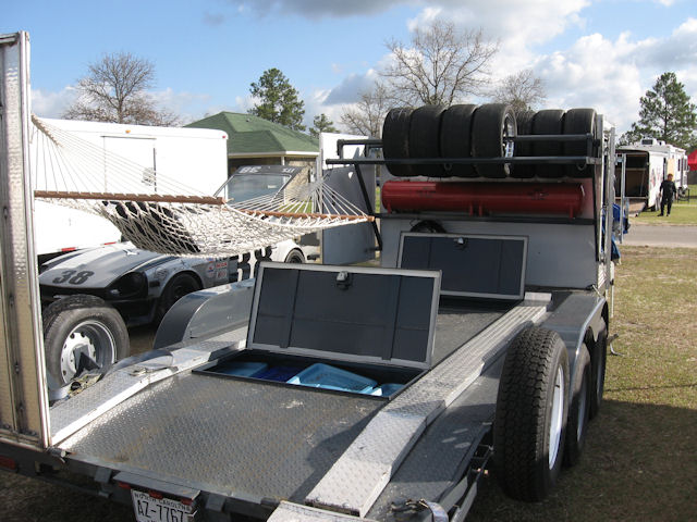

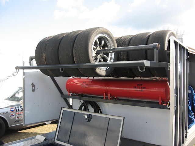

My new trailer is "self powered". I got tired of worrying about if I'd make it to the paddock in time to get a spot with 110V hookup.
I have two deep cycle marine batteries in a special power compartment built into the bottom of the trailer. These two batteries are connected to a 3000W DC inverter to provide 110V power to run the impact gun, air compressor, lights, and the AC unit. The batteries also power the 12V fluorescent lights and the stereo system.
The DC inverter can be plugged in and it'll charge the batteries. However, to avoid having to fool with that I have a 100W solar panel mounted on the front of the trailer that can be pivoted for best angle of sun. This is fed through a charge controller to charge the batteries. Thus far in three race weekends I've not run out of power and the system seems to be sufficient for keeping the batteries topped up (note - the batteries ARE NOT connected to the truck charging system or trailer lighting, they are 100% independent and only charged with the solar panel).
Here are a few pictures of the trailer before the solar panel, AC, stereo, and sleeping quarters. Yes, I sleep in it and it works great!
