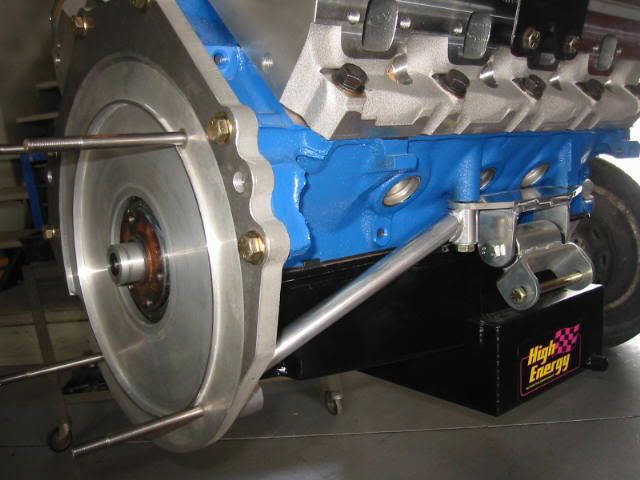

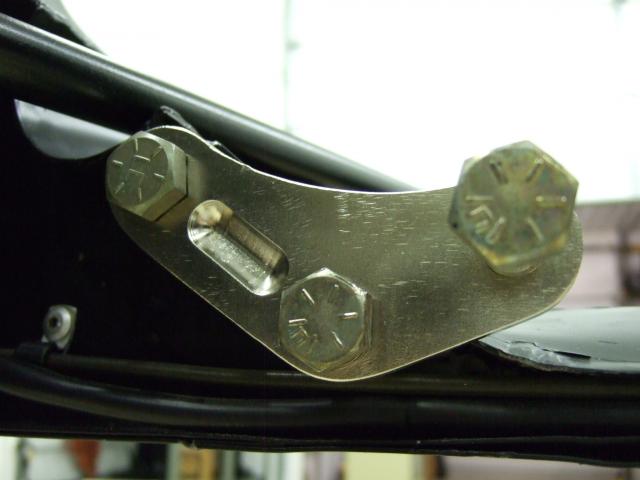

I also have mine mounted solidly. Although I am not on the road yet, I can tell there is little vibration the few times I had mine cranked. I also internally balanced mine and be aware it is not a cheap option to add the special lead to the crank throws. Although mine is not as elegant as Mikes I obtained some tubular steel and bent it to the contour of the trans and added some tabs to grab some of the side nuts. I then triangulated it to the frame.
I have a lot of other examples.
Here is one that they actually braced the trans from flexing.Probably not a bad idea if you decide not to hard mount the trans.

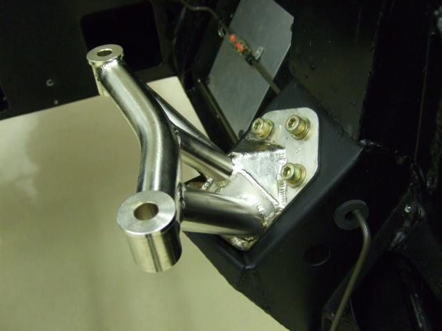

Skinny Man

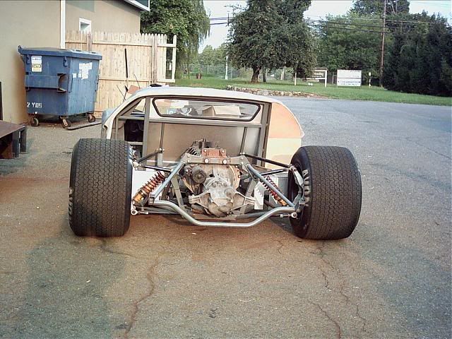

I've use solid mounts before for the entire drivetrain components and never noticed any additional vibration (engine was well balanced though). My current project has solid mounts, but it's an LS2 instead of a 302. I swapped sides, and flipped them over in order to solidly mount them and simultaneously clear the dry sump pump.
Then I solidly connected the KEP adapter plate to the same rails, and lastly, fabbed up an aluminum plate that supports the bottom of the 930 case at the rear.

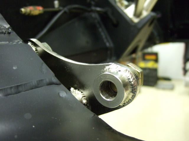

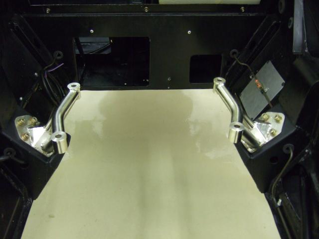

Hi Terry, sorry, just found this thread again. My GT40 has an LS2, and I have tried what you've done there. Sadly, have less room than that, so have had all new parts laser cut and am having a local TIG guru assemble the whole lot.
Great pics, would love to see a few more of your project.
