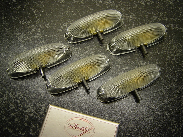

I know I am not building a Monocoque car but I have tried to use as many original parts as possible. I think this is getting out of hand considering what I just paid for a NOS interior light out of Germany.. However they seem to be as rare as hen's teeth as I have been looking for over a year. The hunt is fun. Original shield pattern headlamps are on their way from France along with some Vitaloni mirrors.

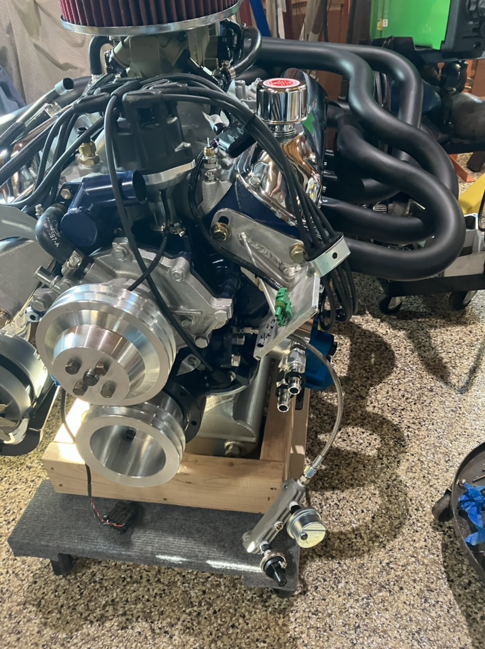

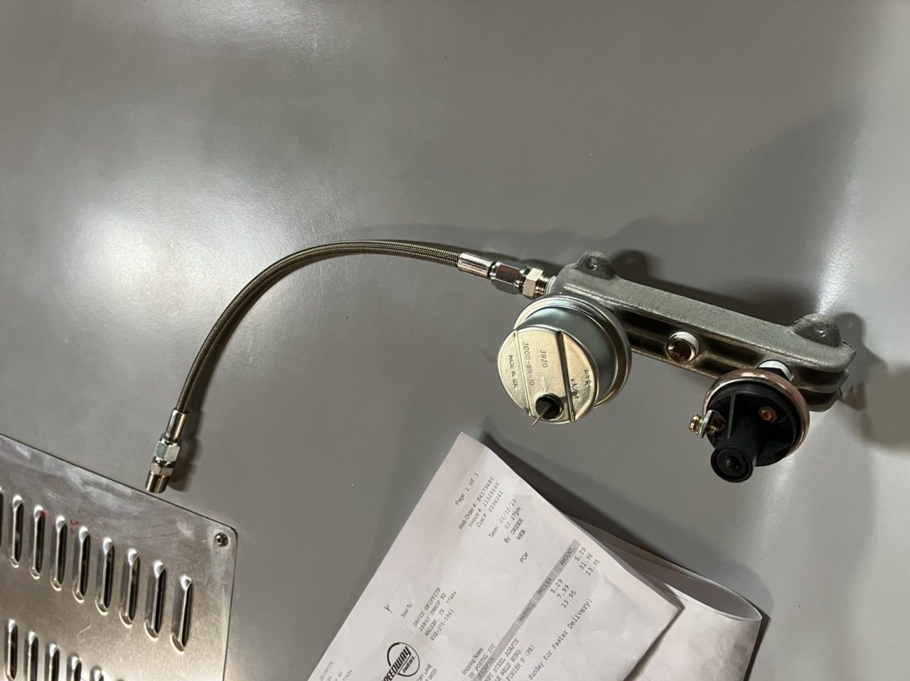

I did not want a oil pressure sending unit hanging off a tube in the side of the block. Found a neat little 3 port fuel distribution block at Speedway motors. Some adapters AN fittings and a hose. This also frees up room for the AC compressor to sit lower
isn't there another oil pressure block off port at the back starbord side of the block that can be used as well or is that into the water jacket?
