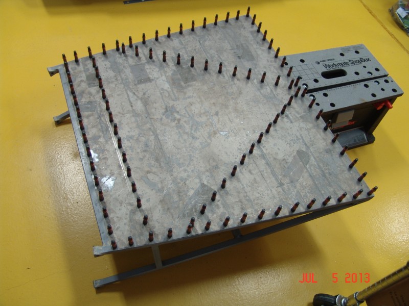

Your project looks very nice. I've always wondered (but never asked) what aluminum alloys and what rivets other people use on their builds?
For my underside stressed panel I used 0.060" 7075-T6 and 451 5/32" CherryMax blind rivets. The panel is finished with a 2-part epoxy zinc chromate primer.
Regards, Neil Tucson, AZ

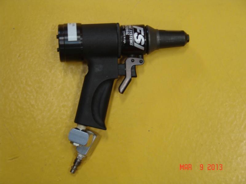

Yes, I did not pull those 451 rivets by hand. I have an FSI air/hydraulic riveter. The CherryMax rivets are 15-7PH stem with a monel body. These are FAR too strong for manual installation- even Popeye could not pull them with a hand tool.

Neil that is a tidy piece of kit!! I have been told even those that can be done by hand the number we have to do its well worth investing in an air powered one, as you say not enough spinach in the world !!

You'll need the big Gespia PowerBird Gold or Pro. The smaller electric rivet guns won't touch high-strength aircraft rivets.

The things I like about the FSI PT-100 riveter are that it has a pull of 4,000 lbs and only weighs 30 ounces. Its light weight is a welcome feature when I'm pulling so many rivets.

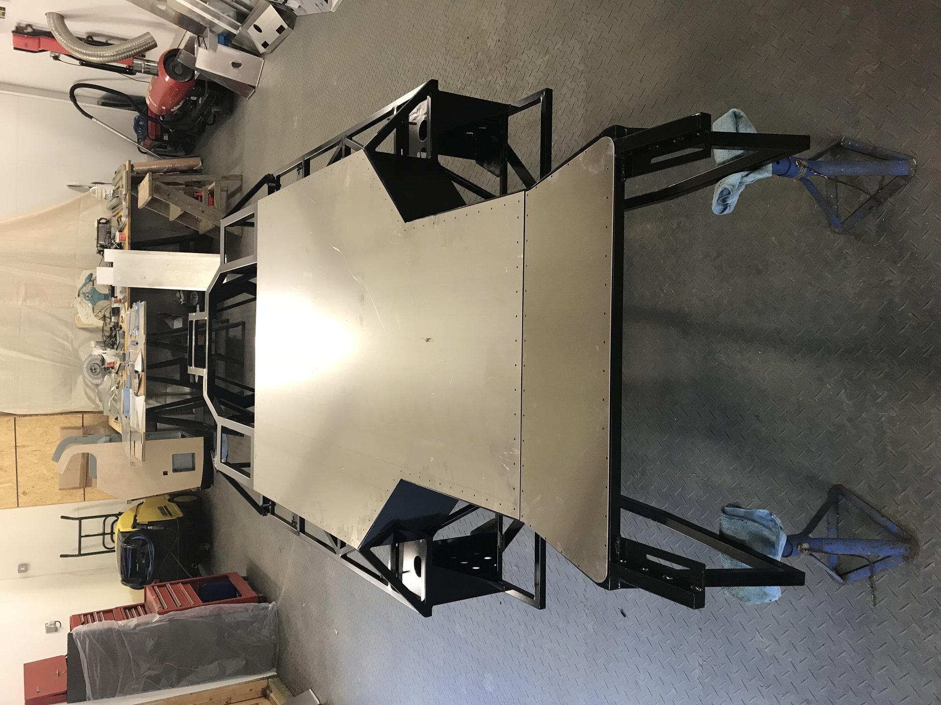

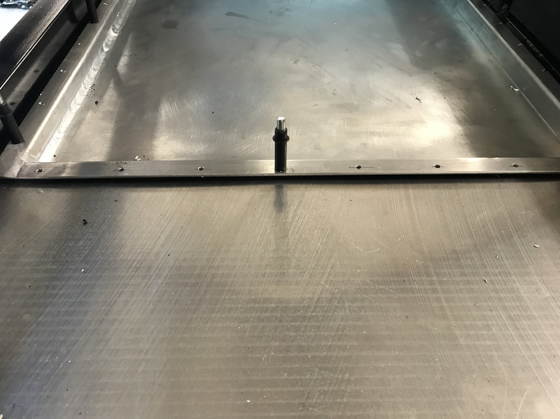

Ok so quick update, lots of looking and delaying the first step, checking then checking again and sleeves up and off we go. Floor pan now on and riveted, will spin it over tomorrow onto my new stands (Cheers Paul) and start panelling the upper body working my way through the panels now all sitting round the workshop walls.
So far so good, only tips I would have for this early stage are don't use too much bonding adhesive, I was forewarned on this as its very liquid, well not the first tube as that was like solid Dunlop rubber, turned out it was 2 years past its sell by date!! Also put all the rivets in loose before firing them home (and use a rivet gun!!) as otherwise again due to the liquidity of the adhesive it will squirt out the rivet holes. Nothing that a bit of Cellulose Thinners wont tidy though whilst wet.
First job when spun will be riveting the centre tunnel (I bonded it and used a lot of weights to hold it right down) then cut out my nice new floor pan to fit the lowered sections as I am a tall bugger. Still gives me some alloy for the odd brackets.
Shaun
Ok quick update, floor fitted, cut for the lowered floor pans which was somewhat nerve-racking, was not totally happy with the gap as one side sits atop the centre tunnel flange so I got a roll of hard rubber strip 1.5mm thick and added that to the 3 sides and it looks and sits a lot better, just need some slightly longer rivets as the 10mm ones are not long enough really so have gone 14mm.
