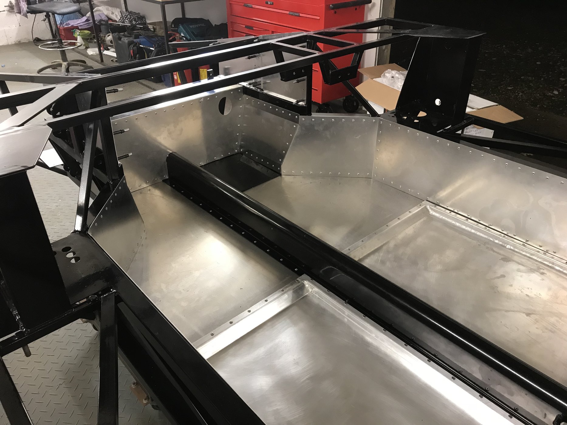

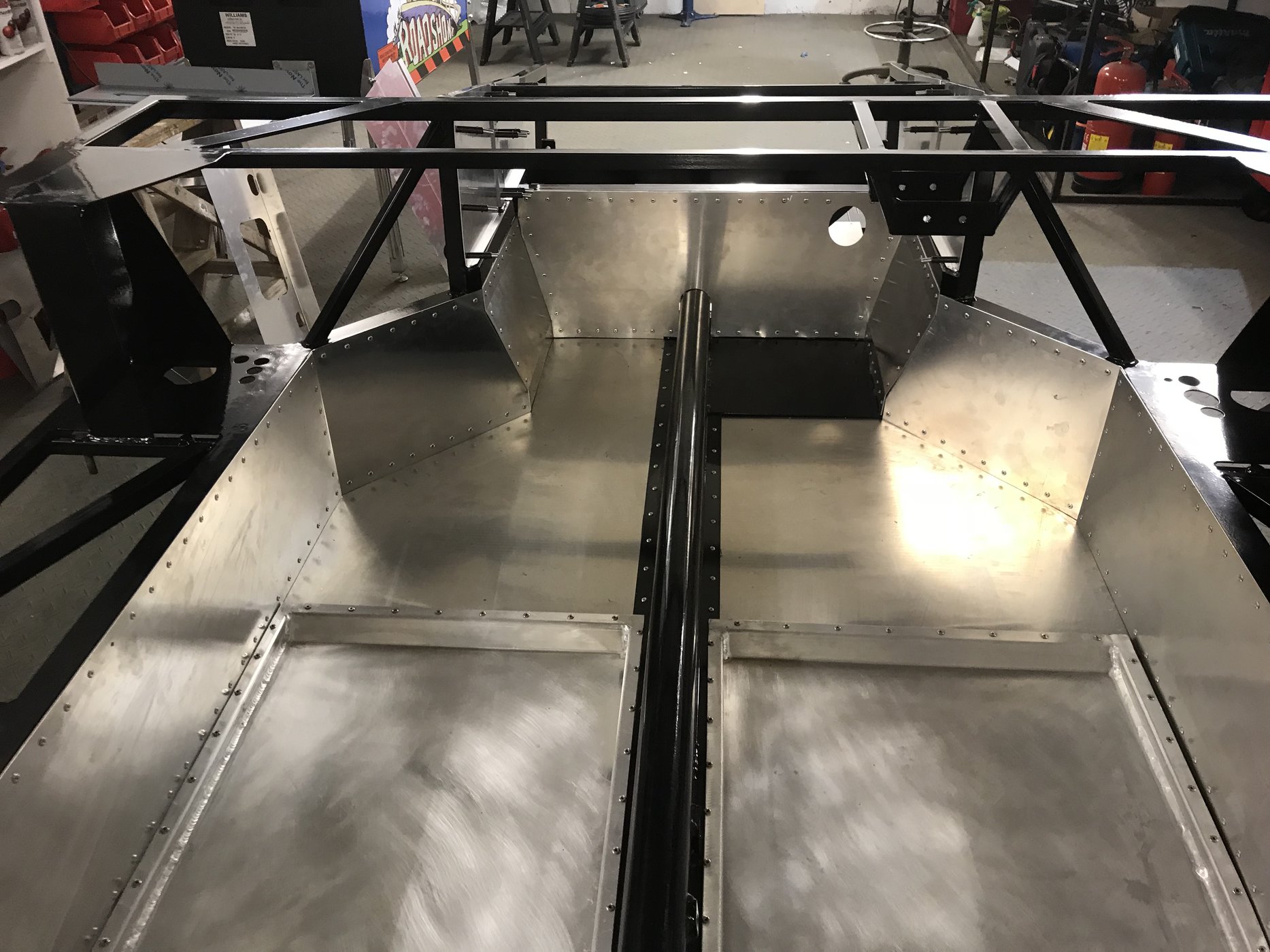

Ok few more panels fitted, mostly going very well, bit of fettling as one would expect, have dug out my band saw with a very high TPI blade and I have to say that really helps (thanks Paul for the tip) as does the rivet spacer, anyone doing this should I think have one, not much money and keeps those rivets inline and level, good for all spacing really, brake pipe clips the lot
Have not really worried about marking the panels, being as careful as I can but mine did not have any blue covering and its going to get used so the floor especially will take some pounding, will be made to a high spec but I am not a concourse man, not toothbrushes up the tailpipes for me, each to their own mind you.
So most of the inner cockpit done, fitted the lower floor pans, moving to the front now, inner sections seem ok, outers look a bit of a challenge a few ciders and some red wine will probably ease the little grey cells!!

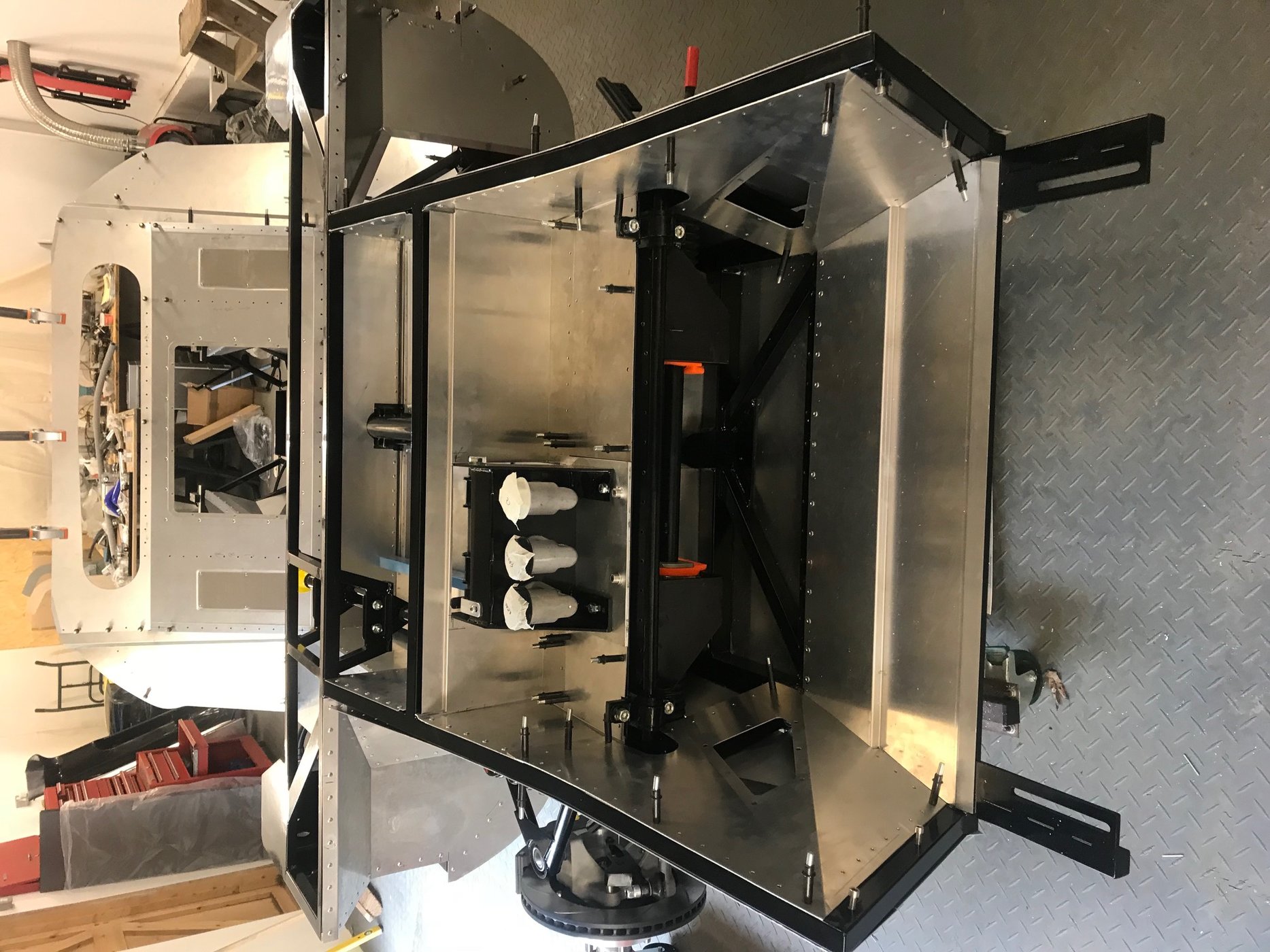

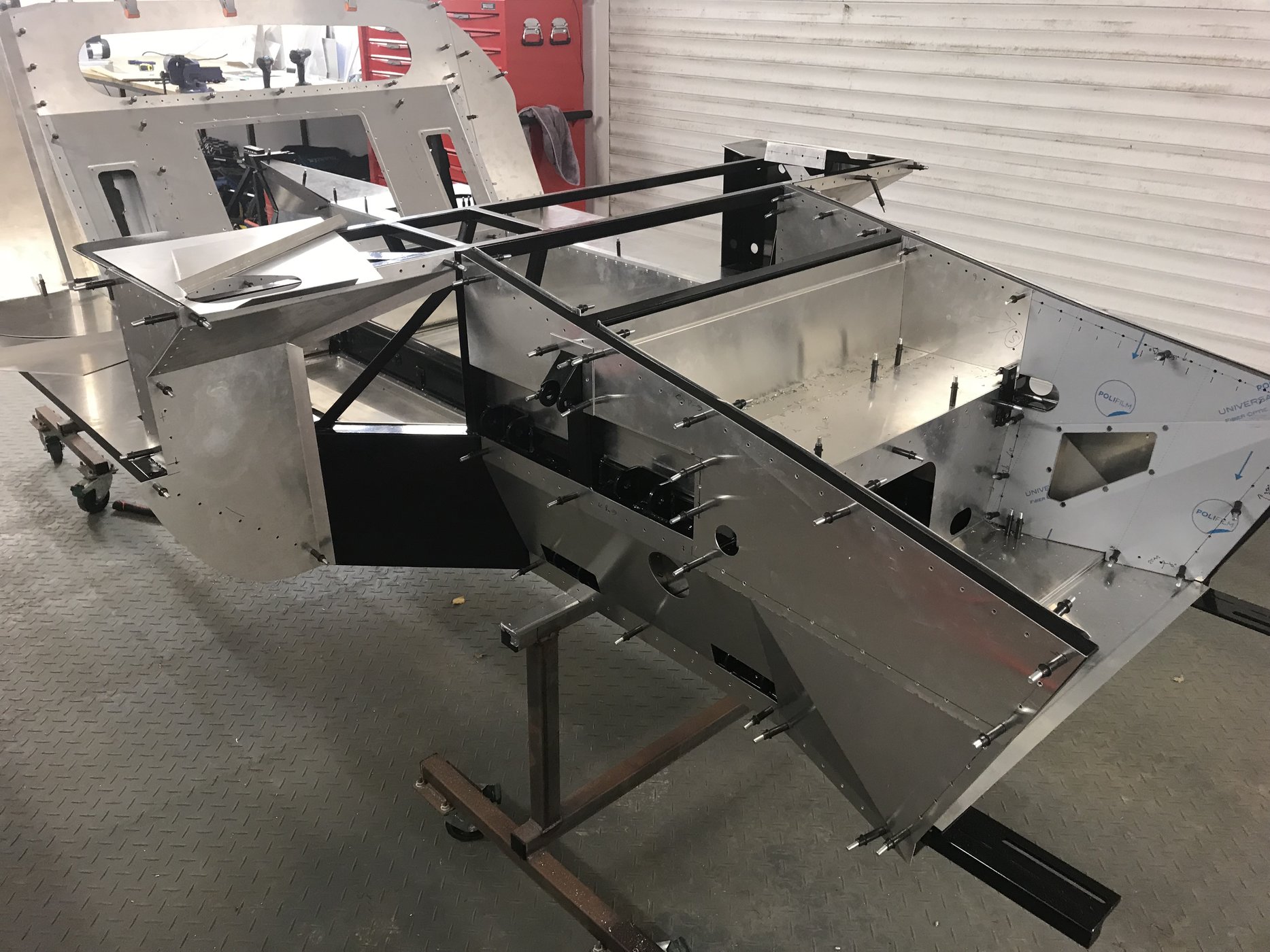

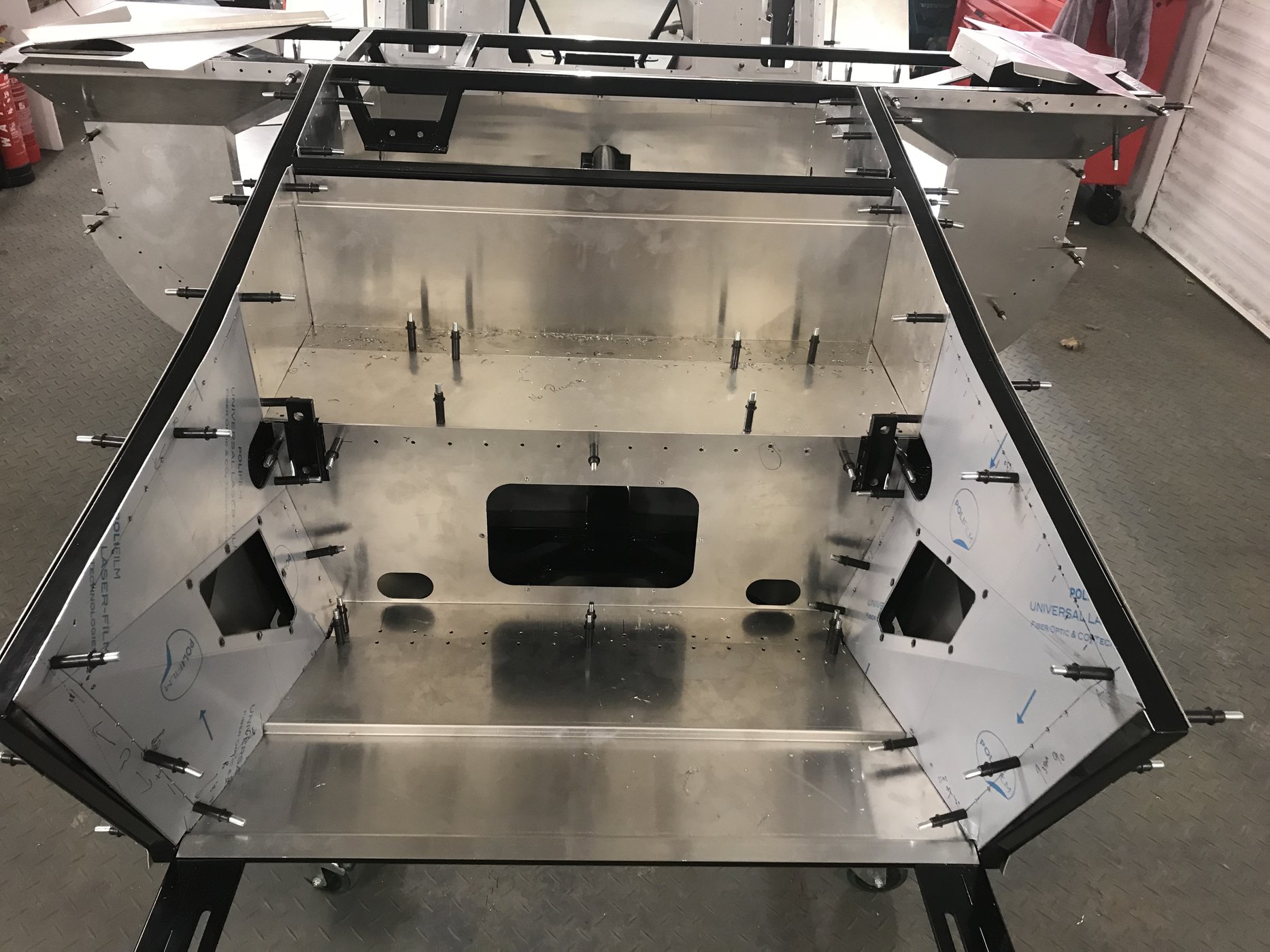

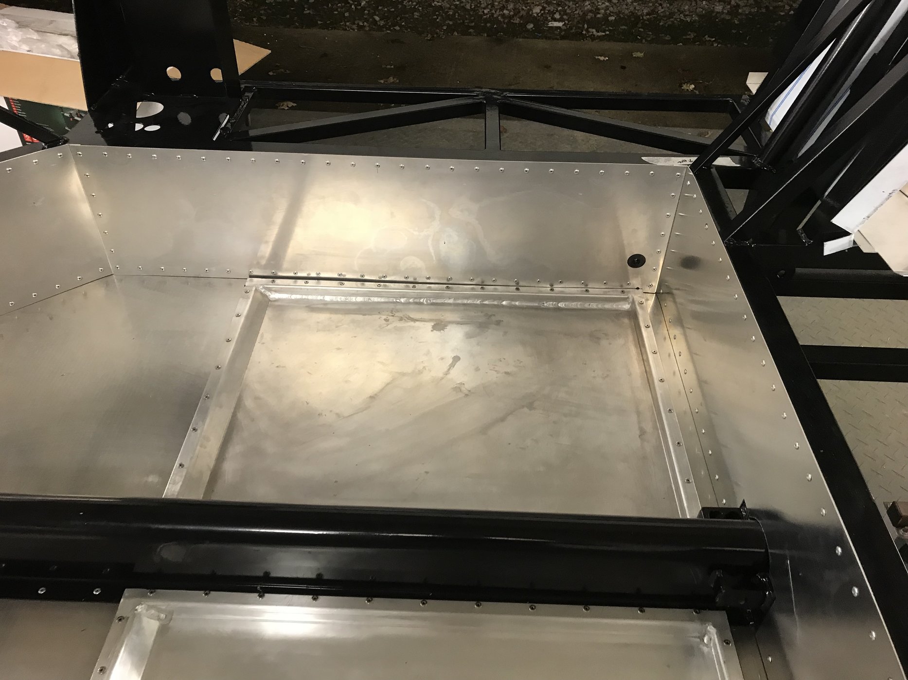

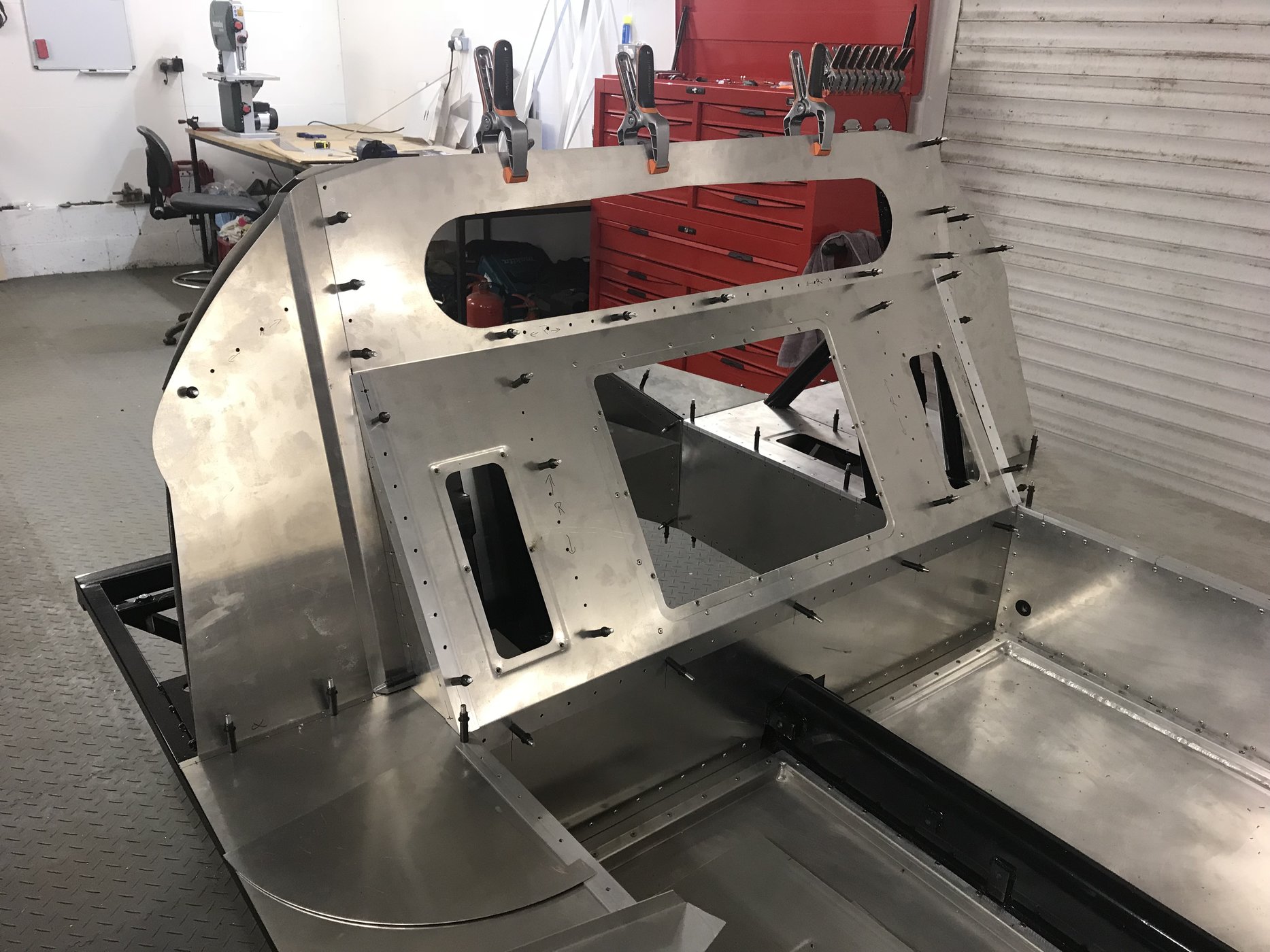

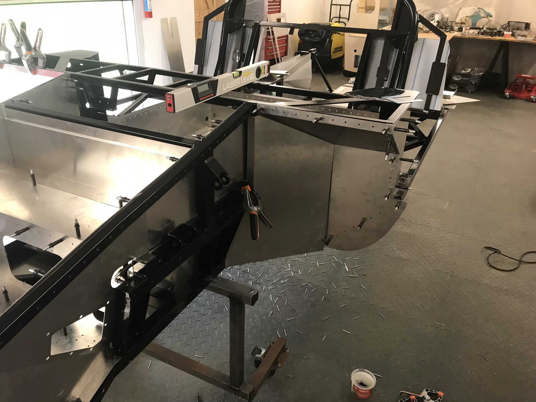

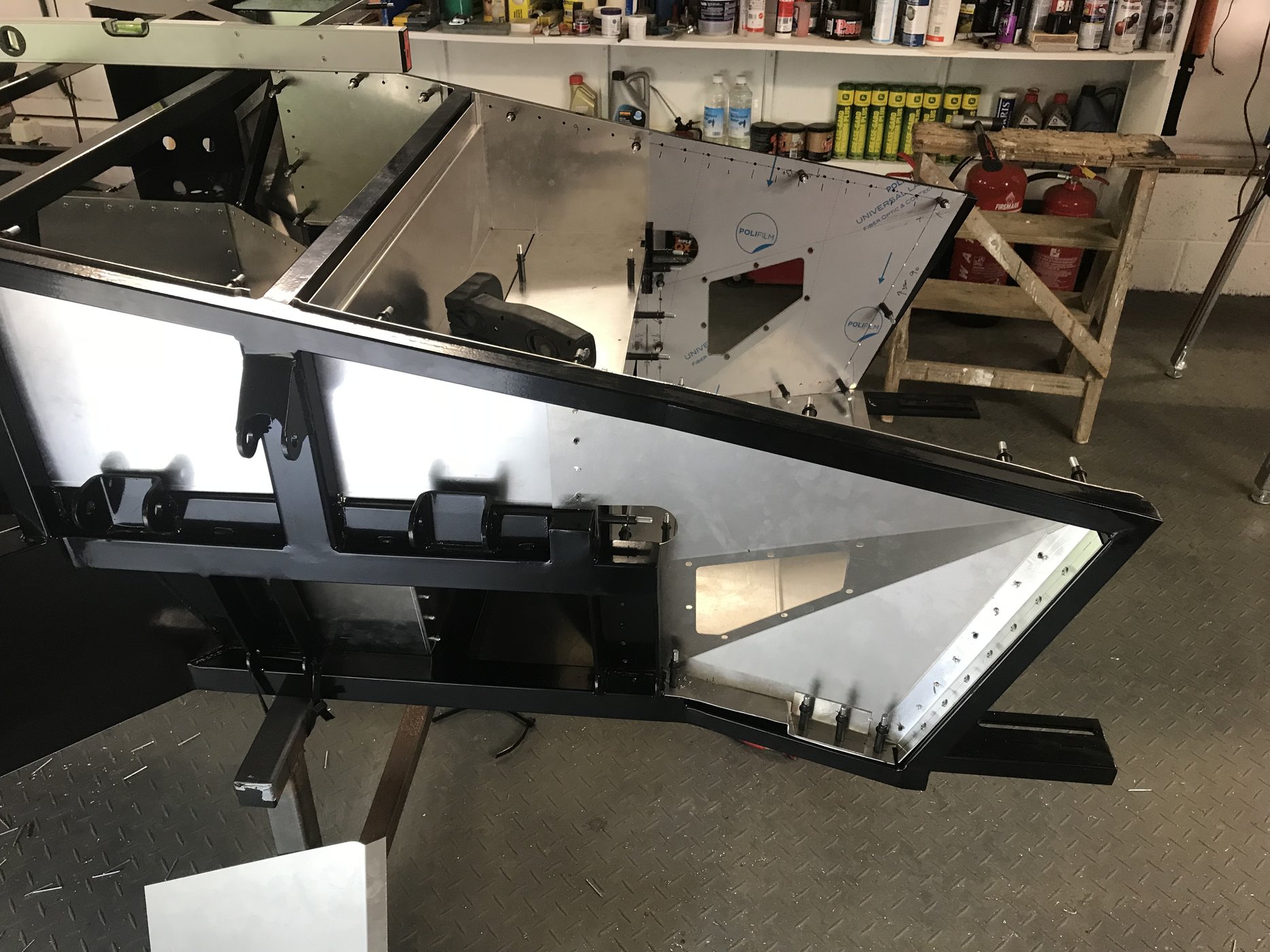

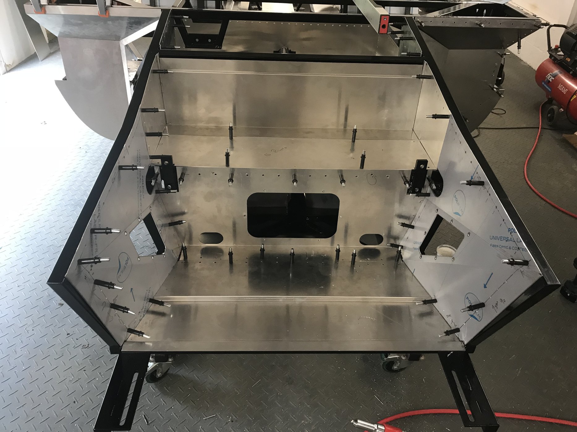

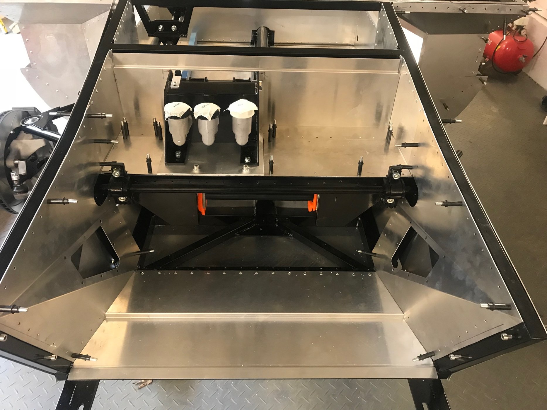

Not posted an update for a while but have been busy beavering away on panel fit, all gone pretty well, its oddly very satisfying, only a couple of minor hiccups but all easily solvable, some photos below, almost done the panels now, probably a couple of evenings and a weekend day and they will all be done and dry fitted then its on to some suspension goodies!!
front panels all but done, will need to make some cover trim caps for over the top of the box sections

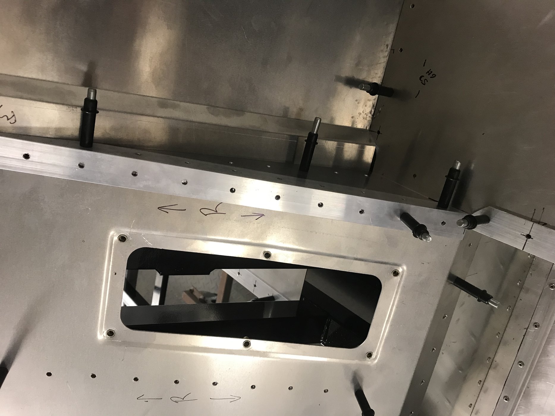

Inner wheel arch ones I still have 2 panels to fit, quite tricky that bit as a few panels come together here and they all have to align.
Bulkhead went in ok, I would recommend these clamps, they are not cheap but are very good, word of warning though, one pinged off the roll cage and flew right across the workshop!!! For those in the UK they come from Screwfix.

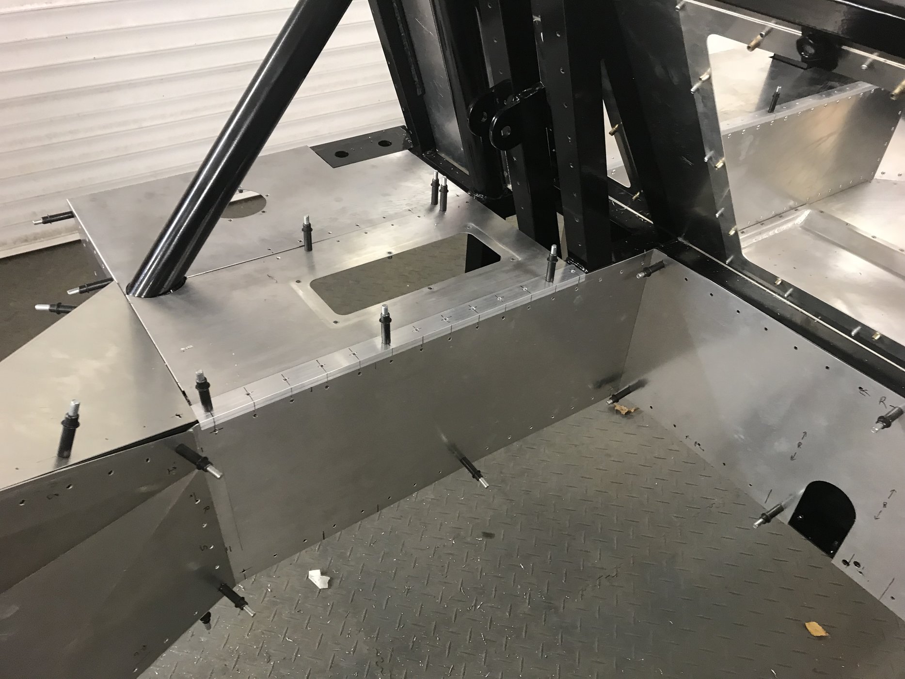

Rear section now done one side apart from some trims, lots of careful filing around the roll bar where it welds to the chassis, I wanted as close as fit as I could get.

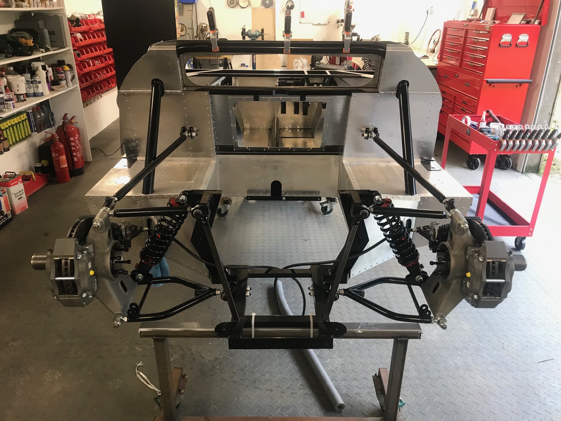

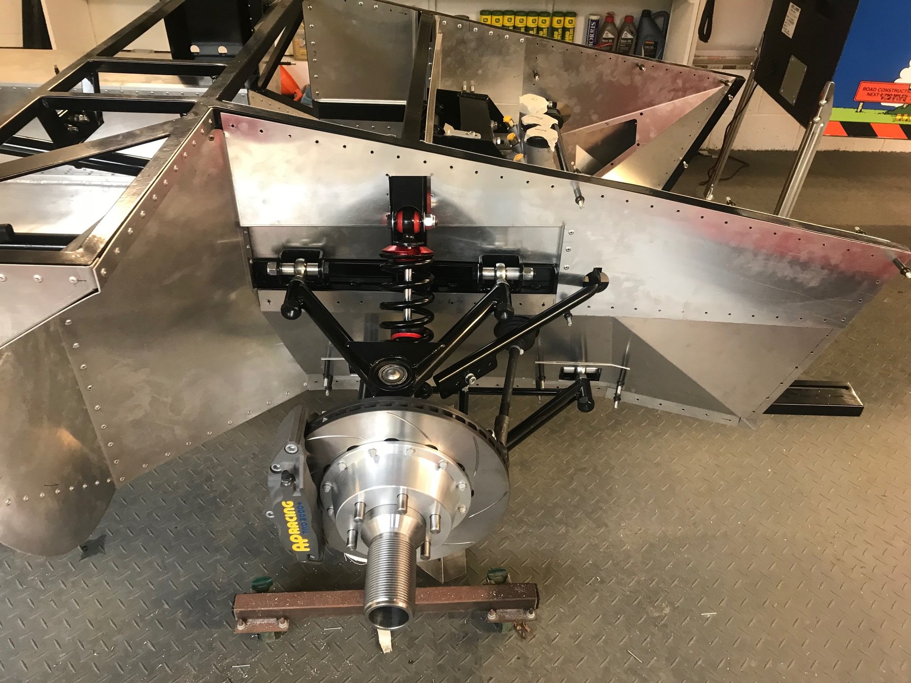

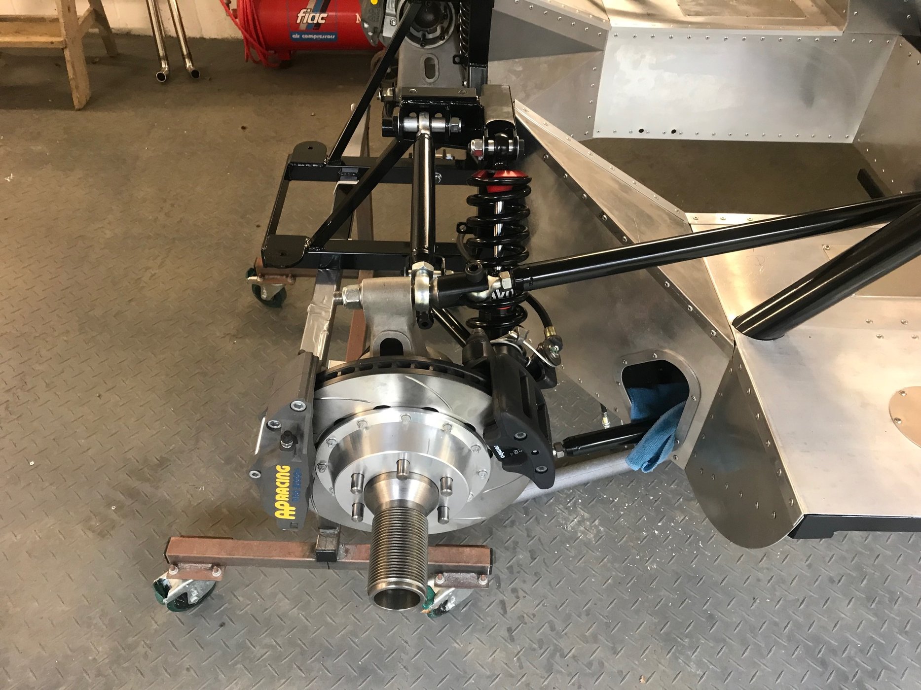

Finally remembered my camera has been far too long since an update, progress made, still very enjoyable, at a b it of a cross roads as to what to do next, thanks Paul for the chat this week really helps, panels I found simple enough as they flowed, now I am nervous about putting the "services" in and then having them in the wrong place so any thoughts appreciated, Paul and i chatted and I am currently thinking brakes, air/con, power.
Brakes would be harder to move than hoses and cables but as always fire over thoughts.
Heater box I am only using the ac part as I am going for a heated screen to avoid the tissue on the screen IVA, some builds put these in different places again any thoughts welcome, looks like a custom bracket needed to hold the box, time for shopping for brake parts and alloy!!
Plus if anyone ideas about pipe routing on a SGT please feel free to share.
