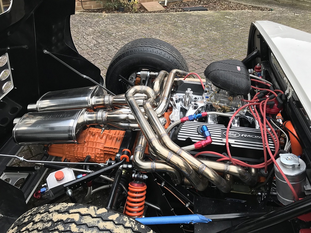

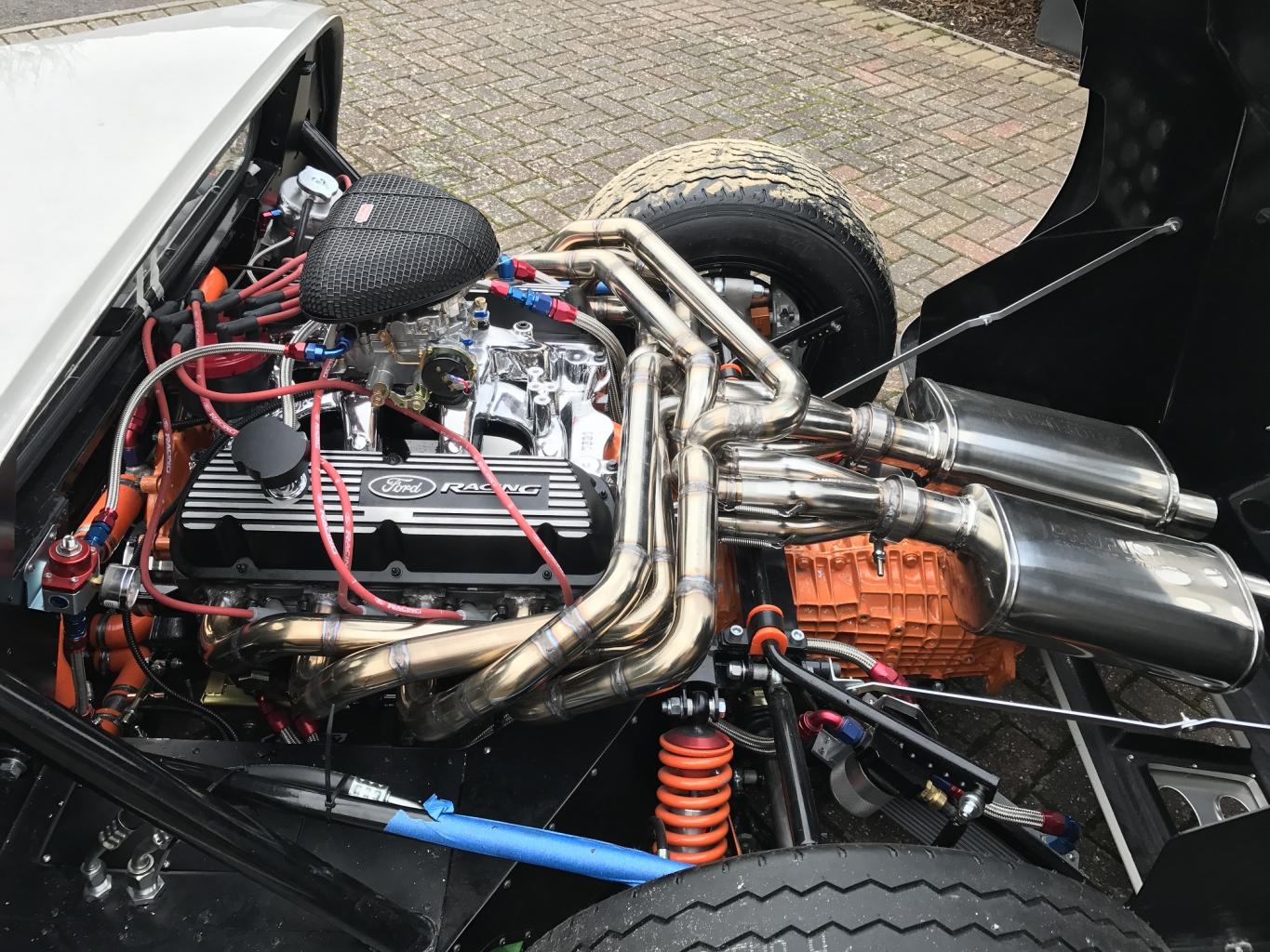

Today I started the engine for the first time and drove her out of the garage :-)
I finished building the stainless steel exhaust last weekend (minus the rear brackets) and had been trying to start the car for a few days, unfortunatly I'd set the valve lash incorectly when i built the engine last year :-( This resulted in the valves staying slightly open and no compression but lots of bangs and pops.

Good progress the last couple of weeks, most of the IVA specific work now complete and i now have the noise down to the required level by making my own modifications to the silencers :-) very happy with home made exhaust system!
Full size high output altinator fitted low down on the drivers side using a bracket i designed and had lader cut after testing with a 3D printed bracket.
