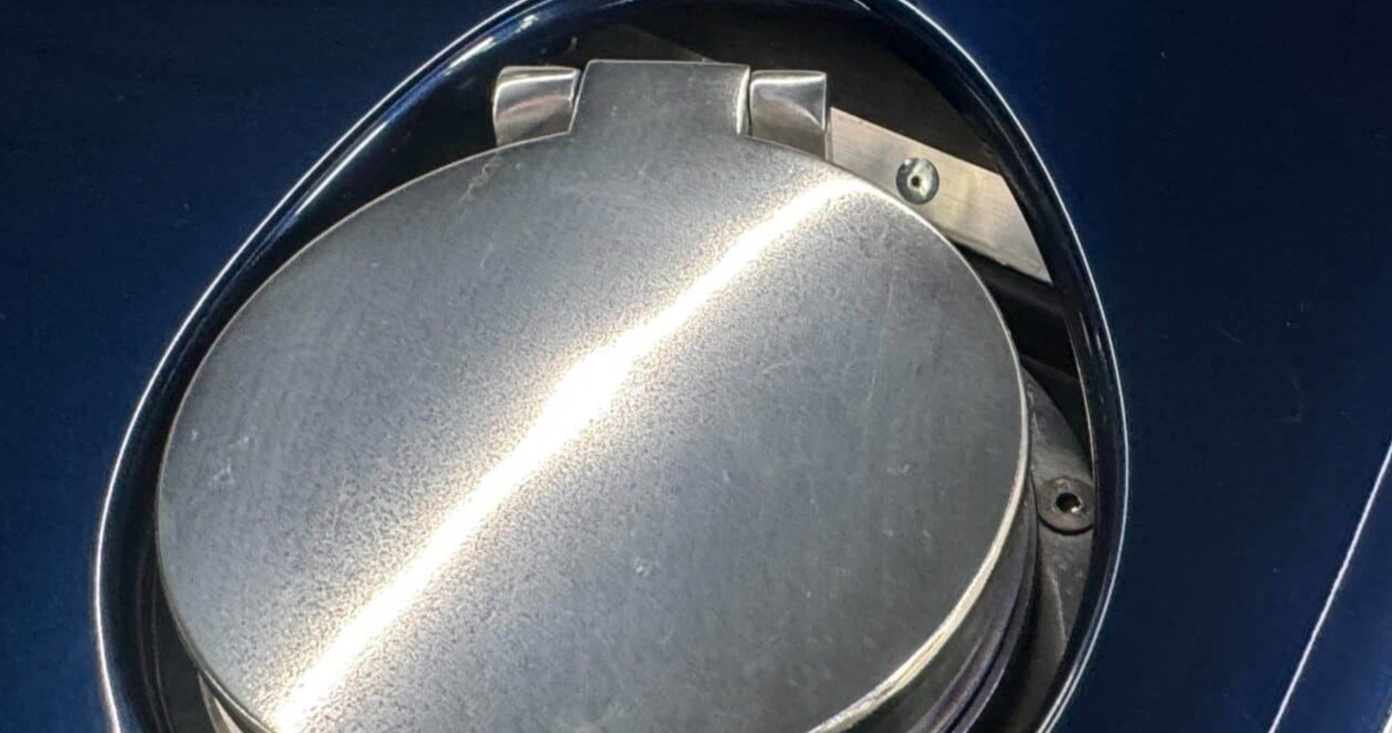

Brian, here is a great idea for SPF GT40 owners (might work on other brands as well). I first saw this on Scott Holley's GT before he sold it. It is a rubber flap attached by an aluminum strip & pop rivets at the front aspect of each flip up fuel fill. It helps prevent chipped windshields from stones being thrown up from the front tires. Without it the stones get thrown up in the gap between the fuel fill and fender and can hit the windshield (this actually happened to Scott, thankfully not causing a chip that time).

I like that Dave. I need to figure out a appropriate place on the forum, where we could post these really good ideas.
Let me think on it.
