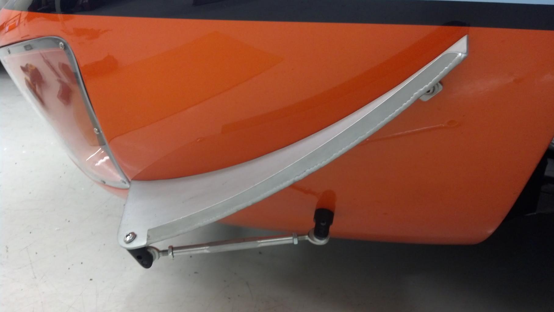

Robert where did you get that canard setup? I want them, looks great.

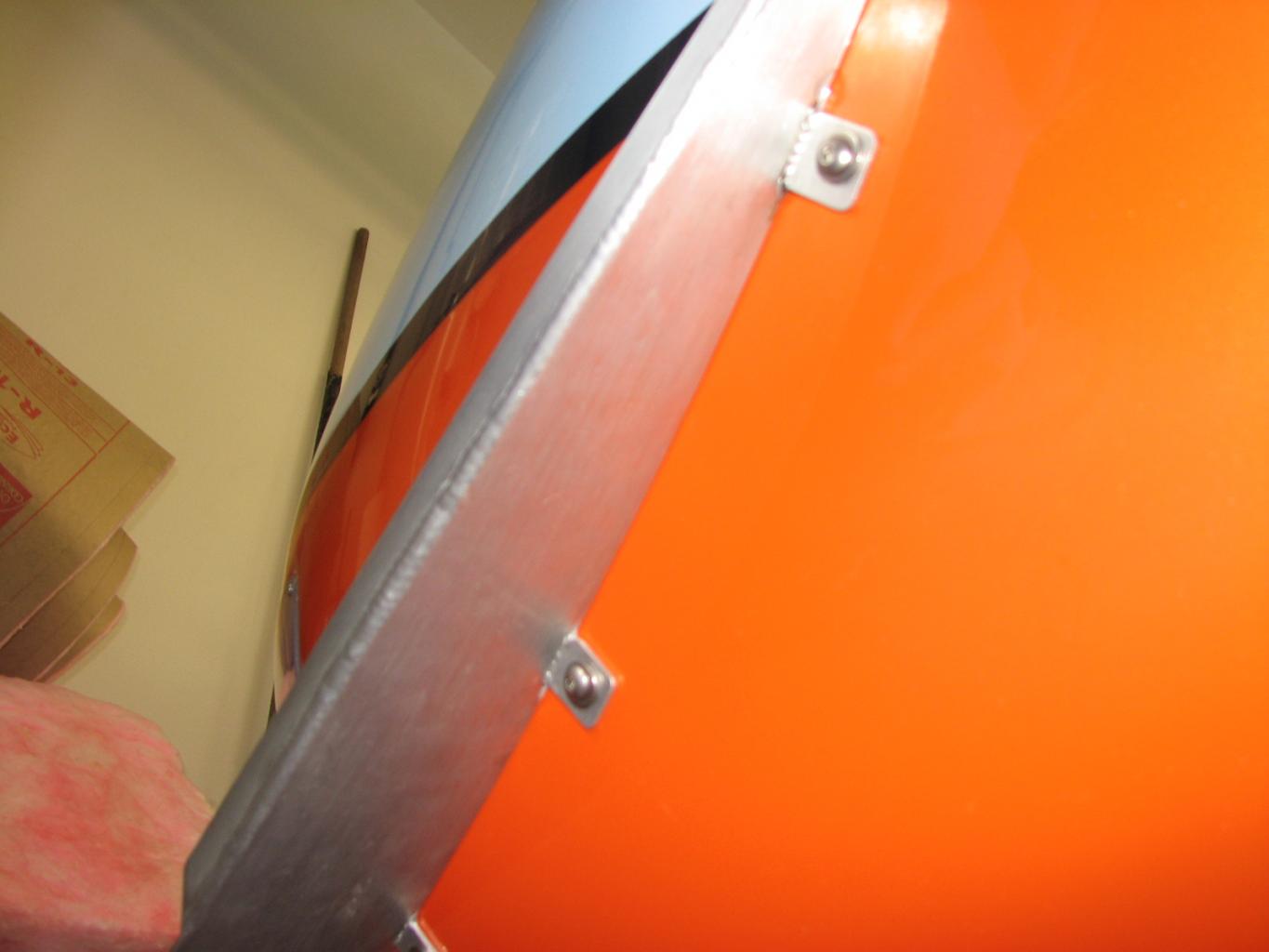

Nick,
I did purchase my conards at Olthoff Racing. I can't remember if the brace bar for the conards were supplied by Denis Olthoff, or if I purchased them separately.
Those conards were priced fairly, and tended to match my brushed side mirrors. Their curvature provided flexible positioning forward and back, as well as the downward angle.
HTH, Robert p2285

GT40 Mrk I p2285 — Conard and Conard Brace Install . . .
HTML:

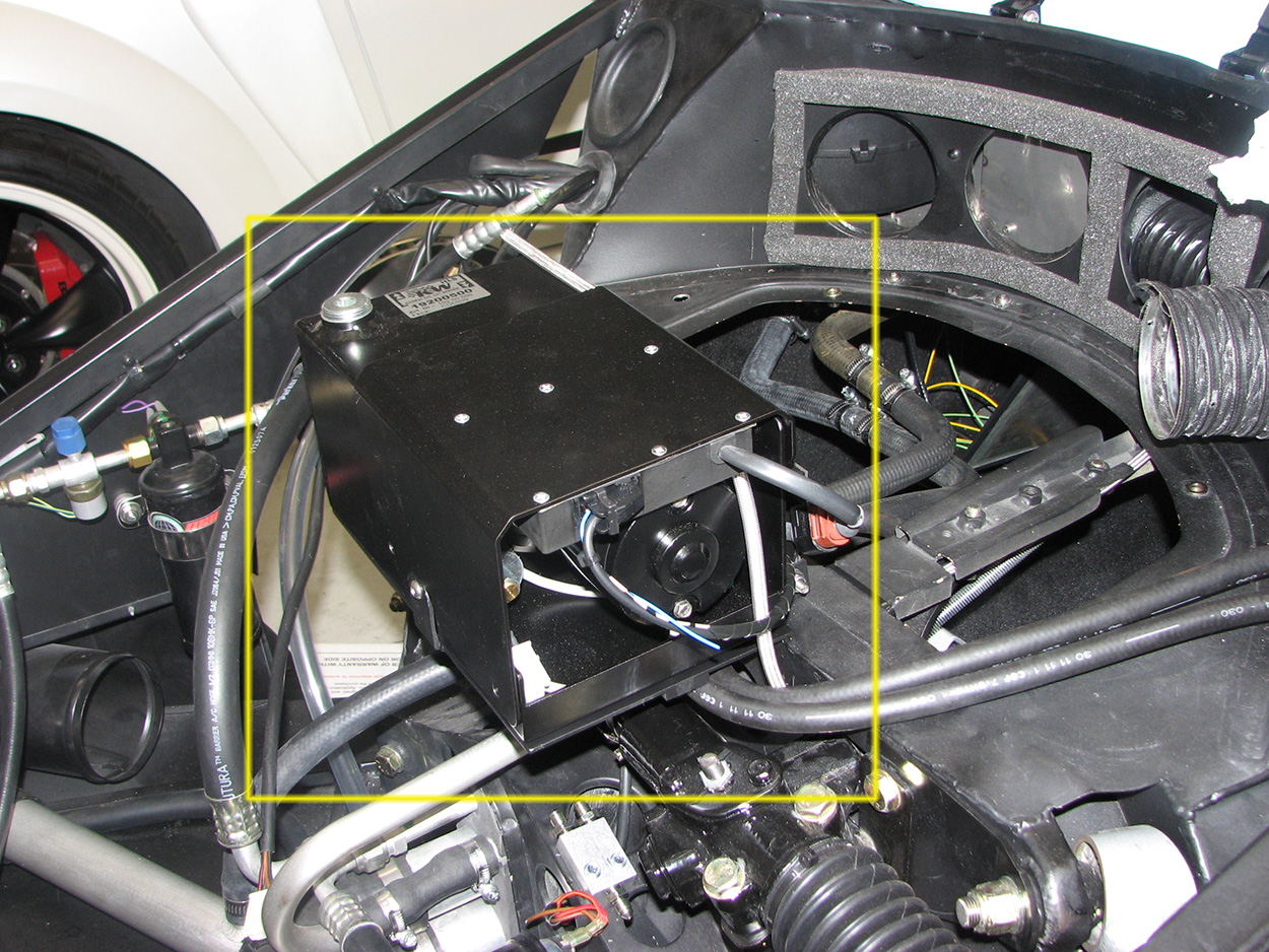

The lift system can be configured to lift only the front body, or it can lift both the front and rear body. I opted for the four wheel lift system.

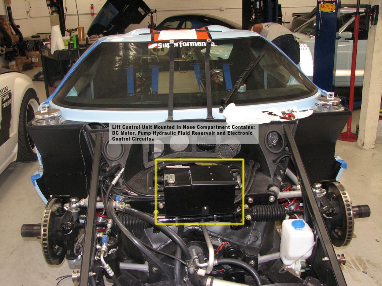

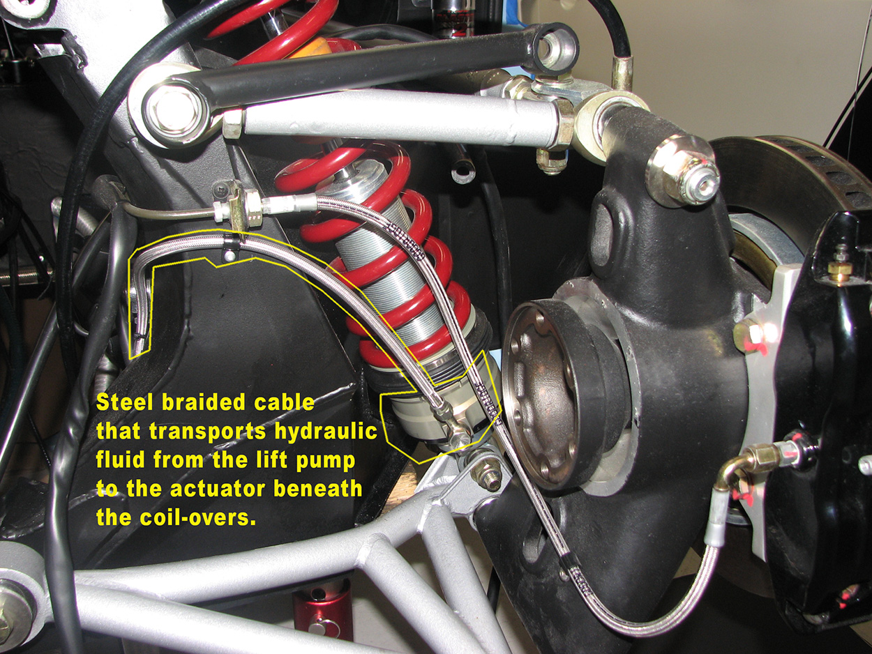

Car lift system makers are sometimes difficult to locate because: there are hydraulic car lifts such as the low rider lifts; those lifts fill your car trunk with much equipment. They can lay the car flat on the ground (slamming it), and/or raise it very high.
The type of lift I was seeking would raise and lower the car nearly 2”, and would take up hardly any room.
I had the best luck when I searched for auto suspension lifts. The brand name of mine was KW, and they are sold at most larger auto parts stores, and internet stores. Earlier on this build thread, I did show picts and video of the small control box. I elected to install it in the front nose area. I also showed photos of the lift mechanisms beneath the coil-overs. Maybe search by key name lift. If you can't find it, I'll try to search for the picts. BTW, I did forget to mention they also have a remote control FOB.
Robert Sackett, GT40 p2285
