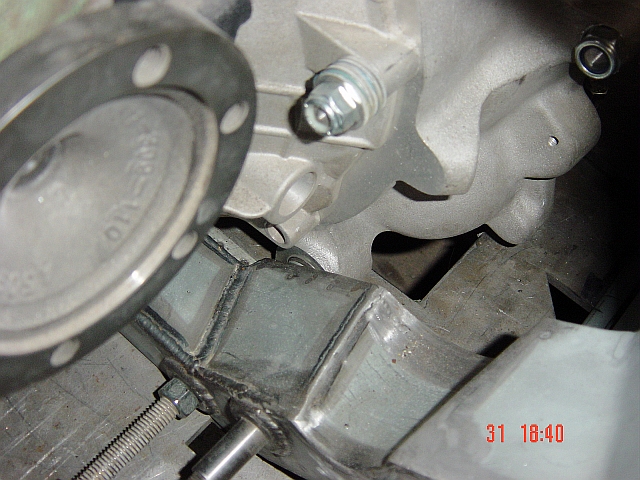

Id like to credit this pic, but cannot remember where its from, might be Jimmy Macs thread. Shows the bell housing lug in relation to the chassis collar/ lower w/bone.

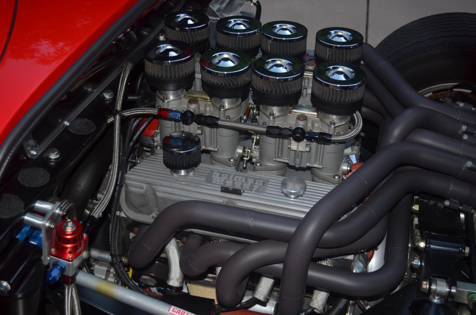

Dave Hood
Carman:
I've had no problems with my Eight Stack set-up. Most people who see the system for the first time assume they are Webers.
Dave

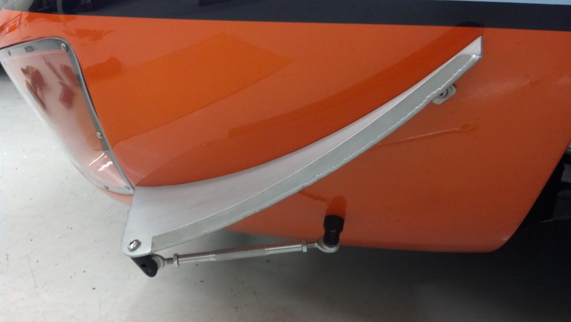

Jimmy, my car is at the age now where I felt the need to have its canards straightened. No car of mine will ever have to go to the car prom with crooked canards. So, I went ahead, did the car right and took him to the carodontist. Yep, the car needed braces. It's expensive to raise cars, huh.

Nick, I have a set of canards that came off SPF2091 Mark 1 as shipped from SPF if interested. Different style than Olthoff’s that Rick posted (no gurney lip, fiberglass and squared off vs curved)
I prefer the curved styling over the squared style so had a local fabricator make an aluminum set.
