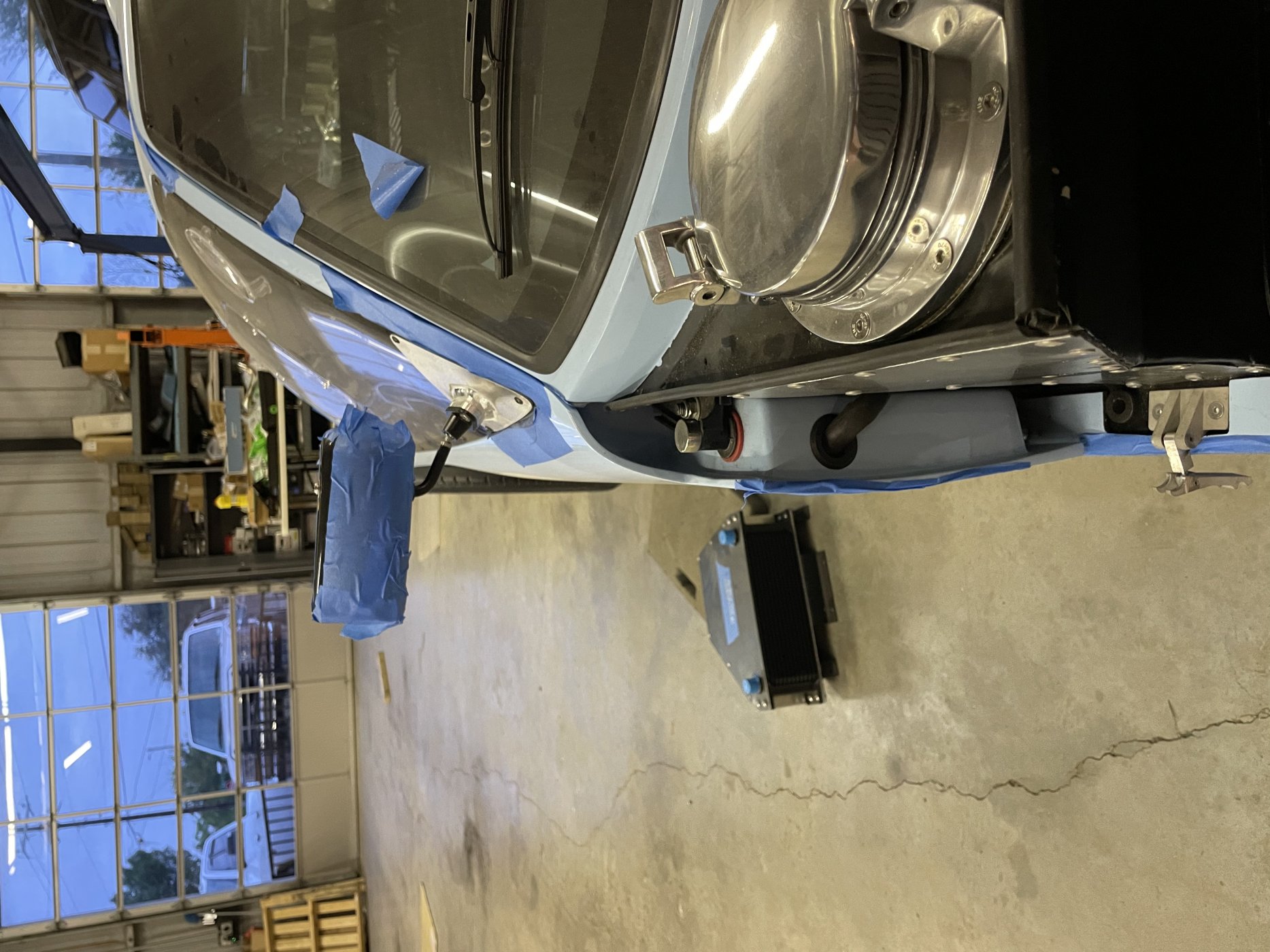

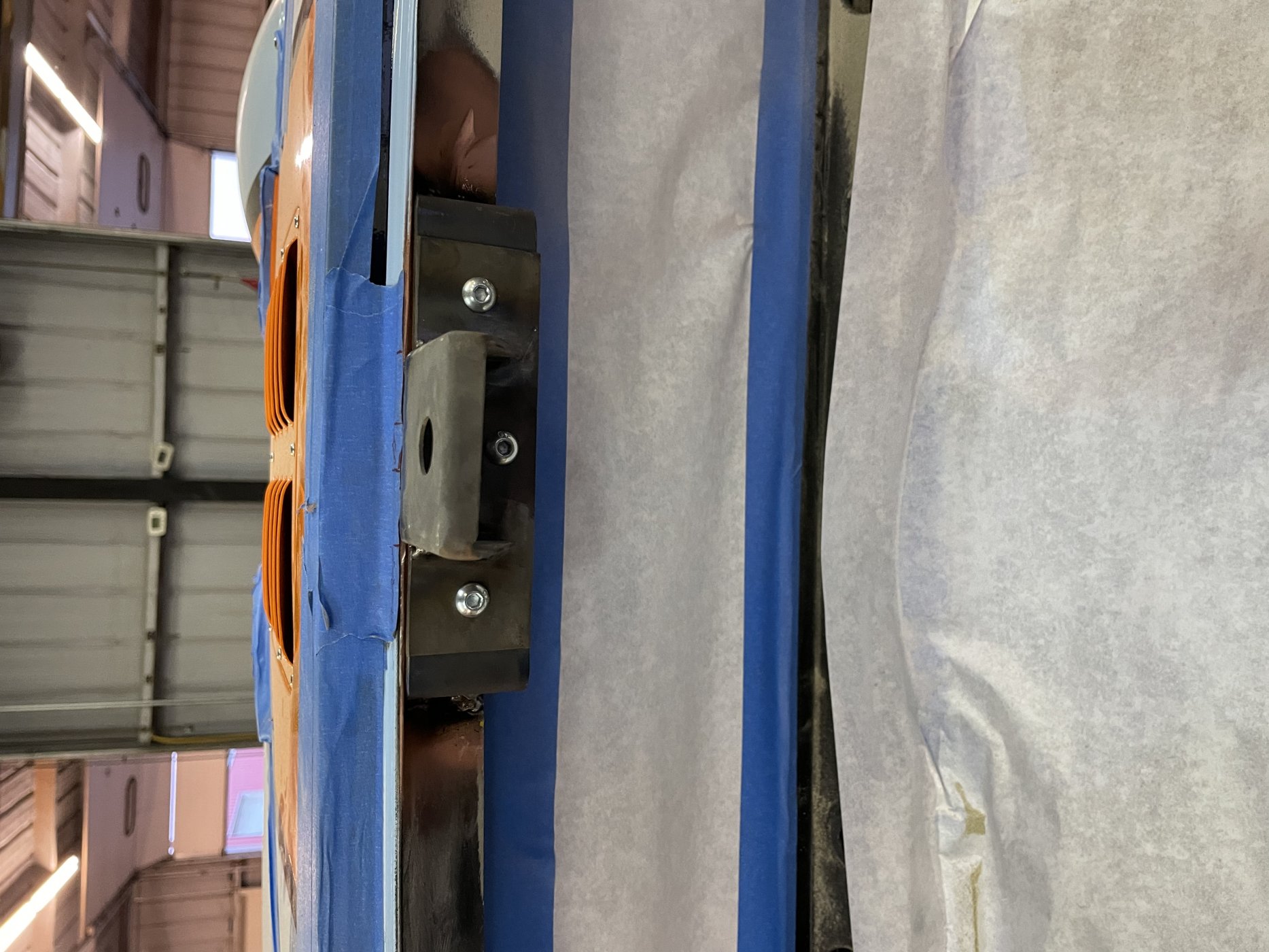

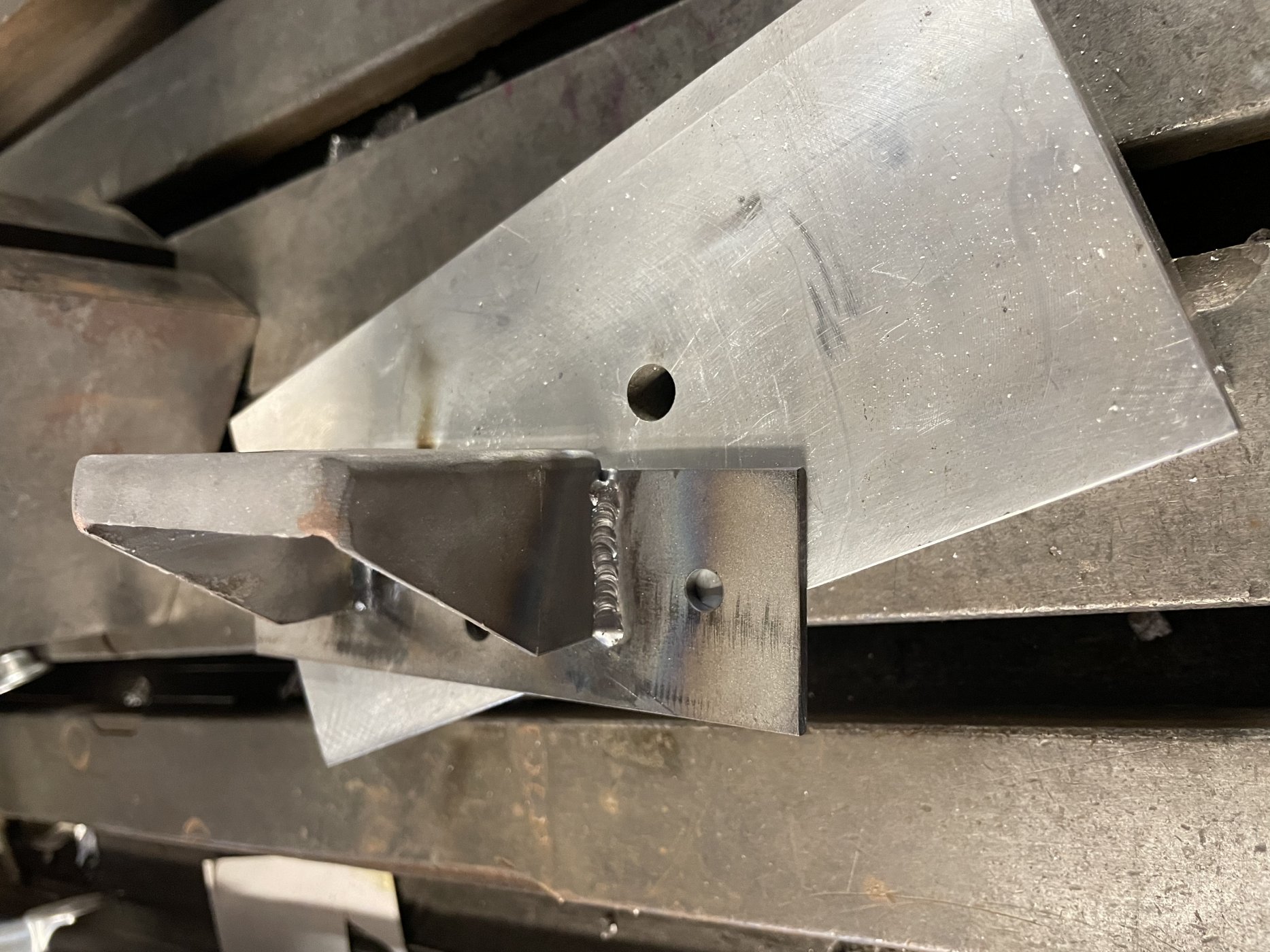

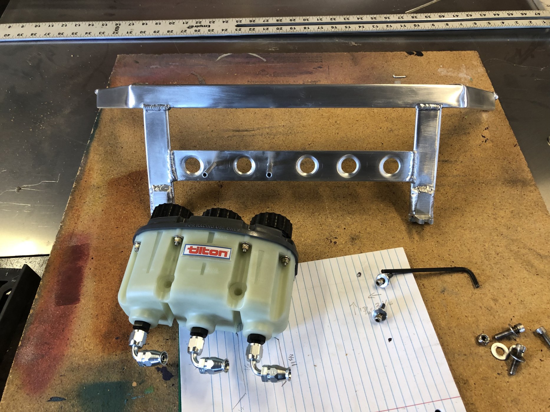

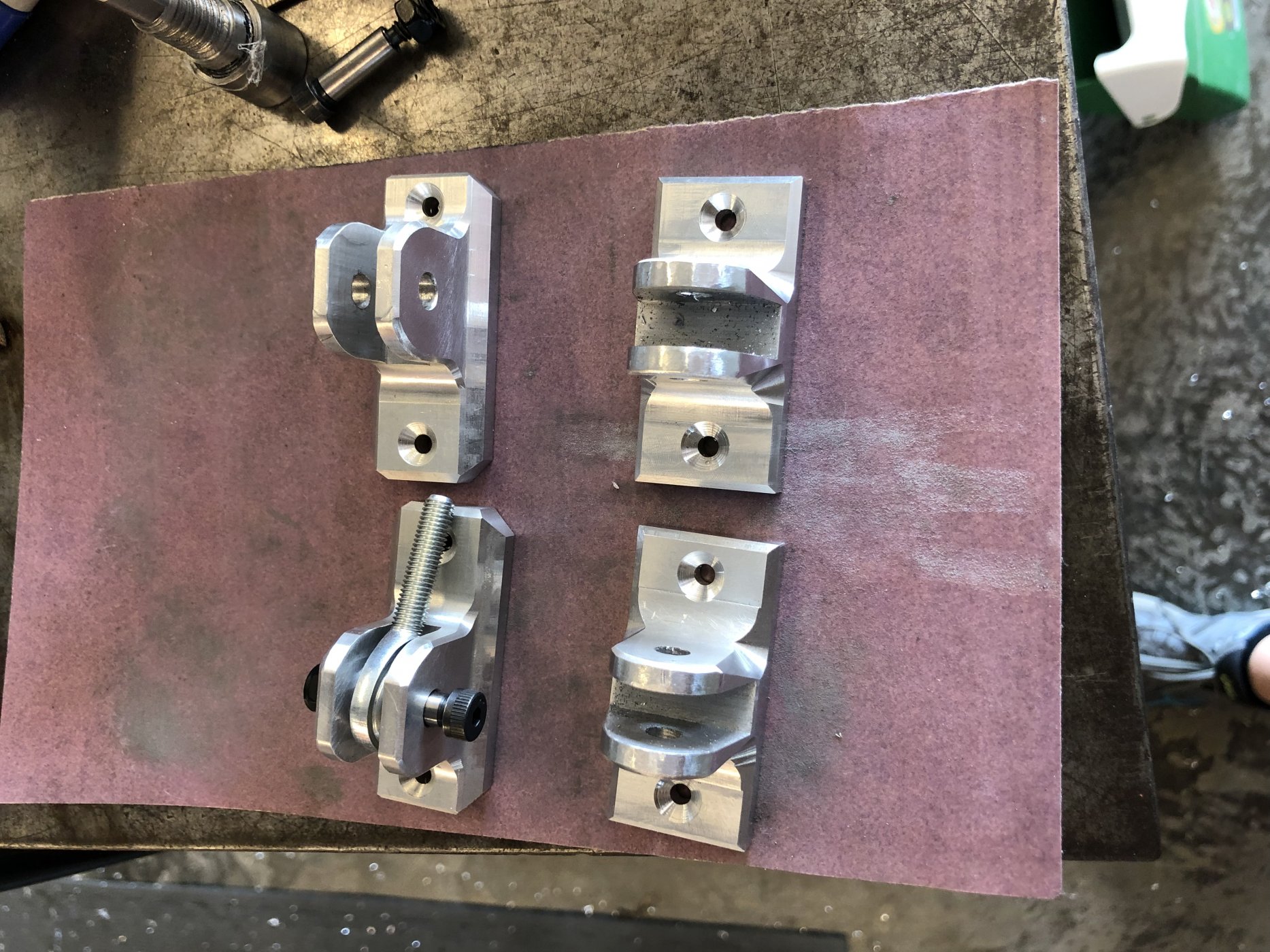

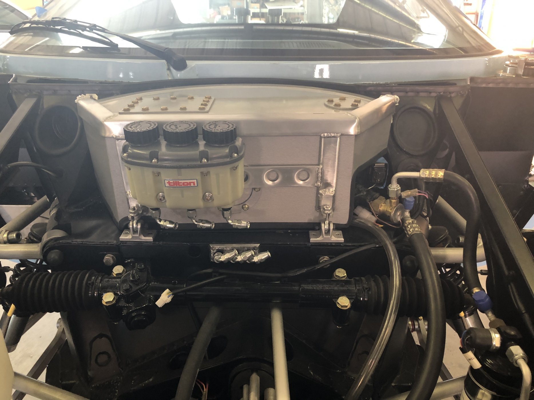

Also finished up the new hold down for the evaporator cover that incorporates a mount for the Tilton reservoir to replace the original brake and clutch fluid reservoirs. View attachment 117781View attachment 117782View attachment 117783
Man, would I love to do this to P2389. It's a pain to remove the nose to check fluid levels and satisfy open track tech inspectors.
Any chance I could talk you into building one of these conversions for my car?
Doug
Doug
Absolutely Doug where are you located?

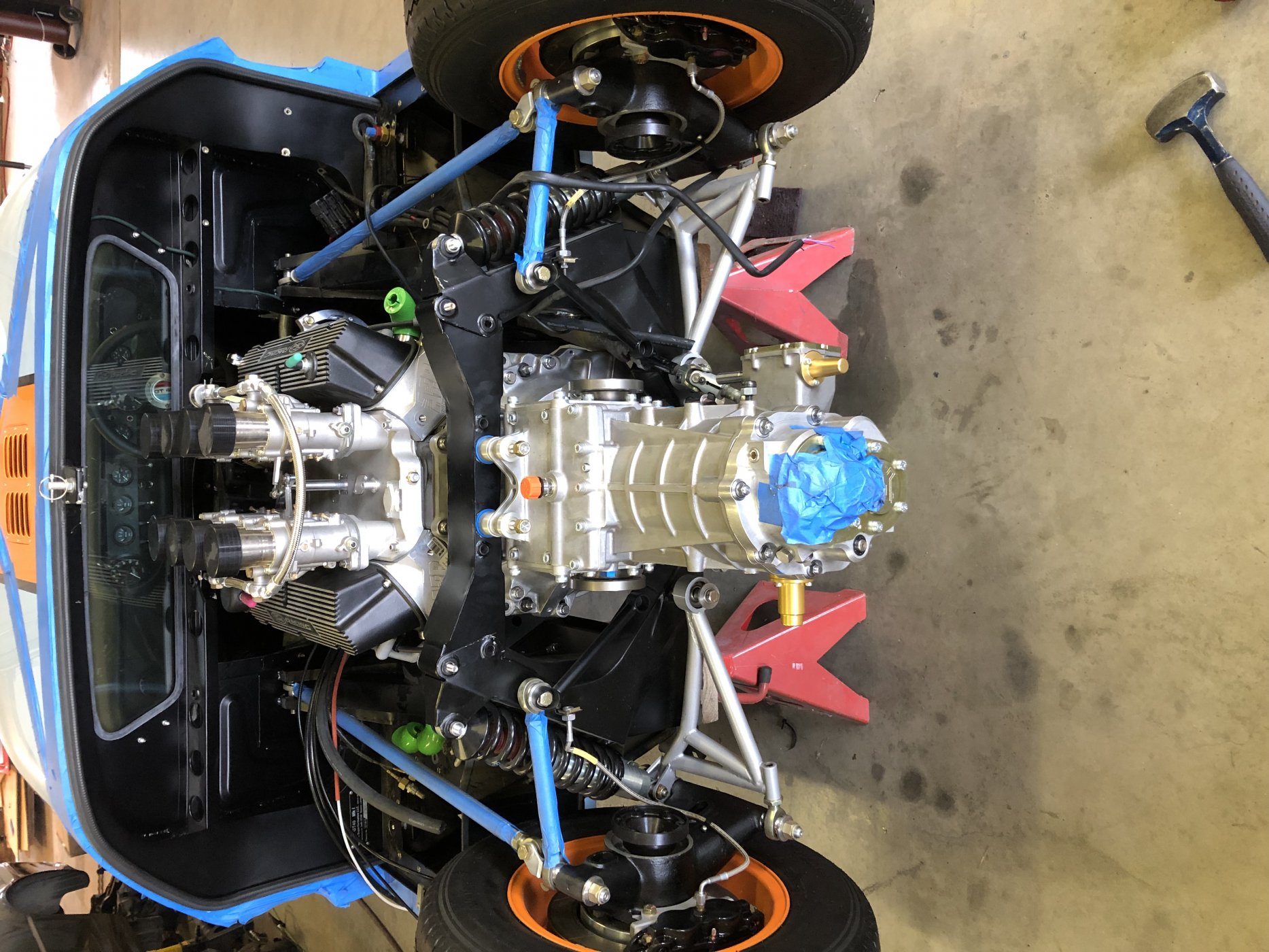

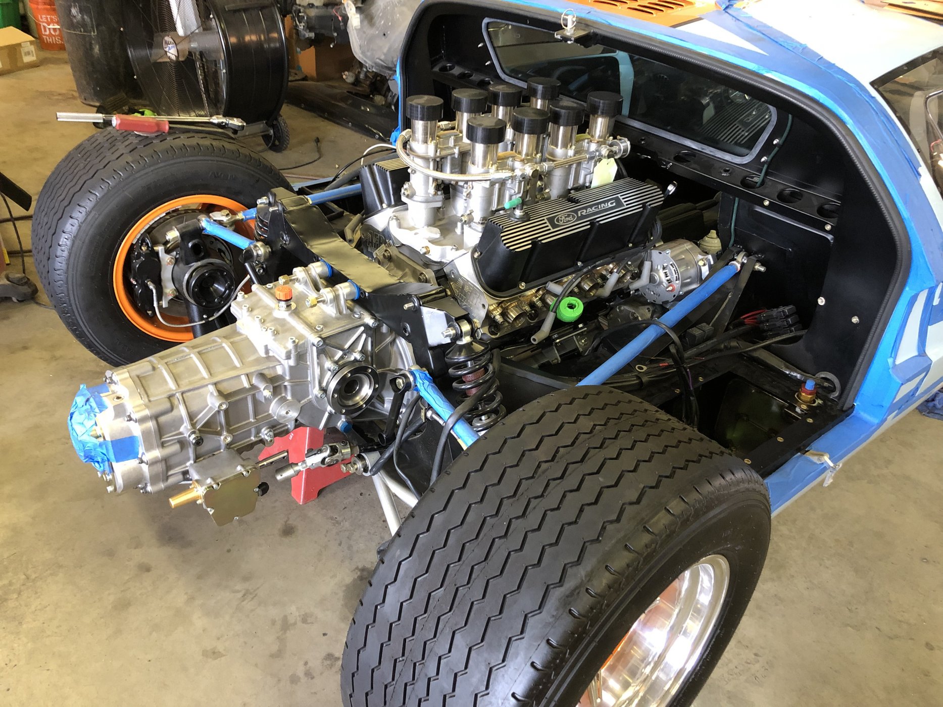

Today was a big day finally got my transaxle in so I can start laying out the exhaust. I ended up having to do some clearancing on the lower crossmember to clear the bottom bolt between the transaxle and bell housing, but it all fits now.

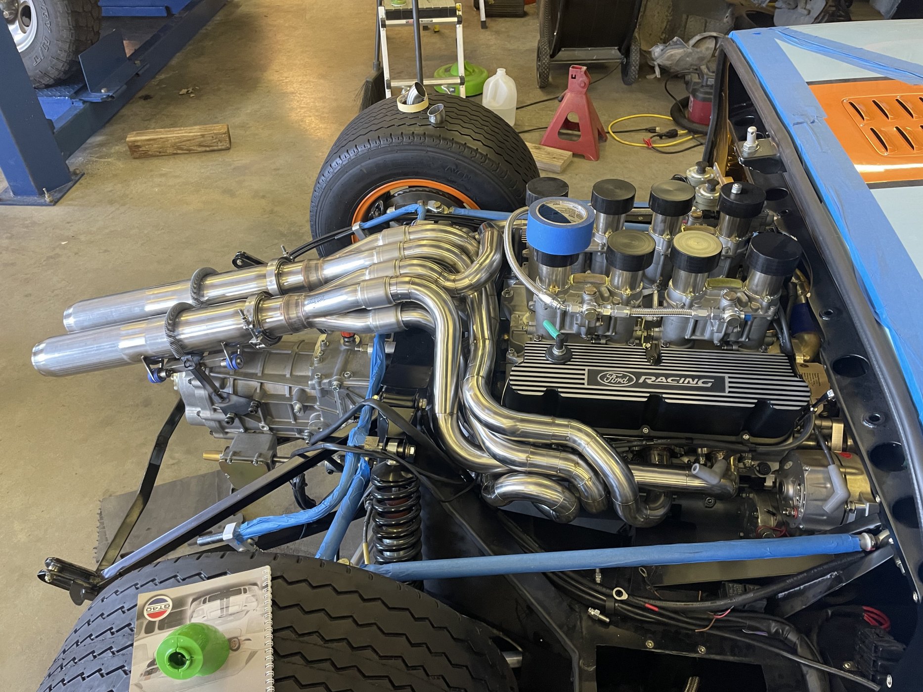

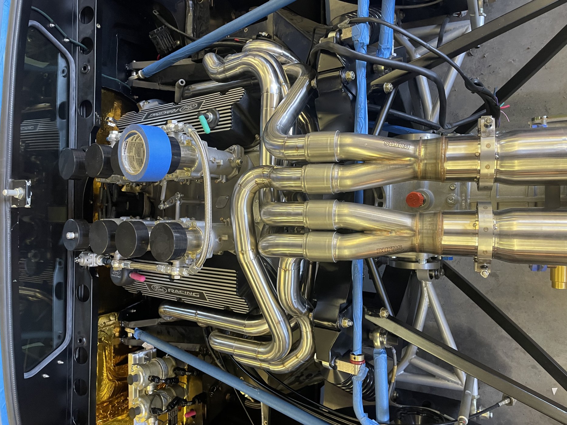

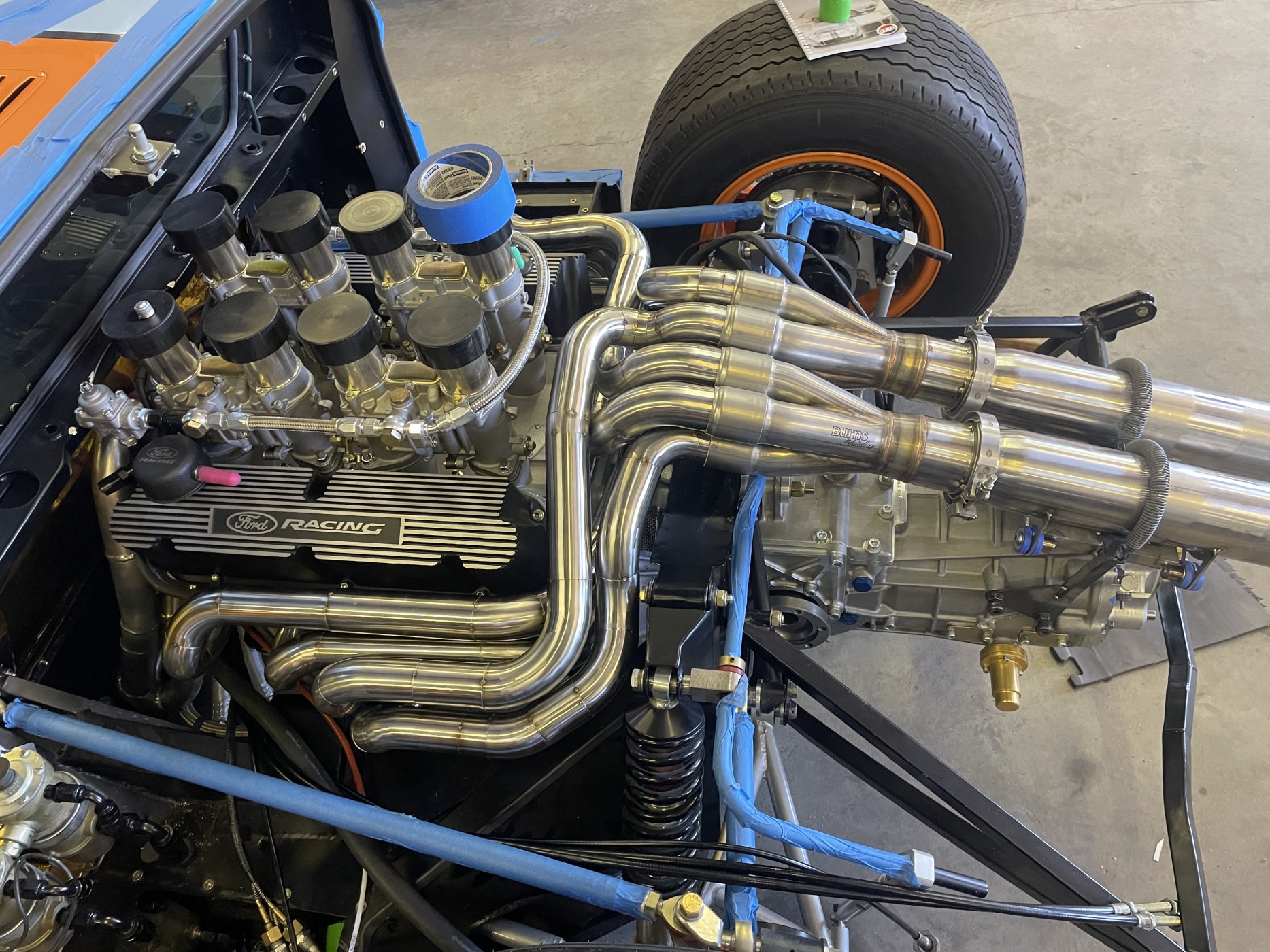

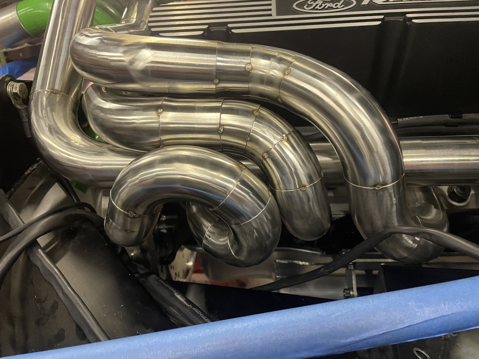

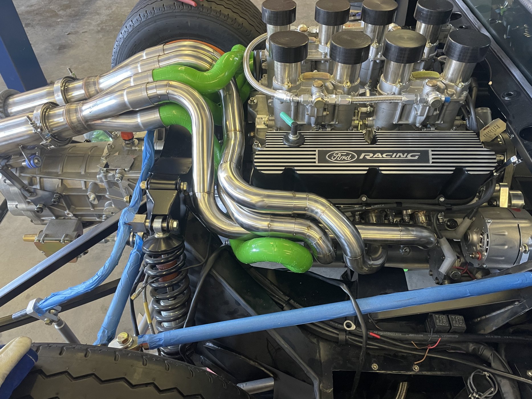

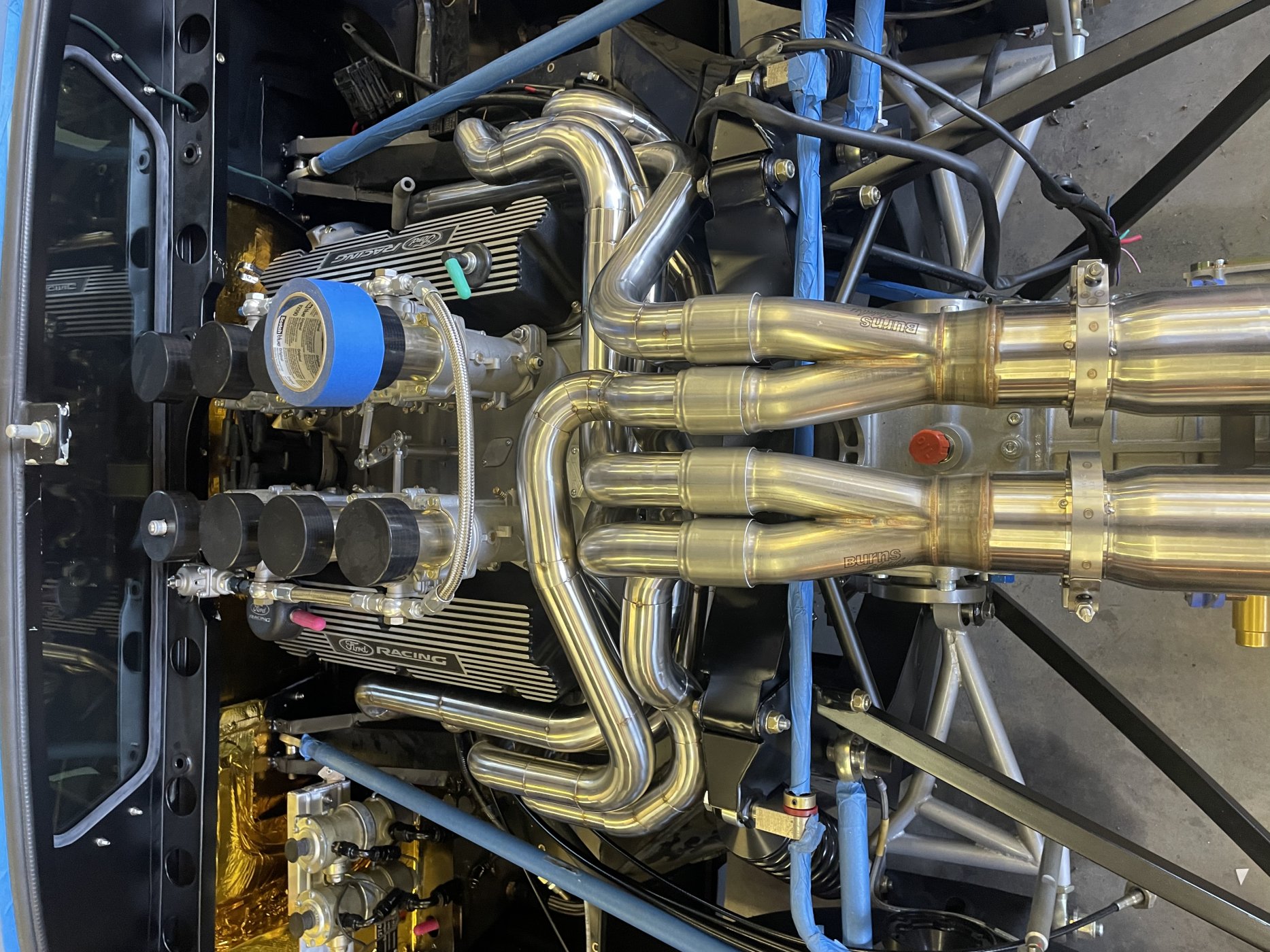

Sorry everyone, I have gotten pretty busy with things at the shop and haven’t posted for a while. I finally got my headers finished! Hats off to everyone that has done this themselves! Not sure I could have pulled it off without the IC engine works mock up blocks and the help of Vince at Burns stainless.

Beautiful bundle of snakes!!

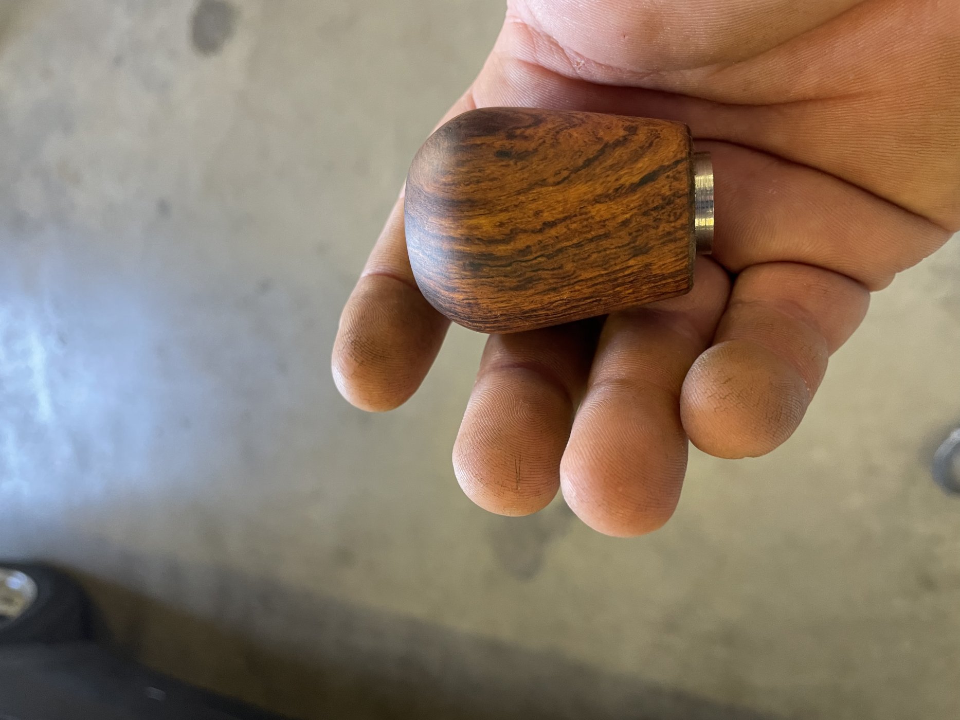

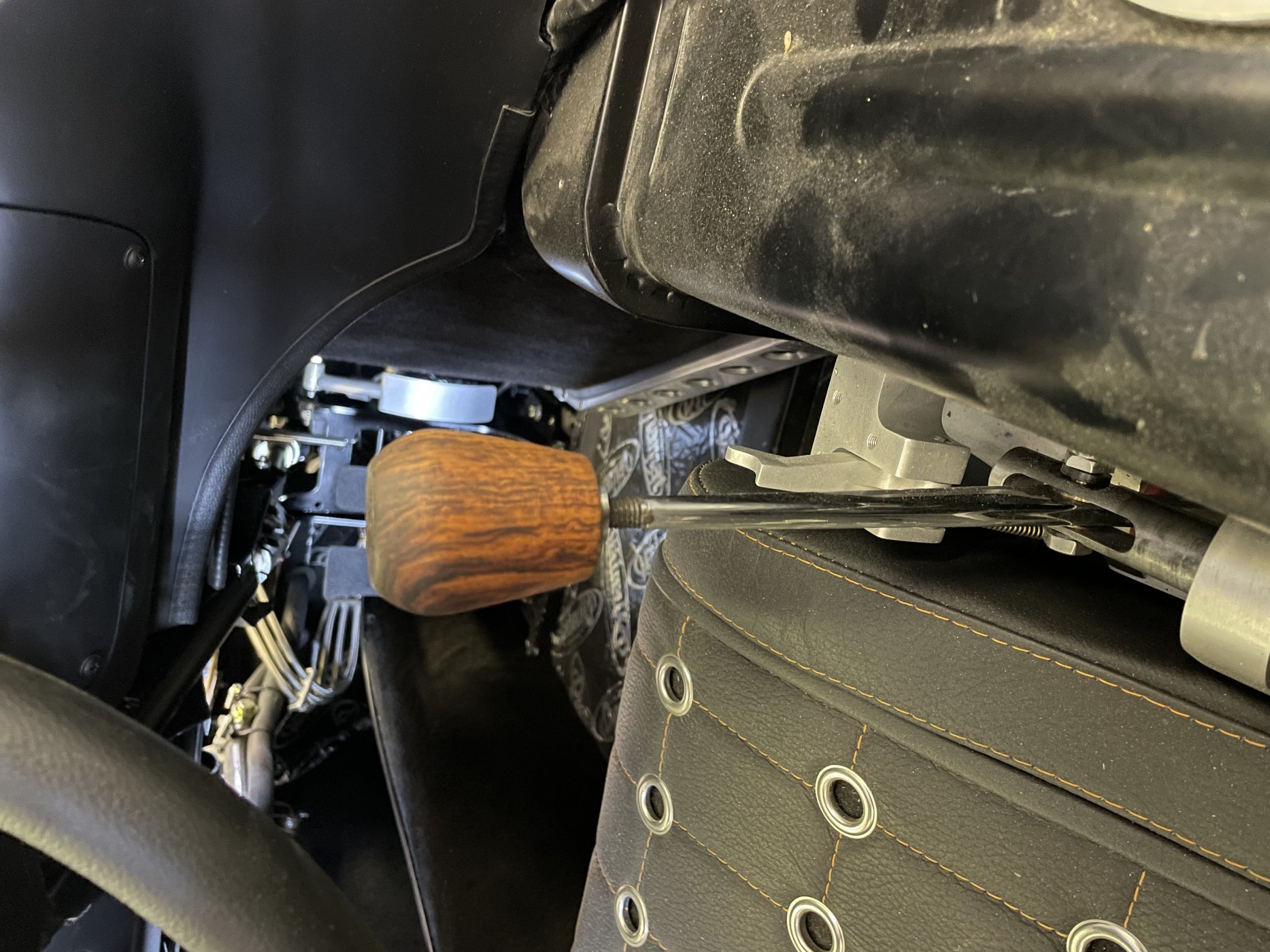

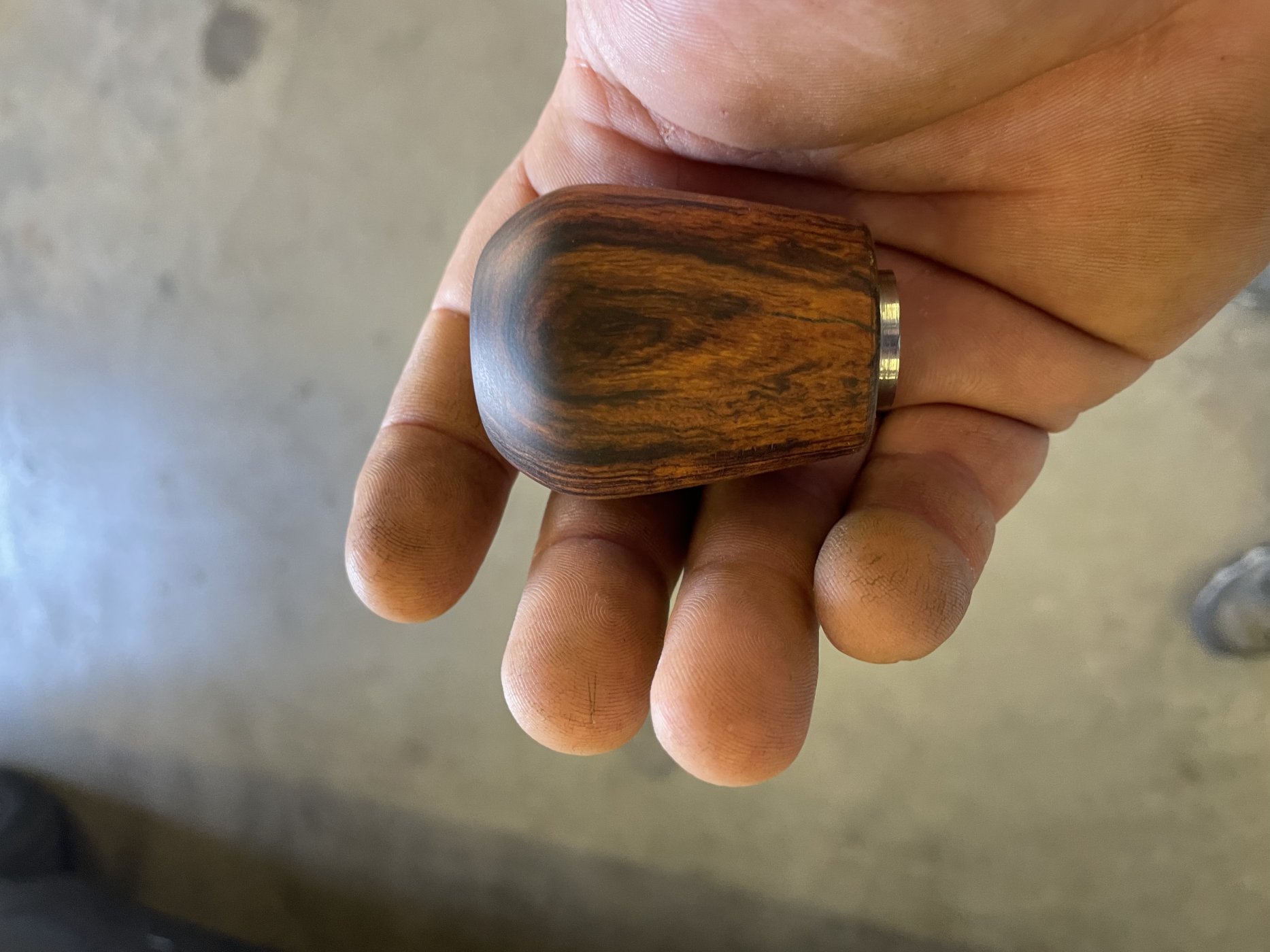

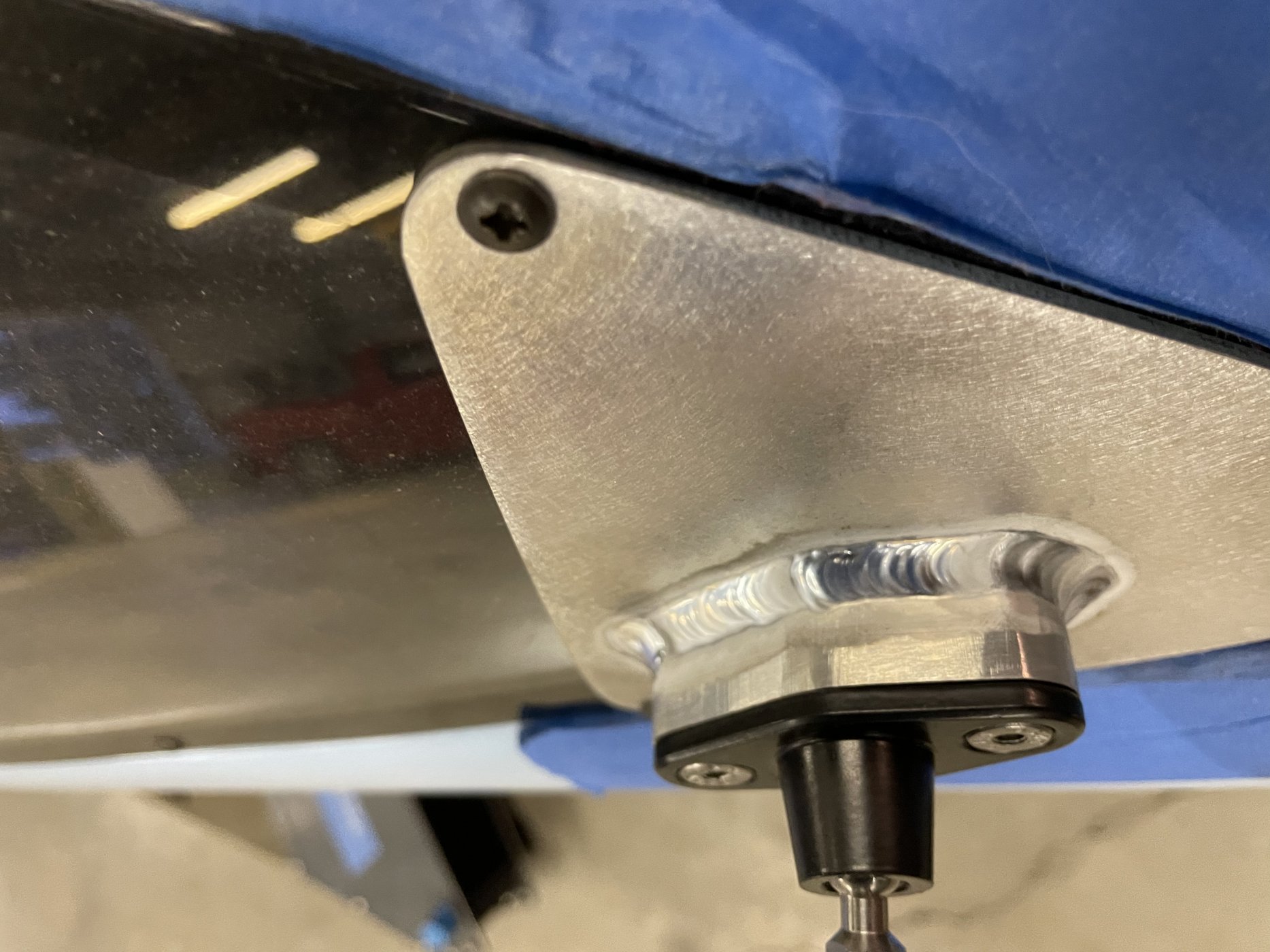

I have been lacking with the posts lately lots of changes going on right now fortunately they are all for the better. Work has been continuing on the gt but sometimes slower than I want it too. I made a wooden shift know for the car and got the mirrors mounted finaly

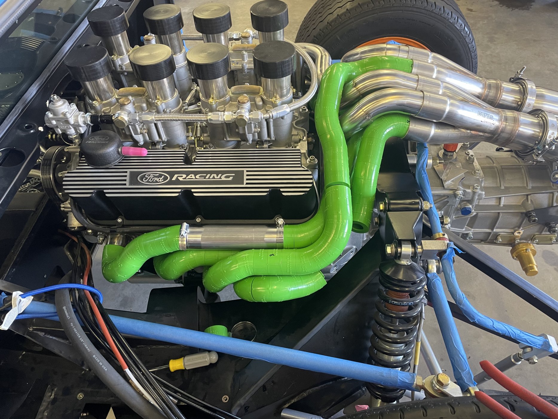

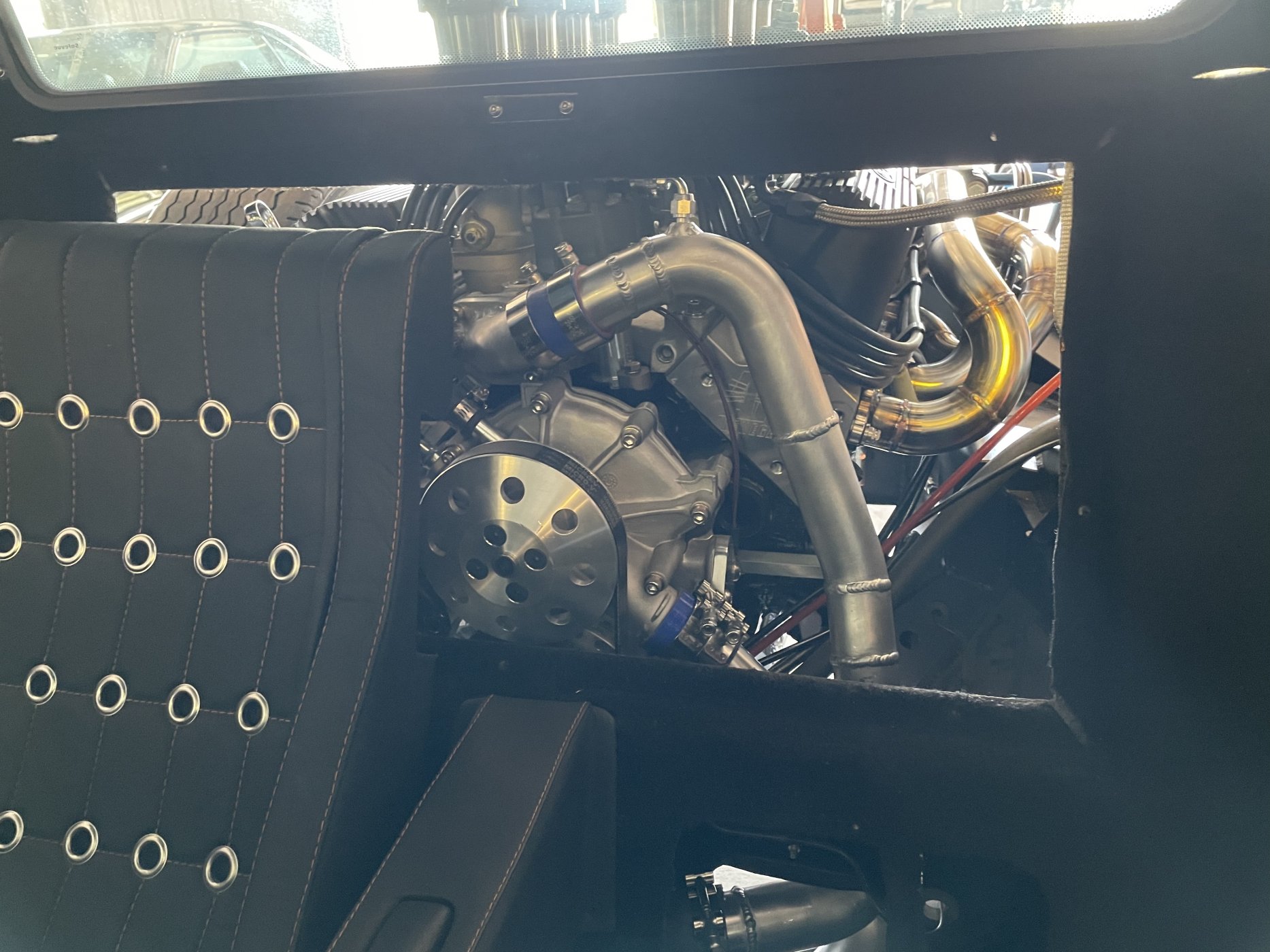

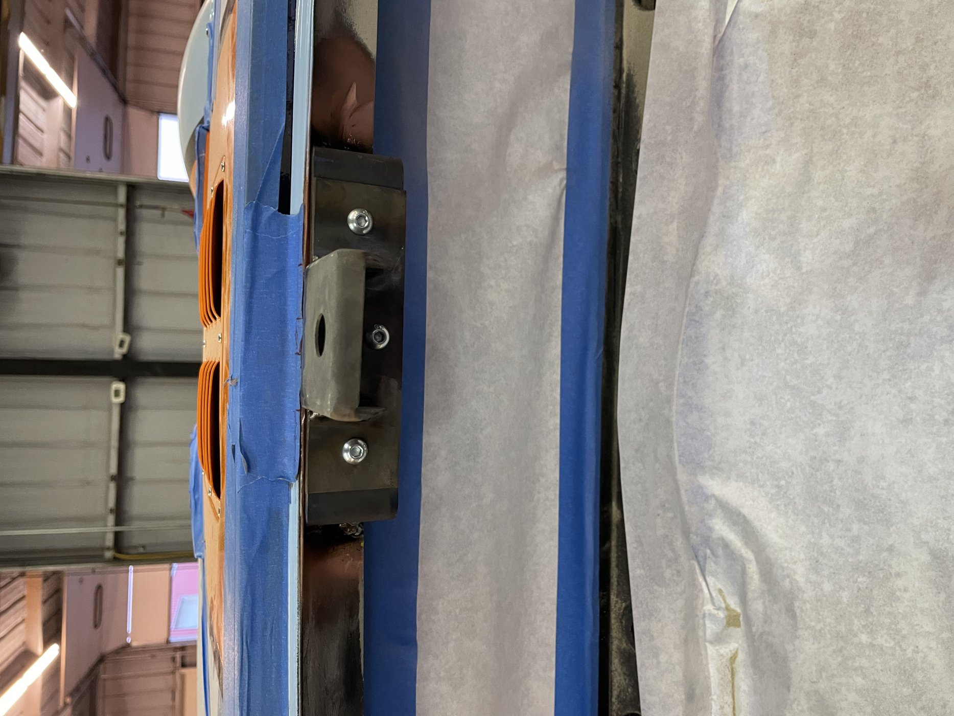

I also made a set of hard lines for the cooling system. I am sure a lot of you have battled trying to get the engine in and out of these cars with the center pin for the clam shell Trying to occupy the same place the water pump pulley is trying to be so I made the pin mount removable.
If you had to guess, what do you have invested in materials from the head to collector with your headers? I was originally going to do my own in stainless, but comparing that to just buying a set.
We have roughly 3k into materials to do those headers. Most of the tubing and collectors came from Burns and it is really unrivaled quality
Lee Patterson
Is there some reason why you did not use the SPF exhaust that comes with the car? Curious as I was told it quite high quality? thanks
Yes Lee, the spf headers are not bad except they come with dual pattern flanges where they connect to the head to accommodate the 80’s 5.0l heads because of this it blocks a significant area of the exhaust port when you are running larger port AFR etc heads and the primary tubes are on the small side for a stroked 302. I also wanted to keep it as far away from the underside of the clam shell as possible to try to avoid bubbling paint.
