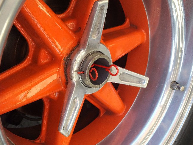

I've hade some safety clips made up by D.Faulkner Springs, very pleased with the result but drilling the adapter hubs is proving very difficult, I'm using 4mm cobalt drills, I've managed 3 hubs (2 holes in each) but the 4th is proving impossible, the adapters and wheels are from Vintage Wheels US, the adapters are forged steel, any ideas anyone what drill would do the job.

I have a bench pillar drill which I could use but as they are on the car I'm a bit reluctant to go that far.
I've tried using a new solid carbide drill with and without hammer action, no effect and as I'm drilling downwards I've got my full body weight on it so the pressure is quite substantial although probably not as much as the pillar drill.
I think Phil is correct and it's work hardening that's causing the problem as I've been able to drill other holes as shown in the pic.

John:
I might have omitted it but don't use the hammer function on the drill, just sharpen it to work as a standard drill, this will take a green wheel. The carbide inserts are pretty tough and a regular carbide drill I believe will be too brittle for what you need to do.
Since you posted a photo where can I get some of those neat little clips you are using?
