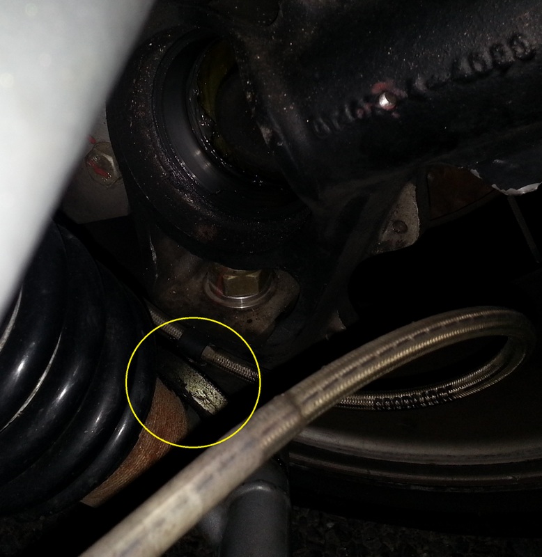

I may have something to say about them doing it the exactly the same way they did back in the day. According to some original documentation and pictures they used a more traditional castle nut to set the pre-load on the front hubs instead of that POS doughnut with the three little cap screws.
If they had I may not have had to go looking along side a desolate stretch of road somewhere north of Bend Or. in the middle night to find my inner wheel bearing. But that may be a story for another thread. Needless to say it was a bit strange to watch my life pass before me.
I guess I lucked out in a big way. Unbelievably the "doughnut" pre-load adjuster was sitting on the lower A arm. Otherwise I might still be there.

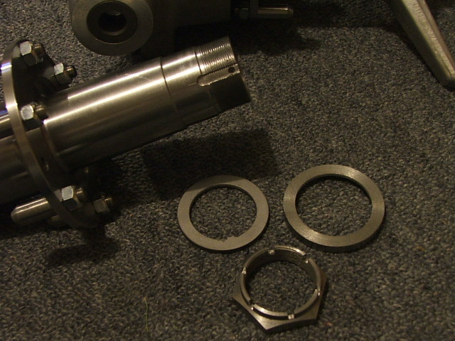

Interesting problem. As mentioned in my last post I had a problem with the pre-load lock plate coming loose (falling off). I ordered a replacement and today I started putting the car back together with new Timken bearings.
Everything was going great until I went to put the new lock plate in. I know in the past it could take a few minutes to get everything lined up so all three screw holes showed up at the same time. Well a few minutes turned into 10 and so on until it was evident it just wasn't going to happen.
No mater how I clocked the pre-load nut I couldn't get all three holes to show up at the same time. Even thou I knew the holes in the nut were symmetrical I tried by turning it over, no joy.
So I checked other side thinking that maybe they had gone to a new design. Well they look the same, both have 5 slots. I tried to upload a video I made because I knew people wouldn't believe me but no matter the size or format the upload always failed. So you'll just have to take my word for it.
If someone has run into this problem before or has a fix please let me know.
OK I'm official embarrassed. I turns out there should only be two. Go figure. I could have sworn there were three. Rick thanks for posting the parts list. Part #9 shows quantity of 2.
