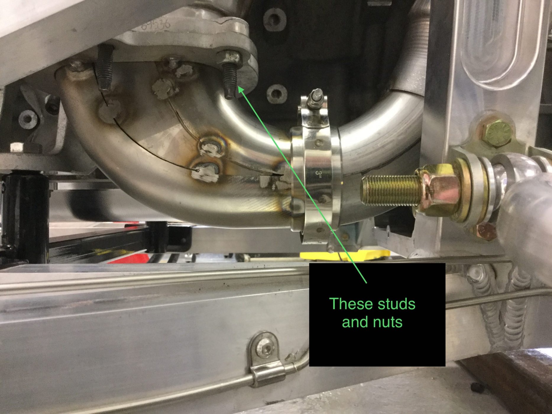

I plan on buying studs and nuts to attach the LS7 style flanges with down pipes to the stock Exhaust manifolds. Wondering if using stainless hardware would make it easier to remove in the future.
Are there any reasons not to use them? The stud size is M10.

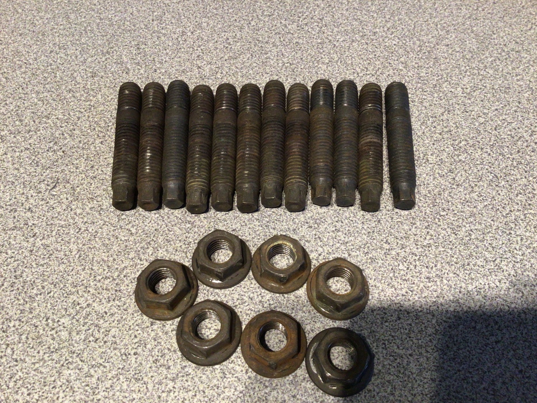

I have a bunch of the original stock style LS7 studs. You are most welcome to have them Joel. They are stainless.

Hi Ken, I may have asked the question incorrectly. Looking to attach the oval exhaust down pipe flange to the outlet on the exhaust manifold. These have four studs and nuts each.

Those are the ones I have. The GM part number is #11518424. They sell for about $10 each new.:oops:
The matching nuts are #11517996. They sell for about $4 each new. They are distorted thread lock nuts so I would recommend buying new. I would just use regular m10x1.5 nuts for fit up and then swap over to the distorted thread nuts when assembling for final time. I wouldn’t install the gaskets until final fit up as they are a one time use “crush” gasket.
You could even just buy distorted thread flange nuts from McMaster Carr. The stock nuts are not stainless. The studs are stainless.
