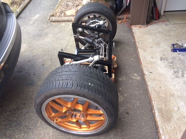

Starting my GTR chassis build
Terry, progress has been slow, but I love every minute of it.

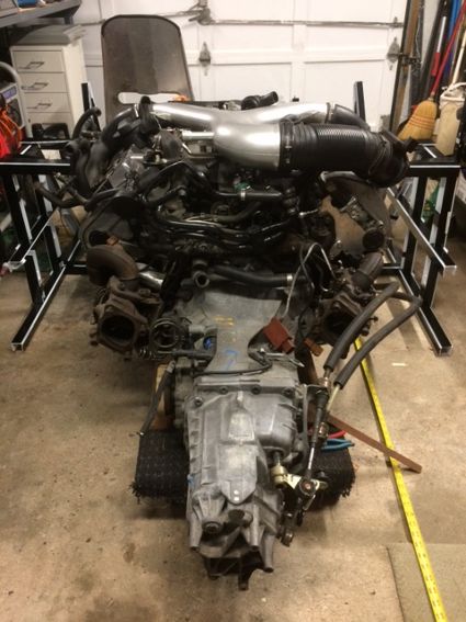

Chris, there is a diagonal in the future for the roll hoop, and the removable x-member over the engine seems like the best solution for engine/trans removal.

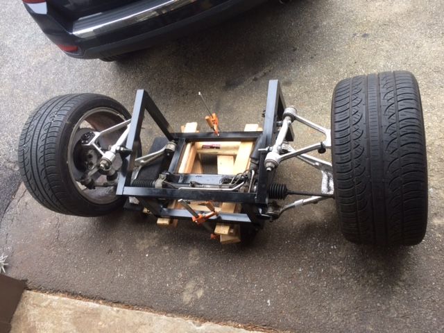

I wanted to double check the front width before breaking it all apart again so I had it down on the tires for a bit.
Thanks to everyone here for following, I read all the build threads and I am amazed as well as inspired by the level of knowledge and craftsmanship shown on this site.
Best regards,
Vinny

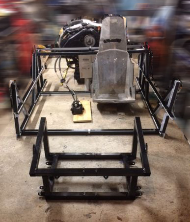

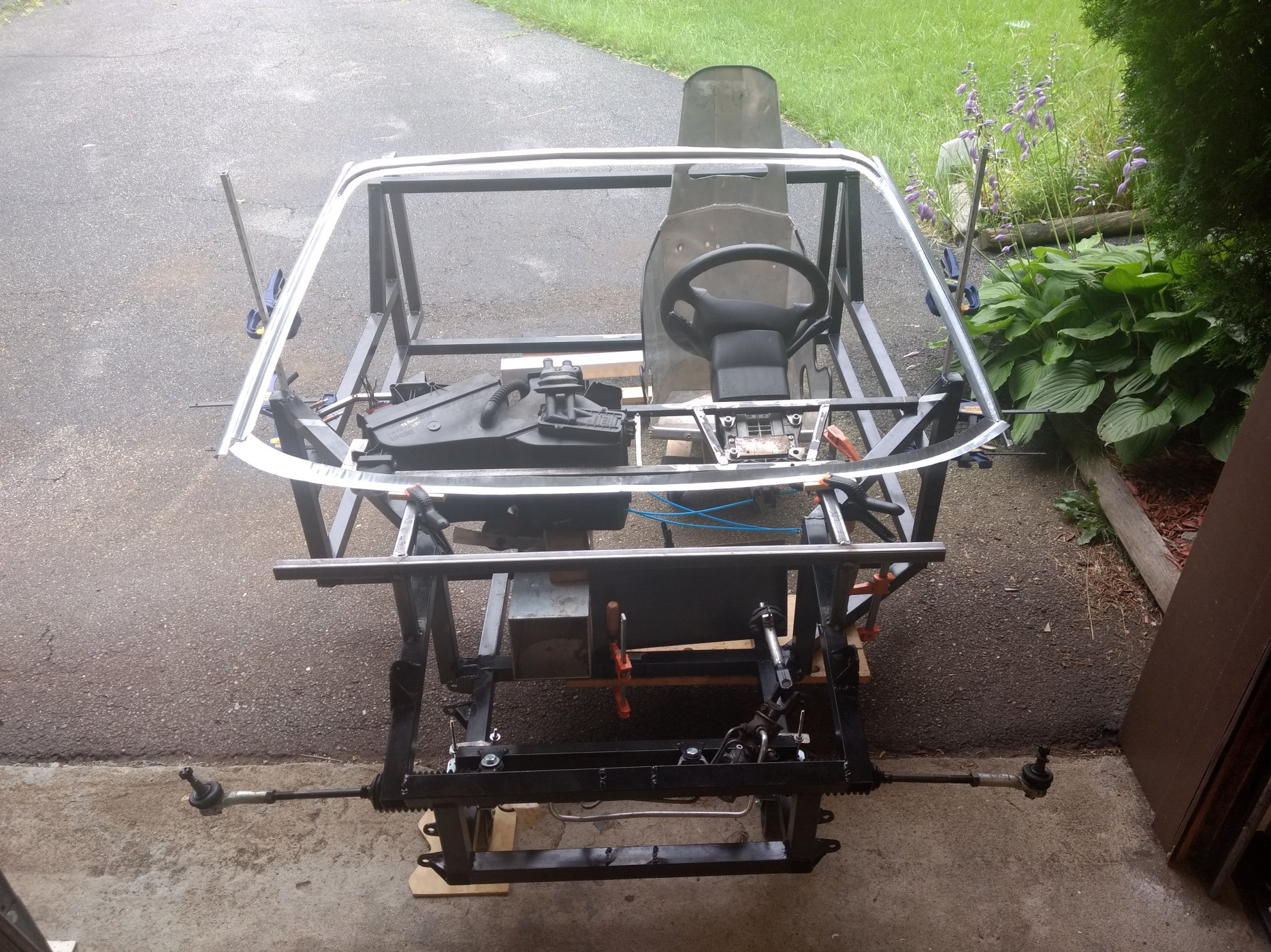

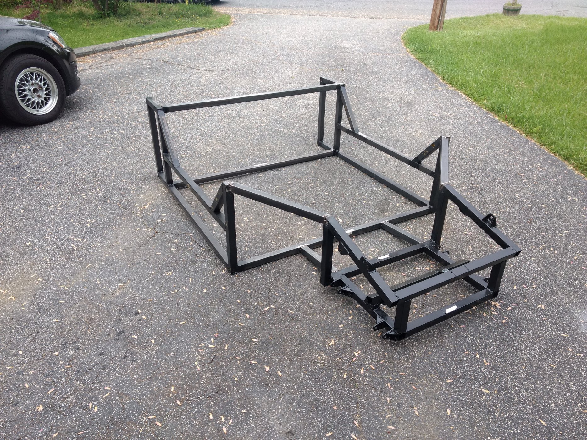

Hello everyone. Here's an update on the build. I've sorted the front and rear suspension crossmember frames. The front cross member was widened and now holds a late model Camaro steering rack over the Corvette C4 unit. And I've begun building the cabin but first wanted to confirm my dimensions and 'sit' in the car before cutting any steel. I made a mock up cabin from currogated plastic square lengths of tube to match my drawing. I was glad to find my pedals and footbox locations were accurate. And I actually have 3" additional room behind my seat I didn't anticipate. Seeing it in the flesh on the garage floor is a real motivator to keep going. Thanks for watching. -Vince

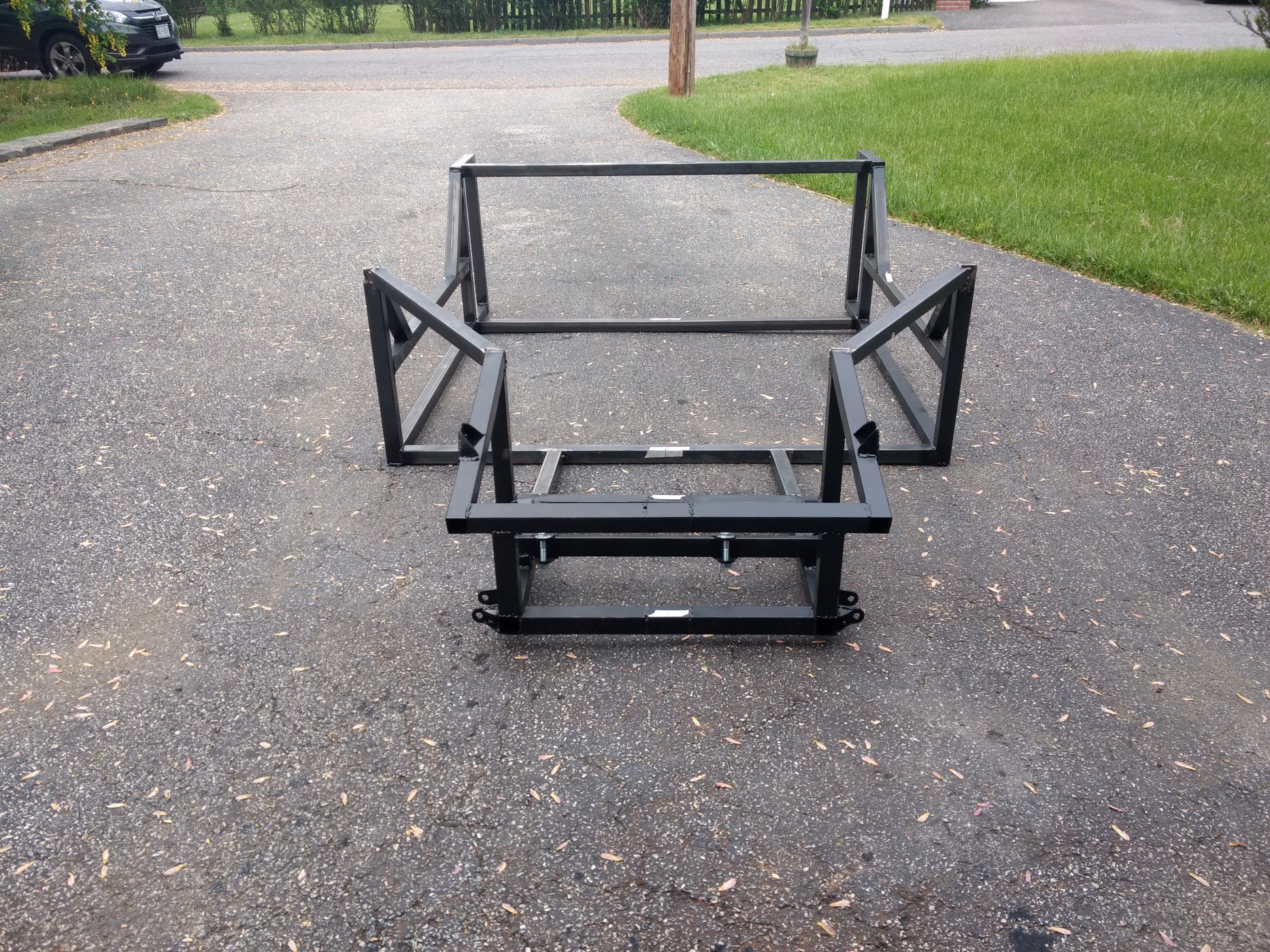

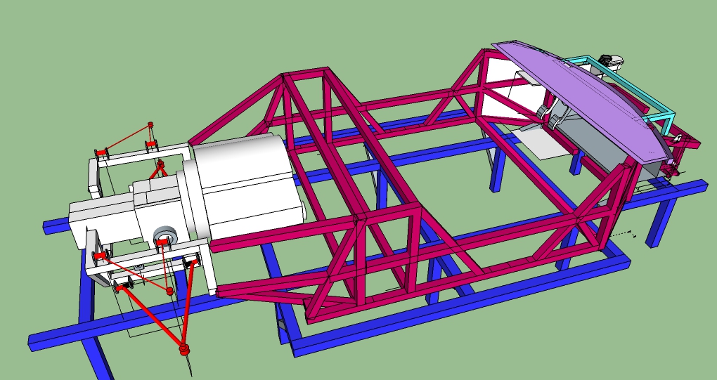

Here's where I am with the chassis. The rolllbar/hoop design is still being finalized.

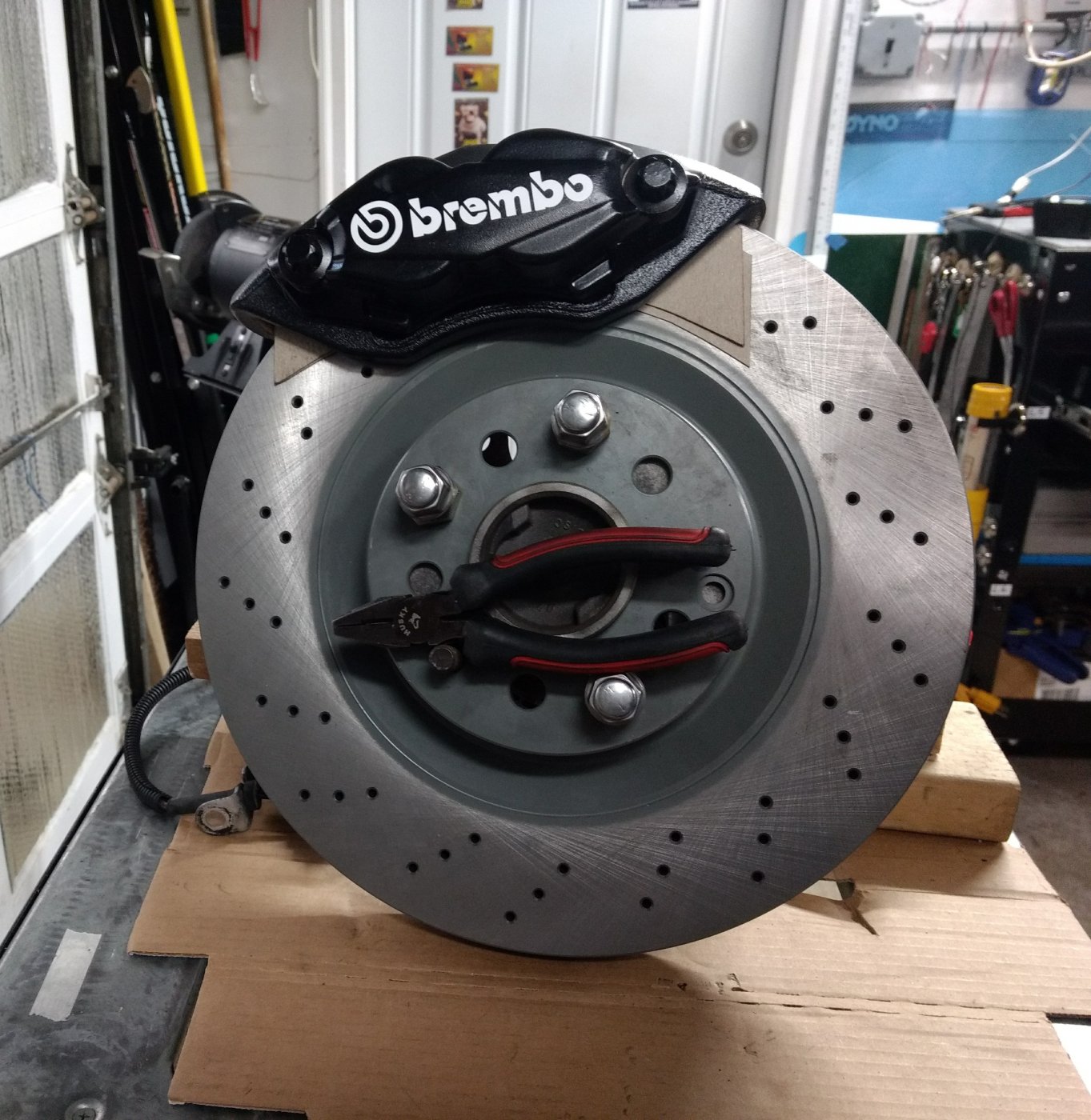

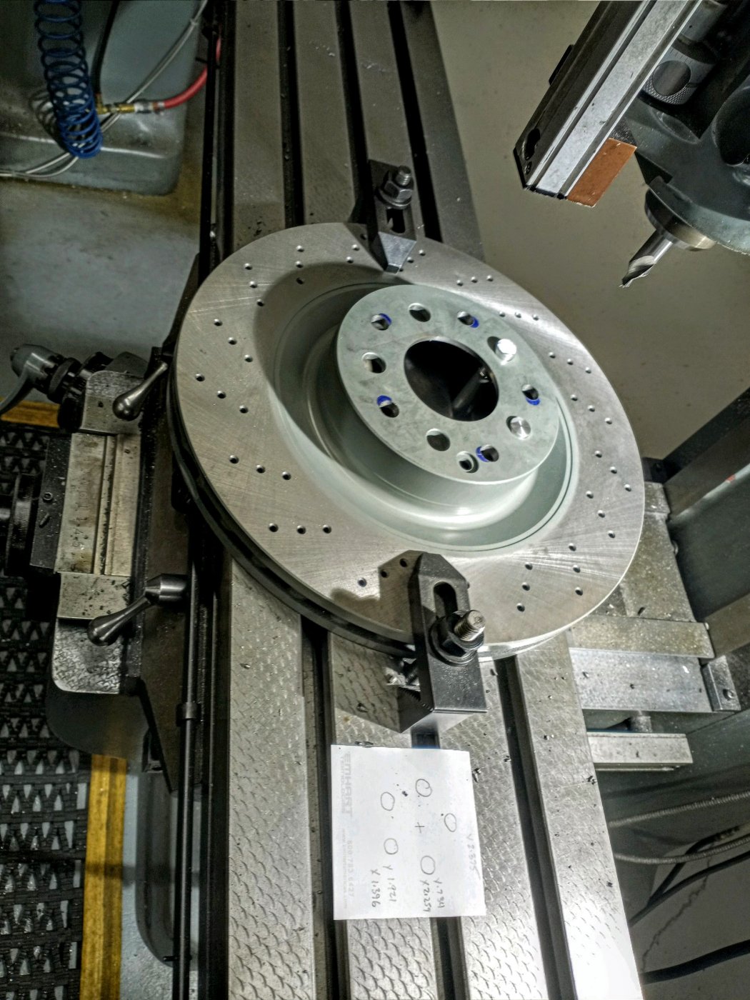

I'm using oem Benz 13.5" front rotors with Brembo 4 pistons calipers. I redrilled them to the hub's Chevy pattern.
I did something similar with my rear brakes. I had Porsche 928 S4 front rotors 130mm bolt pattern re-machined to "5 on 5" (5 5/8" studs on 5" diameter, a standard circle track pattern) . It worked out fine with Porsche 996 uprights.

Hey Neil, the oem stuff was budget friendly and I enjoyed rebuilding the calipers. Replacements are in stock locally to me too.

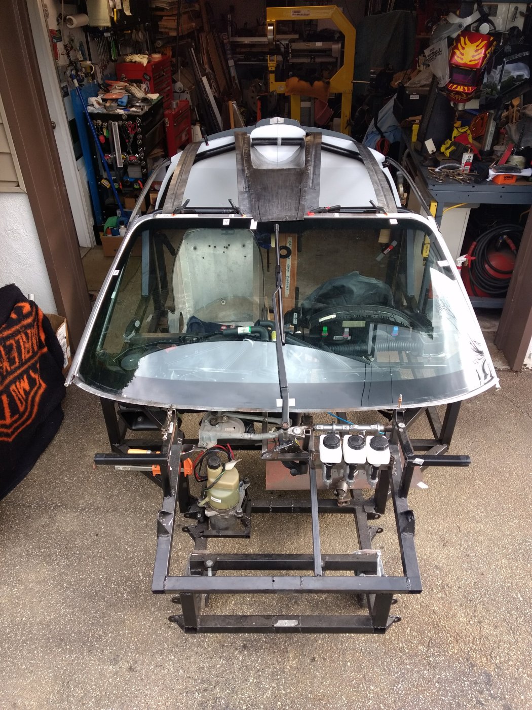

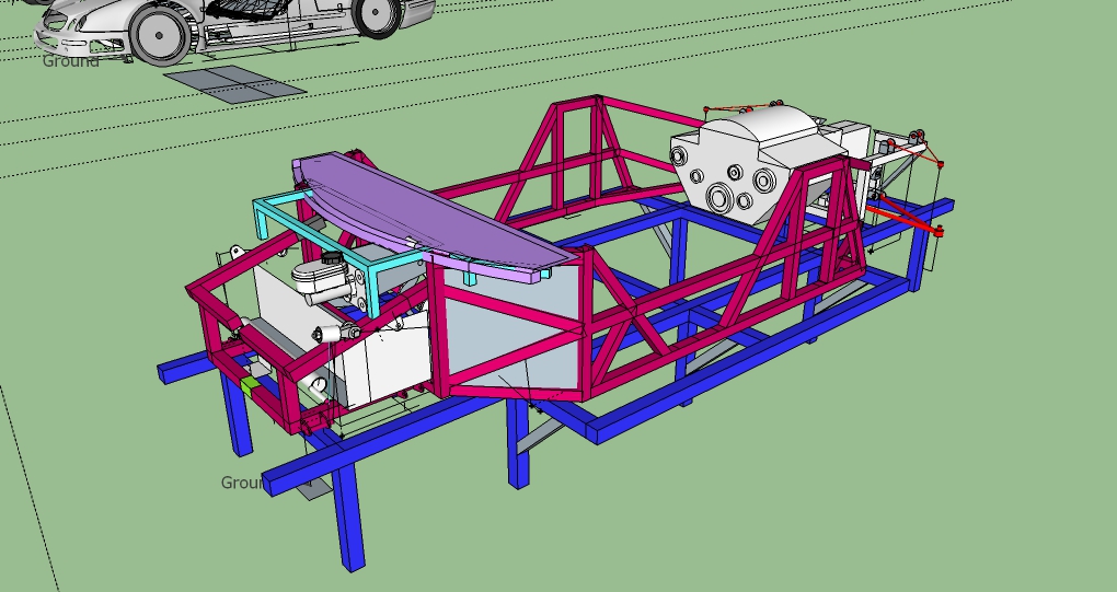

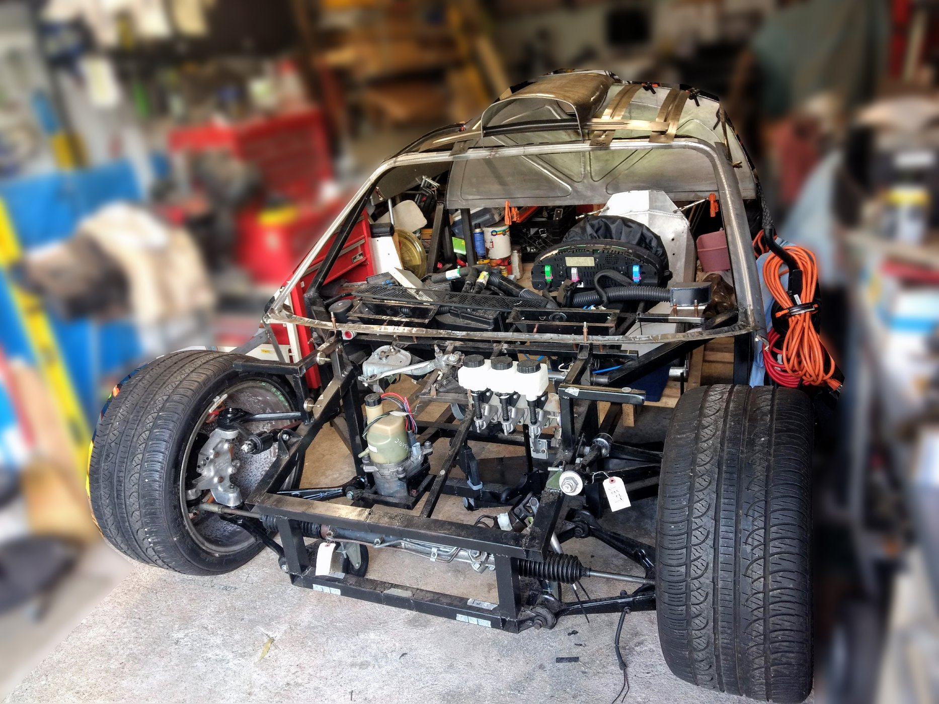

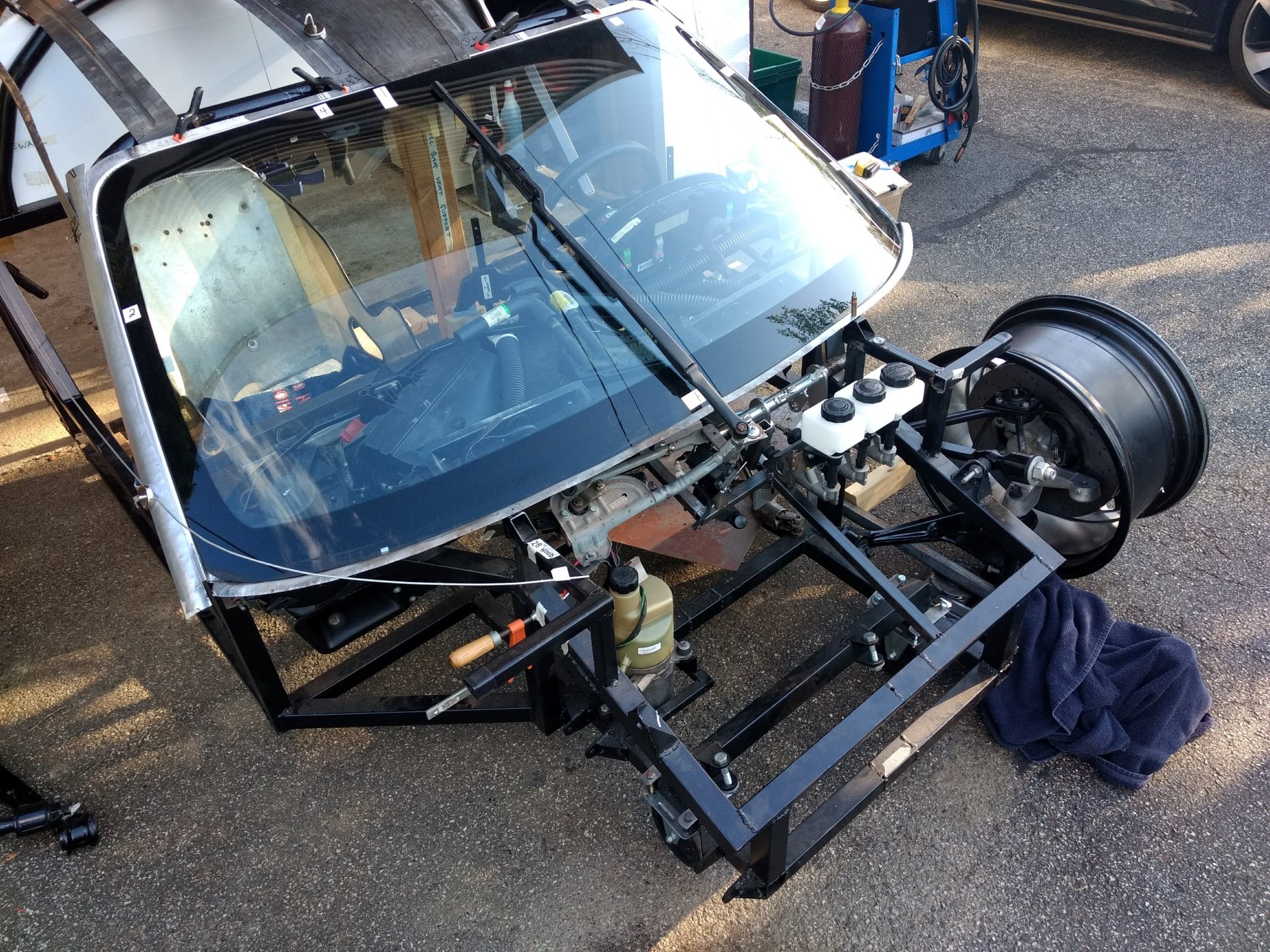

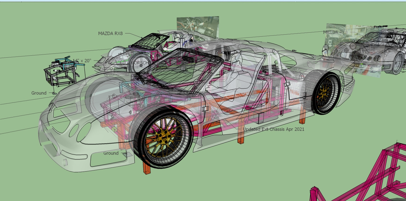

Happy Holidays to everyone here. There's been slow progress on the Merc since the last post. The pedals are in along with the master cyls and reservoirs, wiper arm, linkage and motor, windshield defroster outlets and tubing, electric power steering. Its a slow pace but I love every minute of it. Ive been keeping it all logged in a CAD drawing for reference.

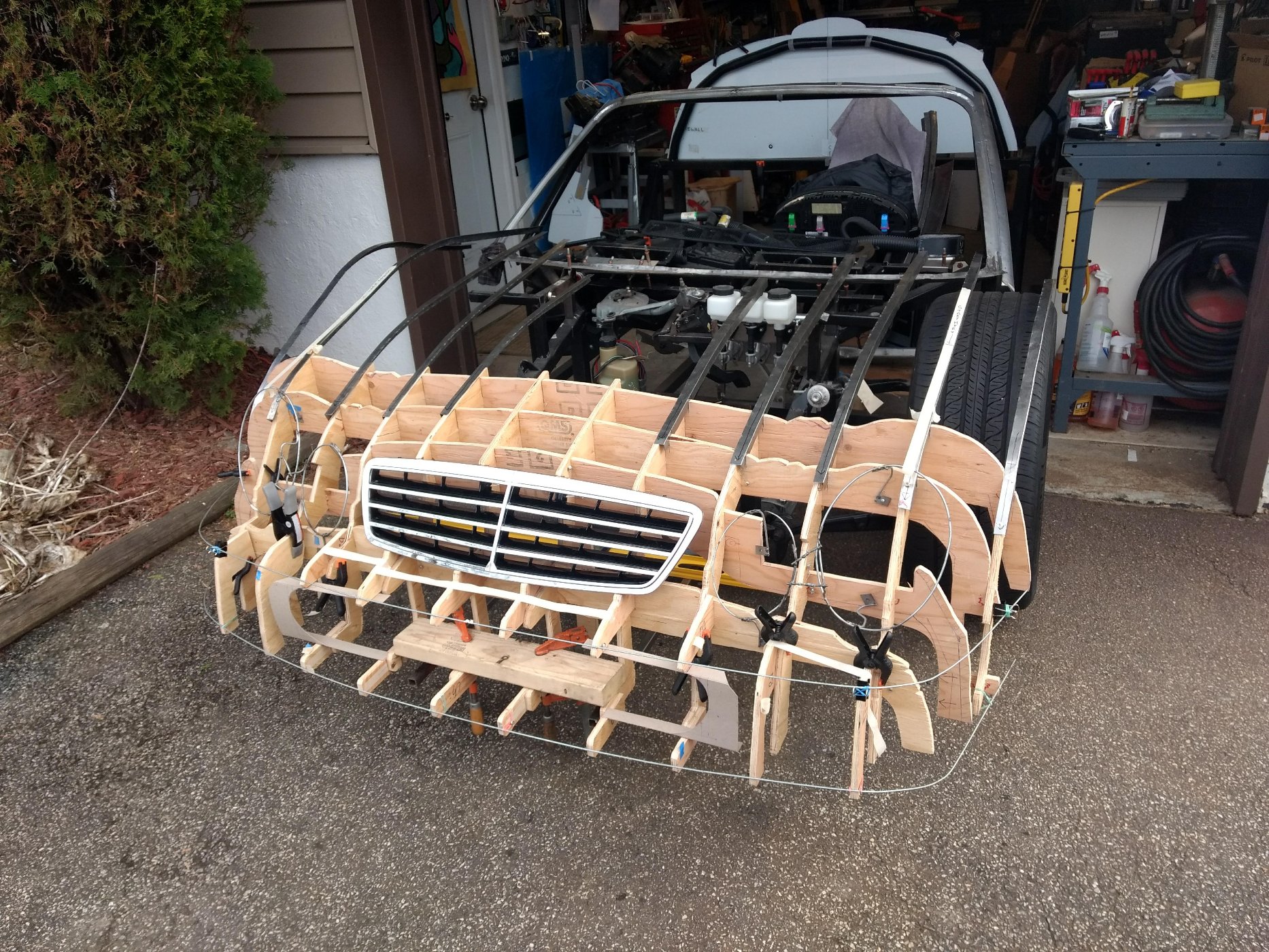

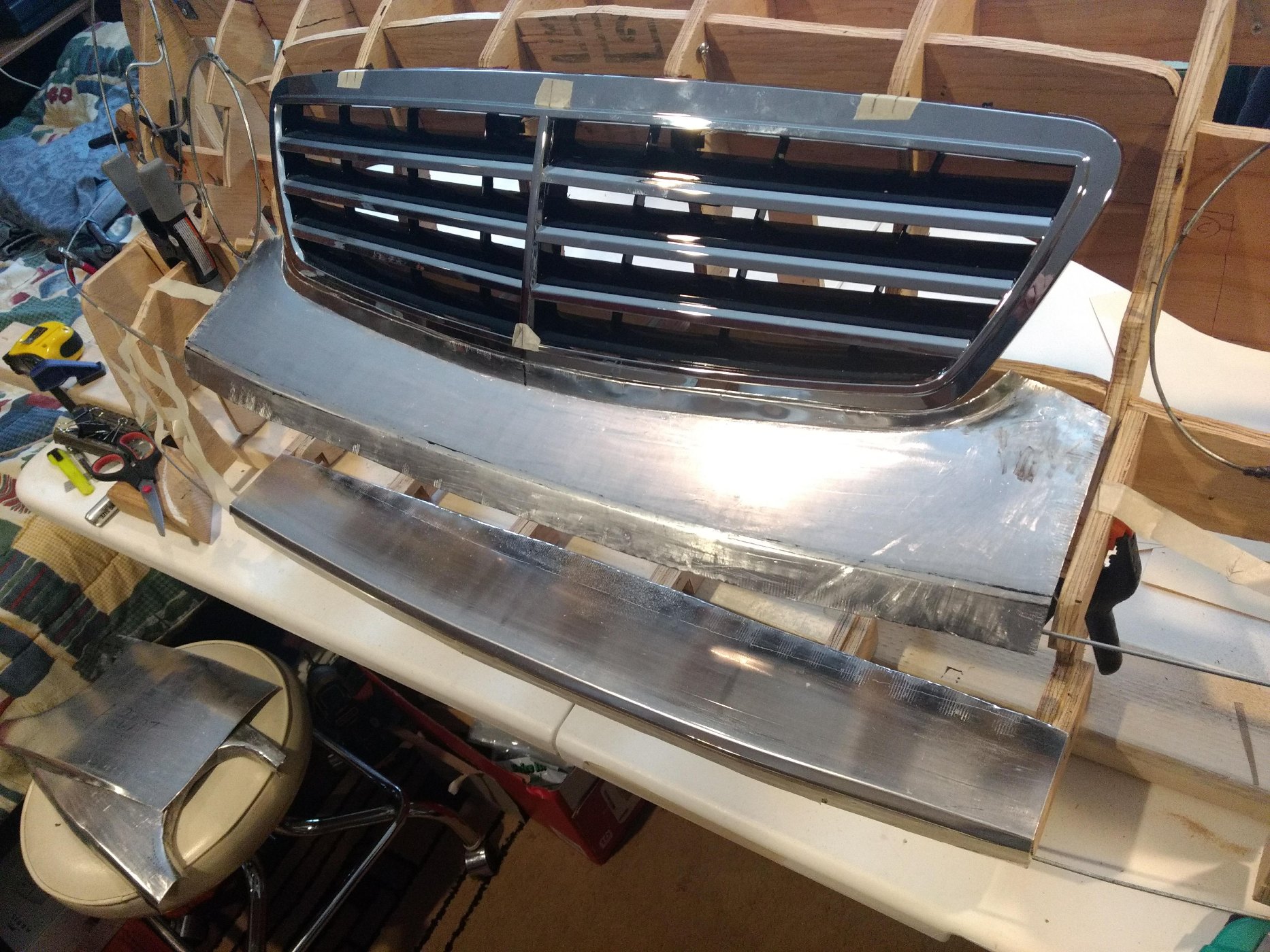

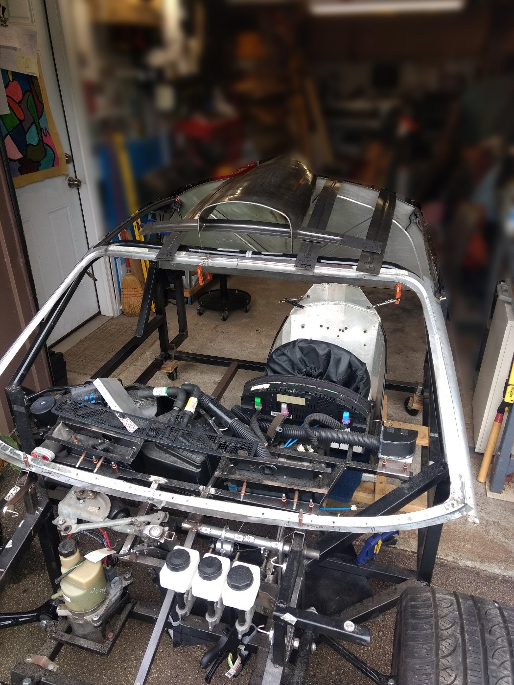

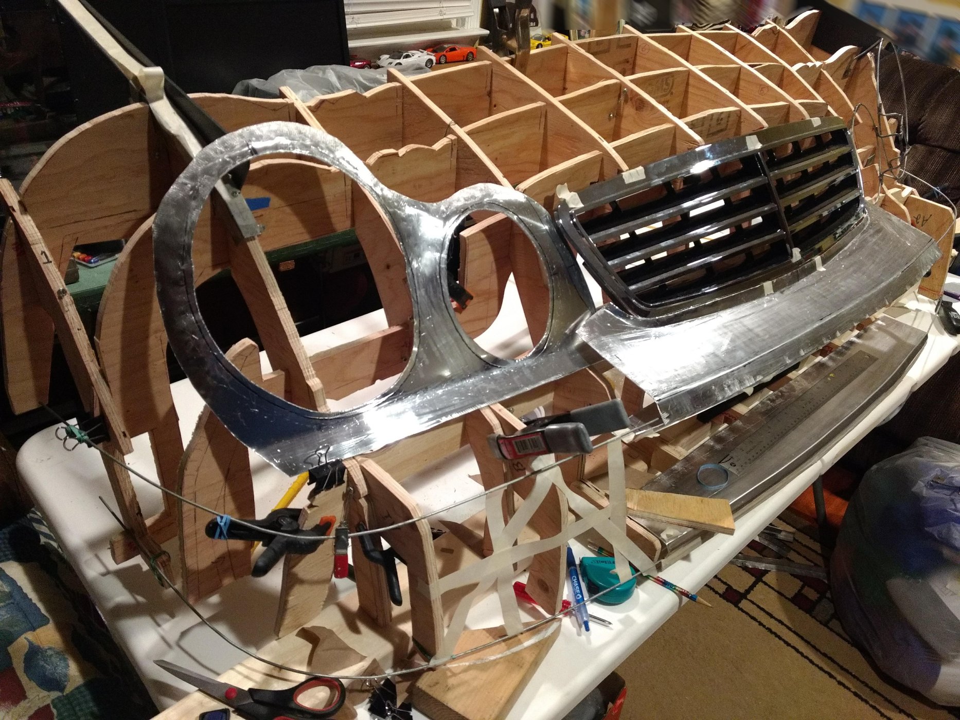

Hello everyone, While enjoying the warm temperatures I've been getting out to the shop more often. Since my last post here I've claimed a room in the house to move the sheet metal forming gear: the English wheel, bead roller -Jenny in the UK, shrinker/stretcher and various dollys and hammers. This allowed me to continue working on the car in the cold winter months learning to form the body panels. Also I recently added the upper firewall behind the driver to help close up the cabin. Shop space is limited so I'm making as much of the front of car as possible, then I plan to build an additional Shed to move machines & tools out for when I add the back half of the chassis. Take care, Vince
