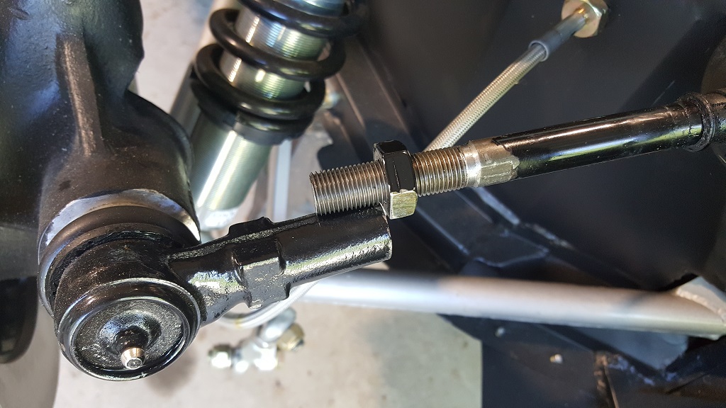

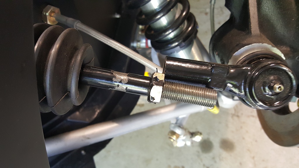

I started to follow your instructions above. Centered the rack between turn locks. Locked steering shaft with pliers. Disconnected tie rod ends and moved wheels near zero toe. Look at the results. The rod ends are very uneven.

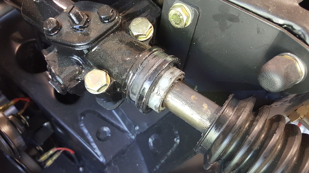

Is the steering limiter the whitish thing in first pic - boot pulled back? If so, how do you remove it?
No,
It would be a nylon piece with a band clamp retaining it. That is the end of the rack housing and will not come off with a pair of dykes!

If the tie-rods are the same length, it suggests that the steering rack itself is not located in the chassis properly. That said - looking at your first picture, it appears that the rack may be mounted in the only position possible.
We ran into similar issues with Factory Five Cobras and Mustang steering racks. The cure was to cut the tie-rod end (the forged steel part) on the side where you run out of threads (your second picture).
