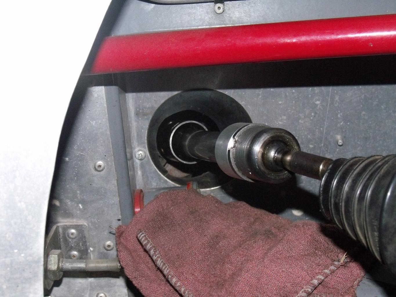

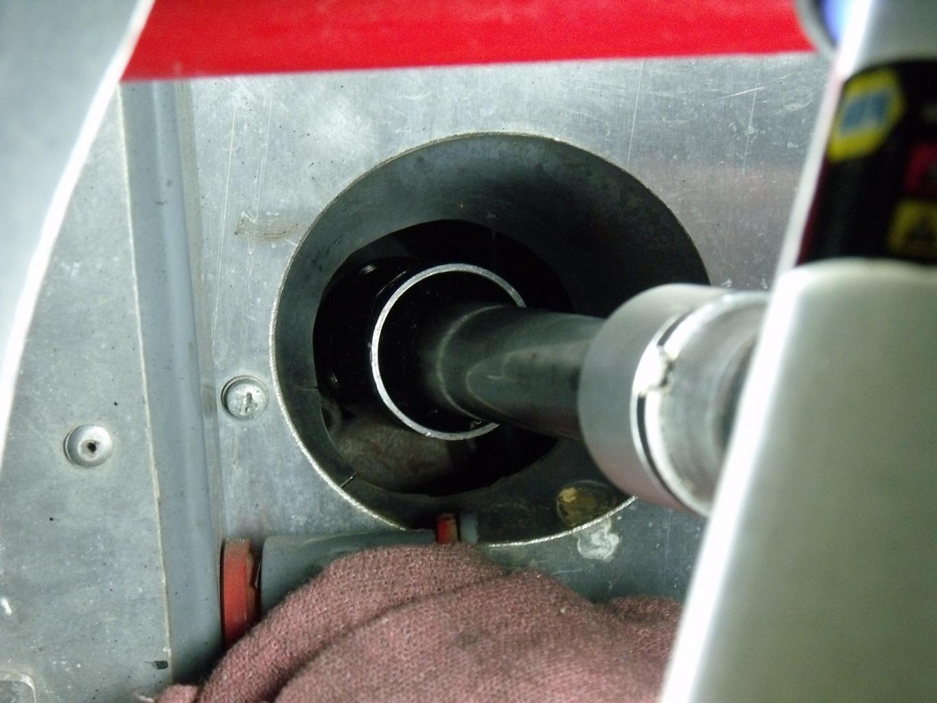

Hello, Does anybody know what 1st gen Roaring Forties used for thier steering racks? It was built in 1999.
My car is making a horrible clunking noise when driving. Upon inspection I found the the left side inner tie rod end moving about. I pulled back the boot and pieces of plastic fell out.
The inner rod is tight. It's the rack shaft itself that is moving because of the spent bushing. It's righthand drive. Any info on this will be greatly appreciated
Patrick
Clayton, After looking at mine and searching the web for Cortina racks, I believe you are correct. Thank You!
Now my mission is to find a bushing stateside. I know... "Good luck Chuck" If anybody knows where in the U.S. I can locate one or two, Please chime in.
If not, I'll be forced to buy overseas.
Patrick

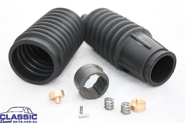

Hi John
I'm pretty sure Patrick is after the plastic inner bush.
This is a pic of an Escort's bush, but both are very similar.
Hi Patrick
As with John, if you cant find any let us know.
Clayton

The bush has lugs on it to hold it in the tube.
Machine it out of nylon and pop rivit it in with 2 rivits through the tube into the bush.
peice of cake.
Jim
Big thanks to all that replied. I'm still looking for these parts in the U.S., But it's looking grim.

I'm open to all and any who can supply or lead me to this bushing. I've noted already said suggestions.
Patrick
